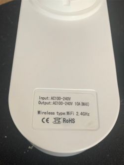

    These are the sockets - both look exactly the same inside and out - even the boxes are the same Cheap AliExpress 13a socket with CB2S (BK7321N)
    So I opened them up, no glue is used, only plastic clips and one fixing screw - when removing the cover you need to push on the power socket to help release the cover.

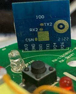

    Few shots of the PCB LEDs etc.
    Cheap AliExpress 13a socket with CB2S (BK7321N) Cheap AliExpress 13a socket with CB2S (BK7321N) Cheap AliExpress 13a socket with CB2S (BK7321N) Cheap AliExpress 13a socket with CB2S (BK7321N)
    Now time to program - success, at first I thought I had bricked it because the LEDs came on, checked wifi and there it was, now setup wifi and the rest is easier from a PC once connected to your wifi

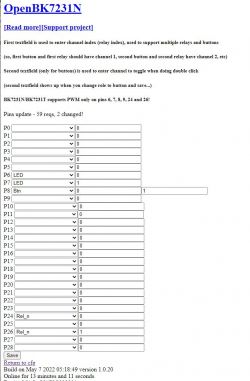

    With my pin assignments - as the switch only has one button I have set it up so that 1 quick press toggles the power socket and 2 quick presses toggle the USB sockets - you can see the second entry across on the P8 line.
    Only issue is that when you plug it in both LEDS will illuminate but the sockets are off, if you do a single and double press it will then have correct status, Another way would be to publish /0/set 100 and /1/set 100 when the socket comes online.
    It may be possible to configure the "change startup control test" but I haven't played with this yet.

    The bad LED status after booting the device is my oversight, I just have to set the pins after rebooting. It's very easy, I will add it and just do OTA (just paste the link to .rbl in the Config-> OTA field and the socket will automatically download a new batch from github).
