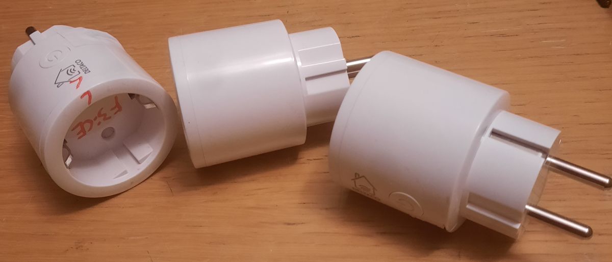

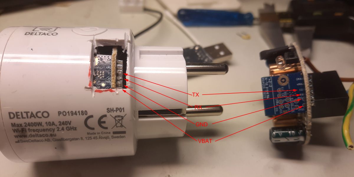

    Here's the teardown for the smartplug Deltaco SH-P01 and SH-P01-3P.
    Serial: PO194180
    https://deltaco.se/sh-p01 (260106)
    Three white Deltaco SH-P01 smart plugs on a wooden surface
    These have been available, and still are, in the Swedish store Clas Ohlson.
    https://www.clasohlson.com/se/Deltaco-smart-plug-SH-P01-inomhus/p/36-8479 (260106)

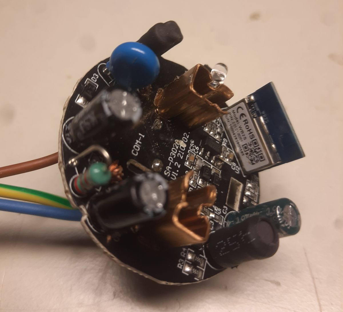

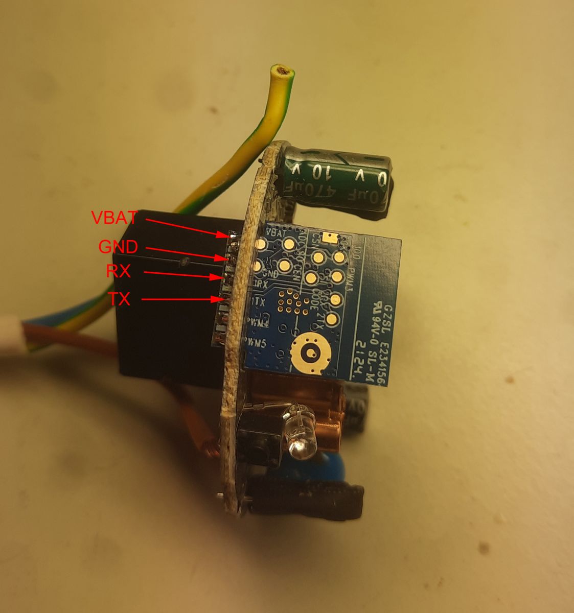

    The WiFi module in these is the WB2S and I have successfully flashed
    the BK7231T firmware on eight of these.

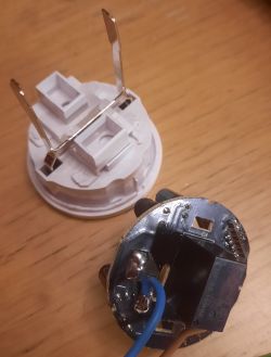

    Disassembled smart plug SH-P01 showing internal PCB and separated plastic housing.
    Disassembled PCB with WB2S Wi-Fi module and various electronic components
    WB2S module with VBAT, GND, RX, and TX pins labeled on a disassembled smartplug

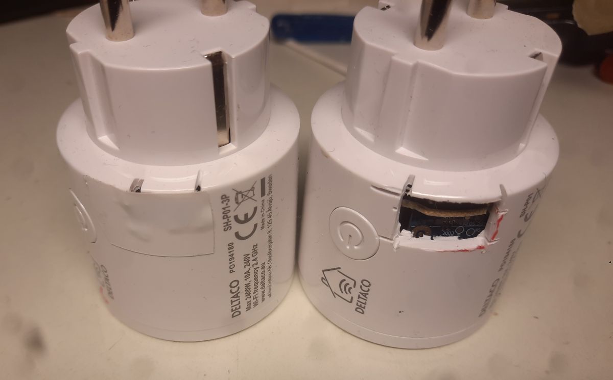

    However I had to destroy one to open it since they are glued.
    The rest I saw a hole on the side to be able to solder

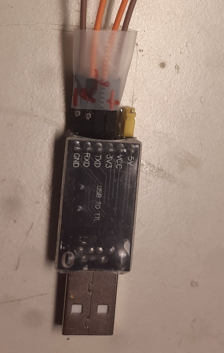

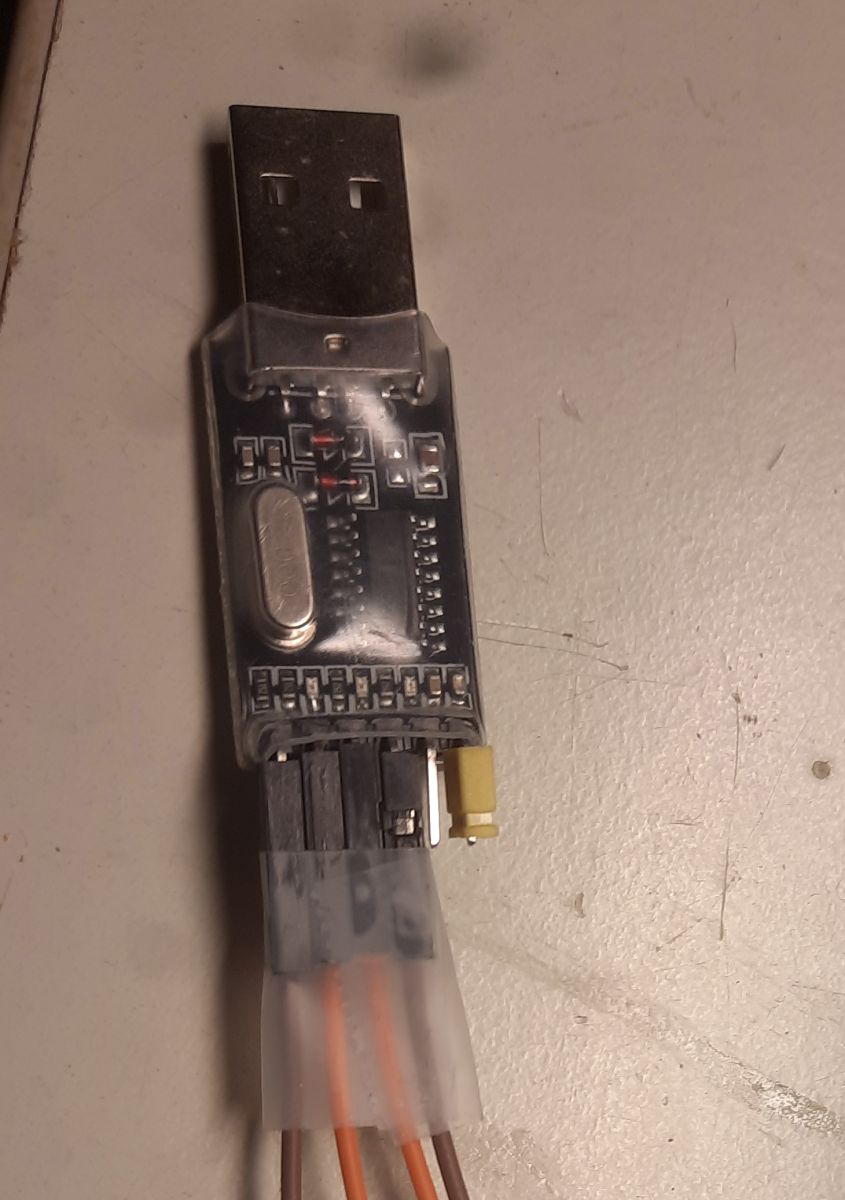

    VBAT, GND, RX, TX to a generic USB2TTL adapter I got from eBay.
    The pin connection should be:
    Adapter pin - WB2S pin
    3.3 V - VBAT
    GND - GND
    TXD - RX
    RXD - TX
    The adapter uses a CH340G chip, so Windows needs drivers for this to
    add a virtual COM port when inserted into USB. I run Windows 10 and probably
    downloaded the driver here (it can be found on other places):
    https://cdn.sparkfun.com/assets/learn_tutorials/8/4/4/CH341SER.EXE (260106)

    USB2TTL adapter with connected wires, visible CH340G chip
    USB to TTL adapter with wires connected to GND, RXD, TXD, and 3V3 pins
    Disassembled SH-P01 smart plug with labeled TX, RX, GND, and VBAT pins
    Two Deltaco smartplugs, one with a cut-out revealing internal circuit board

    The pins are configured as:
    Button : pin 6
    WiFi-LED: pin 8
    Relay : pin 24
    This is the configuration used in the webapp that OpenBekenIOT uses:

    Good idea, it's certainly better than tearing apart whole plug.
    Did you really manage to flash it while powering directly from USB to UART 3.3V pin? That's not very reliable, but still, you're lucky that it worked out well.
    Don't forget to add PowerSave 1 command to the startup line, those devices have low quality power supplies.
