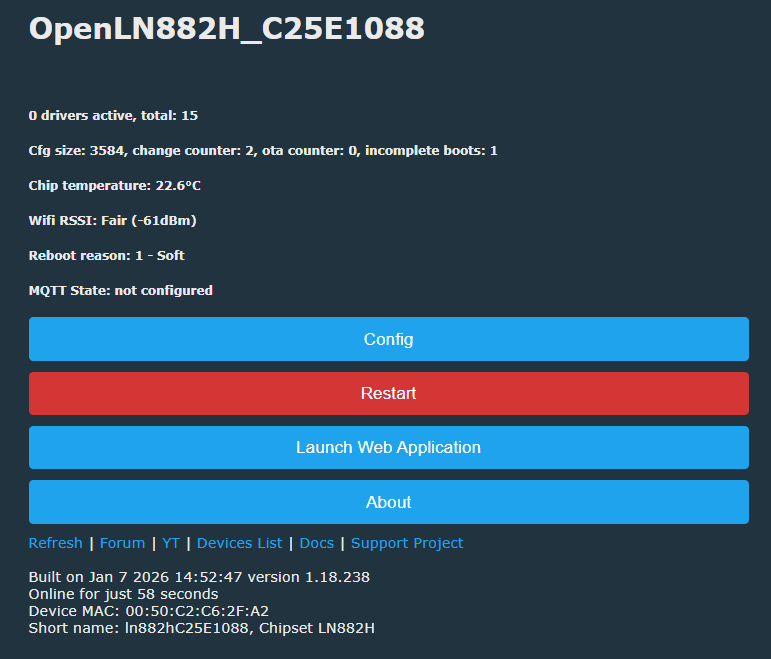

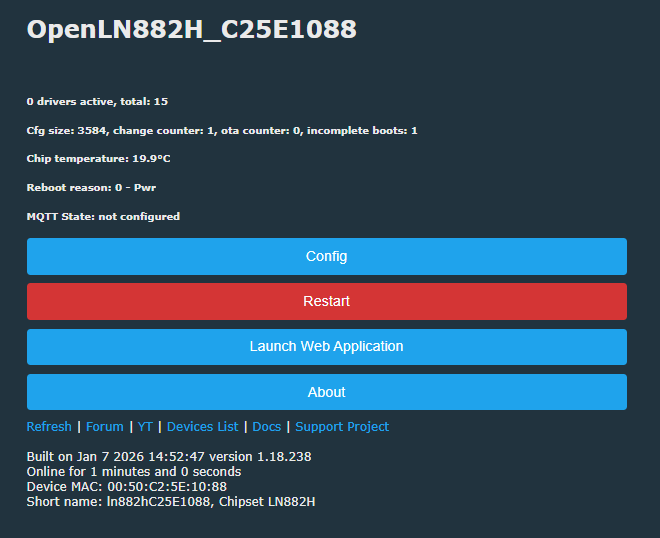

    I buy 3 power outlet to check if some I can apply tuya cloud cutter, no success
    2 of them its CB2S and one its WL2S, all of them with BL0973
    I read the tutorial and apply the fw LN882H.
    No MQTT, just standard config
    I have a weird operation with this module.
    its really slow, sometimes the ping its high, I try to change mac adress, because its started with 00:50:xxxxxxx, I never saw something like that.
    But the web admin its quiet slow, sometimes I loose the connection etc.
    I add the mqtt to test, same, i publish and takes time to read, and sometimes did not do.
    Any ideias?

    which guide did you follow, which tool did you flash with?
    does the mac at the bottom differ from or match (the latter part) the name at the top?
    User interface of OpenLN882H with configuration buttons and system dataControl panel of OpenLN882H device showing Wi-Fi status and configuration options
    Added after 7 [minutes]:
    sweetlilmre wrote:
    The MAC addresses are generated from random data after a flash erase (1 MAC for AP, 1 for STA).
    I think this is still the case
    https://github.com/NonPIayerCharacter/OpenLN8...6a858301425dc/components/utils/ln_misc.c#L176
    as for the poor wifi, this sounds familiar. I feel like there have been reports of such with LN882H for a few months.
    eg https://github.com/openshwprojects/OpenBK7231T_App/issues/1671#issuecomment-2963824624

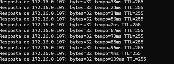

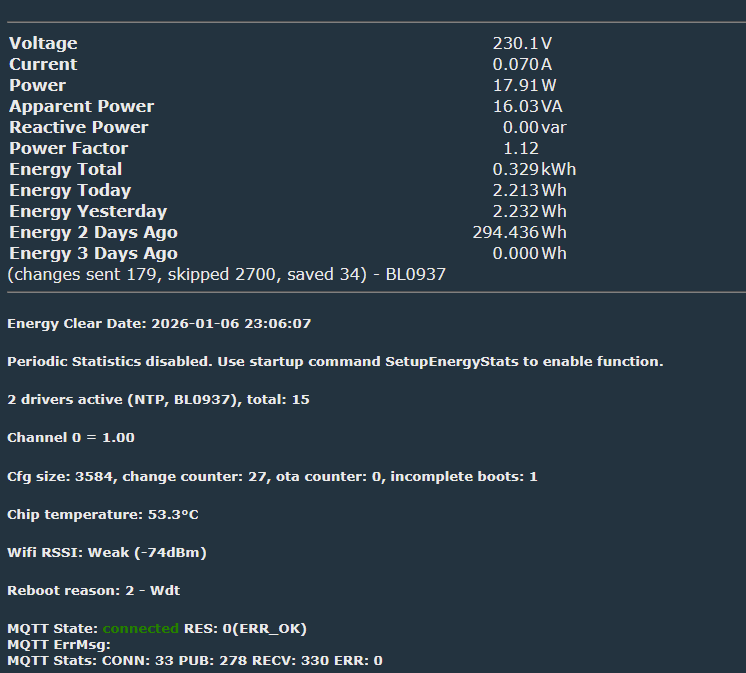

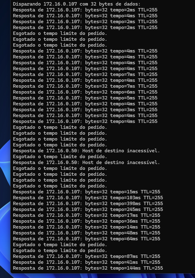

  • High ping persists even with MQTT and bulb off

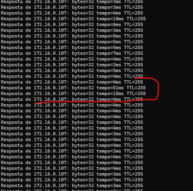

    #4 21803035
    tadeu1
    Posts: 83
    I changed the MAC to Tuya Athom standard and it's still there
    4C:3A:93:19:38:C3
    Also, look at the ping; it's weird, and when I toggle, I lose the connection. I'm beside the router.

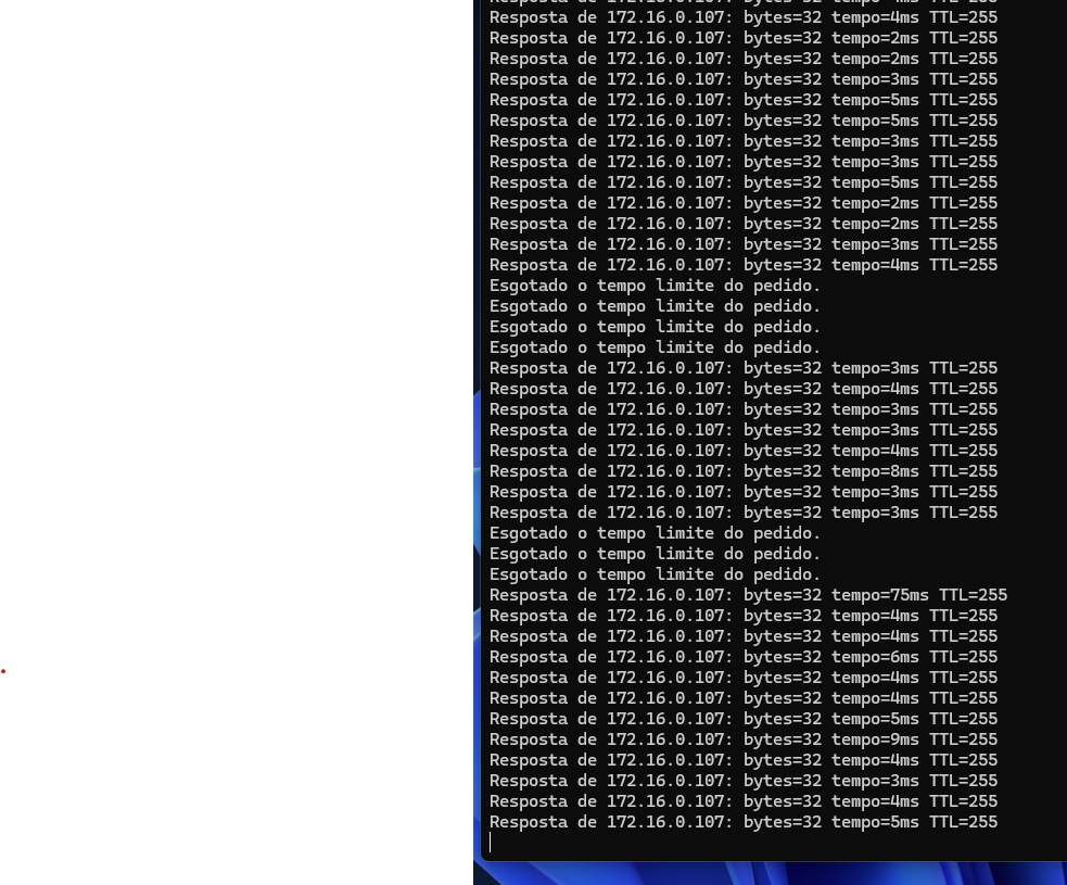

    Ping results to 172.16.0.107 with variable response times and timeouts
    Terminal window showing ping results to 172.16.0.107 with irregular response times
    Added after 1 minute:
    The temperature is not bad.
    Also, I turned the bulb off, and the ping is still bad.
    Screenshot of a metering device showing energy stats and MQTT connection status
    Ping command output with unstable response times for IP 172.16.0.107

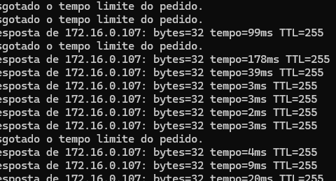

    Added after 7 minutes:
    Version build on Jul 28 2024 11:28:41, version 1.17.650. It's better.
    Just when I press toggle, it gets slow right now.
    Terminal window showing ping results to 172.16.0.107 with variable response times
    Added after 2 minutes:
    I did some tests on Home Assistant; still bad with MQTT.
    Terminal window with ping responses from IP address 172.16.0.107

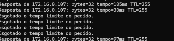

  • #5 21803239
    max4elektroda
    Posts: 758
    Help: 49
    Rate: 189
    The last screenshot shows weak signal.
    Do you maybe have more than one access point with the same SSID?
    LN882H is known to sometimes connecting to any AP, not the nearest. It's some time now, I once tried a solution, but didn't succeed, don't remember the last state...

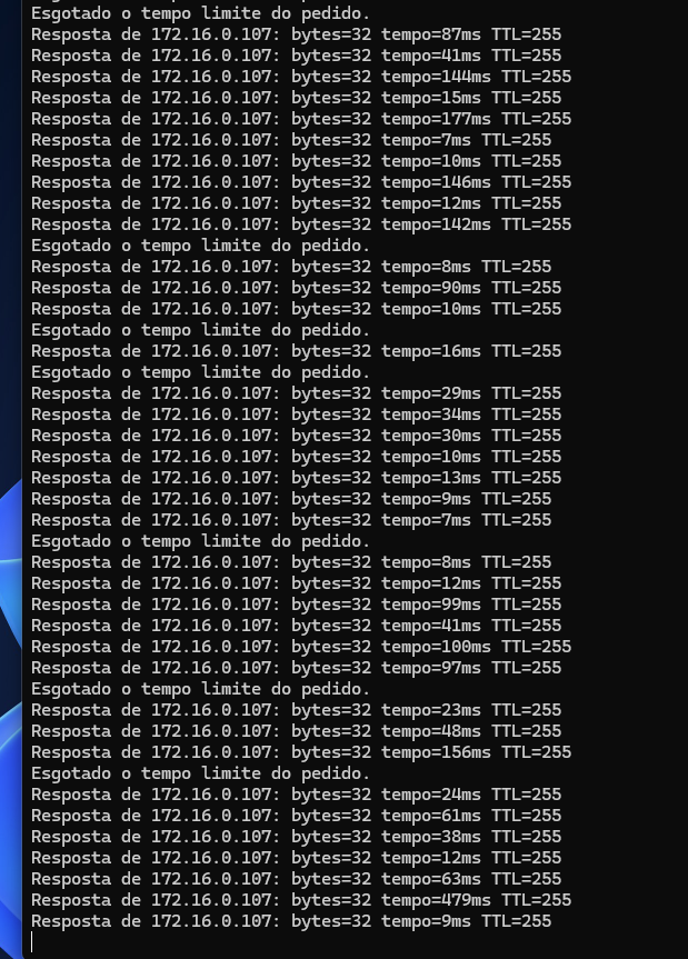

  • Replaced LN882H with ESP-02S and shared Tasmota config

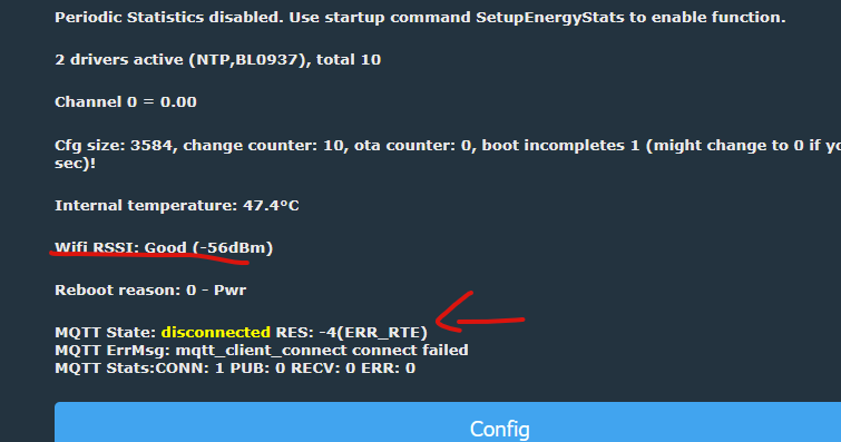

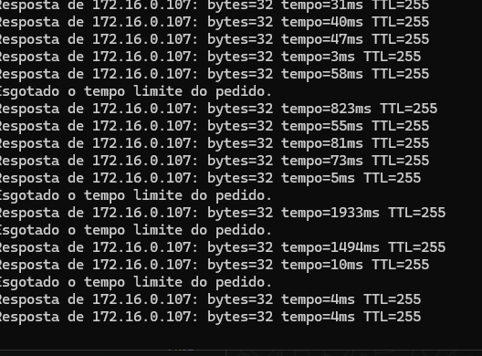

    #6 21803316

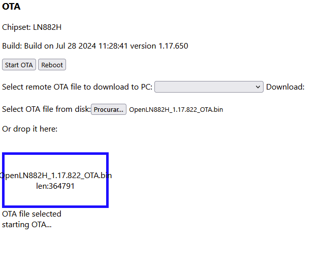

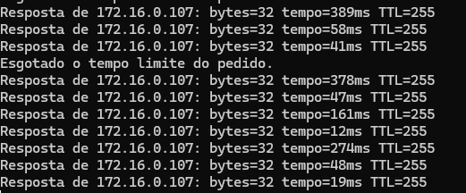

    tadeu1
    Posts: 83
    Yha I have some router with same name.
    Now I get good, I 'm at the version 1.17.650 and I try to run OTA, no sucess, any ideia?:
    Added after 10 [minutes]:
    But with good, I still have issues when I add mqtt and sometimes loose the connection
    Screenshot of a system interface showing Wi-Fi status and MQTT error with pointer on MQTT disconnected.
    Screenshot of ping command with responses and request timeouts
    after mqtt connected
    Ping results to IP address 172.16.0.107 with varying response times and TTL255
    If I toggle at home assistant I loose the connection for a while
    Screen showing ping results to IP 172.16.0.107 with varying response times
    MQTT logs and energy usage data from device “tomada_salao_de_festa_expositor”
    Added after 4 [minutes]:
    I try last fw, last from .17 and I got disconnect when I press start
    Screenshot showing ping to 172.16.0.107 with several requests timing out
    OTA update screen with LN882H chipset and selected file OpenLN882H_1.17.822_OTA.bin
    Added after 2 [hours] 20 [minutes]:
    I give up, I replace with another ESP02S
    attached the config for TNCE to replace LN882H with ESP02S

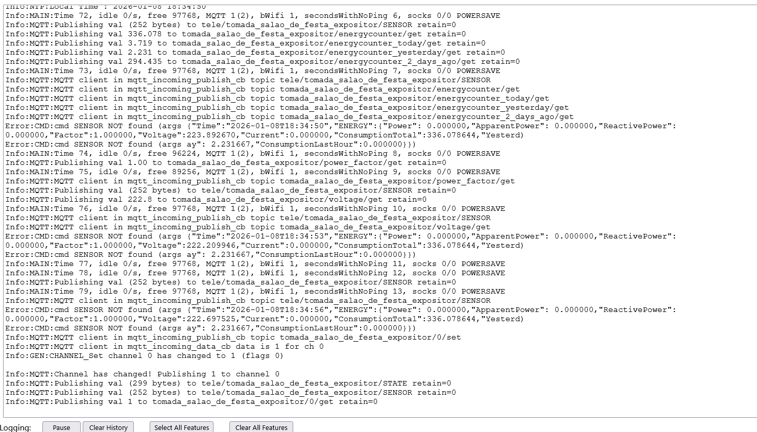

  • LN882H ignores SENSOR commands without test commands enabled
    #7 21803456
    max4elektroda
    Posts: 758
    Help: 49
    Rate: 189
    Sorry it didn't work out for you.
    About the "complaints" about some "SENSOR" command: Seems that for LN882H "TEST_COMMANDS" are not enabled (But even if, it would simply ignore any arguments if I'm not mistaken).
    I can try later on my LN882H device if calling unknown commands regularly can lead to the reported problems.
    Because I'm using a smart plug with BL0937 for some time now. There are some issues with selected AP and sometimes ARP seems not to work (device can't be reached, but it's working fine from my router or if I add a static ARP entry for the plugs IP). Beside this I'm quite happy with it...
