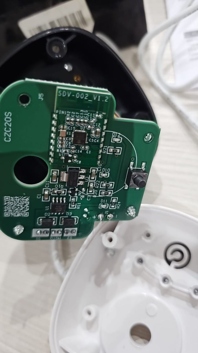

  • R2 to VCC forces boot mode on power-up

    Connection: Connecting a wire to R2 and connecting it to VCC during power-on is enough to put the module in BOOT mode as described here. TX, RX, VCC, and GND pins are as described
    SDV-002_V1.2 PCBs with pinout diagram and function descriptions in table.

    @divadiow please share bootlog
    BL602 boots successfully with current wiring

  • BL602 pinout template with relay, LED, and button pins
    #4 21802304
    lamero345
    Posts: 33
    Template:
      "vendor": "Generic",
      "bDetailed": "0",
      "name": "WiFi Smart Valve Water Gas Shutoff Automated Ball Valve",
      "model": "CZC20",
      "chip": "BL602",
      "board": "SDV-002_V1.2",
      "keywords": [
        "relay",
        "button",
        "wifi_led"
      "pins": {
        "2": "Rel;1",
        "12": "LED;1",
        "14": "Btn;1"
      "command": "",
      "image": "",
      "wiki": "https://www.elektroda.com/rtvforum/topic4160158.html"
