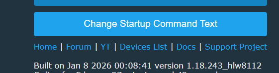

    AI: Which version of OpenBeken firmware are you running on your TH11?
    OpenBK7231N_QIO_1.18.245.bin

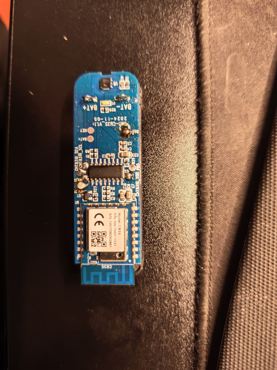

    I don't recall seeing a 'TH11' labelled device before. Do you have pics of device/PCB inside?

    Electronic module with blue PCB and white Bluetooth chip
    I did take a photo, apparently. Sorry for the bad quality and for the ugly soldering. I have Essential Tremors, which don't align well with this hobby. 😅😂

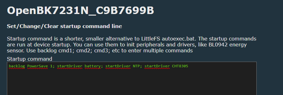

    if this is your autoexec do you get any readings?
  • CHT8305 driver missing from build
    #7 21806487
    nickejonsson
    Posts: 7
    I got the following in the logs after adding your configuration suggestion for the autoexec:
    llback called for bT homeassistant/ subT homeassistant/+
    Info:CMD:CMD_StartScript: started @startup at the beginning

  • TuyaMCU autoexec for CHT8310 sensor mapping
    #8 21806506
    Posts: 5220
    Help: 449
    Rate: 918
    this is not needed when the TuyaMCU is between the Beken MCU and temp/hum sensor.
    also, may need tuyaMcu_defWiFiState 4

    I can't find why it still wants to install the CHT8305 driver. It's not in the autoexec-file...
  • #10 21806580
    Posts: 5220
    Help: 449
    Rate: 918
    it could be set in startup commands
    “Change Startup Command Text” button and software version details

    Yep!
    Can I just remove everything from there, or should I just remove that specific part?
    Screen showing startup command configuration for OpenBK7231N device
  • #12 21806599
    Posts: 5220
    Help: 449
    Rate: 918
    get rid of it all. any parts you want to keep, like ntp and powersave, can go into autoexec
