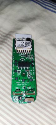

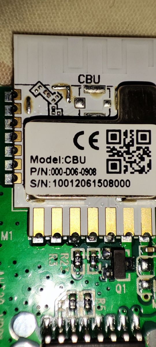

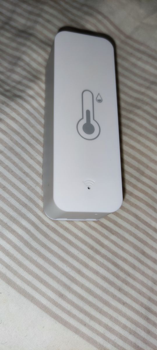

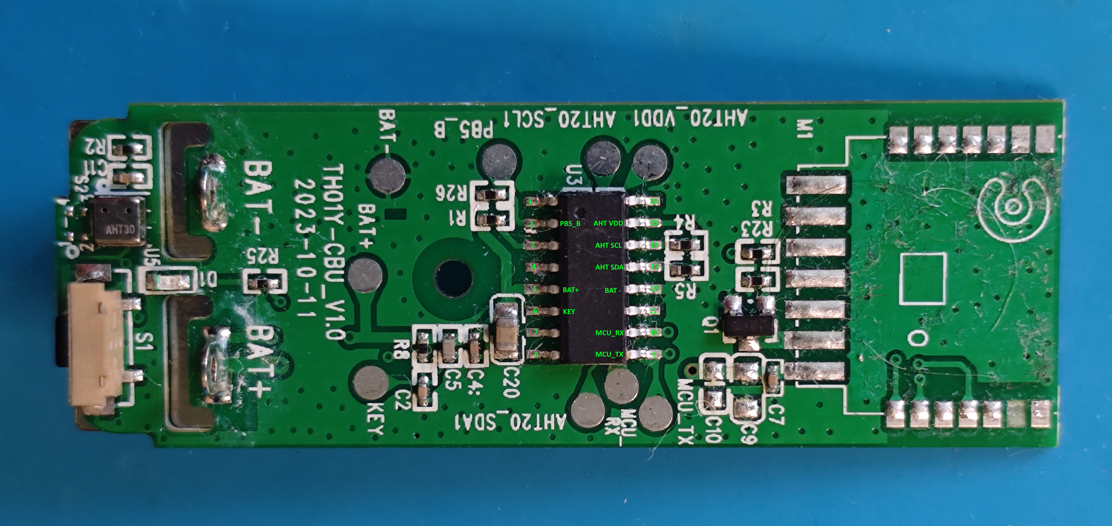

    I present what appears to be another variant of the temperature and humidity sensor TH01 (TH01Y on PCB). This unit has a CBU (BK7231N) module soldered to the top of the PCB. It takes 2x AAA batteries. Packaging is labeled as a Smart Life product.
    (My original post)

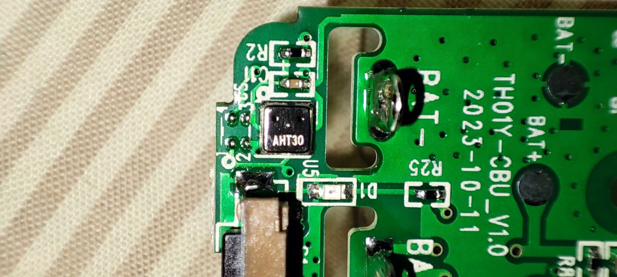

    PCB silk-screen markings of interest:
    TH01Y-CBU_V1.0 2023-10-11
    I notice there are test pads marked "AHT20", but the sensor chip is actually an AHT30.
    Advertisement for Tuya temperature and humidity sensor on an online store.
    Smart Life temperature and humidity sensor packaging with barcode. Smart Life temperature and humidity sensor packaging. External view of the TH01 temperature and humidity sensor in a white casing. Temperature and humidity sensor case without batteries on a fabric background. PCB of temperature and humidity sensor with CBU module. Close-up of a sensor PCB with the CBU module. Close-up of a PCB with AHT30 component and markings TH01Y-CBU_V1.0.
    Screen showing no updates available for modules.

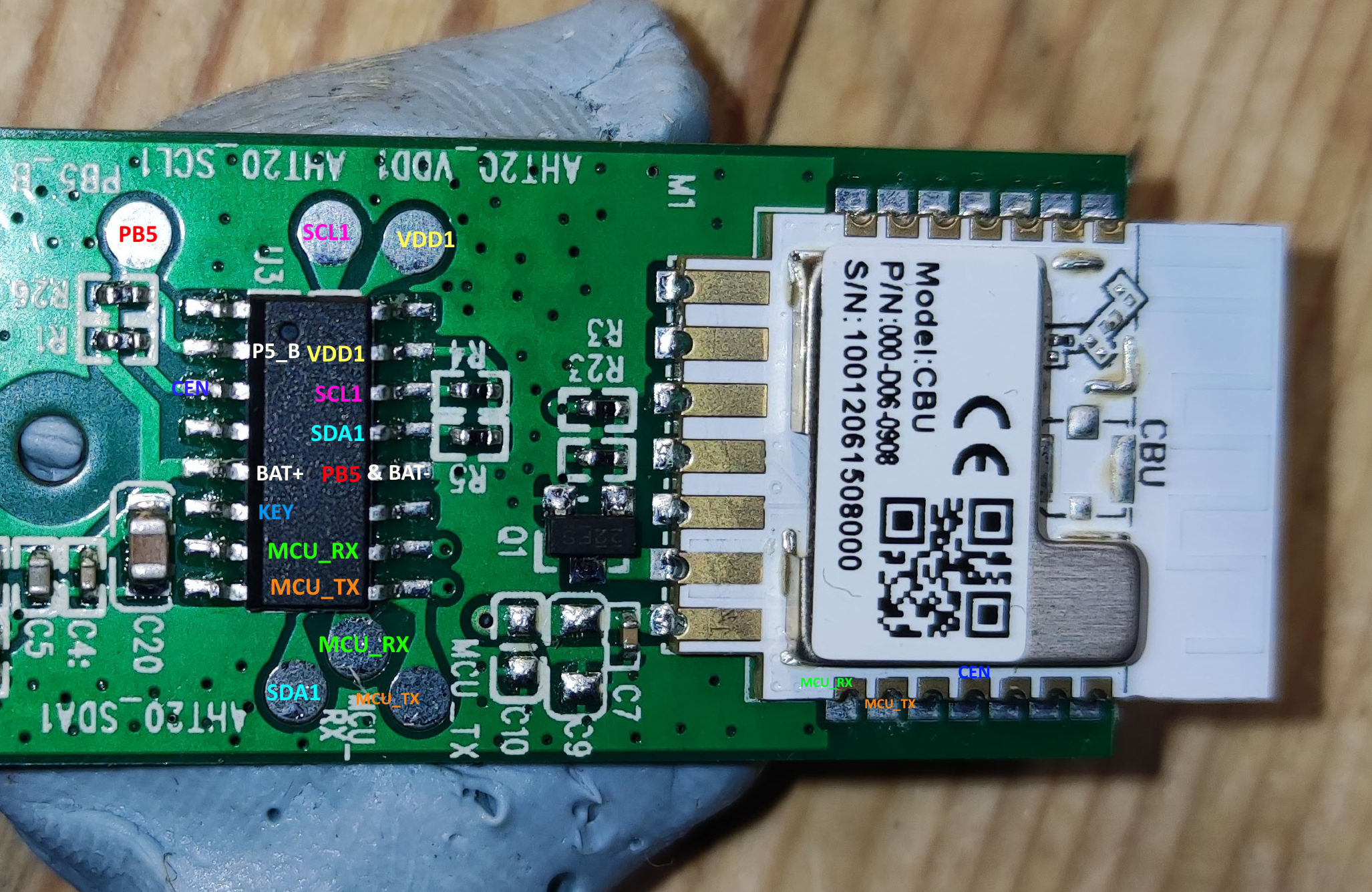

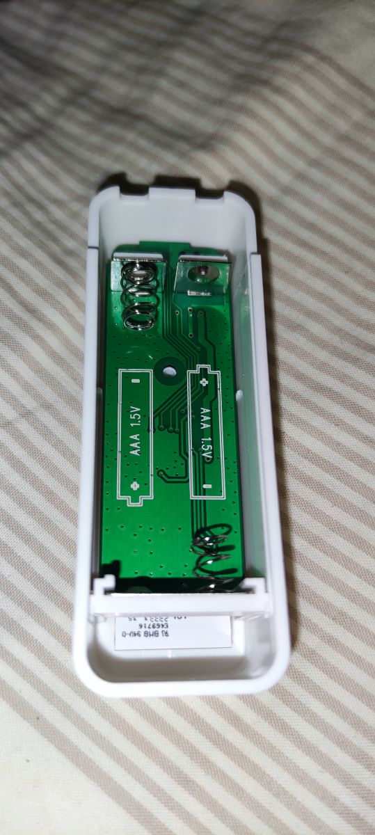

    The 16 pin unmarked chip appears to be some MCU.
    Here are some traces I found which I think I've got right. BAT-/+, KEY and P5_B pads not shown in pic, but easily readable on PCB
    Close-up of the TH01Y sensor PCB with CBU module.

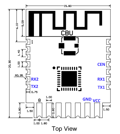

    Diagram of CBU module (BK7231N) with pin labels.

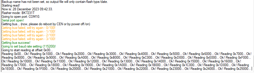

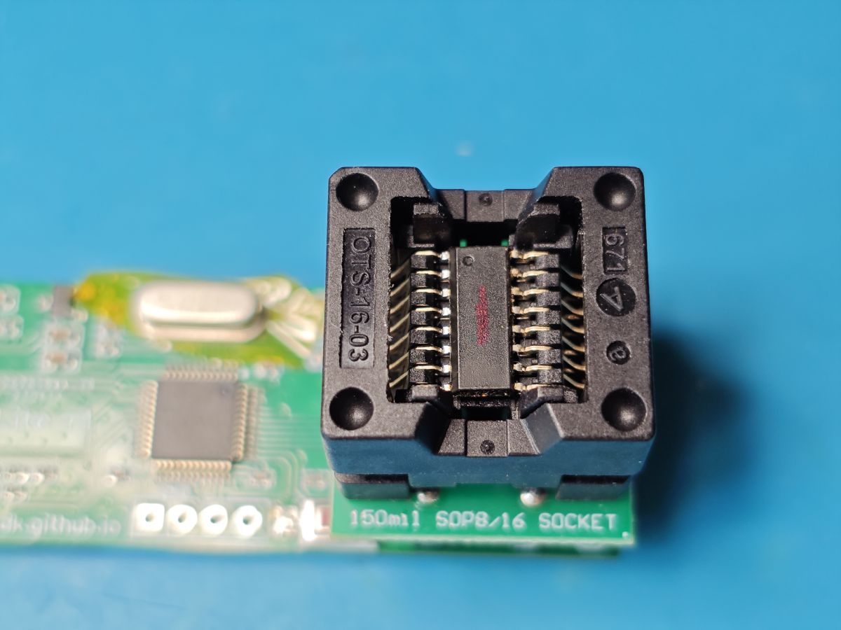

    I don't seem to be able to get a dump/flash yet though, however I power the unit - either from the CBU pins or from the batt-/+ pads. I guess maybe the MCU comms are getting in the way and the TX and or RX need decoupling. I'll update this as I find more.
    edit: probably the same situation as this? https://www.elektroda.com/rtvforum/topic3972260.html
    I'll disconnect RX/TX

    This looks like a TuyaMCU device, so probably a variant of this:
    [CB3S/BK7231N] Temperature/Humidity Sensor with TuyaMCU - Diagram, Reverse Engineering
    You could follow the guide above to handle this device, but... maybe it would be easier to add AHT30 support directly to OBK, remove the MCU and route the wires?
    Do you happen to know how AHT30 protocol looks like?
    We have a SHT3X driver, wouldn't that work for it already?
    https://github.com/openshwprojects/OpenBK7231T_App/issues/574
    https://github.com/openshwprojects/OpenBK7231...f3af70efda56f9f0ee856d/src/driver/drv_sht3x.c
    Removing TuyaMCU would bring some advantes, for example, you'd have full control over the sleep time.

    Since my last update, I've disconnected the MCU_TX pin on the MCU chip and have managed to begin a firmware dump, but it stops about 11-12s after power-up. Maybe it's going to sleep or something. I'll disconnect RX and try again.
    Screenshot of a flash memory reading process with success and failure messages.
    What is the purpose of the MCU if the CBU module can be engineered to perform all functions? Why do other temp/hum devices not have an MCU?
    I'll try the SHT3x driver if I can get it to flash with OBK. I do not know what the AHT30 protocol looks like. I could only find AHT20 references.

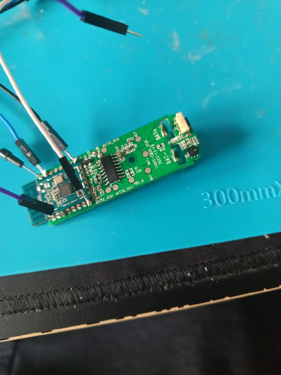

    Hi, i have two PCBs more recent like that (TH01Y of 2023-12-16)
    Image of a PCB with connected wires on a blue surface.
    and with the next autoexec.bat no data is received, always 0:

    There is no TuyaMCU communication at all. Do you power that WiFI module artificially? TuyaMCU communication will only occur if you allow TuyaMCU to control the power of WIFi chip
  • #9 20968824
    nacxoffw
    Posts: 13
    I tested powering from battery pinouts and from CB3S 3v/GND pinouts before and after rebuild Rx Tx board traces...
    Any tip?

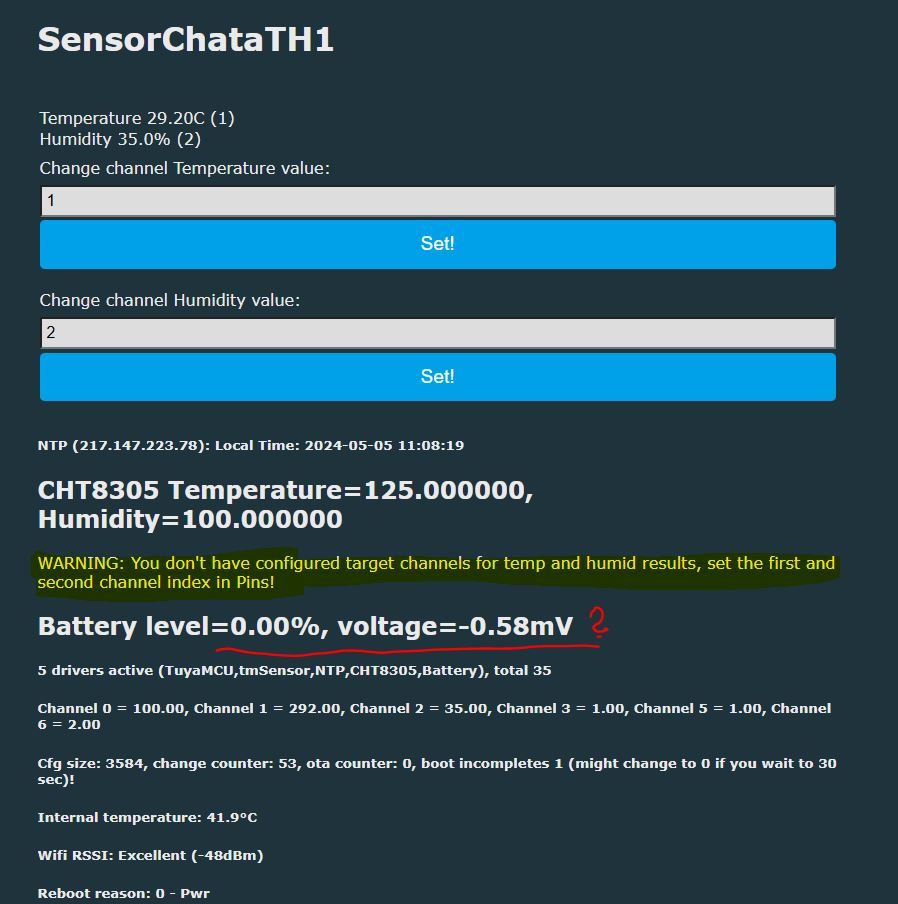

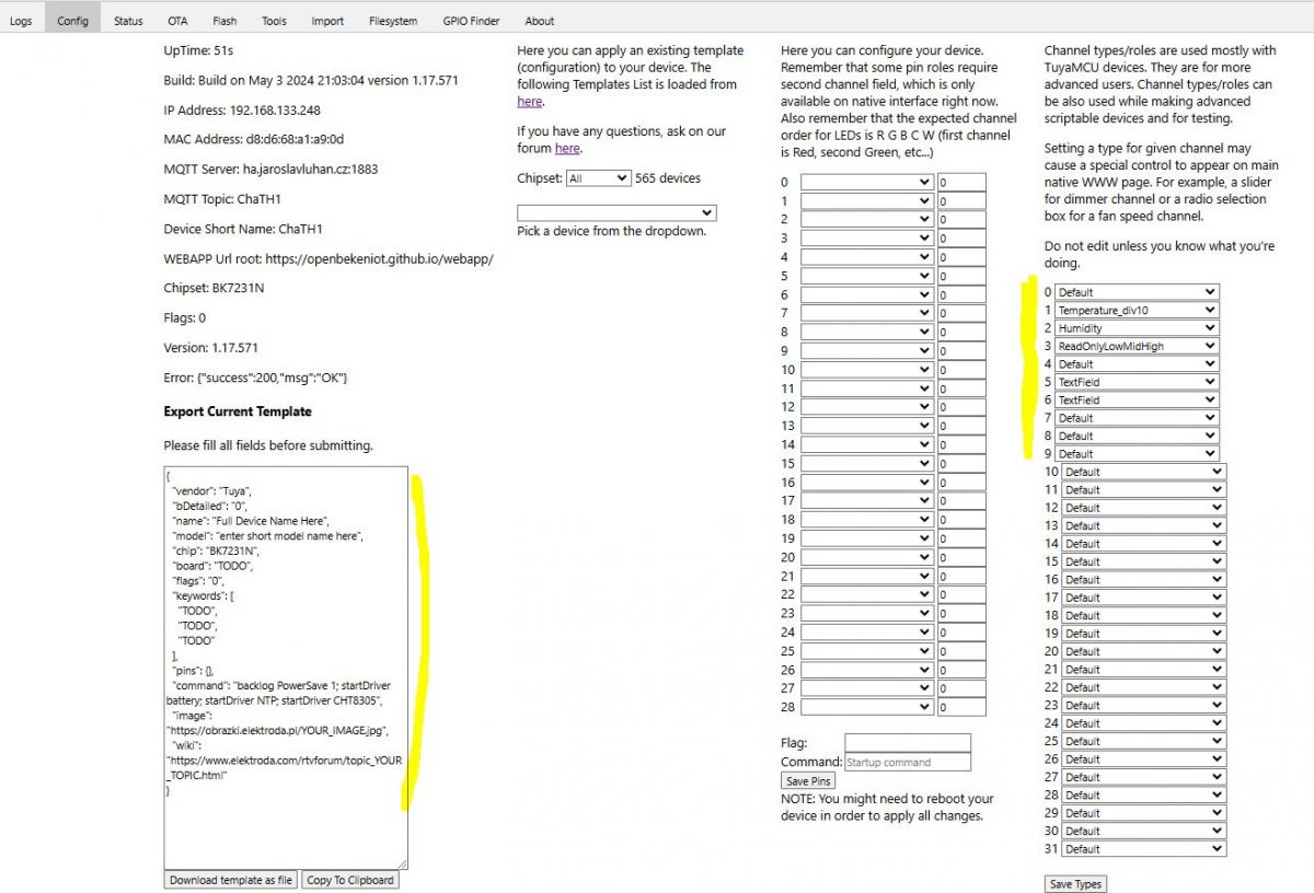

    Hello, thanks to all for the descriptions and tips.
    I have also two PCBs (TH01Y-CB3S_V1.6 2023-12-16), searched all forum topics but now I am in this state:
    Temperature and Humidity is displayed, but I need some level correction.
    There is warning to configure target channels for temp and humid. results, but I don't know where to do it. I tried to guess the pins but not successfully. See attached screenshot.
    MQTT is connected, but publish voltage and battery with 0 values.
    Humidity and temperature are published as:
    temperature not divided by 10
    ChaTH1/1/get
    humidity
    ChaTH1/2/get
    My autoexec.bat:
    startDriver TuyaMCU
    startDriver tmSensor
    // may be needed, depends on device, some also use 9600
    tuyaMCU_setBaudRate 9600
    // dpID 1 is temperature div 10
    setChannelType 1 temperature_div10
    // dpID 2 is % humidity
    setChannelType 2 Humidity
    // dpID 3 is battery state - low(0), mid(1) and high(2)
    linkTuyaMCUOutputToChannel 3 enum 3
    setChannelType 3 ReadOnlyLowMidHigh
    setChannelLabel 3 Battery
    // setup dpCache - temperature interval
    // Show textfield for that
    setChannelType 5 TextField
    // setup display name
    setChannelLabel 5 Temperature Interval
    // Make value persistent (stored between reboots),
    // start value -1 means "remember last"
    SetStartValue 5 -1
    // set default value if not set
    if $CH5==0 then setChannel 5 1
    // link dpID 17 to channel 5, the type is val, extra '1' means that its dpCache variable
    linkTuyaMCUOutputToChannel 17 val 5 1
    setChannelType 6 TextField
    setChannelLabel 6 Humidity Interval
    SetStartValue 6 -1
    if $CH6==0 then setChannel 6 1
    linkTuyaMCUOutputToChannel 18 val 6 1
    Thanks for advice or links to final solution. If there is no final on one page, I will post my result when I will successfully similar to the "my" door sensor solution as here: https://www.elektroda.com/rtvforum/topic4023117.html
    EDIT/UPDATE:
    I understood, that battery indicator is readable and it has only 0,1,2 states
    ChaTH1/3/get
    So now I want to customize:
    1. Wake up interval, for example the measuring one hour is enough to me.
    2. how to read temperature divided 10. I can change it in home assistant, but better is change it before MQTT publishing
    3. how to set up the correction of temp. and humidity.
    Screenshot of a configuration interface with channel settings. Screenshot of sensor interface showing temperature and humidity data with a warning about unconfigured target channels.

    I also have some of these TH01Y-CBU Boards.
    This is what I have found out so far:
    If you try often enough (more than 10-100 times), you can program the firmware randomly without stopping after about 11-12 seconds.
    If you remove the MCU chip, programming works without any problem at the first time
    I have flashed 6 of these devices, but they stop working after a few hours. They don't publish to MQTT anymore.
    I want to revert them to the original firmware, but unfortunately, I can't find my original firmware file.
    Can someone upload or send this file to me?

    [BK7231N] [CBU] [AHT30] Cutesliving TH01 Smart Life Temperature and Humidity Sensor

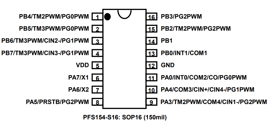

    I wanted to find out what these unmarked 16-pin TuyaMCUs really are.
    they could be Padauk PFS154s. GND, VCC and PB5 line up.
    https://www.padauk.com.tw/en/product/show.aspx?num=66&kind=42
    annoyingly they require the Padauk burning hardware
    https://www.padauk.com.tw/en/technical/index.aspx?kind=27
    • PFS154 datasheet_EN_V107_20240912.pdf (2 MB) You must be logged in to download this attachment.

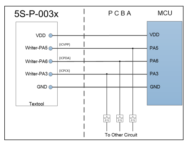

    Why is Padauk burning hardware required? What's special there? Couldn't we just make a driver for Beken?
  • #22 21891652
    Posts: 5062
    Help: 438
    Rate: 893
    in section 9.1.8 in the datasheet:
    5S-P-003
    it seems there are DIY programmers, but their creation looks quite involved:
    https://free-pdk.github.io
    https://github.com/free-pdk/easy-pdk-programmer-hardware
    https://github.com/free-pdk/easy-pdk-programmer-lite-hardware
    assuming these chips are PFS154-S16 even
    #23 21892976
    Posts: 14620
    Help: 655
    Rate: 12635
    Ahhh, it seems it needs higher voltages, like VPP which may be more than 5V. I can see how it complicate stuff.
    It reminds me of the old PICKIT2 clone I did 10 years ago, it also had to generate VPP with a simple step up converter from 5V:
    https://www.elektroda.pl/rtvforum/topic3209760.html
    So that would not be very simple for Beken, sadly. I hoped for a flashing approach that will work at BK7231 GPIO logic levels (0-3.3V).

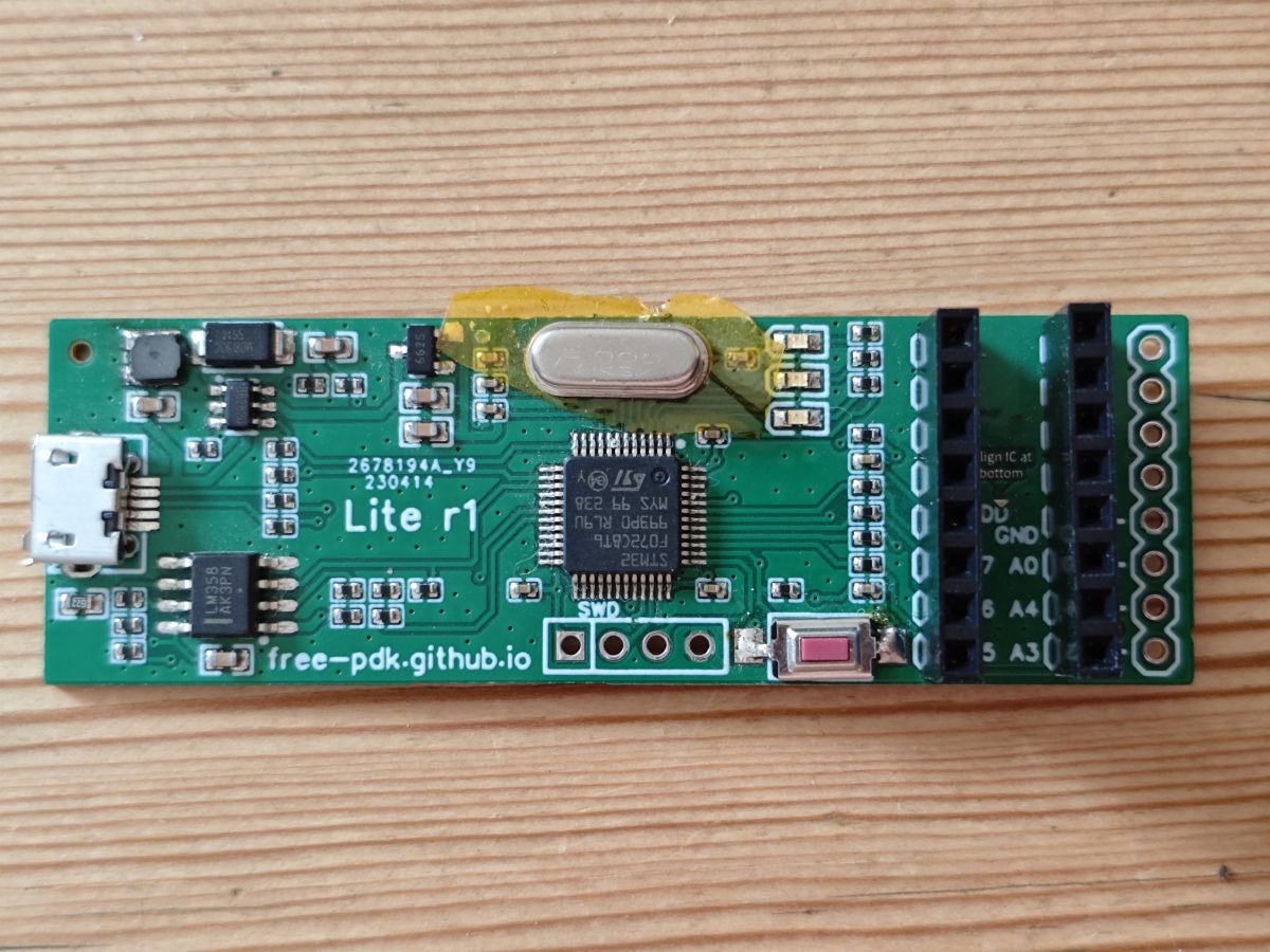

  • #25 21904402
    Posts: 14620
    Help: 655
    Rate: 12635

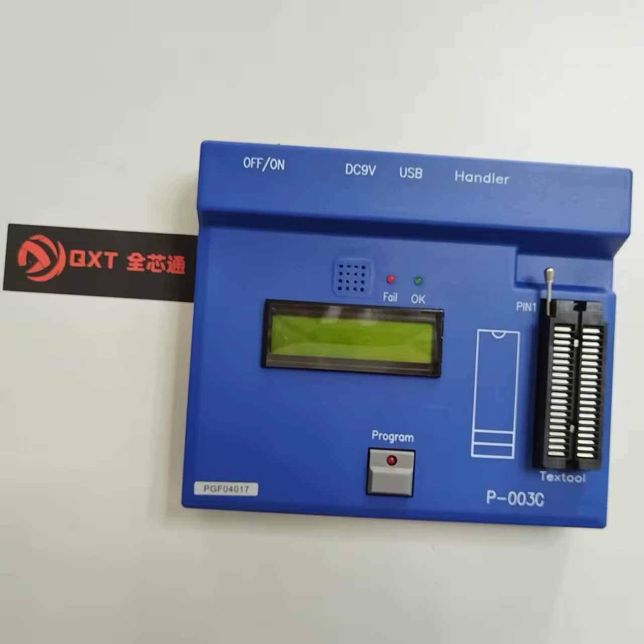

    Did you get one or is it a project from web? What's the cost?
  • #26 21904645
    Posts: 5062
    Help: 438
    Rate: 893
    ~£15 delivered. got lucky with this post here https://github.com/free-pdk/easy-pdk-programm...ite-hardware/issues/1#issuecomment-4324690070
    a user who had 5 and offered some for sale 3 years ago still had one left!

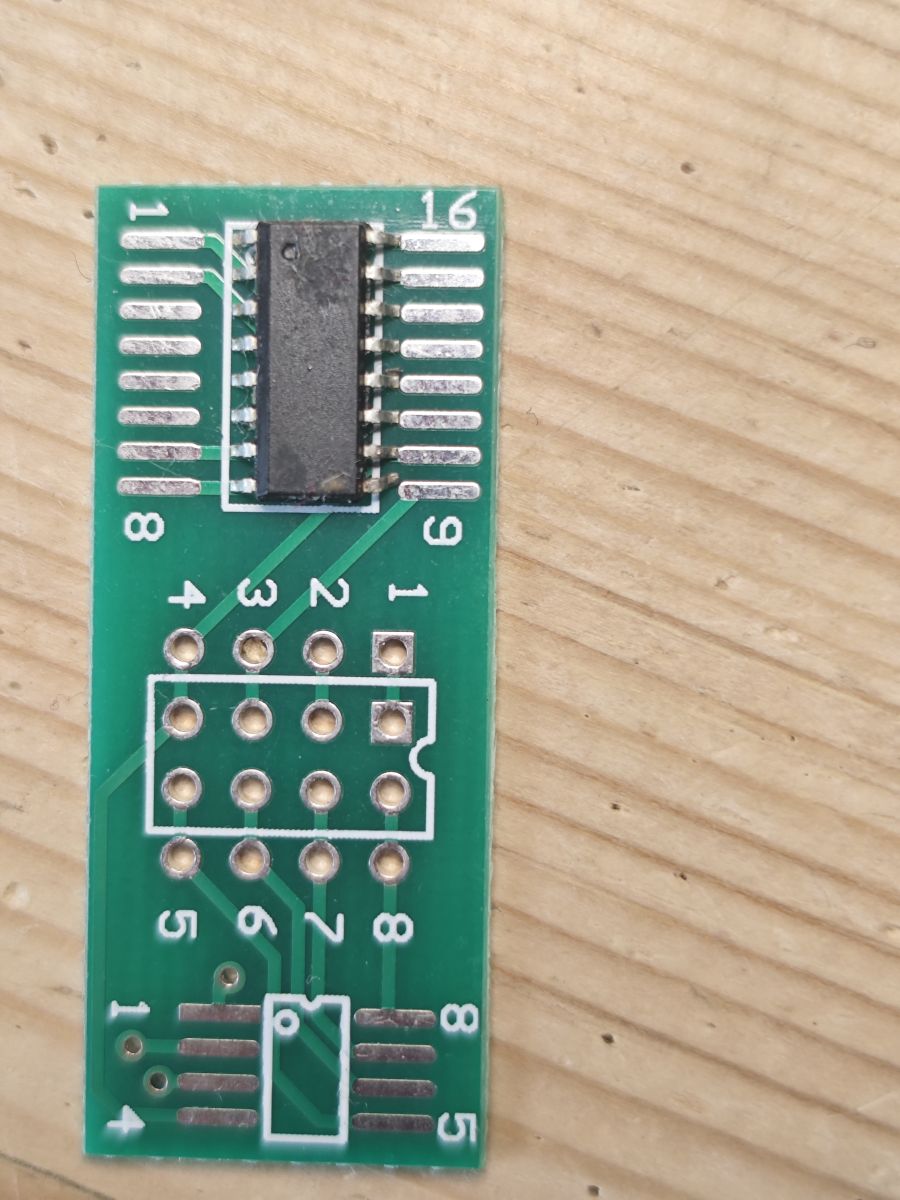

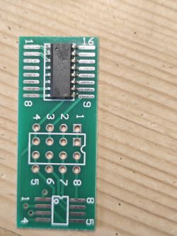

    so I hope to check if these unmarked TuyaMCUs really are Padauk chips and if they can be read with this burning tool later today or tomorrow.
    Added after 4 [hours] 56 [minutes]:
    trouble is, I don't have a SOP16 adaptor thing. this is the closest I have from CH341A kit.

  • #29 21908571
    Posts: 5062
    Help: 438
    Rate: 893
    beginning to think these SOP16s are not Padauk :(
    continuity confirmed between seated TuyaMCU through to the Lite r1 headers. Tried 2x TuyaMCU. Programmer is detected OK.
    Same on Ubuntu + Windows.
    The only thing I don't have is a real Padauk IC to try. Seller did test programmer before shipment though.
    Close-up of a black SOP8/16 test socket on a PCB against a blue background
  • #30 21909319
    Posts: 14620
    Help: 655
    Rate: 12635
    Oh no... but GND/VDD footprint was matching? Maybe it's a time to get Padauk to try. Aren't they dirt chip?
