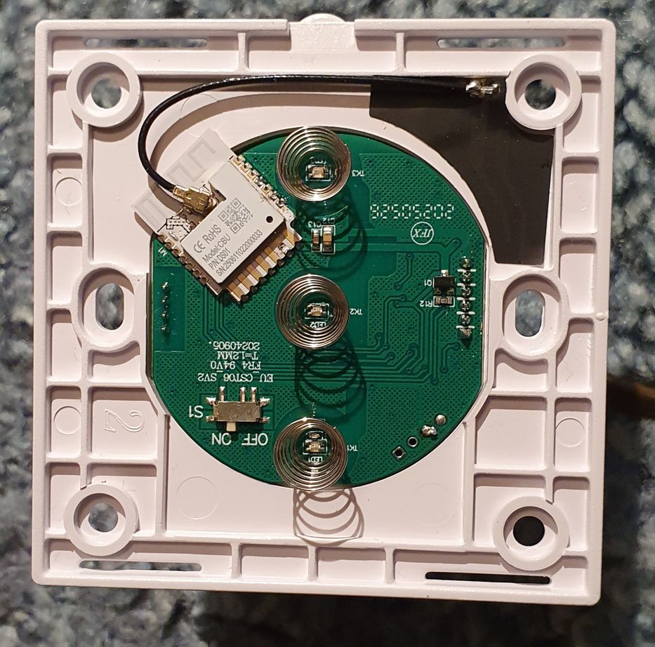

    lhakanl
    Posts: 10
    This is a WF-DS01 Touch Wall Dimmer, BK7231N-based.
    All my earlier (several years old) WF-DS01:s are ESP8266-based.
    Most things seem to work, however not dimming via command in console or via mqtt.
    The power command works as expected.
    The local touch buttons also work. And both local dimming and power produces mqtt output.
    The somewhat strange thing is that "led_dimming/get" is used in the mqtt output when dimming and just "1/get" when powering on/off.
    Also "led_dimming" seem to imply that DC PWM should be used ? (allthough this is an AC Triac dimmer).
    When sending the dimmer command, no tuya activity is detected in the log (except for heartbeat).
    I assume that there is some configuration that I have missed or done wrong ??

    In the config, "Pin Settings:" are blank,.
    "Channel types:" are "1: Toggle" and "2:Dimmer". All other are "Default".

  • TuyaMCU dimmer needs separate command handling
    #2 21809428
    Posts: 14771
    Rate: 12914
    Thank you for reporting the issue.
    This is because our TuyaMCU dimmer resides outside core LED dimmer. Here's self test:
    https://github.com/openshwprojects/OpenBK7231T_App/pull/1947
    Now, the question is, how do we fix it? Would it be enough to detect TuyaMCU in Dimmer command and forward it there? Or shall whole LED driver be made tuyamcu-aware...
    Maybe something like tuyaMCU_setupLED but for single color? Maybe I could try making tuyaMCU_setupDimmer?
