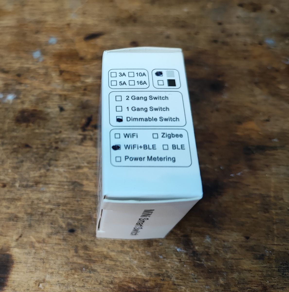

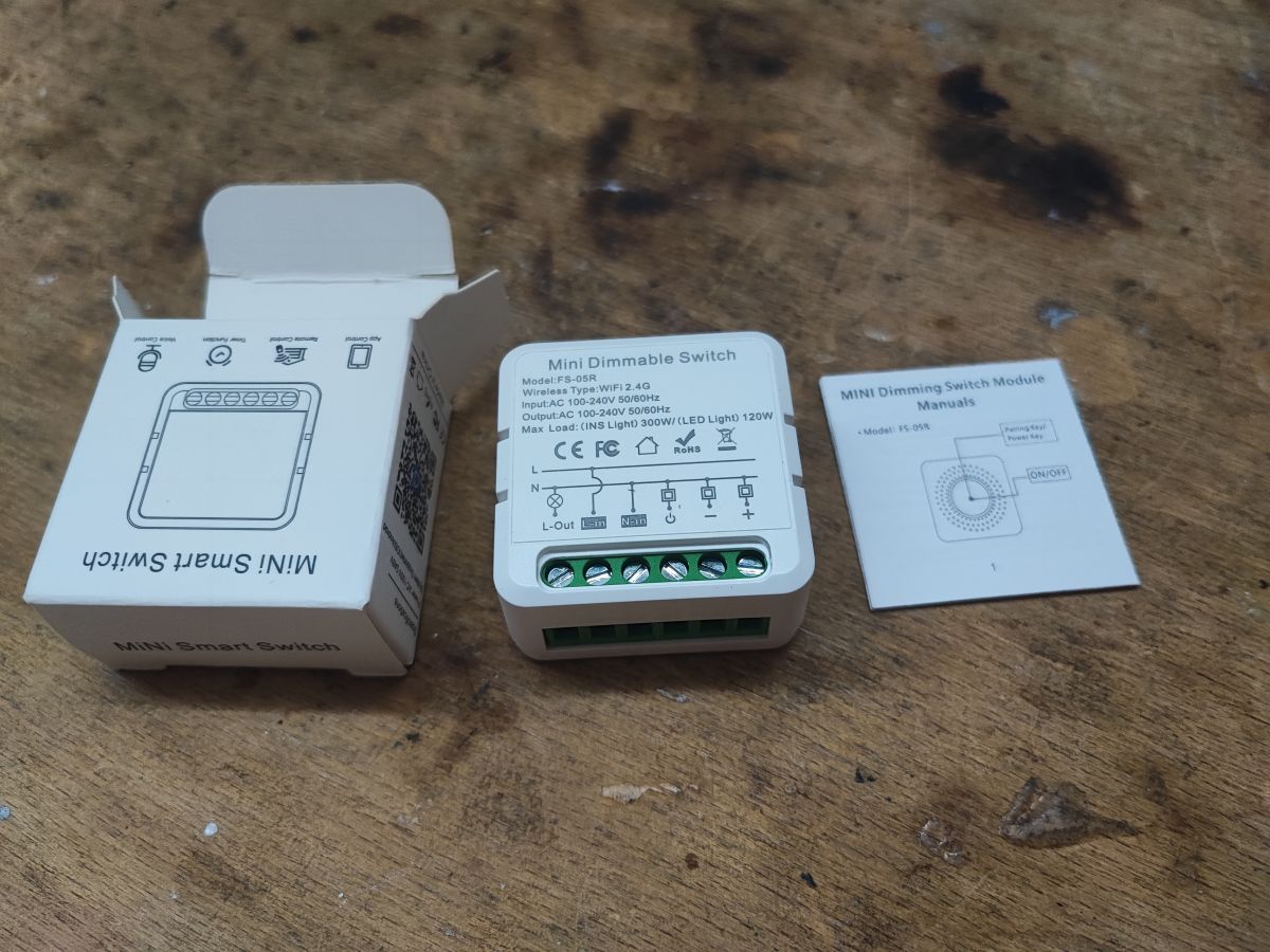

    The work got stuck, so the reader sent me the equipment so I could examine it myself:
    Side of the Tuya FS-05R dimmer packaging with feature markings. MiNi Smart Switch box on a wooden table
    Mini dimmer module FS-05R with packaging and instructions on a wooden table.
    Instruction:
    MNINI FS-05R dimming switch module manual Instruction manual for the Tuya FS-05R dimmer Tuya app operation instructions shown on an unfolded leaflet, depicting various device control screens. User manual for smart modules with Bluetooth and Zigbee functions.
    Thank you for sending me the equipment! Time for analysis.

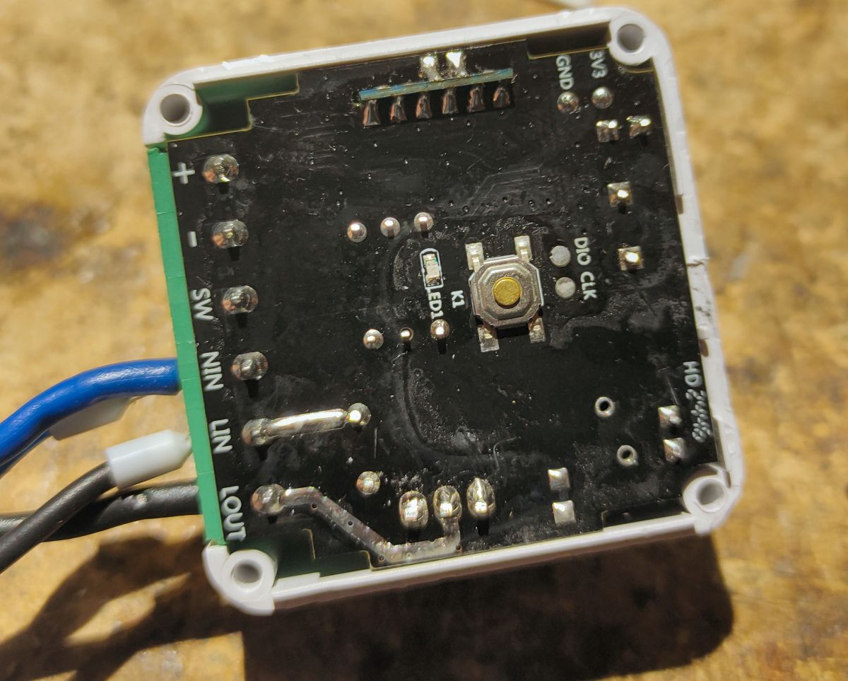

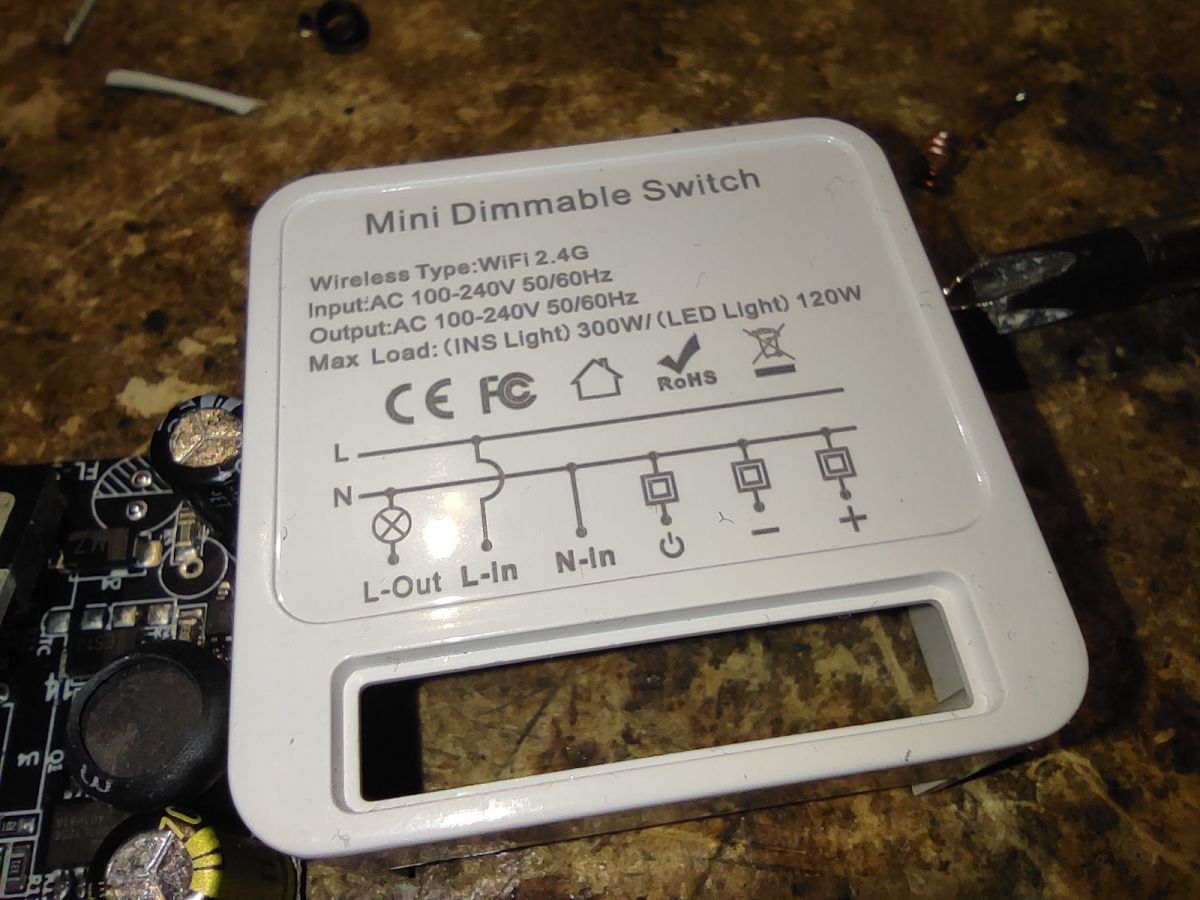

    Interior of the FS-05R

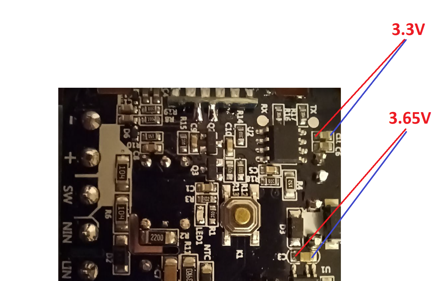

    The first thing that catches your eye after looking inside is: invalid CB2S description layer : :
    Close-up of a blue PCB with a green screw terminal block and visible silkscreen showing pins.
    Location of 3.3V (VDD) and GND is incorrect .
    I`ve checked it many times, and it`s not the first time I`ve come across a poorly described CB2S, and I know that the correct schedule is available on the Tuya website:
    Pin layout diagram with dimensions for an electronic module.

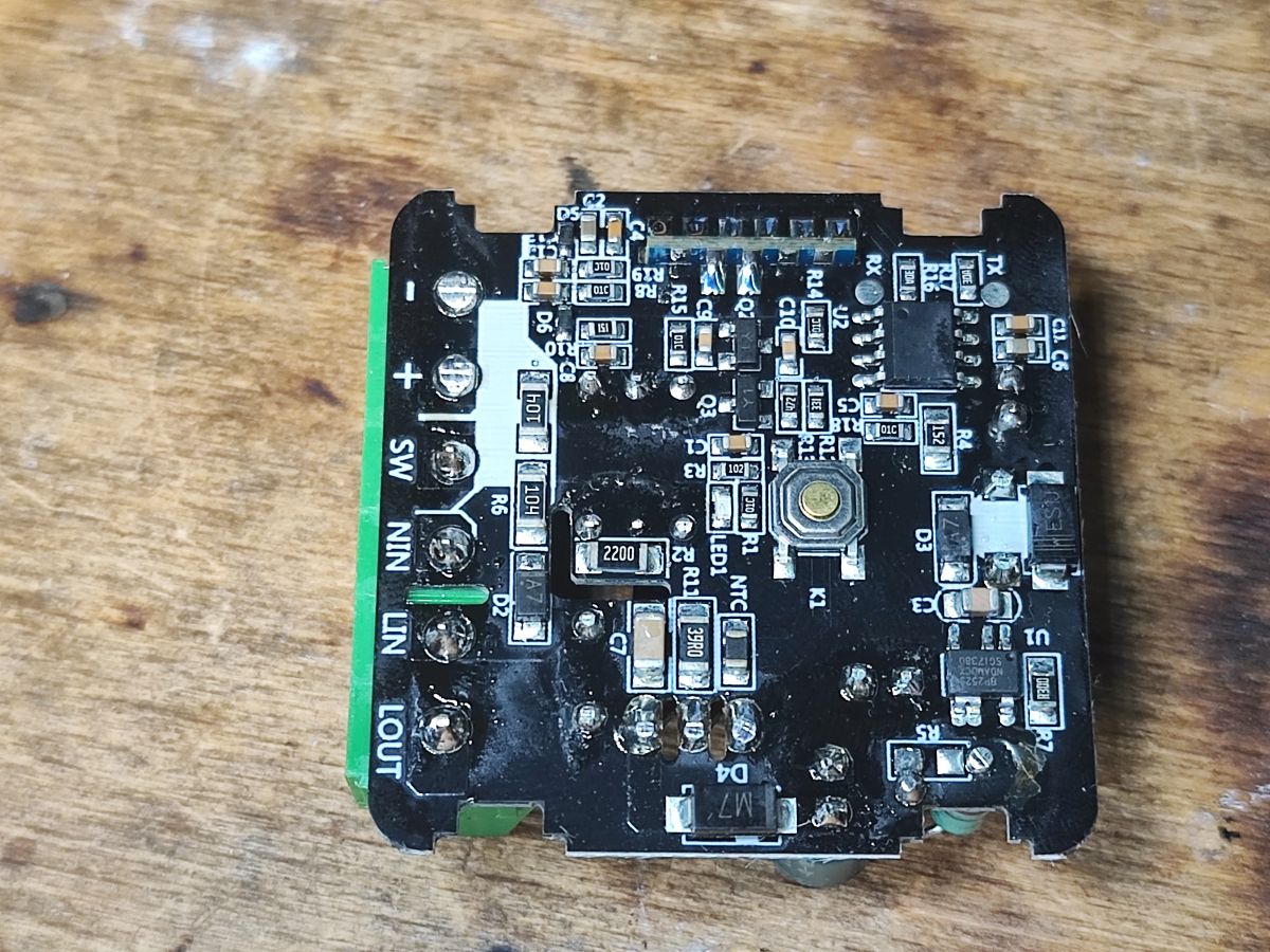

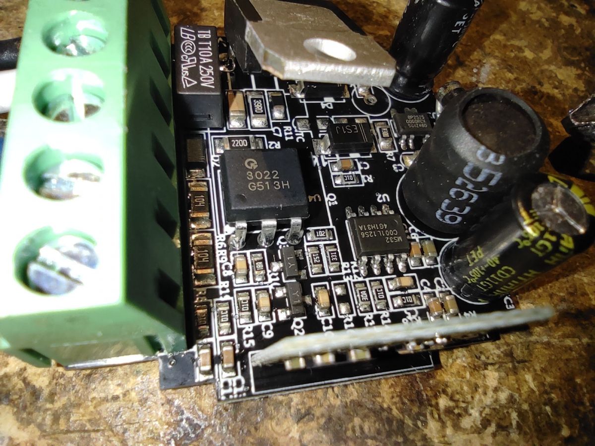

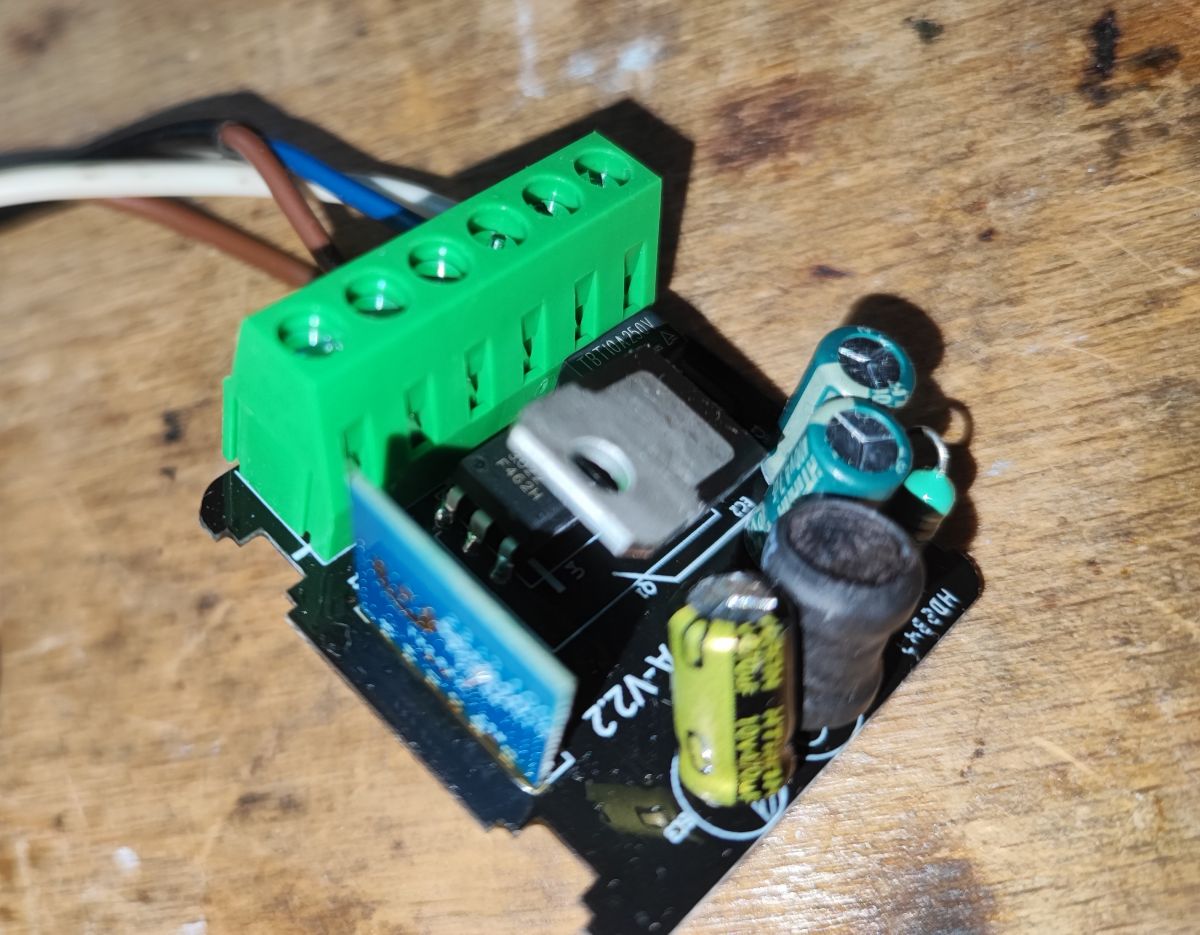

    Plus - here`s the interior:
    Interior of the Tuya FS-05R dimmer showing electronic components on the PCB.
    Here we have a non-isolated step down converter which, interestingly, directly powers the microcontroller itself. There is no additional LDO AMS1117-3.3V here, as is usually the case.
    Additionally, you can see that the CB2S WiFi module is connected to the element in the SOIC8 housing via RX and TX lines.

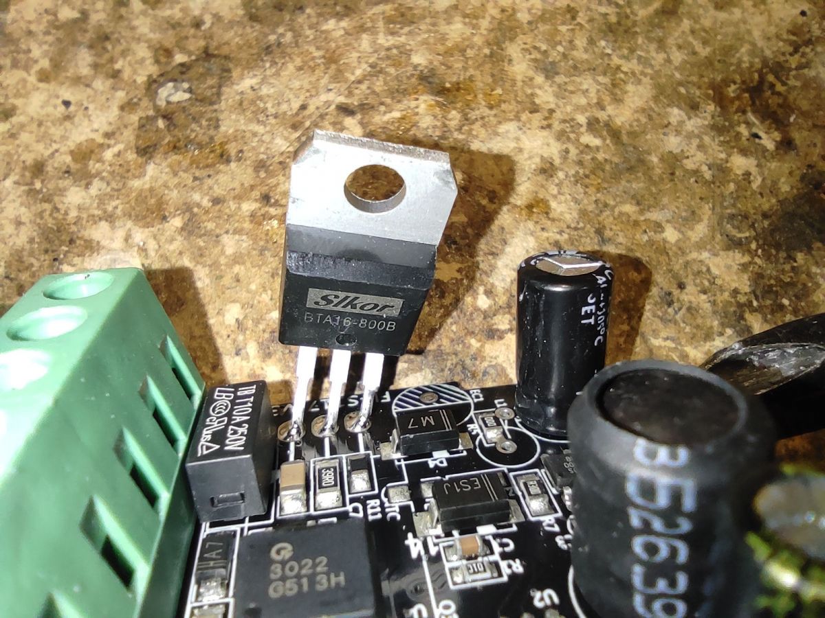

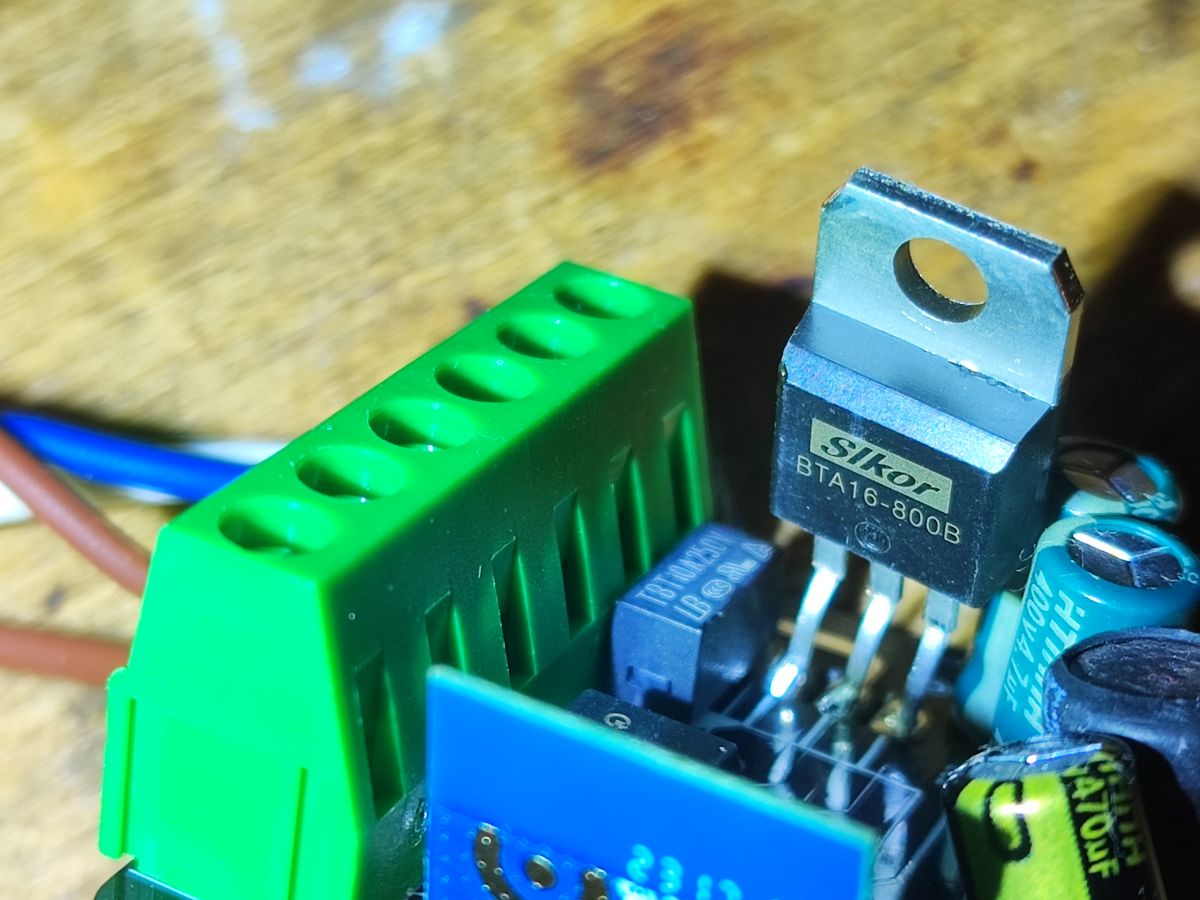

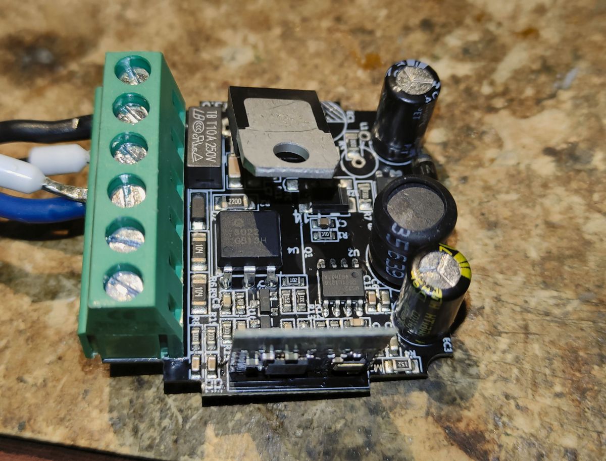

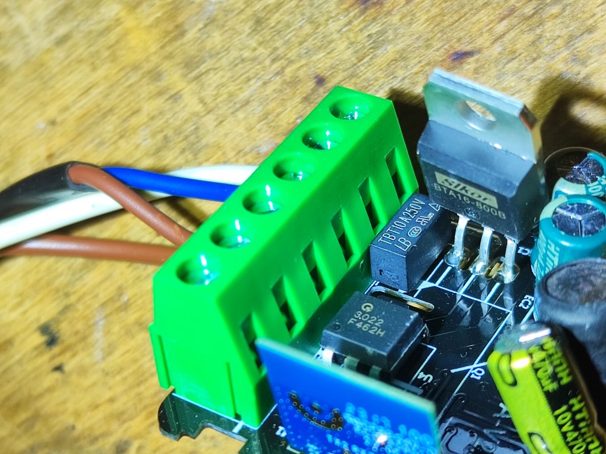

    Now the view from above:
    Close-up of Slkor BTA16-800B triac and green terminal block PCB with electronic components including capacitors and a green screw terminal block. Close-up of a circuit with a BTA16-800B triac and capacitors on a PCB
    Dimming is performed on the BTA16-800B triac, which is controlled by 3022 F462H.

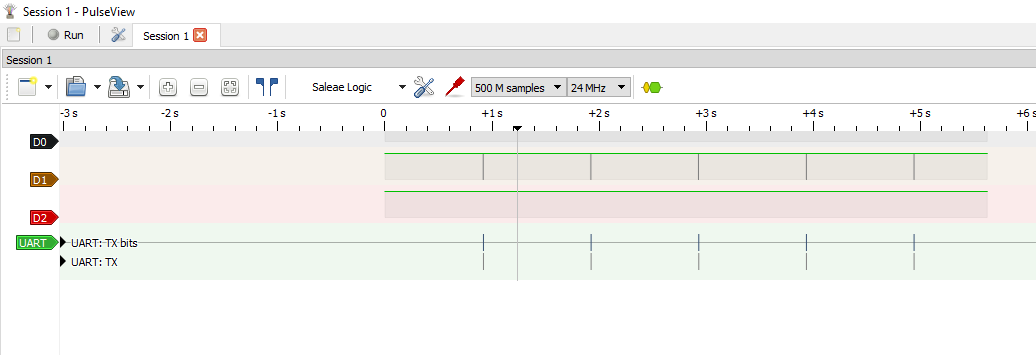

    Interception of FS-05R communication
    I decided on a method based on the Sigrok analyzer, similarly to the one above this topic .
    Normally there would be a problem here, because you cannot connect the analyzer to a system powered from the mains, you would have to use special opto-isolation systems/modules, but I powered the whole thing from 3.3V and the arrangement started anyway:
    Interior of an electronic circuit with voltage labels

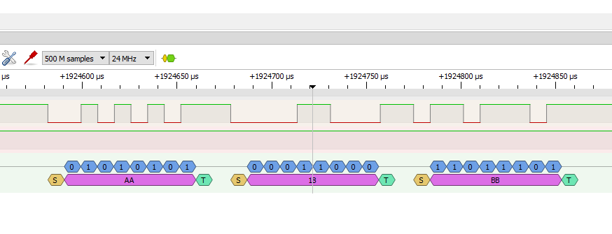

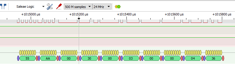

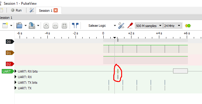

    Here is the traffic on TX/RX:
    UART signal measurements in PulseView

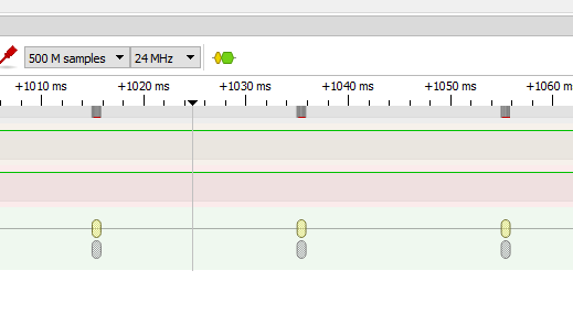

    While the MCU is idle, it sends something to us...

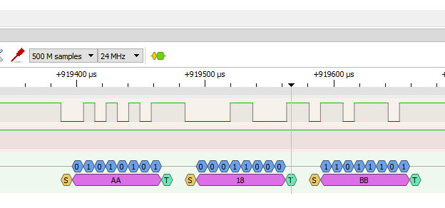

    Screenshot of protocol analyzer with UART signals
    View of captured UART protocol on a logic analyzer
    Screenshot of UART signal analysis using Saleae Logic.
    It sends three bytes with the AA header, which I associate with the BL0942 protocol. This is not TuyaMCU.
    But what happens when we press the button?
    Screenshot from PulseView showing UART data.
    When you press the button, the WiFi module sends something to the MCU:
    Screenshot of UART signal analysis in a logic analyzer.

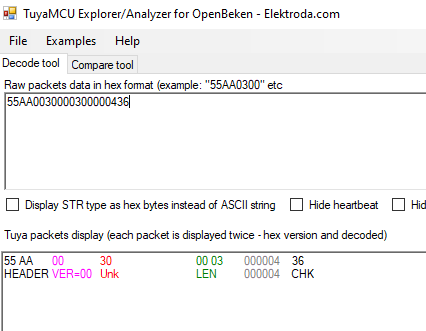

    Wait, heading 55 AA? This looks like TuyaMCU though! This protocol must be some simplified version of it.
    Screenshot from a logic analyzer showing UART data.
    Let`s see what mine says TuyaMCU analyzer
    TuyaMCU Explorer application interface displaying raw packet data in hex format.
    This is a TuyaMCU compatible package , even the checksum is calculated correctly.
    I collected some of these packages and noticed that second and third bytes payload changes when I press the button - maybe the brightness levels?

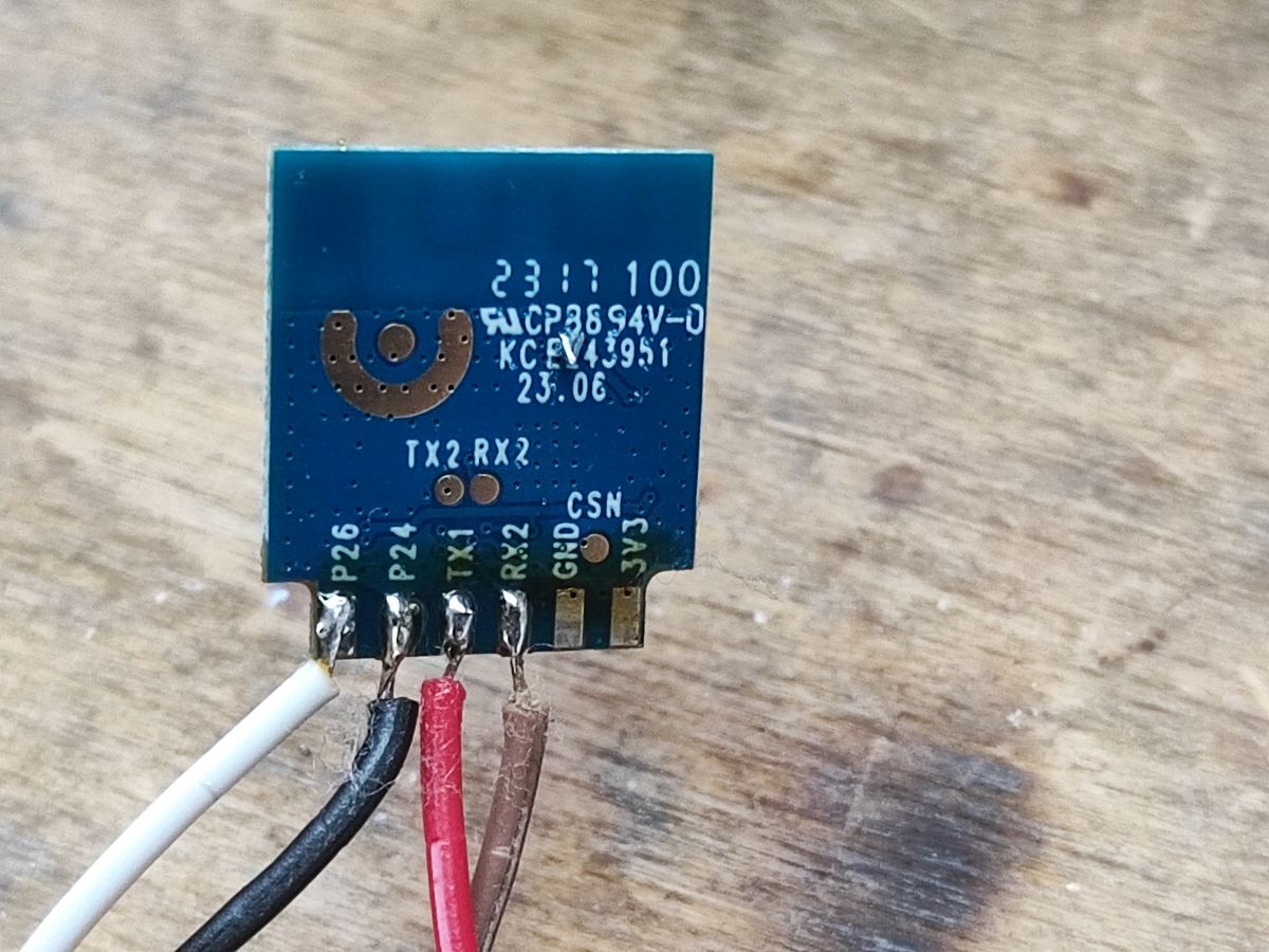

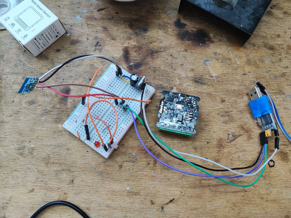

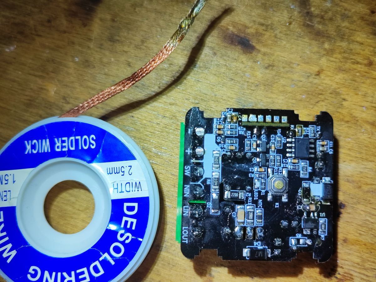

    CB2S communicates with the MCU via the UART port used for programming, so you need to desolder CB2S. You need flux and braid.
    FS-05R dimmer circuit board next to solder wick
    I program with my flasher:
    Desoldered, cables need to be connected ignoring the descriptive layer, looking at the catalog note : :
    Electronic module with connected wires on a wooden surface.
    Whole system:
    Breadboard with connected electronic equipment on a desk
    After uploading, we solder the module into place.

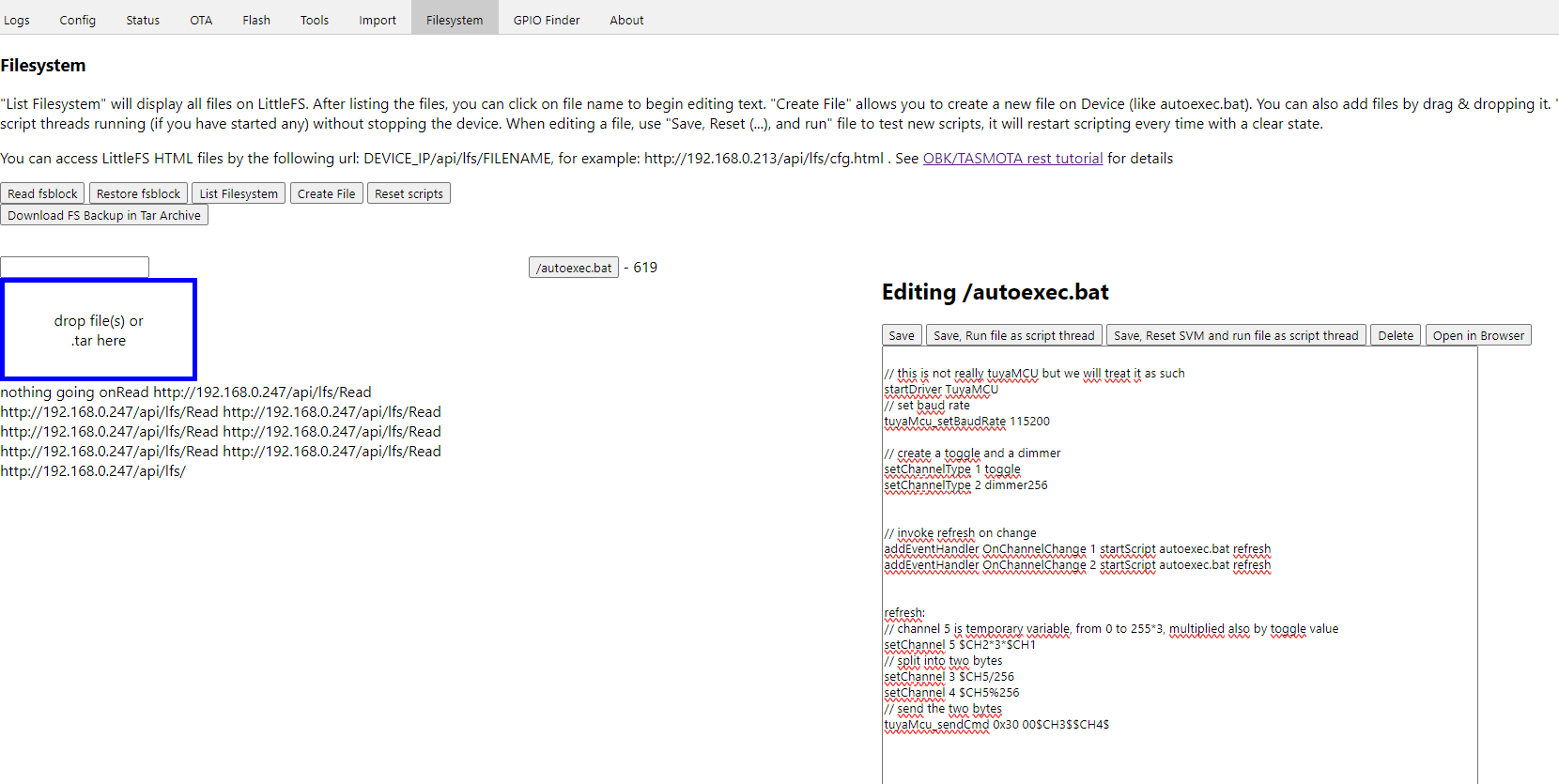

    Now it`s time to turn this proof of concept demo into something functional .

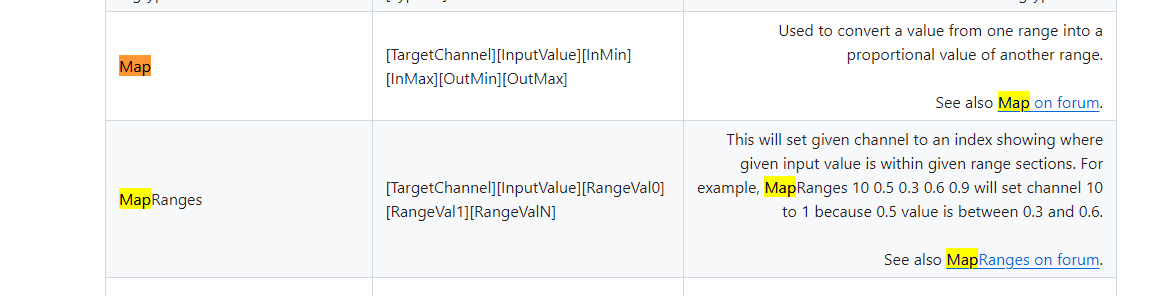

    OBK allows you to define channel types and create simple scripts, you can read about it in the documentation:
    https://github.com/openshwprojects/OpenBK7231T_App/tree/main/docs
    Based on this, I prepared the following script:
    // this is not really tuyaMCU but we will treat it as such
    startDriver TuyaMCU
    // set baud rate
    tuyaMcu_setBaudRate 115200
    // create a toggle and a dimmer
    setChannelType 1 toggle
    setChannelType 2 dimmer256
    // invoke refresh on change
    addEventHandler OnChannelChange 1 startScript autoexec.bat refresh
    addEventHandler OnChannelChange 2 startScript autoexec.bat refresh
    refresh:
    // channel 5 is temporary variable, from 0 to 255*3, multiplied also by toggle value
    setChannel 5 $CH2*3*$CH1
    // split into two bytes
    setChannel 3 $CH5/256
    setChannel 4 $CH5%256
    // send the two bytes
    tuyaMcu_sendCmd 0x30 00$CH3$$CH4$
    This script creates a dimmer controller on foot that supports both turning it on and off, as well as changing the brightness level. The brightness level is remembered after turning it off and on. It`s all about the scripts. The brightness level is manually split into two bytes and sent in the packet already discussed.

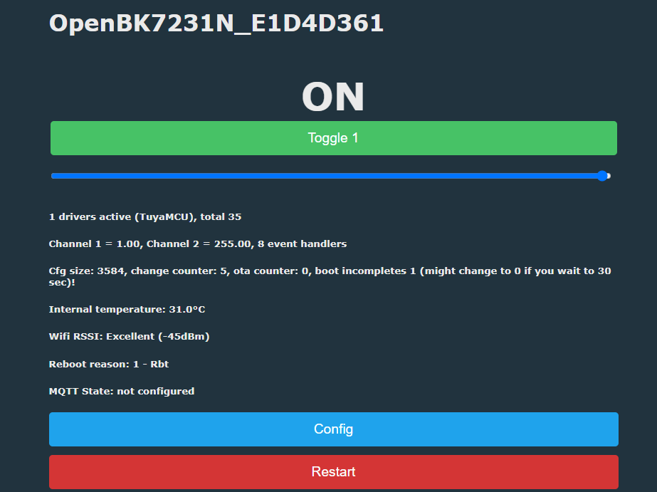

    And on the panel:
    OpenBK7231N dimmer control panel.
    Thanks to the new Home Assistant Discovery system, a dimmer scripted in this way will be seen automatically by HA, without writing Yaml!

    As for the mapping, I think we have a command for that. It may require some script trickery but here it is:
    Table showing the syntax for Map and MapRanges commands from documentation.
    I guess you will need to introduce a third channel a temporary variable for that to work.

    I am currently playing with this dimmer and have a problem.
    It is also the FS-05R version, although there is no model designation on the housing and there are minimal differences in the position of the components on the PCB. For that, the markings on the CB2S are also reversed.
    To the point, I've uploaded OpenBK there and created an Autoexec.bat file with that ready-made script given in the first message. It seemingly works, i.e. I have a brightness slider and a button, but it doesn't respond every time. For a few clicks on the button it turns the connected bulb on/off, then for a few clicks it doesn't respond. It's the same with the brightness slider, a few slides work, then a few don't. I haven't noticed any rule so far.
    Any ideas what could be the cause?
    Added after 6 [hours] 28 [minutes]: .
    Here's some more pictures of this dimmer of mine.
    View of the lighting dimmer circuit board. .
    Dimmer circuit board with electronic components .
    Photo of an electronic dimmer circuit board with various components. .
    Close-up of a dimmer circuit board with visible markings on components. .
    White plastic mini dimmable switch with technical specifications. .
    And a video of how he behaves:
    I have the flags enabled 2,7,10,37. With MQTT not connected for now.

    And autoexec.bat with this entry:
    startDriver TuyaMCU
    // set baud rate
    refresh:
    And also the ripped original batch with the location where the wifi password was stored reset to zero:

    And would you be able to power it with 5V from USB, unplug it from the mains and capture with the UART what it sends?
  • #28 21485568
    @GUTEK@
    Posts: 1561
    Help: 163
    Rate: 367
    Rather 3.3V instead of 5V was it supposed to be? From what I can see from the BP2525 catalogue note it is in 3.3V mode there.
    I managed to capture something via Realterm. I am uploading in the attachment.
    sciemniac..ump.7z (1.47 kB)You must be logged in to download this attachment. .
  • #29 21486931
    @GUTEK@
    Posts: 1561
    Help: 163
    Rate: 367
    While I still have it connected to the terminal, I have loaded OpenBK and I see that every few seconds it sends 55 AA 00 00 00 00 FF, all the time as it is running. Is this by any chance somehow "clogging up" this TuyaMCU chip?
    Added after 1 [hour] 14 [minutes]: .
    Okay, that will be 99% the heartbeat sent.
    I did a test like this:
    I initialised only the uart, instead of the tuyamcu driver:
    uartInit 115200
    then I alternated sending commands:
    uartSendHex 55AA0030000300000032
    uartSendHex 55AA003000030003E81D
    and each time it responded.
    Is there any way to disable the heartbeat, as I have not found anything in the documentation so far?
  • #30 21487134
    Posts: 14612
    Help: 655
    Rate: 12629
    Well done on diagnosing the problem and suggesting a fix. I'll try to add a flag or switch for this. Maybe it's also possible to "cheat the system" and type startDriver tmSensor into the autoexec bat too, but I haven't tried that.
