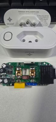

    Ekaza Smart Plug Power Monitoring 20A Module T1-S2-NL
    BK7238 T1
    To get work
    Connect
    3.3
    GND
    RX
    TX
    CEN to GND
    When press ready backup, take out 3.3 and put again. Its work for me
    Or leave CEN connected and when ask for CEN remove it.
    both method works for me

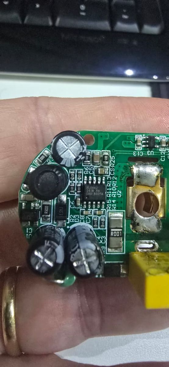

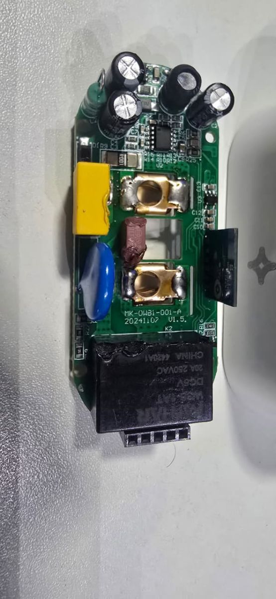

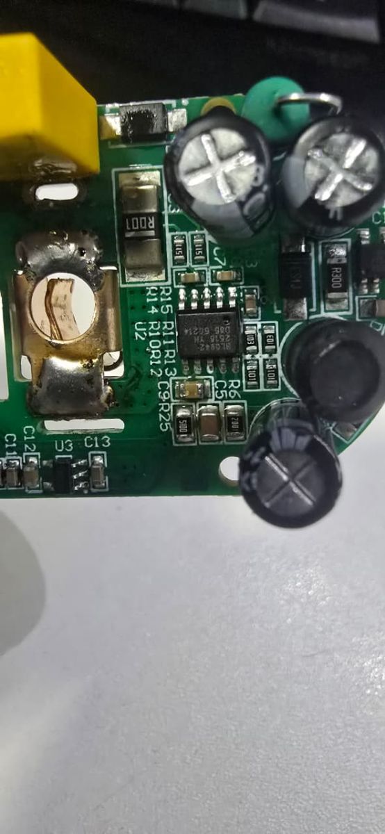

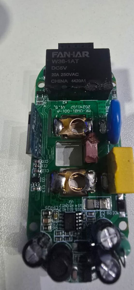

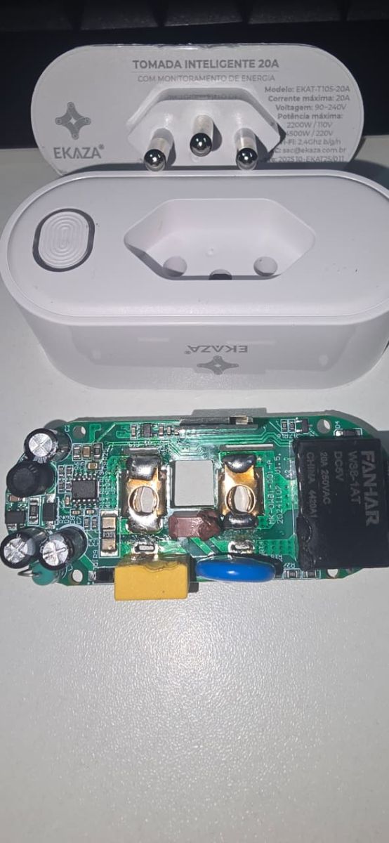

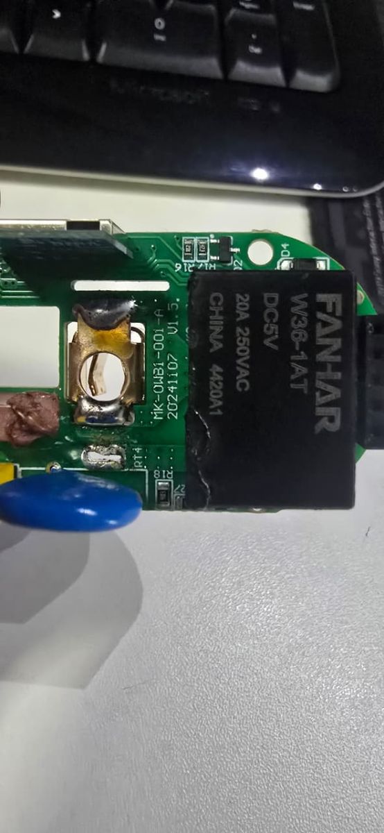

    PCB with FANHAR W36-1AT relay, terminal block, and surface-mount components Disassembled EKAZA smart plug with exposed internal electronics EKAZA smart plug 20A and its internal circuit board Close-up of damaged PCB with capacitors and electronic components Close-up of a damaged circuit board with capacitors, resistors, and burned area. Close-up of a circuit board with FANHAR relay and electronic components PCB with electronic components including capacitors and a black relay.
    White EKAZA smart plug with three prongs and technical specifications on the back

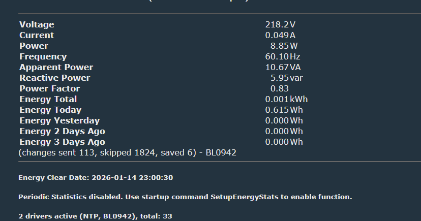

    Added after 8 [minutes]:
    Screenshot of electrical energy usage data from BL0942 monitoring device
    One thing its weird
    Chip temperature: 91.1°C, its too high and I'm with the socket open and the AC in the room
    I check the chip with my finger and its cold
    #2 21809156
    insmod
    Posts: 1397
    Help: 164
    Rate: 436
    Temperature is currently uncalibrated, the cooler it is, the higher is reported temperature.
