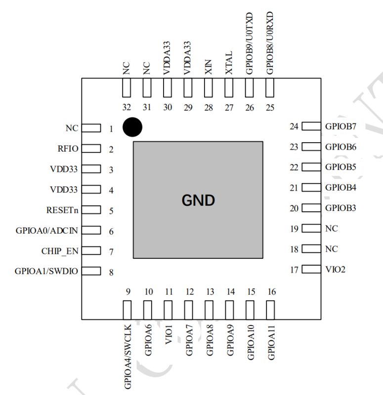

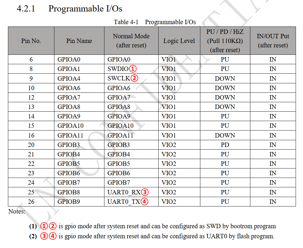

    Quick ref:
    A10 grounded at power-on - download mode
    Flash program B8 - U0RXD, B9 - U0TXD
    B6 - U1RX, B7 - U1TX
    Pinout diagram of the LN8825B IC with labeled pins and central GND marking
    LN8825 programmable I/O table showing GPIO, logic levels, and default directions

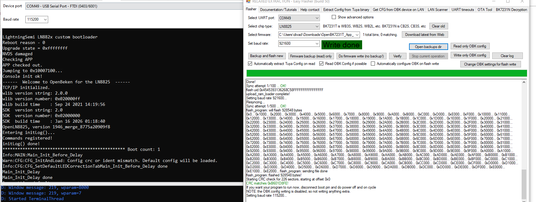

    OpenLN8825 boot log

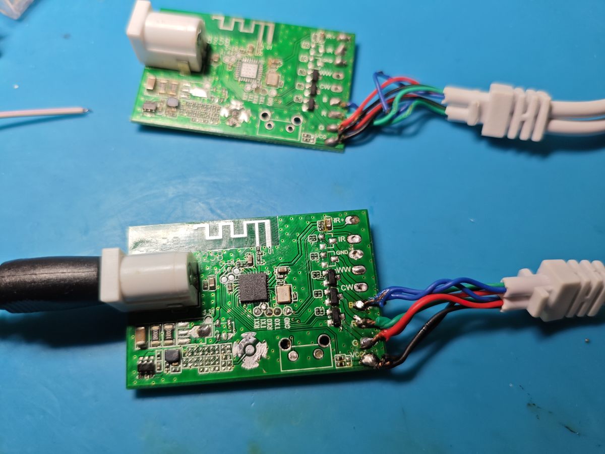

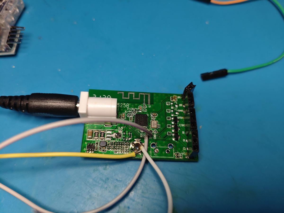

    omg. one of the 3 LN8825B Tuya RGB controllers I've owned over the last 2 years IS still viable. I thought I'd killed them all
    Terminal showing LN8825 OpenBeken boot logs and Easy Flasher interface with flash status
    LN8825 electronic module with connected wires on blue mat
    Added after 9 [hours] 29 [minutes]:
    soldered and cleaned back up ready for PWM test. need to go out for a bit. coloured cables didn't match PCB marking from factory, so kept that.

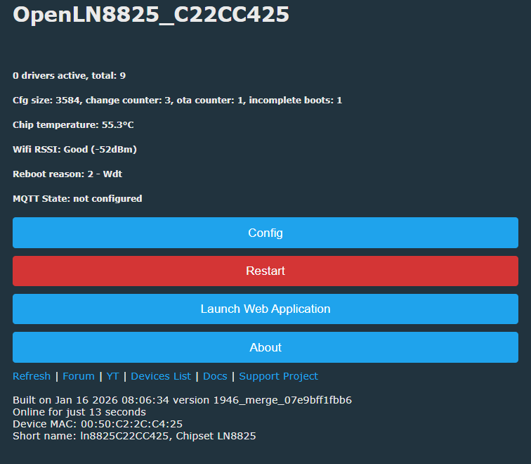

    OTA 1946_merge_8775a20909f8 -> 1946_merge_07e9bff1fbb6 ✅
    OpenLN8825 device web panel with system status and control buttons Two PCB boards with Wi-Fi modules and wires soldered to labeled pins
    looks like IR has resistors and capacitor too so could try that out. could bridge resistors on CW and WW too I guess for other IO use
    Added after 3 [hours] 10 [minutes]:
    well, LLM was correct with these IOs being in use on this device (not from KV extraction). With my 3-pin strip I immediately get R, G and B to match:
    R=A11, G=A8, B=A7
    but only if I use GPIO dr to pull each high. As PWM the colours don't change much, even with LED tools. Power on/off button is not effective - the colours change a little instead.
    Added after 11 [hours] 1 [minutes]:
    1946_merge_07e9bff1fbb6 -> 1946_merge_4e2cdfd460bc ✅
    PWM looks good now! dimmer too

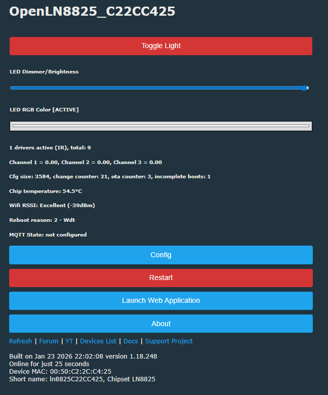

    LN8825B OTA listing
    Screenshot of an LN8825 OTA page with Reboot button, OTA file selector, GitHub download link, and “Drop OTA file here” box.
    OTA to release worked
    Screenshot of OpenLN8825 web UI with Toggle Light, Config and Restart buttons and a brightness slider
