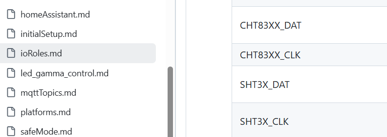

    - updating docs, etc, docs page for variants
    etc, etc.
    The rule of thumb should be making firmware more user friendly, so if we can allow users changing pins at runtime at the cost of few cpu cycles, then let it be.

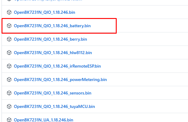

    We also now have a build for battery powered devices (variant) with short startup time, maybe some of @protectivedad fixes can be enabled there? Just please, be careful, don't enable risky things in main release, we can't just go around bricking people's devices. I already saw how removing startup delay for Beken breaks SOME of user devices while other devices are working good.
    This is the battery variant I mention:
    How to Implement PIN_FindPinIndexForRole_new() Function in OpenBeken for Pin Management
    but we need docs for that... variants.md page?

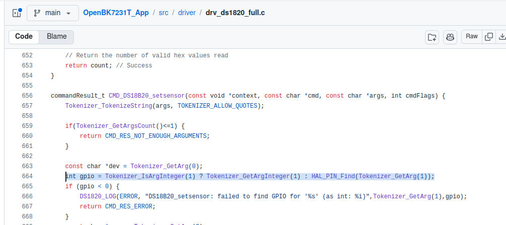

    Since there already is "Tokenizer_GetPin()" maybe we can just check for the argument being an int like
    int Tokenizer_GetPin(int i, int def) {
       int r;
       if (g_numArgs <= i) {
          return def;
    //   return HAL_PIN_Find(g_args[i]);
       return Tokenizer_IsArgInteger(g_args[i]) ? Tokenizer_GetArgInteger(g_args[g_args[i]]) : HAL_PIN_Find(Tokenizer_GetArg(g_args[i]));
    so it would work for an argument for pins as int or alias.
    Or did you mean "expand existing drivers" to use this?

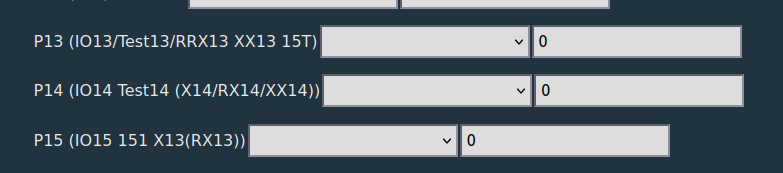

    For now I did step one:
    Moved the code to generic (hal_pins_generic.c) and removed it for the few platforms which already had it implemented.
    Made the call case insensitive (by introducing a new, case insensitive version of strstr() in new_common): "char *wal_stristr(const char *haystack, const char *needle);"
    I had to include the src\hal\generic\hal_pins_generic.c in Windows build, too, but to hide all the weak functions there for Windows build - compiler threw errors).
    I also enabled TEST for all platforms, which needed some changes for ESPDIF platforms (comment out recursive stack-overflow-test).
    I think it's now o.k. to test the platforms I don't own to do some tests with command "getPin <alias>" to find out if it's working as expected.
    Maybe @divadiow would be so kind?
    just try out if the command "getPin <ailas>" works (returning the correct pin index) on the platform.
    Maybe also try some "errors" (asking for non-existing pins or only parts (even if there is TX1, the command "getPin Tx" should return -1 because it's no full match.
    Especially the platforms with multiple aliases per pin should work with all names for a pin that's why for testing I made these funny pins for windows:

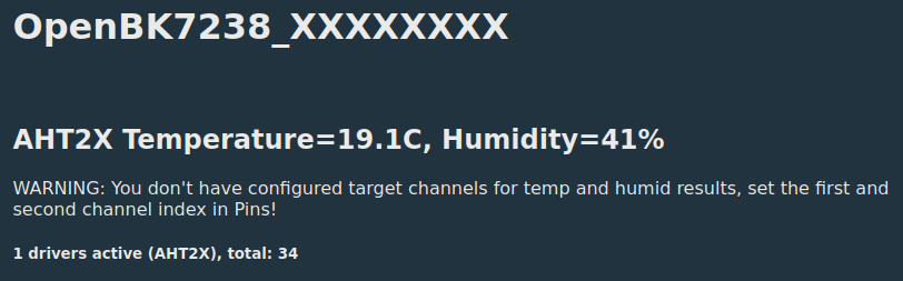

    Sadly I only own DS3231 and AHT2X from the list of devices using pin definition from "startdriver", so I can only confirm some few configuration.
    As an example BK7238 with AHT2X:
    Debug:CMD:cmd [startdriver aht2x PWM1 pwm2]
    Debug:CMD:Tokenizer_GetPin: Argument 1 (PWM1) - Returning index 7
    Debug:CMD:Tokenizer_GetPin: Argument 2 (pwm2) - Returning index 8
    Debug:CMD:Adding command SoftI2C_SetClkPeriod
    Debug:CMD:Adding command AHT2X_Calibrate
    Debug:CMD:Adding command AHT2X_Cycle
    Debug:CMD:Adding command AHT2X_Measure
    Debug:CMD:Adding command AHT2X_Reinit
    Info:CMD:[WebApp Cmd 'startdriver aht2x PWM2 pwm1' Result] OK
    Screenshot of OpenBK7238 web interface showing AHT2X temperature and humidity data

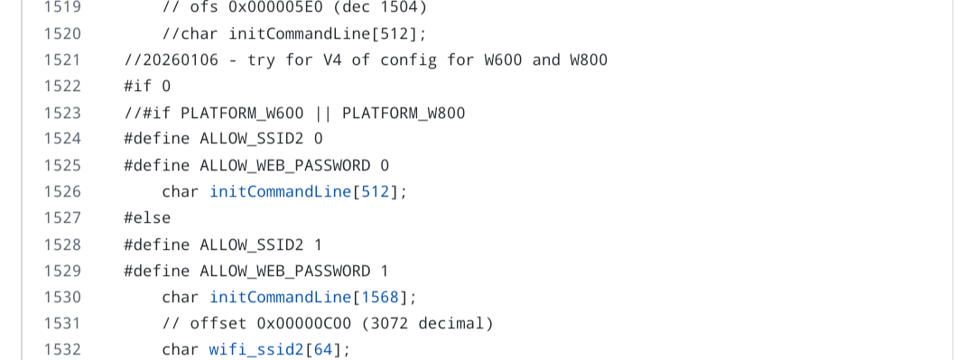

    Maybe you could take a look at PR#1936?
    For some time now we have restrictions on W600/W800 because newer (bigger) configs didn't work.
    If I'm not mistaken this was a quite "simple" issue (we overwrote config with flashvars when expanding config size).
    W800 and W600 tested o.k. by @divadiow and me.

    C source code snippet with macro definitions and character array declarations
    I didn't check if it will "survive", but I expect it
  • Flags persist across reboot and OTA on W600

    If it's not too much:
    Will startup command line from release be present after changing to new version?
    All other values of config are untouched, but this will start at the same address but be larger with new version...
    Thank you for your help!

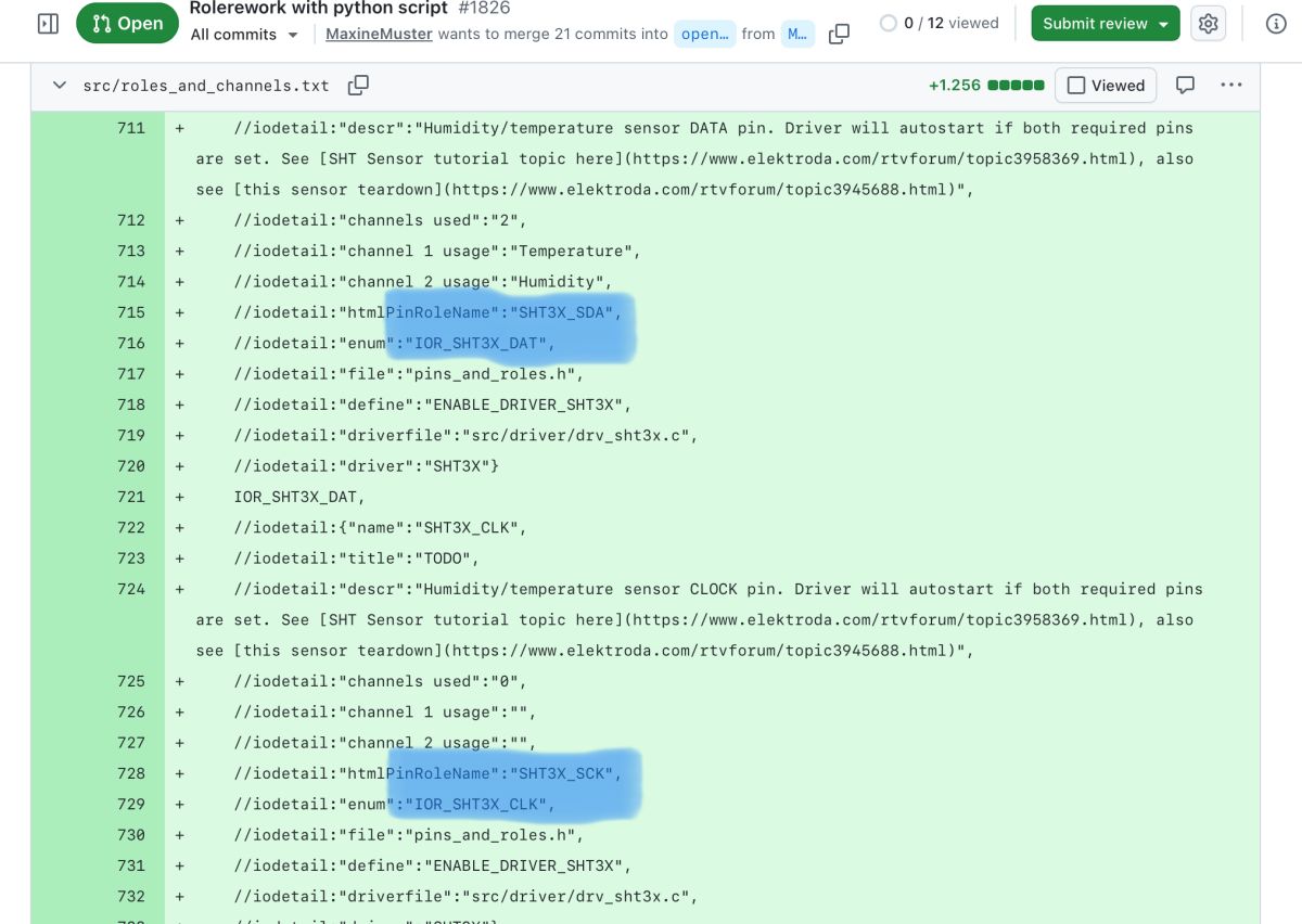

    #20 21862536
    Posts: 5236
    Help: 449
    Rate: 918
    on the subject of pins and aliases and stuff, further to this post https://www.elektroda.com/rtvforum/topic4130528-30.html#21862513, there are a couple of other oddities
    Editor screenshot: Markdown file list on the left and a table with signal names on the right.
    Screenshot showing “Bad argument” error and command line: SetPinRole 24 SHT3X_CLK
    Screen fragment showing “OK” and the command “SetPinRole 24 SHT3X_SCK”.
    eg
    SetPinRole x SHT3X_CLK
    fails because parser expects SHT3X_SCK
    SetPinRole x CHT83XX_DAT
    fails because parser expects CHT83XX_SDA
    SetPinRole x HLW8112_SCSN
    fails because parser expects HLW_8112_SCSN
    so should these canonical names be added to PIN_ParsePinRoleName()?
    CHT83XX_DAT
    CHT83XX_CLK
    SHT3X_DAT
    SHT3X_CLK
    HLW8112_SCSN
  • #21 21862564
    max4elektroda
    Posts: 758
    Help: 49
    Rate: 189
    That's one point I always said: much easier to find, if all this information is not spread over several files...
    GitHub diff view showing roles_and_channels.txt with green added lines and highlighted SHT3X entries
