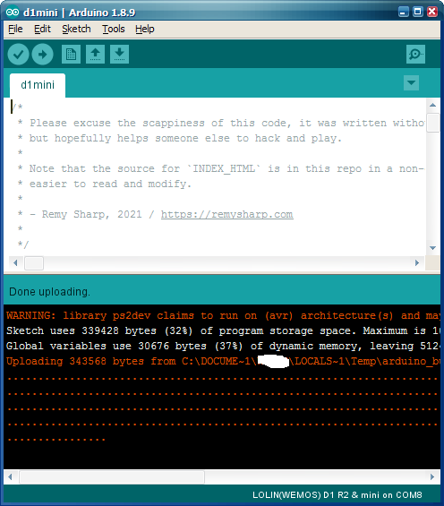

    When uploading, the blue LED is on, in ArduinoIDE you can see that it has compiled (with a warning) and is uploading:
    Screenshot of ArduinoIDE 1.8.9 showing uploaded sketch and upload completion message.
    When I connect WeMOS to USB, the blue diode flashes once and in a moment in Windows I can see the Wifi network ESP-cipheres Unsecured
    In the sketch I gave my Wifi network name, password and IP of my network but I don't see any device at the specified IP address on the local network.
    What is wrong?

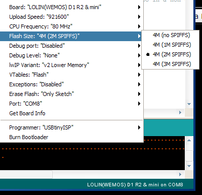

    What Flash Size should be selected in ArduinoIDE ? I think it programs on each, or is it indifferent to what is selected ?
    Screenshot of Flash Size settings for WeMOS D1 mini in Arduino IDE
    Added after 9 [minutes]:
    Here someone wrote that setting Flash Size 4M (1M SPIFFTS) helped:
    https://www.elektroda.pl/rtvforum/topic3695403.html#18706362
    It compiles, uploads, but doesn't do the job and I don't know what's going on.

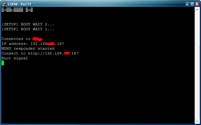

    OK, the hidden wifi network is to blame. I disabled SSID hiding in the router and now it works.
    Just the IP address doesn't match the one in the sketch? In the sketch I've given a suffix of 160 and WeMOS is connected at an address with a suffix of 167 - why is that?
    Screenshot of browser and text editor showing different IP addresses
    Does WeMOS support hidden Wifi or not ?
    PuTTY window showing WeMOS D1 mini connection and assigned IP address

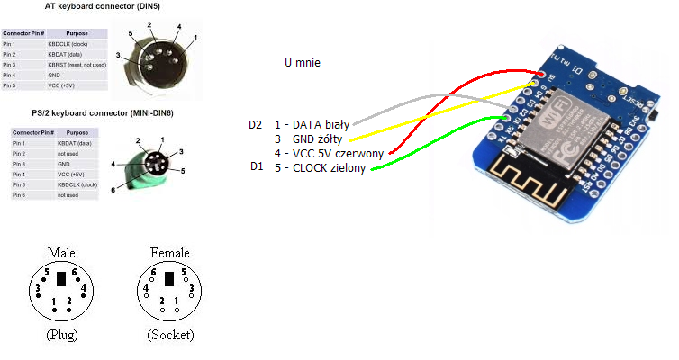

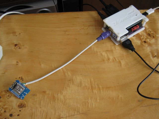

    I soldered the PS/2 cable, WeMOS gets power, WebServer works but the computer I connect to the PS/2 keyboard port doesn't detect the keyboard and it doesn't work.
    I have compiled with the ps2dev library the latest i.e. 0.0.4 and it is the same as with version 0.0.1 - message:
    WARNING: library ps2dev claims to run on (avr) architecture(s) and may be incompatible with your current board which runs on (esp8266) architecture(s).
    Sketch uses 339460 bytes (32%) of program storage space. Maximum is 1044464 bytes.
    Global variables use 30692 bytes (37%) of dynamic memory, leaving 51228 bytes for local variables. Maximum is 81920 bytes.
    Uploading 343600 bytes from C:\DOCUME~1\xxx\LOCALS~1\Temp\arduino_build_732377/d1mini.ino.bin to flash at 0x00000000
    ................................................................................ [ 23% ]
    ................................................................................ [ 47% ]
    ................................................................................ [ 71% ]
    ................................................................................ [ 95% ]
    ................                                                                 [ 100% ]
    Why doesn't it work?
    Sketch d1mini.ino is here - I just changed my SSID, password and IP details:
    https://github.com/remy/ps2-remote
    https://remysharp.com/2021/04/14/building-a-ps2-remote-keyboard
    I soldered according to this:
    Wiring diagram of a PS/2 connector to a WeMos D1 mini board with labeled wire colors
    Added after 15 [minutes]:
    From the script it seems that every key press on the WebServer page should appear in the Serial window and the LED on the WeMOS should flash and nothing happens - something is wrong, just what? My WeMOS has different pins than the older version of WeMOS ???? The author refers to this page:
    https://chewett.co.uk/blog/1066/pin-numbering-for-wemos-d1-mini-esp8266/

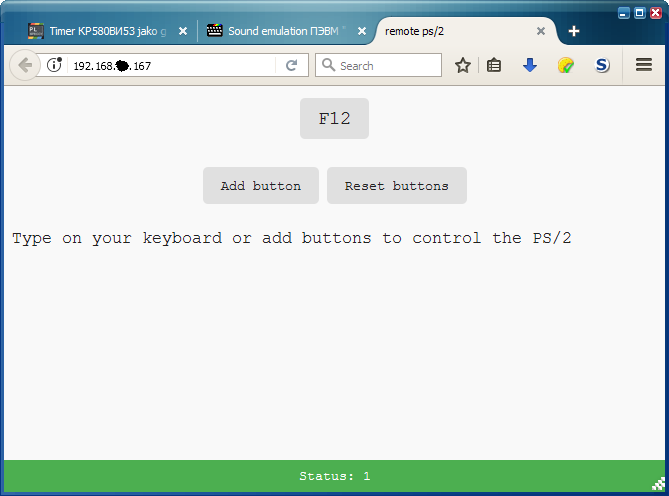

    I changed the IP 160 to 167 in the sketch - the one shown by WeMOS when I compiled with IP 160. Now it bangs nicely :-) Previously on WebServer I had Status: 0 in red at the bottom now I have Status 1 in green:
    WeMOS D1 mini ESP8266-12F CH340, ArduinoIDE 1.8.9 WinXP - does it work or not?
    Great stuff - I'm typing on my laptop and WeMOS plugged into the ZX Spectrum emulator's PS/2 port
    WeMos ESP8266 module connected via PS/2 cable to a ZX Spectrum emulator

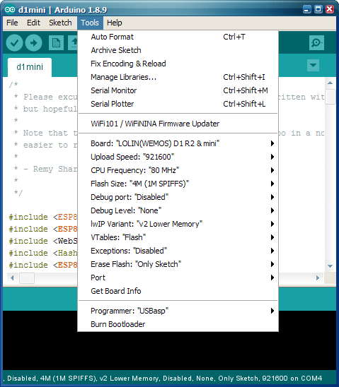

    And these ArduinoIDE settings:
