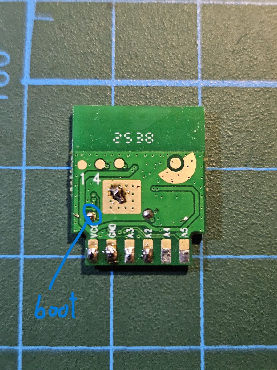

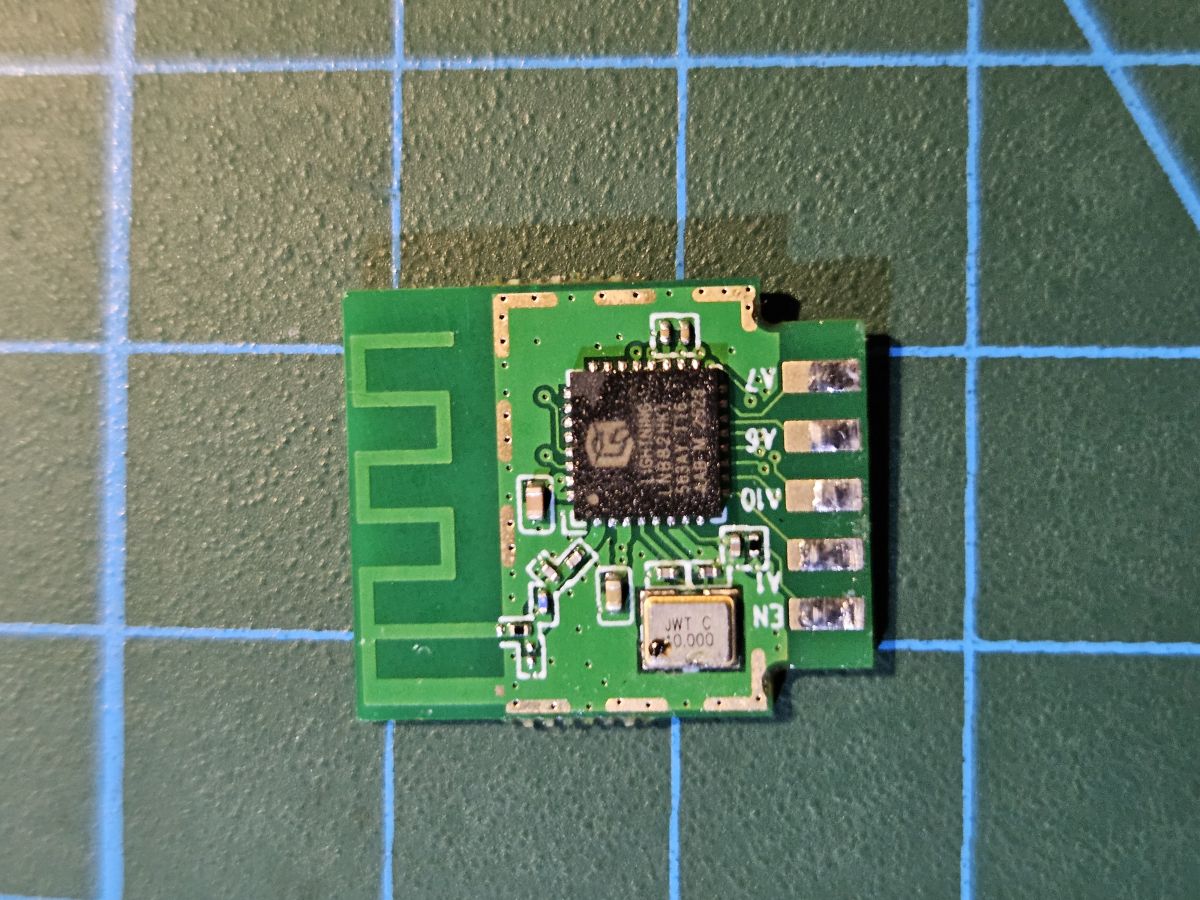

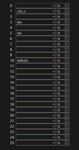

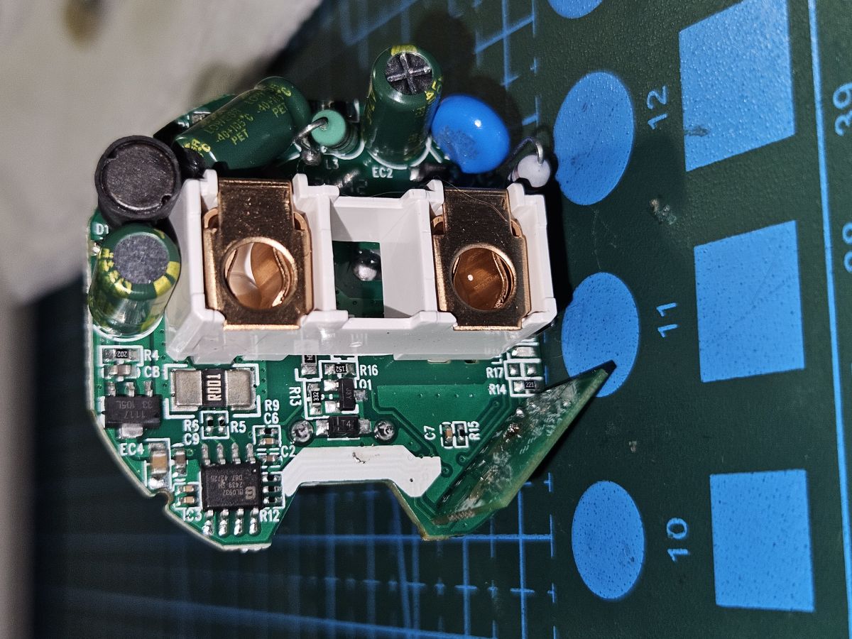

    Hello, I have a plug here with the LN882H chip and the BL0937 energy monitor.
    I followed the instructions in the existing post about this device. Unfortunately, the hardware is slightly different than described in that post. The boot pin was in a different location, but I managed to reflash the chip with the latest firmware (1-18-247). However, I'm now having trouble getting the BL0937 to work. The LEDs, button, and the relay are functioning. Does anyone have any ideas on how I need to configure the energy monitor to which pins get reasonable readings? Pins 7, 12, and 19 aren't working. I'd be grateful for any tips.
    The WIFI modul is called- WB02A
    Electronic module with PCB antenna and integrated circuit on cutting mat Close-up of a PCB with capacitors, coils, and large copper contacts Interface showing 26 numbered channels with labels and numeric values GIRIER 20A smart plug with energy monitoring, front and back views shown
    Electronic module PCB with labeled boot pin and other pin labels
    AI: Could you please share the exact brand and model of the plug you’re working with?
    Girier JR-PM09
  • #3 21812316
    martin271
    Thank you,
    that was exactly what I'm looking for. It works now as expected.
