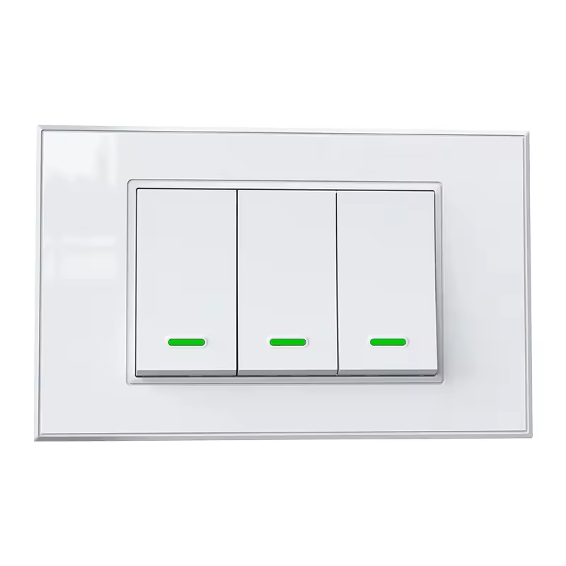

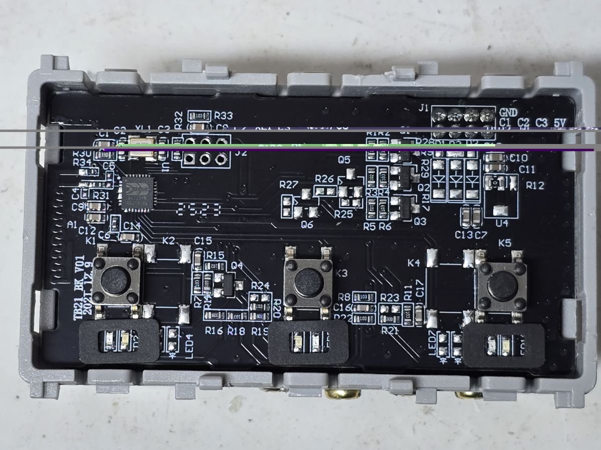

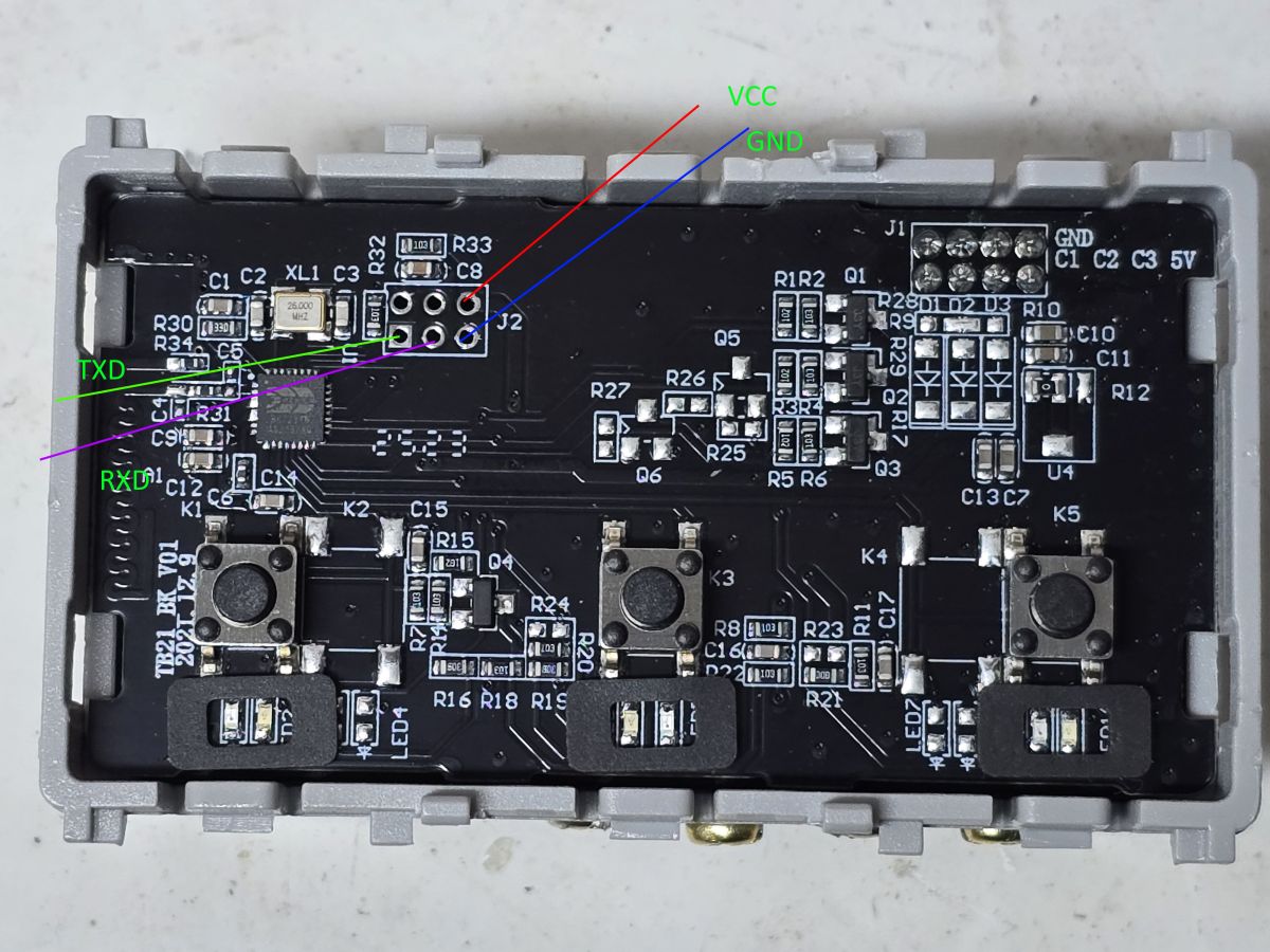

    Bought a 3-way light switch with physical buttons; did not find the template, so I made one:
    Markings: TB23
    Triple white light switch with green LED indicators
    Close-up of a PCB with push buttons and electronic components in a gray casing.
    Close-up of a PCB with buttons, connectors, and labeled TXD, RXD, VCC, and GND pins

    Thanks for sharing. I really like smart switches that are using physical buttons (tactile switches). They are especially useful in OpenBeken - with OBK, you can script the double click, hold, press, release and even triple and quadruple click events to the variety of actions.

    >>21811131
    Yeah, I did back it up.
    • readResult_BK7231N_QIO_3-gang-physical_2026-16-1-13-43-29.bin (2 MB) You must be logged in to download this attachment.
