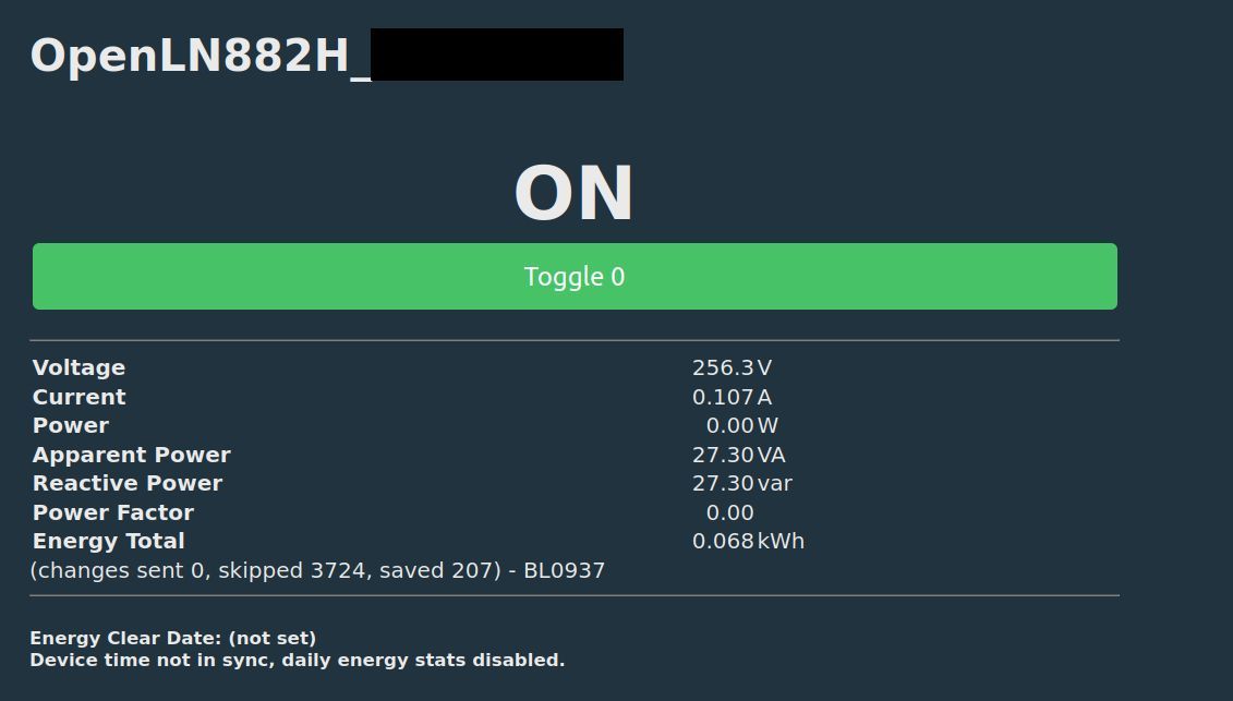

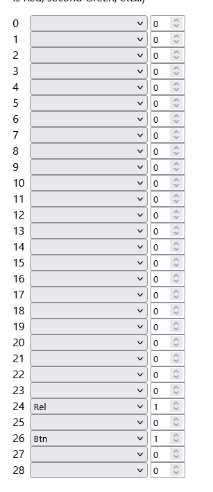

    I just extract the config from the firmware, I cannot get some info
    Screenshot of electrical energy data with zero energy consumption
    Configuration interface with dropdown menus and numeric input fields
    looks like one of the pin is not correct

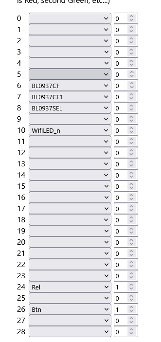

    JSON
    "sel_pin_pin":"8",
    "rl1_lv":"1",
    "bt1_pin":"26",
    "net_trig":"1",
    "jv":"1.0.5",
    "netled1_lv":"0",
    "netled_reuse":"1",
    "bt1_type":"0",
    "ffc_select":"1",
    "vi_pin":"7",
    "resistor":"1",
    "over_cur":"21000",
    "bt1_lv":"0",
    "reset_t":"5",
    "netled1_pin":"10",
    "chip_type":"0",
    "lose_vol":"96",
    "over_vol":"265",
    "module":"CB2S",
    "ele_pin":"6",
    "ch_cddpid1":"9",
    "ch1_stat":"2",
    "rl1_type":"0",
    "ch_num":"1",
    "ele_fun_en":"1",
    "rl1_pin":"24",
    "vol_def":"0",
    "ch_dpid1":"1",
    "sel_pin_lv":"1",
    "crc":"70"
    TEXT
    - BL0937 SEL on P8
    - Button (channel 1) on P26
    - BL0937 VI (CF1) on P7
    - WiFi LED on P10
    - BL0937 ELE (CF) on P6
    - Relay (channel 1) on P24

    Did you calibrate the plug (on the "Tools" page of Web App)?
    Are the values slightly changing?

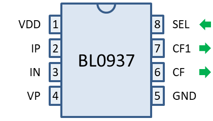

    Help: 49
    Rate: 189

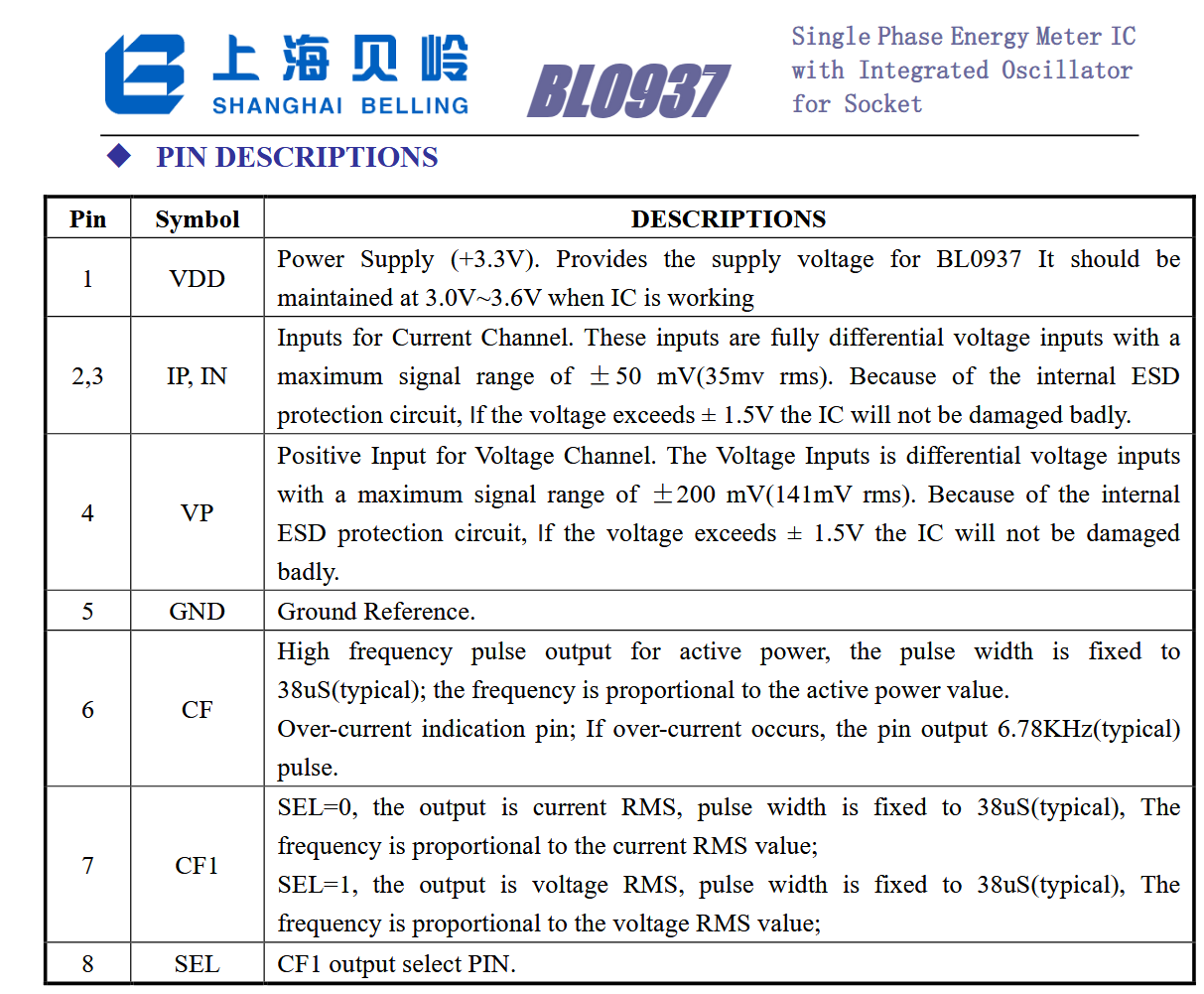

    Thinking about it, probably CF pin is not correct (or connection is broken), this pin will read BL0937's power, while CF1 reads current/voltage, depending on SEL value.
    Table describing the pin functions of the BL0937 energy meter IC by Shanghai Belling

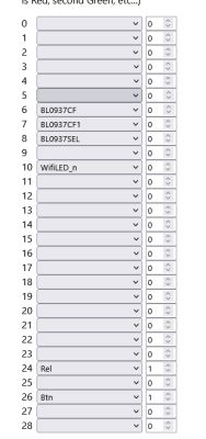

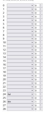

    I just leave the rel and btn (I know both are working)
    Dropdown list and number fields from 0 to 28 with labels “Rel” and “Btn”
    And still showing
    Screenshot of electrical parameters and energy consumption data.
  • #8 21807524
    max4elektroda
    Posts: 758
    Help: 49
    Rate: 189
    If you don't stop the driver (ore restart), it will continue.
    IIRC only if you change the pins for the chip, the driver will use the new pins. If you "delete" them, it will continue with the old pin assignment.

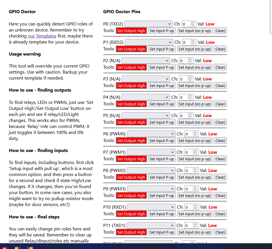

    Posts: 83

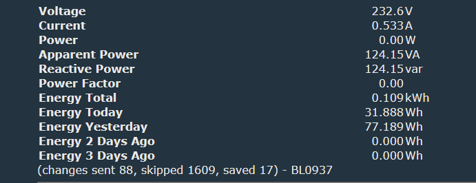

    Also I cleared all in gpio doctos
    GPIO Doctor tool interface with pin list and configuration buttons.
    And still
    Screenshot of electrical data: voltage 232.6V, current 0.533A, power 0.00W
    It's weird, right?
  • #10 21807547
    max4elektroda
    Posts: 758
    Help: 49
    Rate: 189
    But you stopped the driver or restarted after clearing the pins?

    I'm trying to check the pinout from bl0973
    Pinout diagram of the BL0937 integrated circuit with labeled pins
    to the CB2S pin, just gnd and 3.3 Its connect, the cf cf1 and sel the multimeter dont beep. omg;;;

    Posts: 758
    Help: 49
    Rate: 189
    At least CF1 should be right, since you get some readings and SEL for the values seem "o.k.".
    I can force the same here by assigning CF to a wrong pin (and, sorry, seems I was wrong, I restarted the plug after changing the pin assignment)

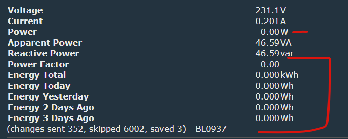

    I just resolder 3 times, with the micorsope.
    I take out, clean, and resolder again.
    now its working.

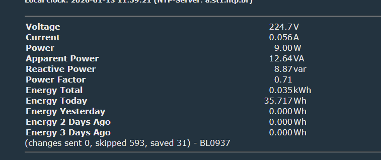

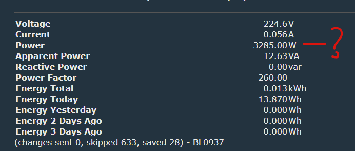

    Posts: 83
    now its almost
    Screenshot of electrical data showing 3285 W power at low current of 0.056 A
    and change agian to the correct
    Screenshot showing voltage, current, power, and energy readings from BL0937 meter

  • #19 21807627
    tadeu1
    Posts: 83
    >>21807619
    almost
    I get the correct power, and after 1 second, wrong, its back to correnct and back to wrong.
    like a loop
    #20 21807651
    max4elektroda
    Posts: 758
    Help: 49
    Rate: 189
    Only power, current and voltage o.k.?
    Did you enable powersave? That doesn't work well together with BL0973.
    Else I'm running out of ideas, if connection now is fine...
  • #21 21807687
    tadeu1
    Posts: 83

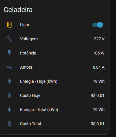

    I did a jump from the bl0973 and cb2s, its ok now, something is wrong with the pcb ;-(
    Added after 1 [hours] 6 [minutes]:
    Refrigerator control panel showing power consumption and cost values
    WORKING FLAWLESS
