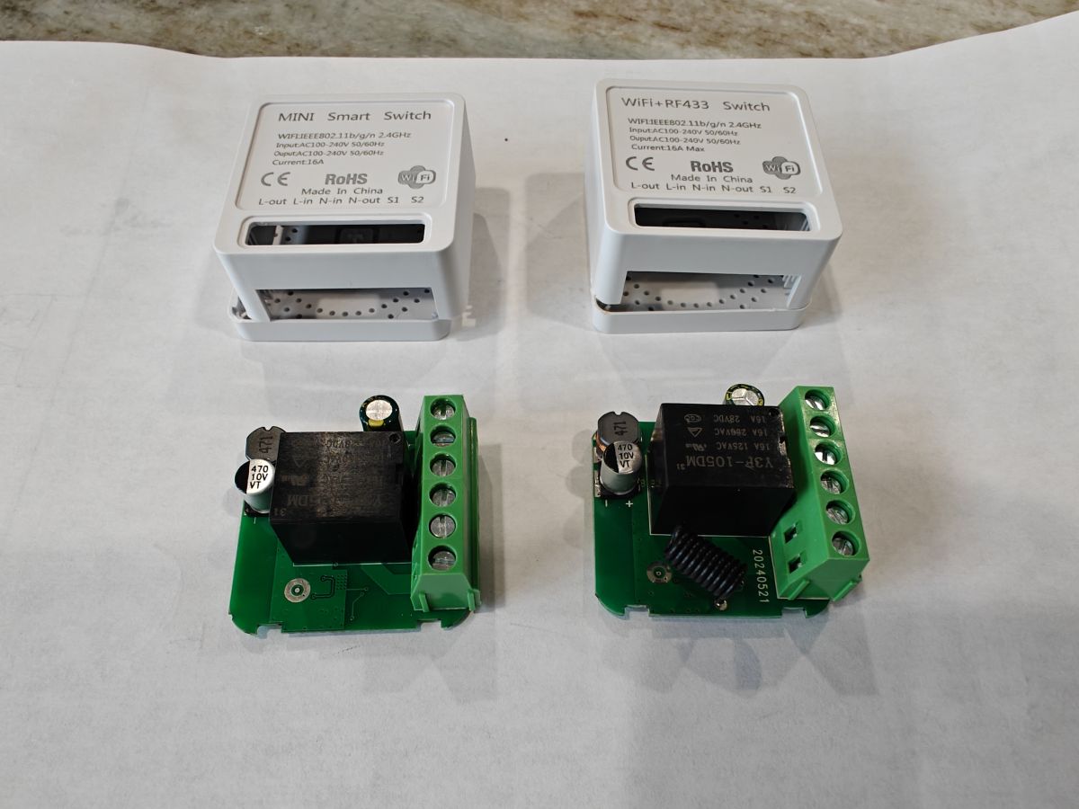

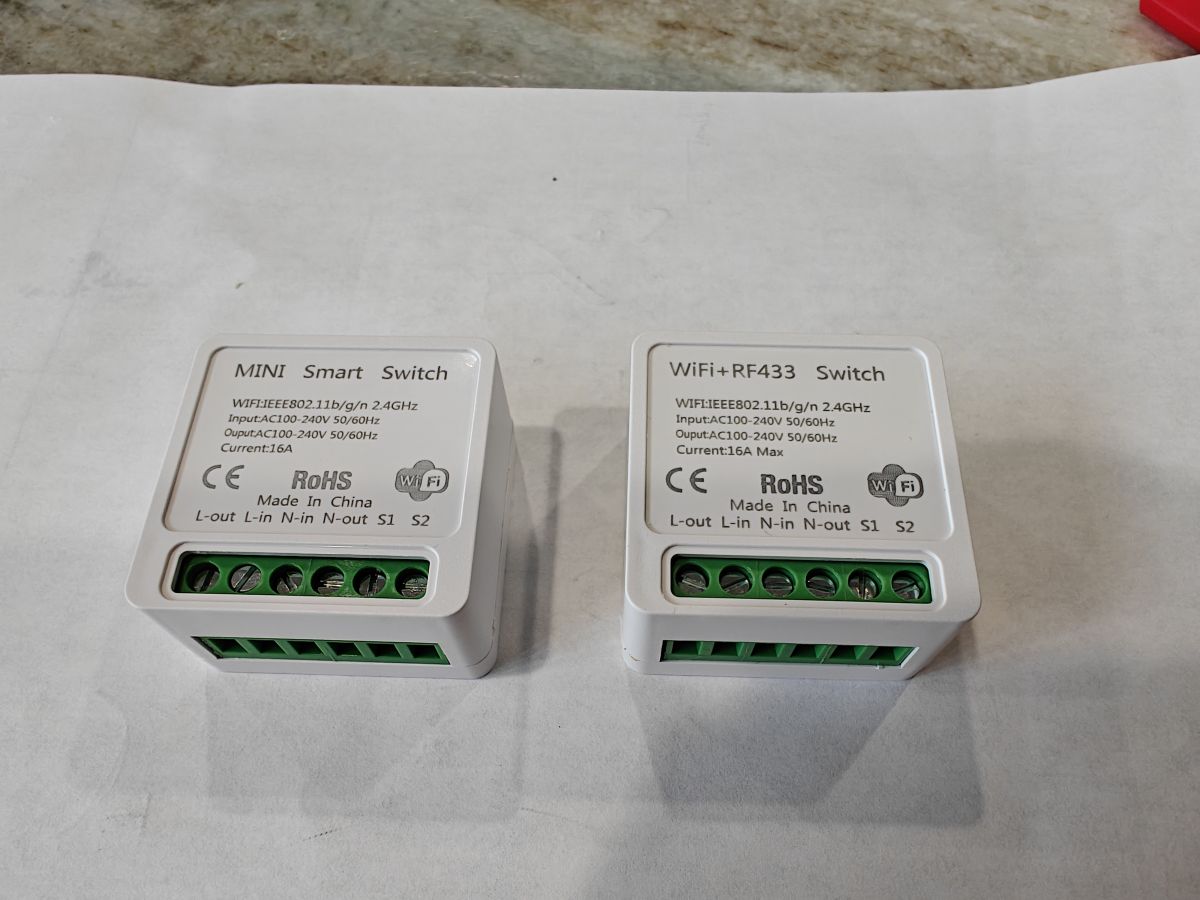

    Generic Tuya WiFi Smart Switches (bare minimum BK7231N)
    I bought these on aliexpress because of their price (the cheapest I could find). These are built down to price and have no modules in them, just a BK7231N on the main board.
    Two generic Tuya WiFi Smart Switches side by side.
    WiFi only: https://www.aliexpress.us/item/3256806781135781.html
    WiFi + RF 433 MHz: https://www.aliexpress.us/item/3256806984455025.html
    I looked for the cheapest ones because my goal is not to use them as is, but rather re-flash them to my liking and use in my home assistant setup.
    Let's crack them open! There is just a single board inside. Terminals, relay and power supply inductor/capacitors on one side (+antenna for RF version):
    Two Tuya WiFi Smart Switches modules with electronic boards.

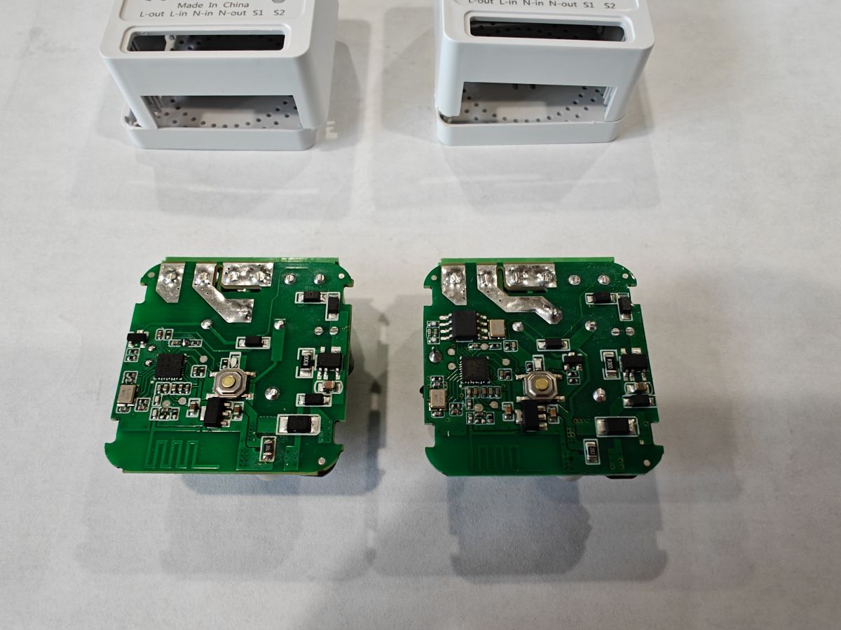

    and all other electronics including BK7231N, power supply chips, and other discrete components (RF version also has what seems to be a SYN470R receiver chip) on the other side:
    Two green circuit boards of Tuya WiFi Smart Switches against a background of two white enclosures.

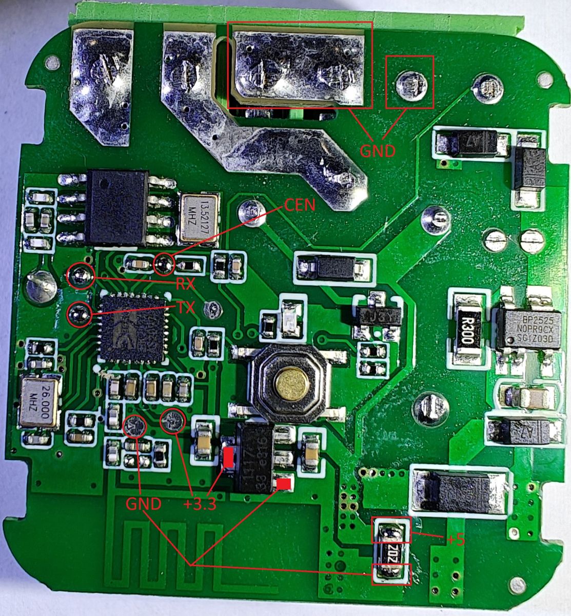

    Not sure about the receiver - it is an unmarked chip, but connections seem to match the 8-pin package pinout in the datasheet. Exact model of receiver chip is not important though. So let's find out how to reprogram these boards. I used a multimeter with really thin and sharp probes to probe BK chip pads directly and found out all the required connection points and where peripherals connected to.
    PCB of a Tuya WiFi Smart Switch module with marked pads.
    There are very conveniently placed test pads for CEN, RX and TX pins. They are easily accessible to solder with a soldering iron.

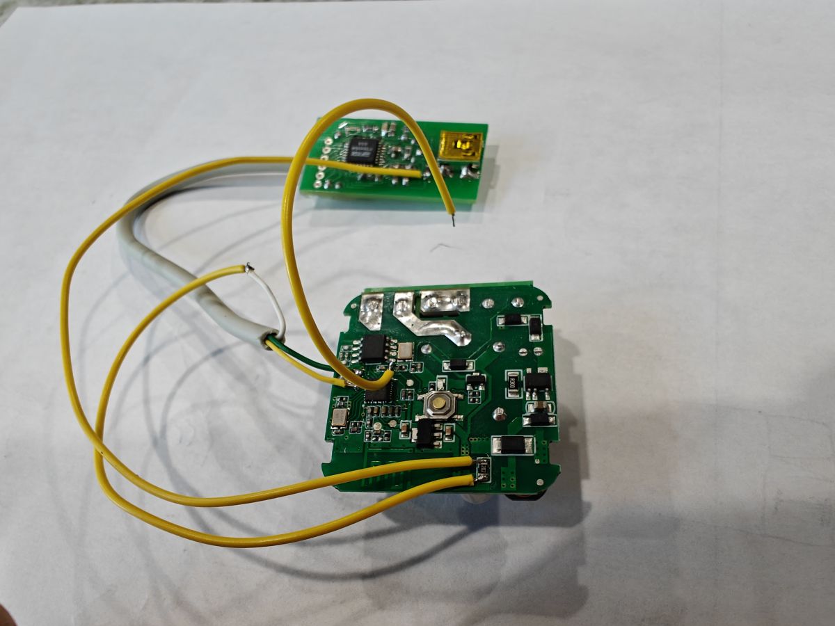

    There are also pads for GND and +3.3, but they are not so conveniently located - there are other components nearby. However, it is a blessing in disguise as this board has a 3.3 volt regulator, so we can power it from USB directly! Just solder 2 wires on each side of 2K resistor and we are golden.
    Tuya WiFi Smart Switch circuits with visible wires and electronic components.
    2 middle pins of the main connector form a large unmasked surface which is connected to ground. That makes it a perfect point to touch with a wire soldered to CEN pad to initiate chip reprogramming.
    Peripheral connections:
    Relay is connected to P7
    Button is connected to P23
    LED is connected to P26
    External switch (main terminals) shorts P6 to ground
    RF receiver is on P8 (on the WiFi+RF board only)
