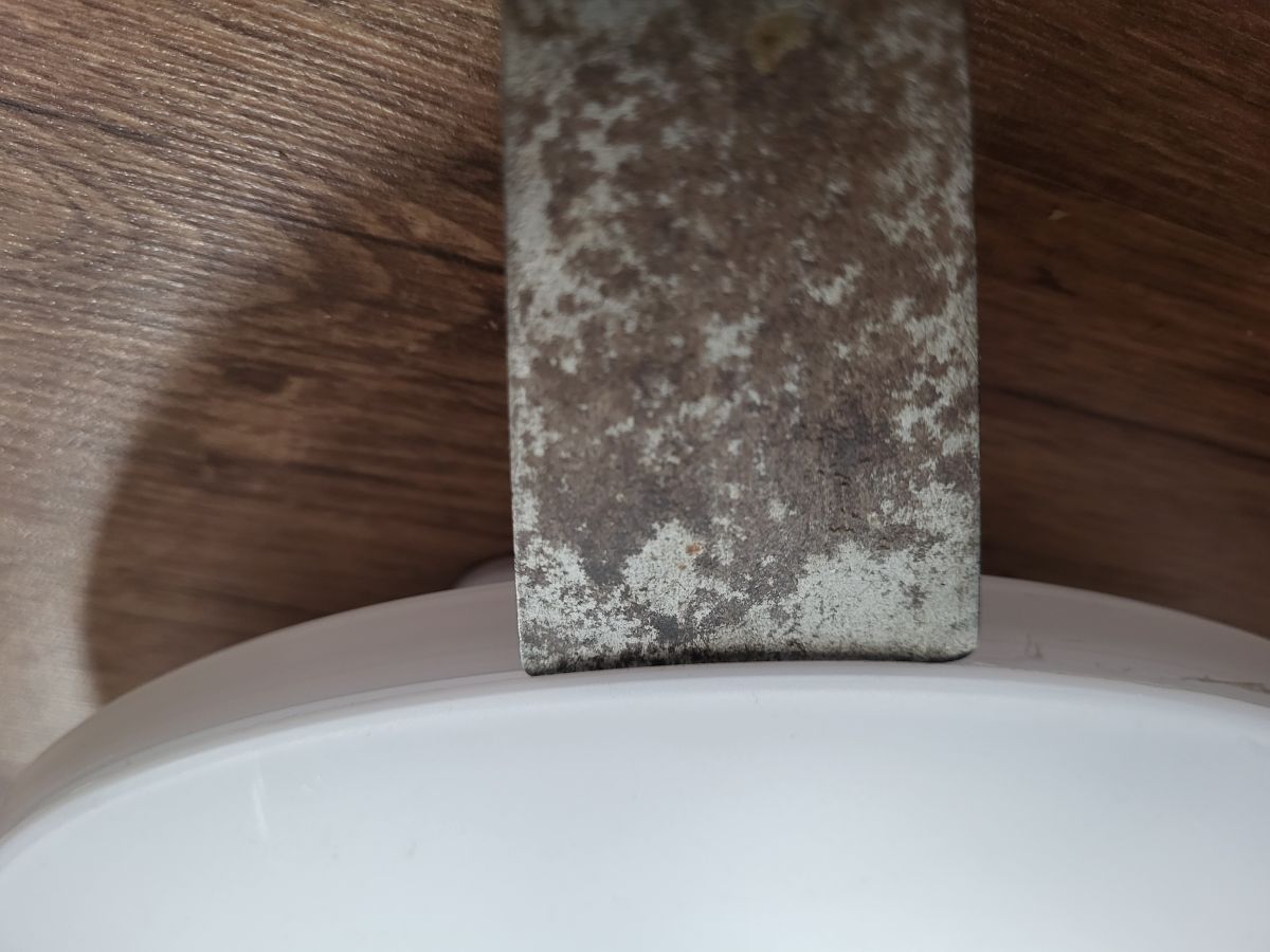

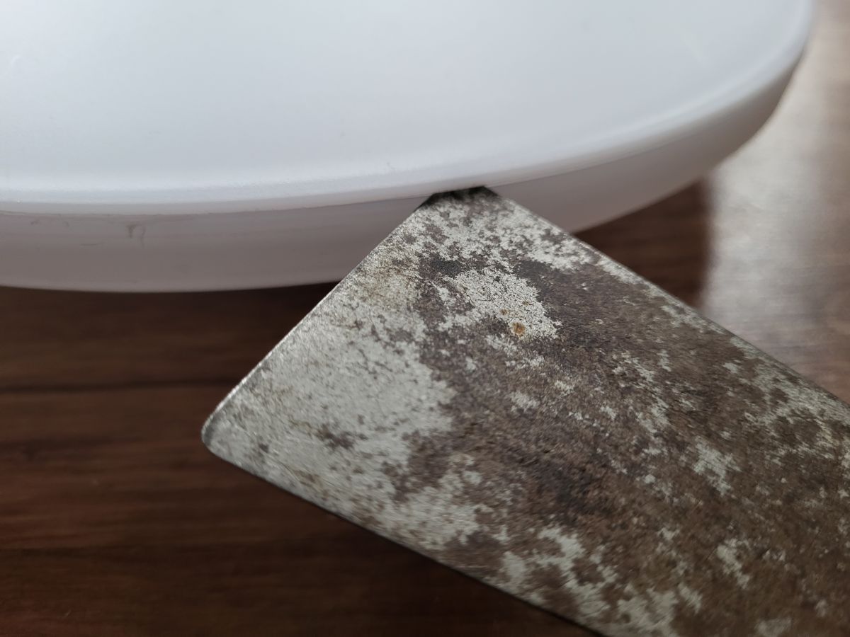

    First we need to open the Lamp. The easiest way to get access is by going through the front. You can insert a scraper in this little nodge here. The cover is glued in... the easiest way without destroying anything is to twist the scraper to both sides. reposition the scraper on a different position and repeat the twisting motion until you can open the lid. be patient and you will only destroy the glue.

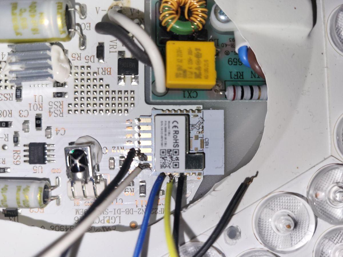

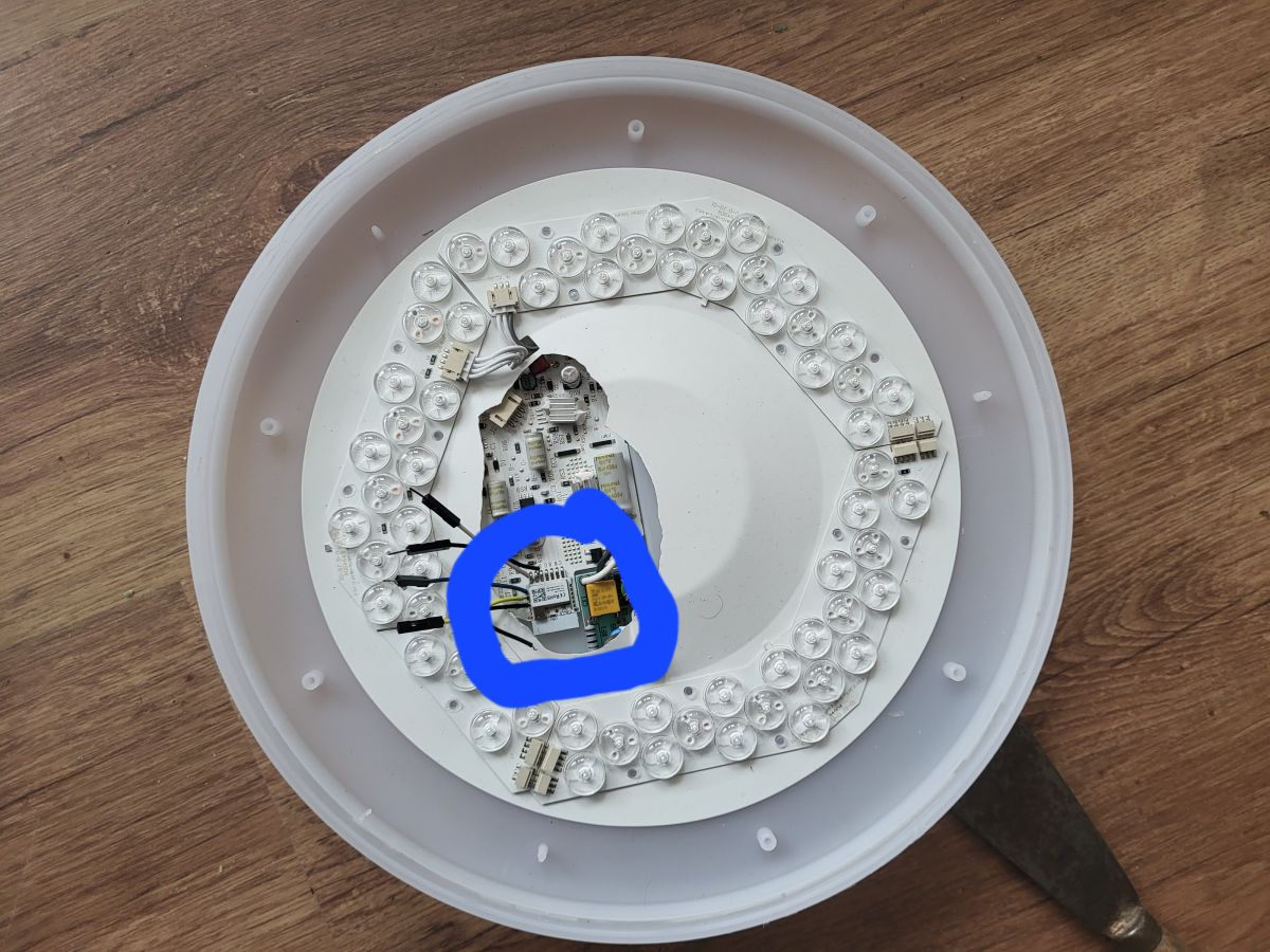

    Now we need to cut a little hole into the cardboard. you can see where the CBU chip is located on the picture. Either you solder some wires or you just insert a CBU flashing jig. (My hole was to big. only the blue circle is needed to be open)
    Disassembled LED lamp with highlighted electronic module in the centerESP module on a circuit board with electronic components and wiresblue=TX / yellow=RX / black=GND and CEN / white=VCC
    After flashing firmware for a BK7231N chip you can use the lamp with OpenBeken. Last step is to configure the firmware. everything you need is in the profile.
