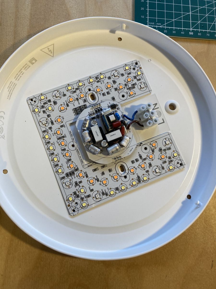

    I seem to have found a new revision of the LSC SMART CONNECT ceiling light
    Packaging of LSC Smart Connect ceiling light with illustration and specifications.
    Packaging of the LSC Smart Connect ceiling light with RGB and tunable white options.

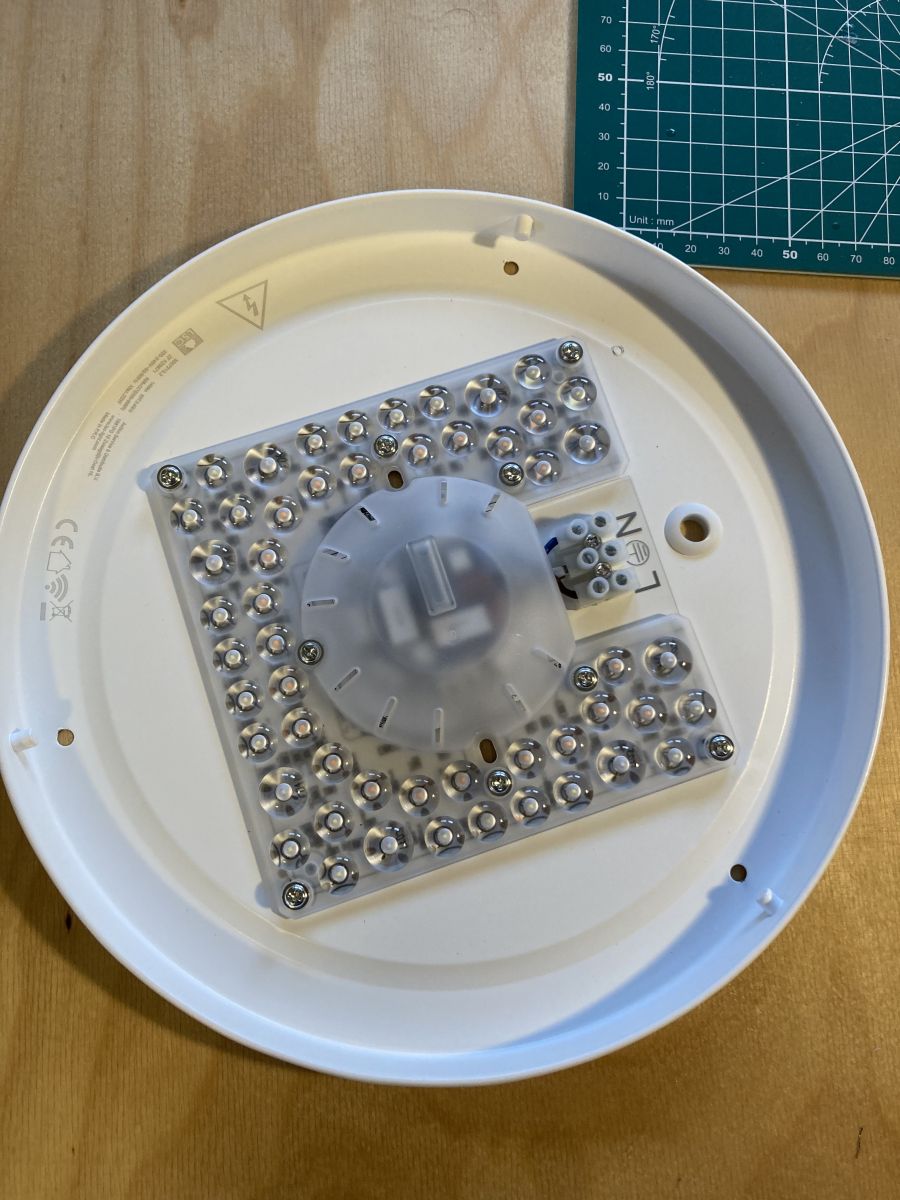

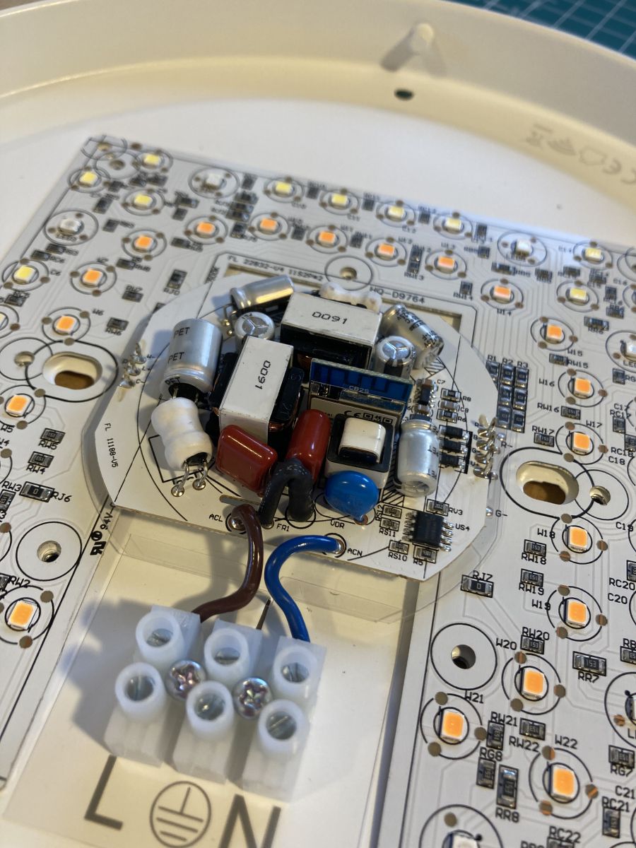

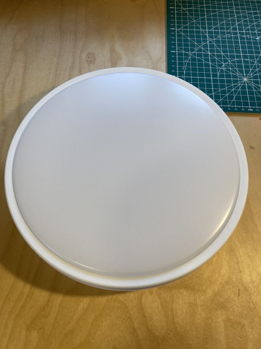

    The box looked the same as the older revisions, but the internals are quite different looking. But they still feature the CB2S chip.
    White plastic ceiling lamp on a wooden tabletop.
    LSC SMART CONNECT ceiling light with exposed internal components.
    PCB of LCS SMART CONNECT ceiling light with LEDs and CB2S chip.
    Interior of the LSC SMART CONNECT ceiling light showing LED components and electronic elements.
    Close-up of a printed circuit board with electronic components mounted on a metal frame.

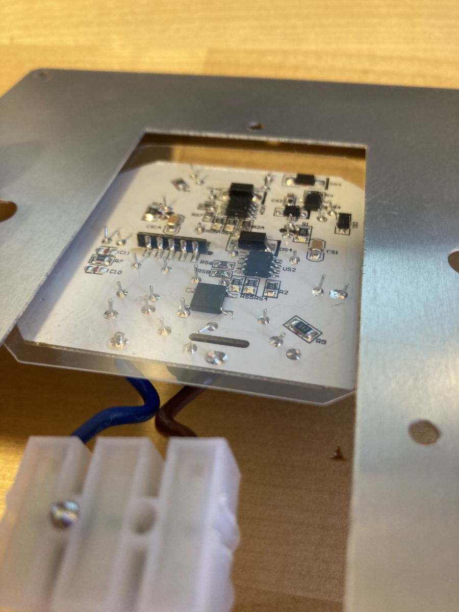

    Disassembly was quite easy, just twist the plastic lamp cap until it can be taken off without any force required.
    The flashing process was also easy, as the module pins were easily accessible after removing the plastic cover by cutting away as small strip of it and bending the remaining part away. I also used the CEN pin thats also labeled on the board, so easy to locate if your not as familiar.
    I used bk7231flasher to flash the OpenBK7231N firmware.
