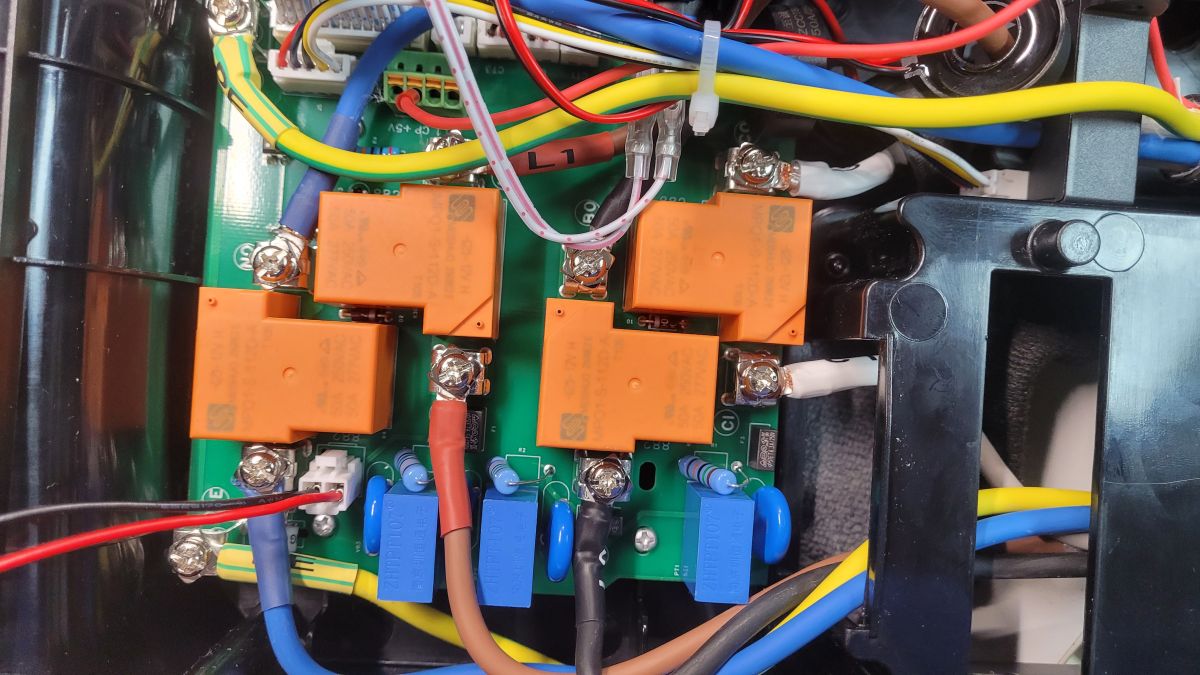

    No-name AliExpress 3-phase EV charger (EVSE) with WBR3
    Differences from:
    https://www.elektroda.com/rtvforum/topic4085036.html#21754359 - this one does not have a connection to the electrical meter and is 3-phase
    https://www.elektroda.com/rtvforum/topic4159907.html - this one is 3-phase

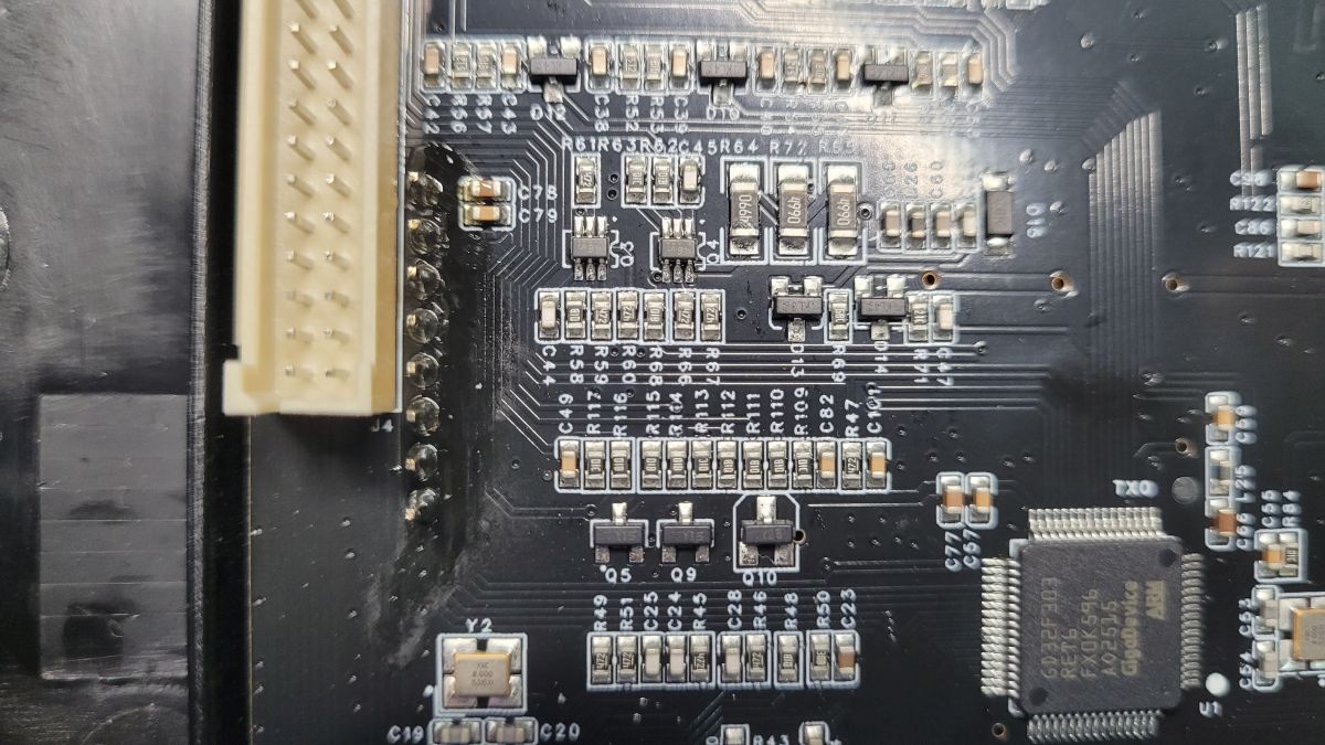

    These are only pictures of the inside, without any software/MCU hacking. If this is not supposed to be here, please feel free to delete it.

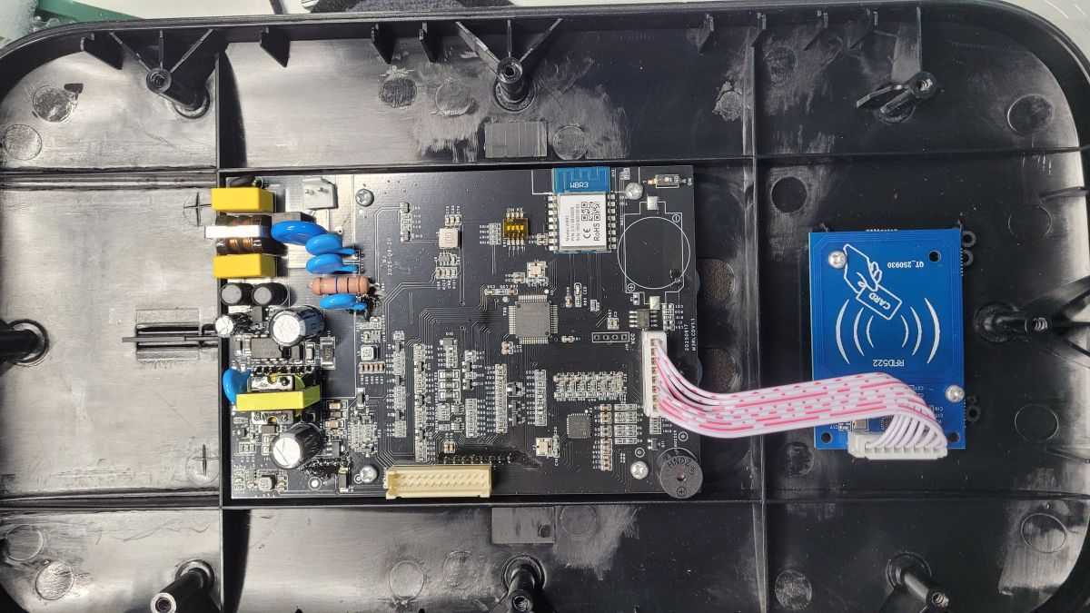

    Interior of 3-phase EV charger with visible relays, wires, and PCB componentsEV charger PCB with RFID module and WBR3 module connected by flat ribbon cable

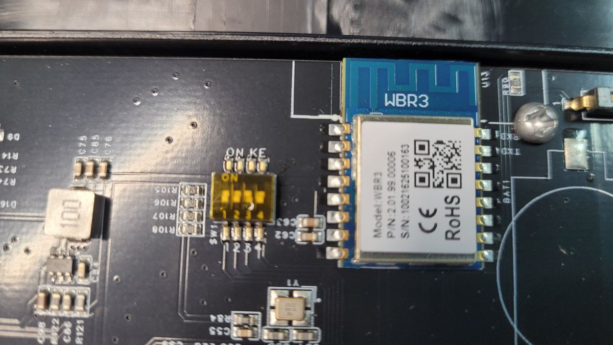

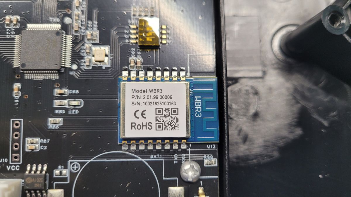

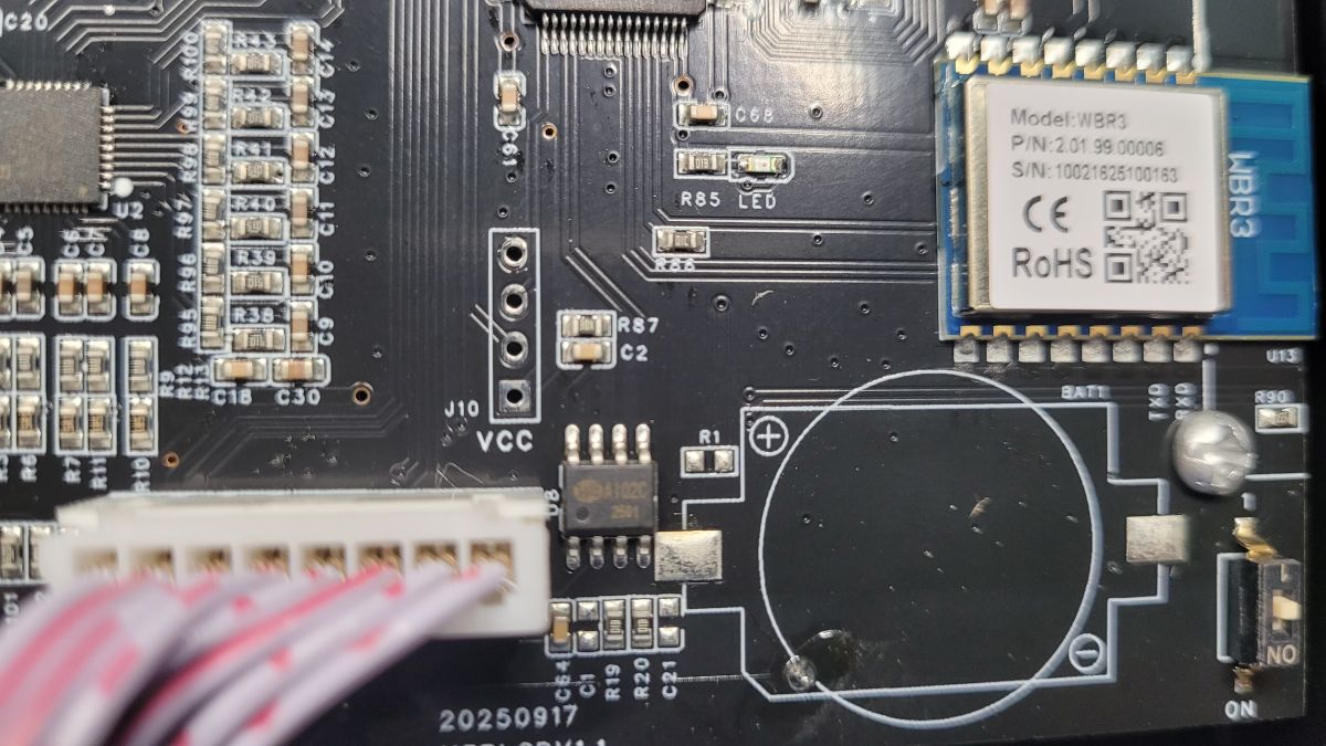

    WBR3 module and UART header on EVSE circuit board

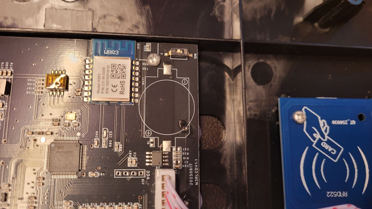

    Close-up of PCB with microcontroller, Wi-Fi module, and UART label

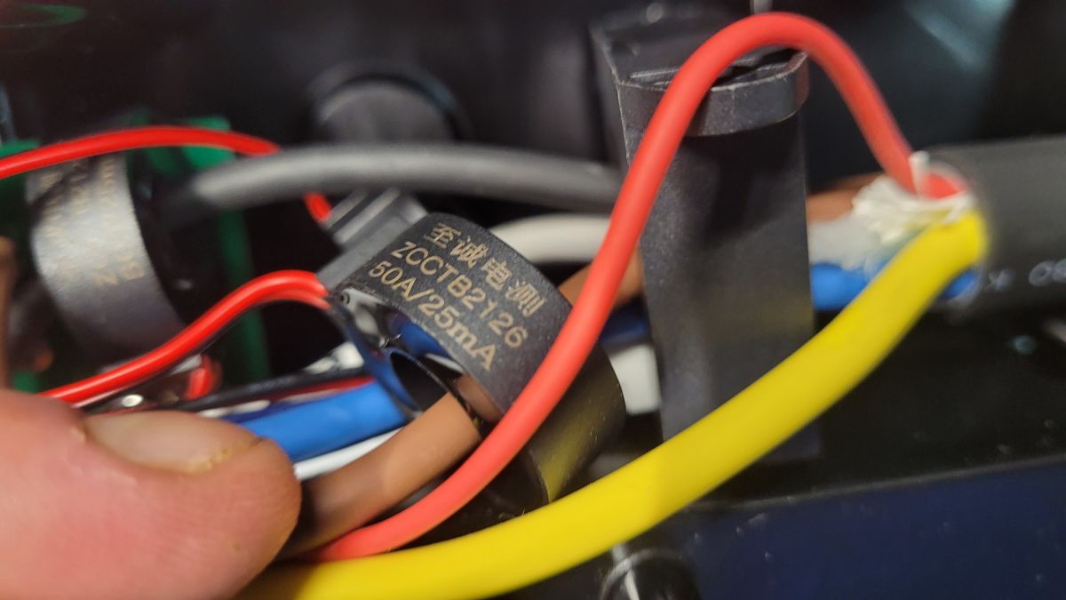

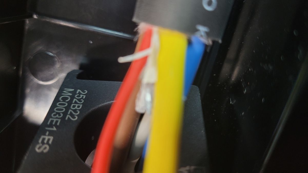

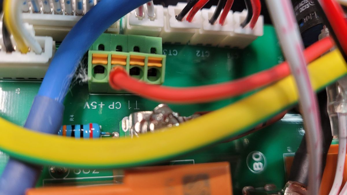

    Close-up of multicolored wires connected to a component labeled 252B22 MC003E1-ES Close-up of wires and 4-pin connector inside an EV charger housing Close-up of PCB with colorful wires and connector labeled T1 CP +5V Close-up of ZCTB2126 current transformer in EV charger with colorful wires WBR3 module on PCB with RFID reader and UART header visible

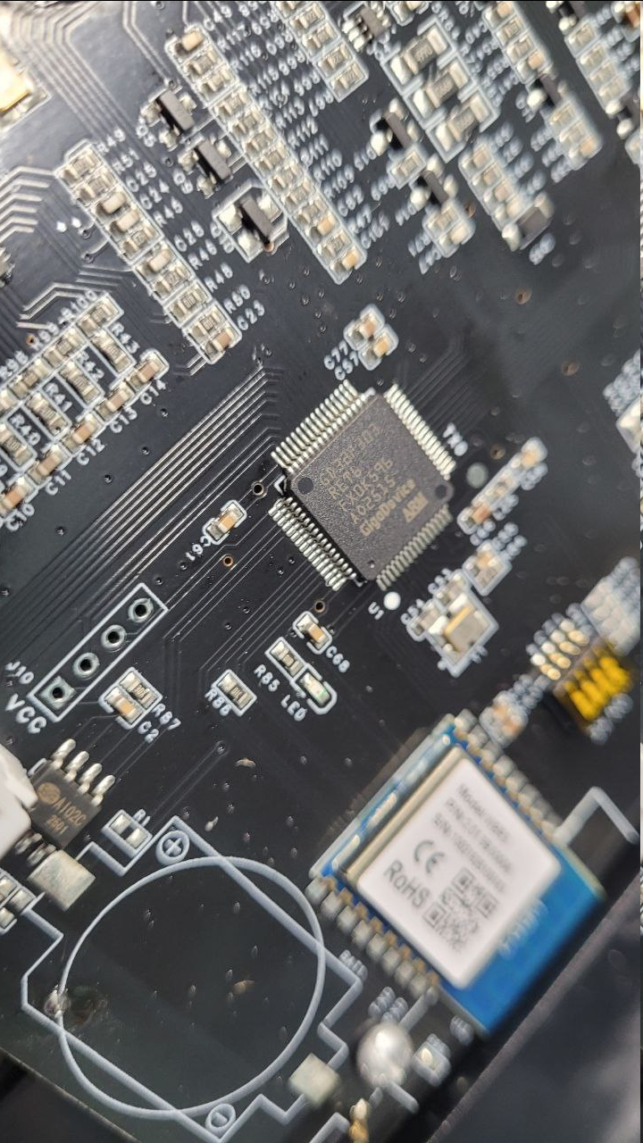

    WBR3 module on PCB with DIP switches and CE marking visible Close-up of a PCB with GigaDevice microcontroller and UART header WBR3 module on PCB with visible pins and labeled components
    what does SW1 seem to do:
    1,2 - i do not understand exactly, but seem to switch between 8,10,13,16A and 16,20,24,32A modes for the button
    3 - most likely 1/3 phase
    4 - switches C and F and also switches the limit up to 40/50A - I guess as USA do not use 3 phases
    there is no way to be able to set less then 8A out of box
    ARM chip is
    GigaDevice
    GD32F303
    RET6
    FX0K596
    A02515
    https://download.gigadevice.com/Datasheet/GD32F303xx%20Datasheet%20Rev3.2.pdf
    Identifies itself as GO-E31-32A in device scan
    HEADER seems to be
    PB11 Alternate: I2C1_SDA, USART2_RX
    VCC
    Header seems to be
    DIO CLK GND VCC
