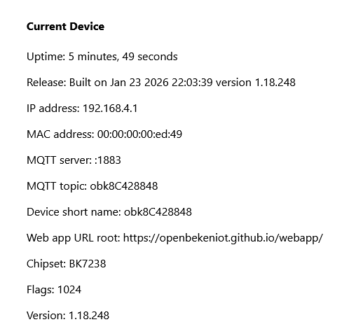

    Hello ;)
    I am struggling with these thermometers on the BK7238 and a problem has arisen. Namely, I uploaded firmware 1.18.247 (also tested on 1.18.248) and both thermometers get the same MAC address (C8:47:8C:42:88:48).
    Unfortunately the option to change the MAC address in the configuration does not work for this chip :( Ot disconnects the connection and that's the end of it....
    UART2 console log attached change_ma..og.txt (24.82 kB)You must be logged in to download this attachment.
    In the web application the MAC shown is wrong (in the configuration it shows ok)
    Screenshot of BK7238 device info panel showing invalid MAC address

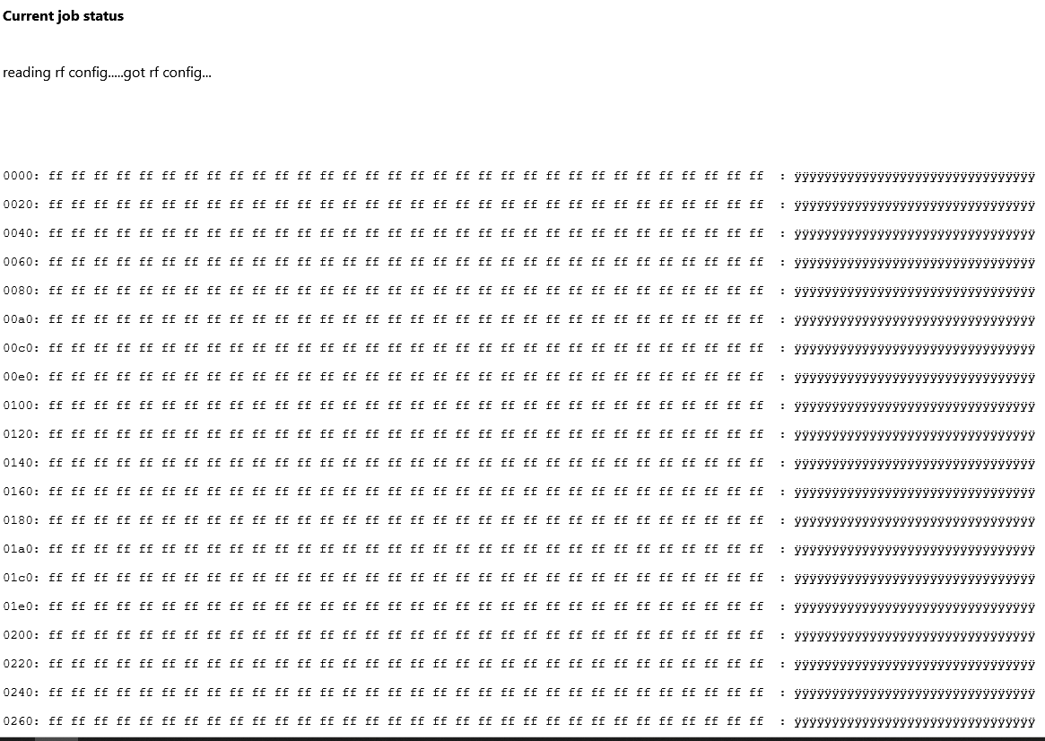

    I've also read the RF Config section and it looks empty and restoring does nothing....
    UART2 console showing RF config with only 0xFF bytes, indicating blank memory
    Any ideas how the MAC can be changed ?

    RF section on common, non-Tuya BK7238 is at 0x1E0000. On T1 - at 0x1E3000.
    And unfortunately, that's where OBK stores it's flash vars (reboot count, etc.).
    Implement dummy RF generation in web app?

    https://www.elektroda.com/rtvforum/topic4106397.html#21764525 (select BK7238)
    Or in web app, page "Flash" -> "Restore (Recreate) RF Config (N & T)". But, there was a report that it made device inaccessible (https://www.elektroda.com/rtvforum/topic4163492.html#21827393)
    On devices without backup, flashed before 1.18.255, original RF/MAC data is lost. On those that were flashed after, it's still at 0x1E3000.

    What do you mean? If you have default MAC (C8:47:8C:42:88:48), then it's not stored anywhere, but firmware.
    You would need to recompile it with different default MAC to change it.
    There are much better methods than that though.
    You would have to either wait for https://github.com/OpenBekenIOT/webapp/pull/266 to be merged, or create some tiny web server to host it.
