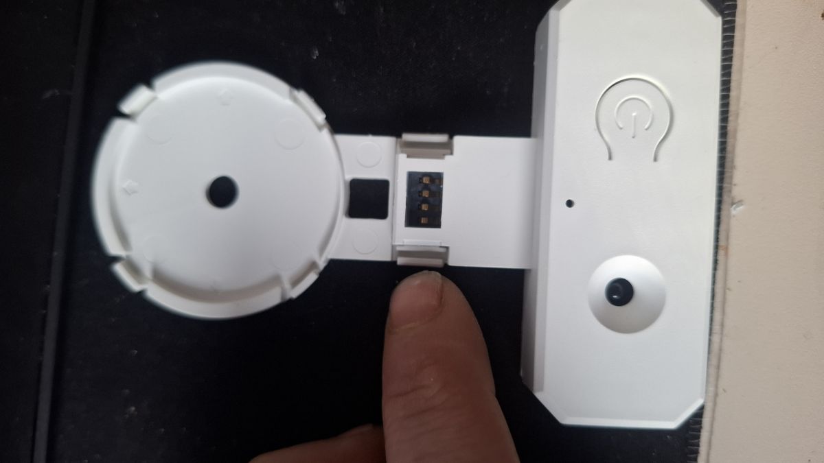

    How to Flash: UART

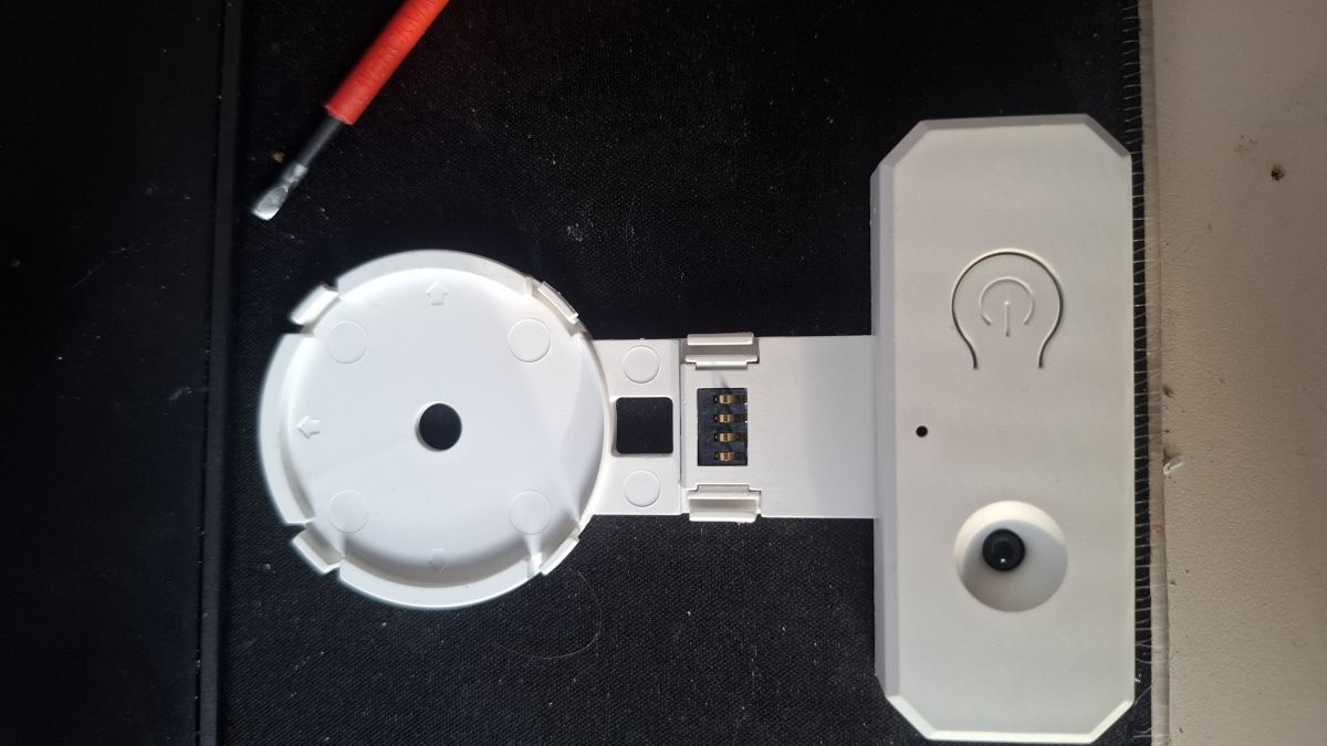

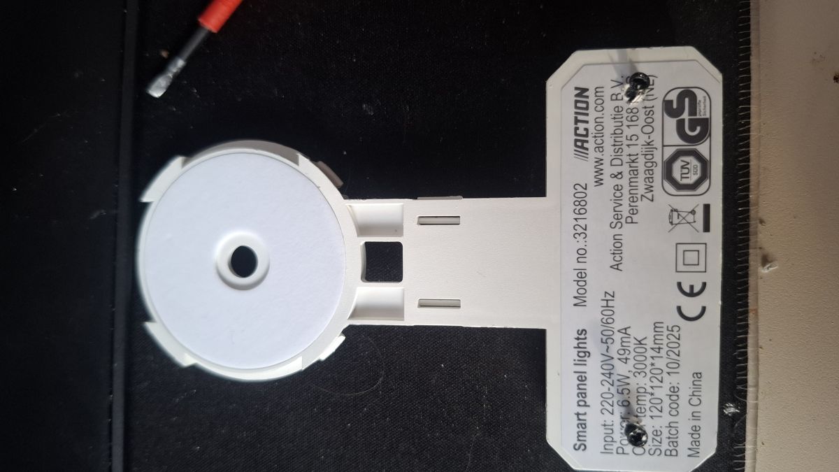

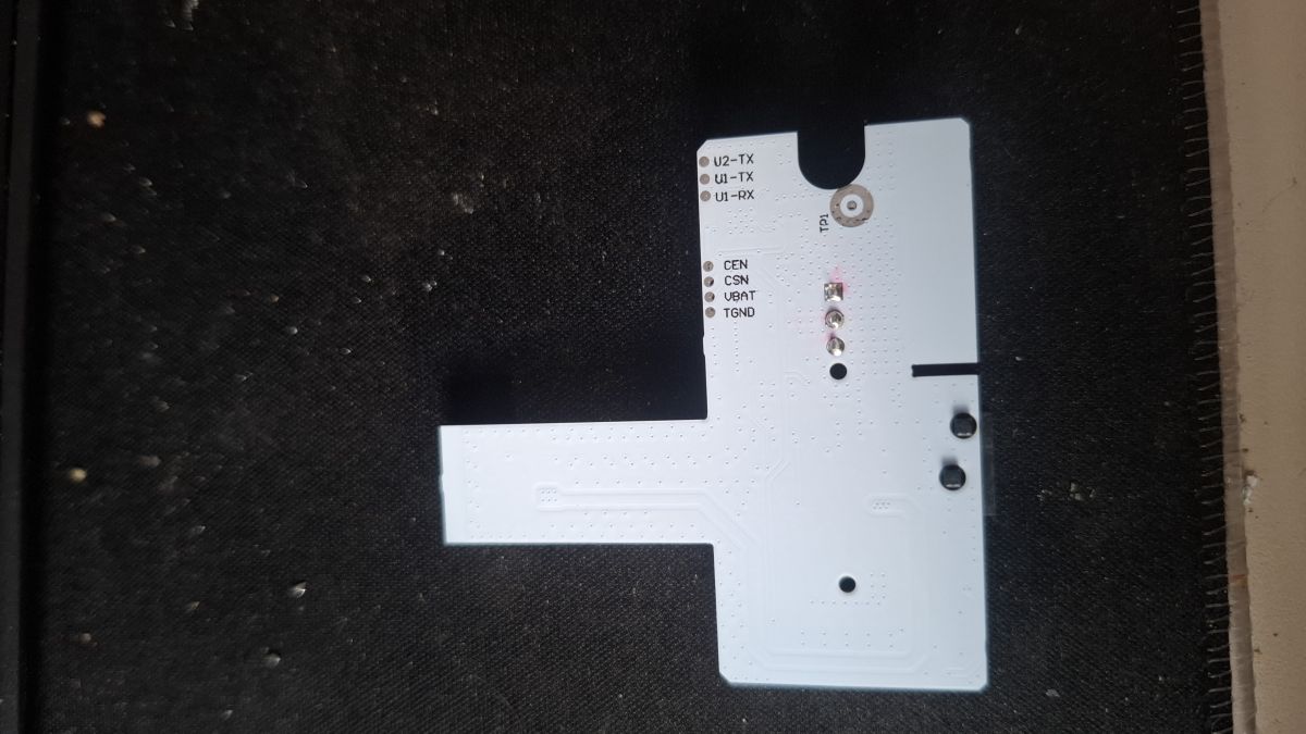

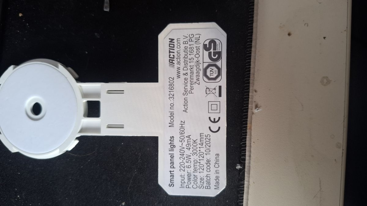

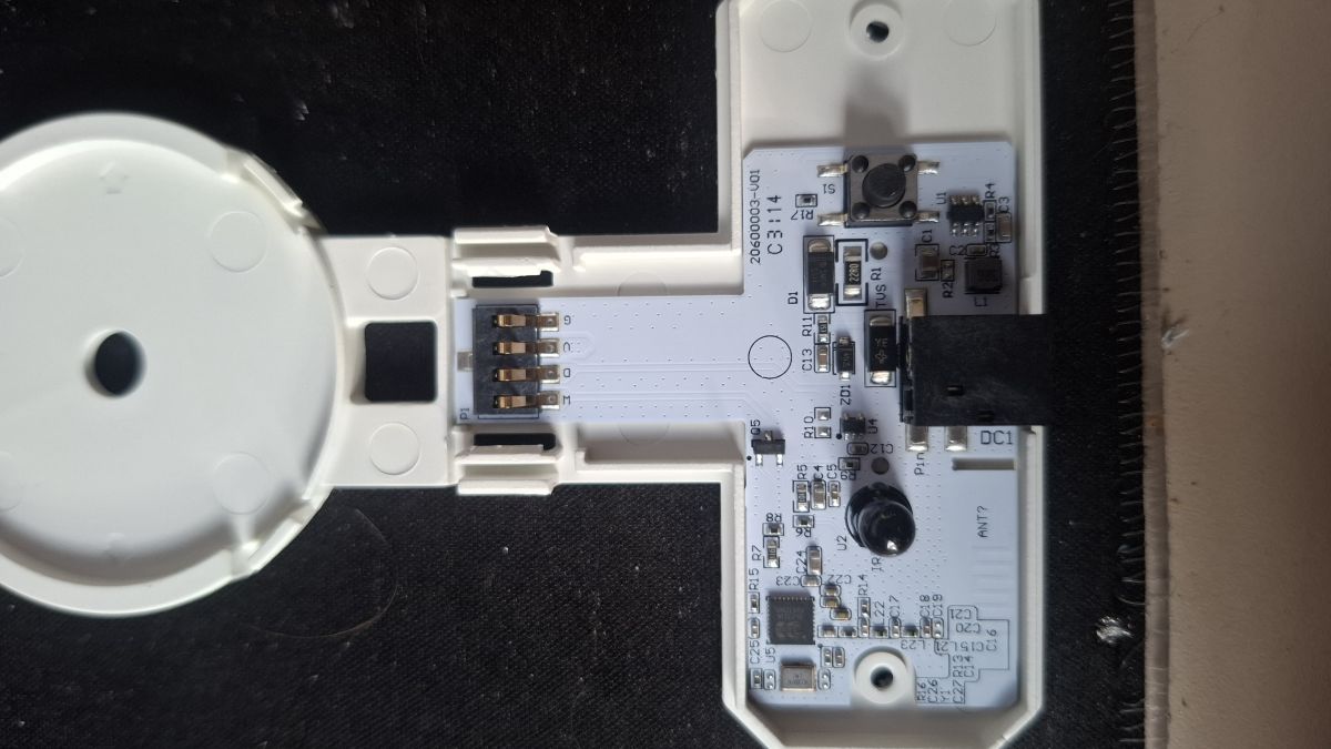

    PINS are all easy to solder on the backside of the controller; only 2 screws needed to open it.
    [Nameplate on the back of the LSC Smart Panel Lights unit, showing electrical specs Technical label on housing of LSC Smart Panel Lights model 3216802 Disassembled LSC Smart Panel Lights controller with exposed UART connector Close-up of the UART pin connector on LSC Smart Panel Light controller LSC Smart Panel Lights PCB with visible UART pins and electronic components Rear side of PCB showing UART label and pin pads for soldering
    PINOUT:
    P9: SM16703P_DIN
    P24: Warm White LED
    P26: IRRECV
    P28: Button
    Works great but my problem is to bring the software to use RGB for color and Cold White and the Warm white output to use as Warm white anybody an idea

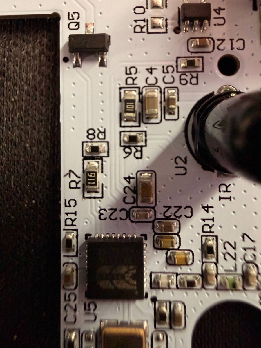

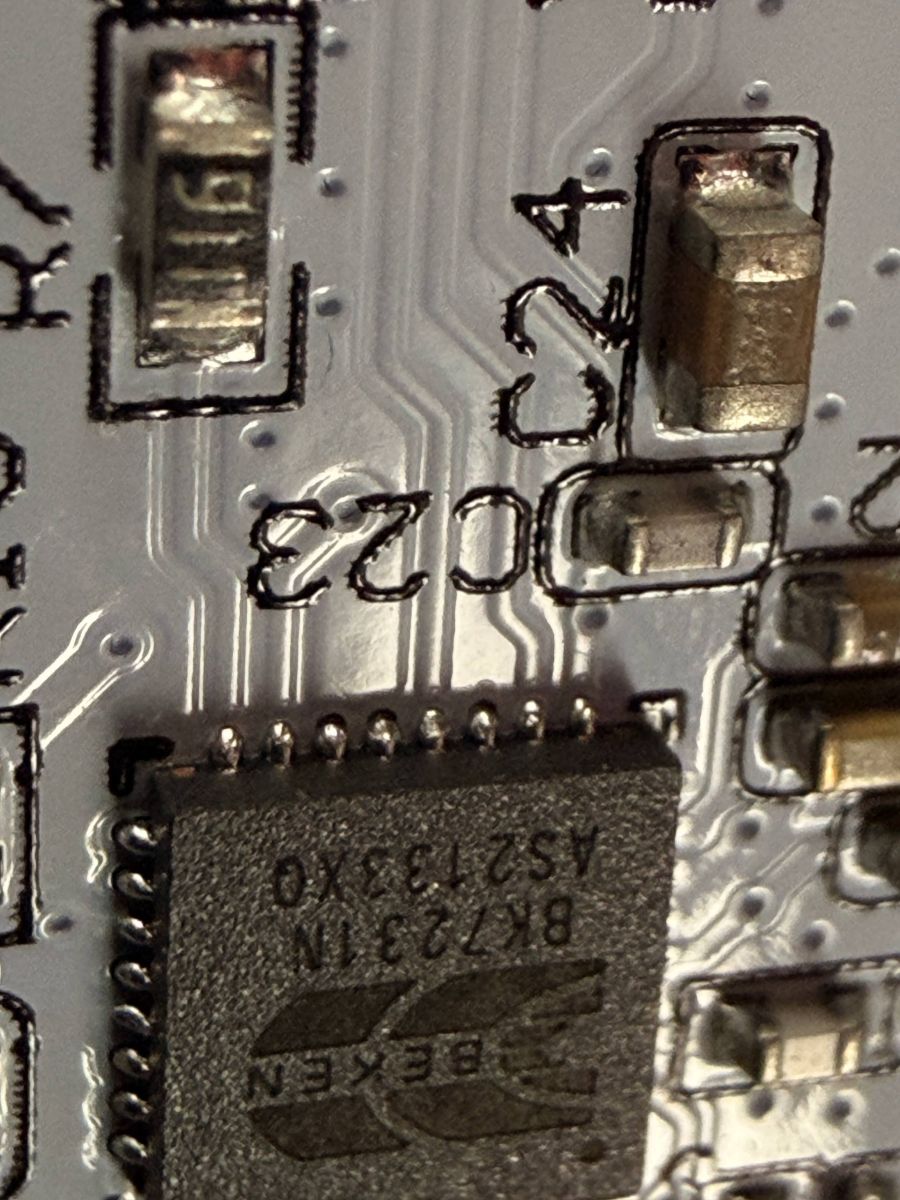

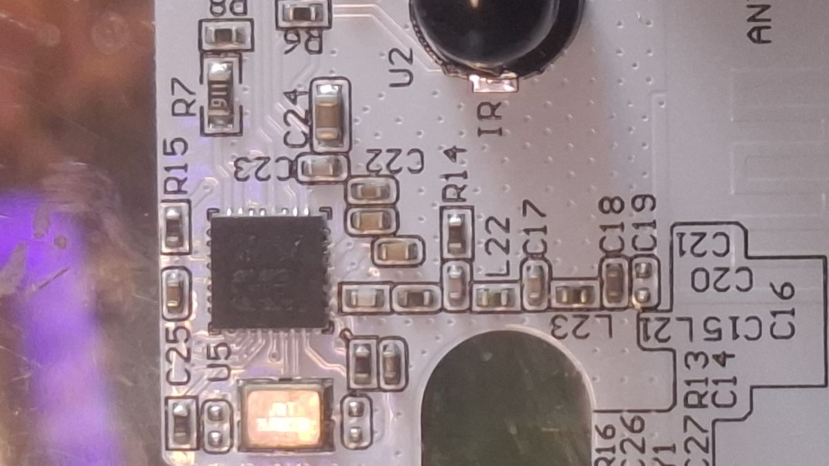

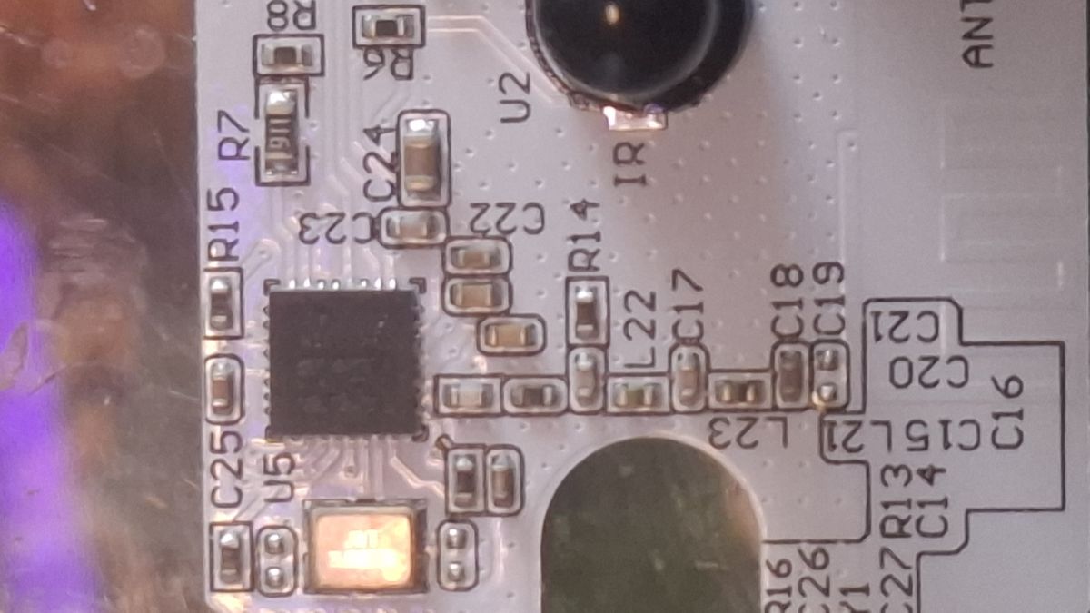

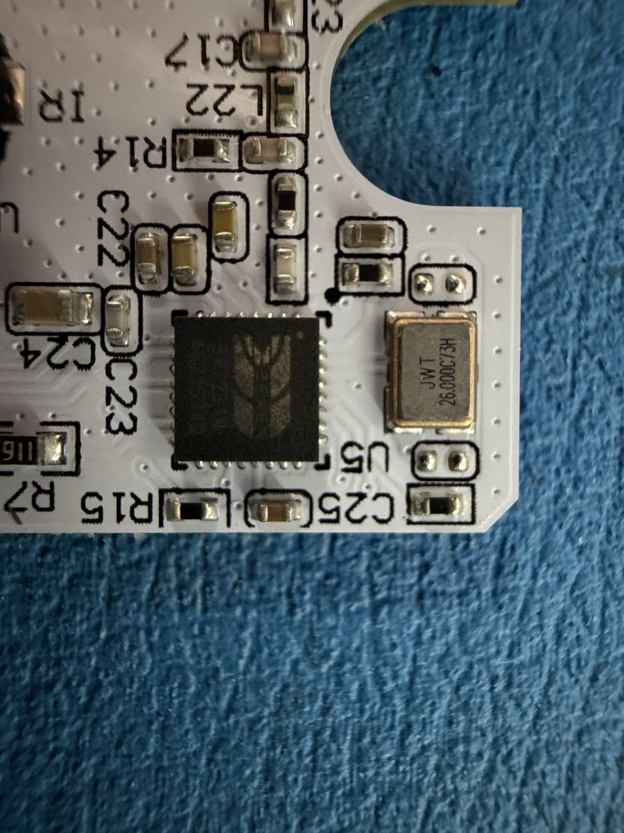

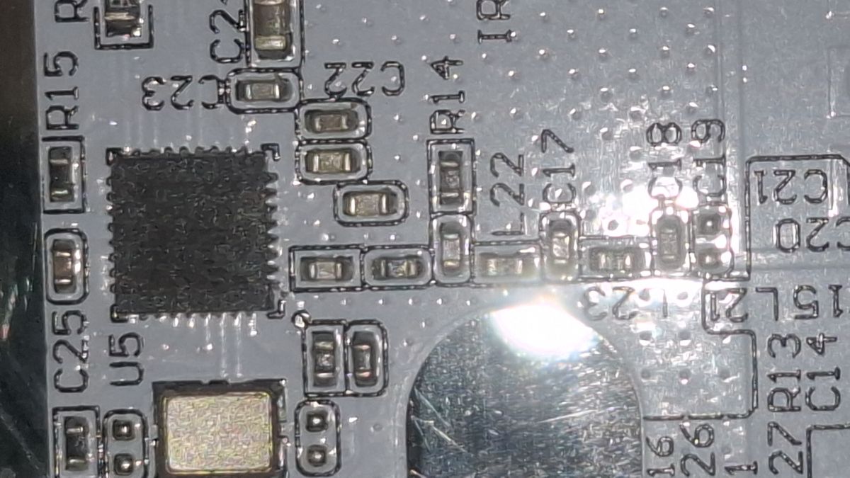

    is anyone in a position to get a nice hi-res clear image of the PCB, especially this area so the traces from each leg of the BK7231N is visible?
    Close-up of a PCB with an IC chip, SMD components, and a mounting hole
  • #12 21847470
    Diabe1337
    Level 4  
    Posts: 11
    >>21847150

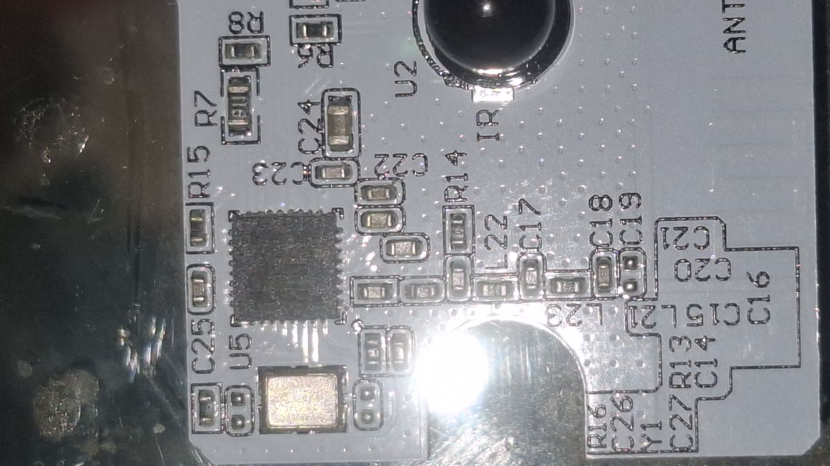

    I gotcha.
    Close-up of a PCB with a black IC and a metal can labeled 26.000C73H.
    Close-up of a PCB with SMD parts and labels R, C, U, plus a large electrolytic capacitor Close-up of a PCB with an IC and SMD parts; labels C22, C23, R15, C25 visible
  • #13 21847471

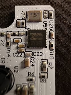

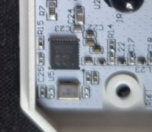

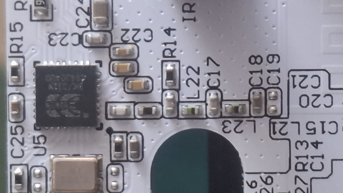

    cyclemat
    Posts: 12
    Close-up of a PCB with SMD parts and markings (R, C, U) and a black integrated circuit Macro photo of a PCB with an IC and markings R15, C25, U5, plus a bright glare on a round metallic area Close-up of a PCB with IC U5 and SMD parts labeled R14 and capacitors C17–C19 Close-up of a PCB with an IC and SMD components, showing labels R, C, L, U and “ANT”. Close-up of a PCB with an IC, SMD components, and printed R and C reference markings
    Hope it will help.
  • #14 21847486
    Posts: 5220
    Help: 449
    Rate: 918

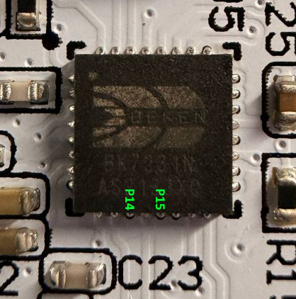

    cool, cheers. I was curious to know if any attention should be given to P14/P15
    Close-up of an IC on a PCB with visible markings C23 and green labels P14 and P15
    doesn't seem like they are connected to anything, so it seems no.
  • #15 21847490
    Diabe1337
    Level 4  
    Posts: 11
    >>21847486
    Doesn't like it, no.
    Macro photo of a PCB with a Beken IC and SMD parts; marking “C24” is visible.

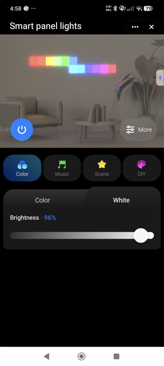

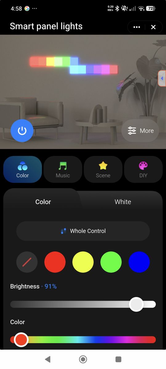

    regarding the factory behaviour of the white channel vs RGB, it kind of looks like control is separated in the Tuya app.
    Screenshot of “Smart panel lights” app with brightness slider and Color, Music, Scene, DIY modes. Screenshot of the “Smart panel lights” app showing a preview of multicolor LED panels and brightness/color controls.
    if you put white down to 0/off brightness and then play with colour settings only, does the white come on at all?

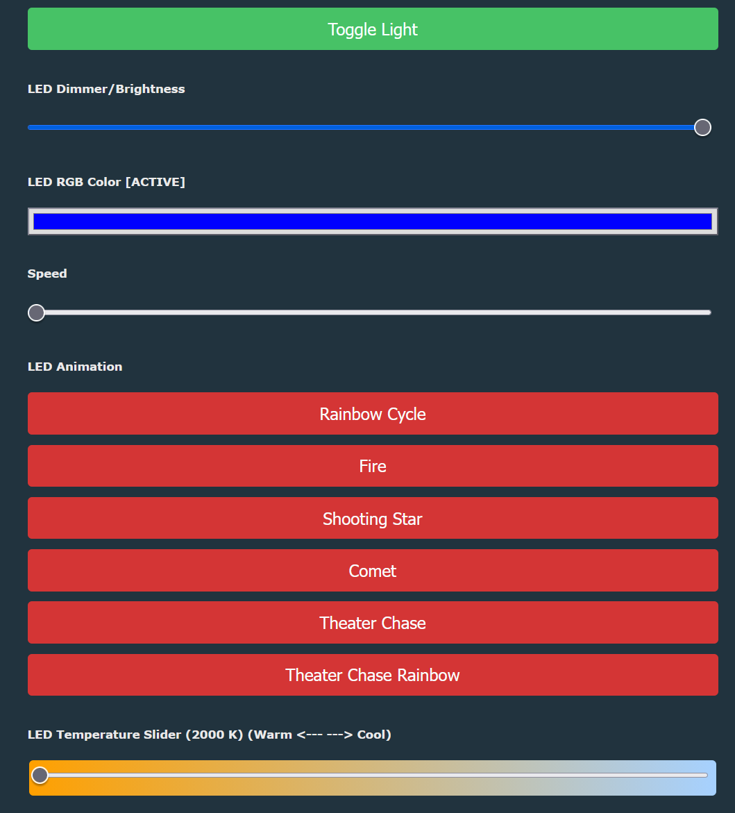

    >>21849009 Using the config from this thread, I get these controls. If I put the brightness down, nothing turns on anymore
    LED control panel with Toggle Light button, brightness, RGB color, speed sliders, and animation buttons
