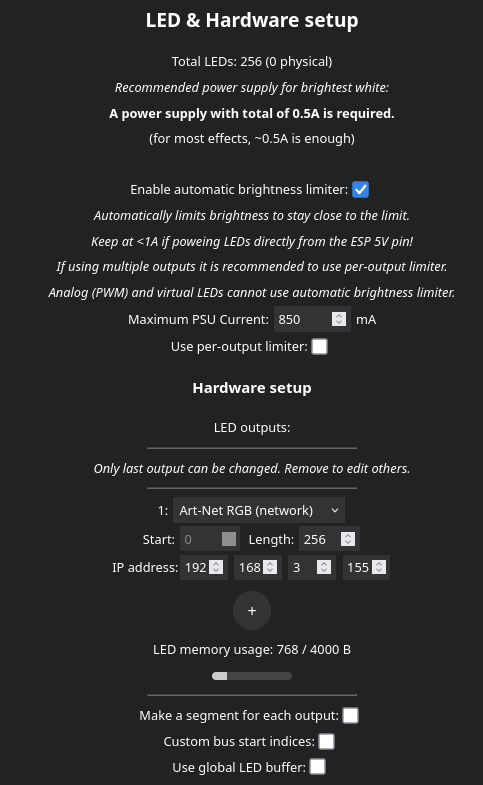

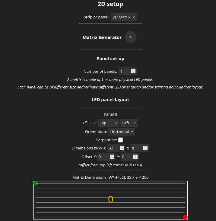

    I'd like to report on my attempt to control the TC001 desktop clock as an LED display using WLED.
    First, I flashed the clock with AWTRIX (using esptool, but it might be more comfortable via the online flasher). Once the clock is connected to the Wi‑Fi network, DMX commands can be sent to it, which are generated, for example, by WLED. I flashed and configured WLED on a D1 mini (ESP8266). When you start to send data, AWTRIX will stop its normal operation and show your data. 1 s after you stop sending data, AWTRIX will return to normal operation.
    These are my configurations in WLED:
    LED matrix setup 32x8 with horizontal layout and non-serpentine mode
    LED and hardware setup screen with 256 LEDs and brightness limiter enabled
