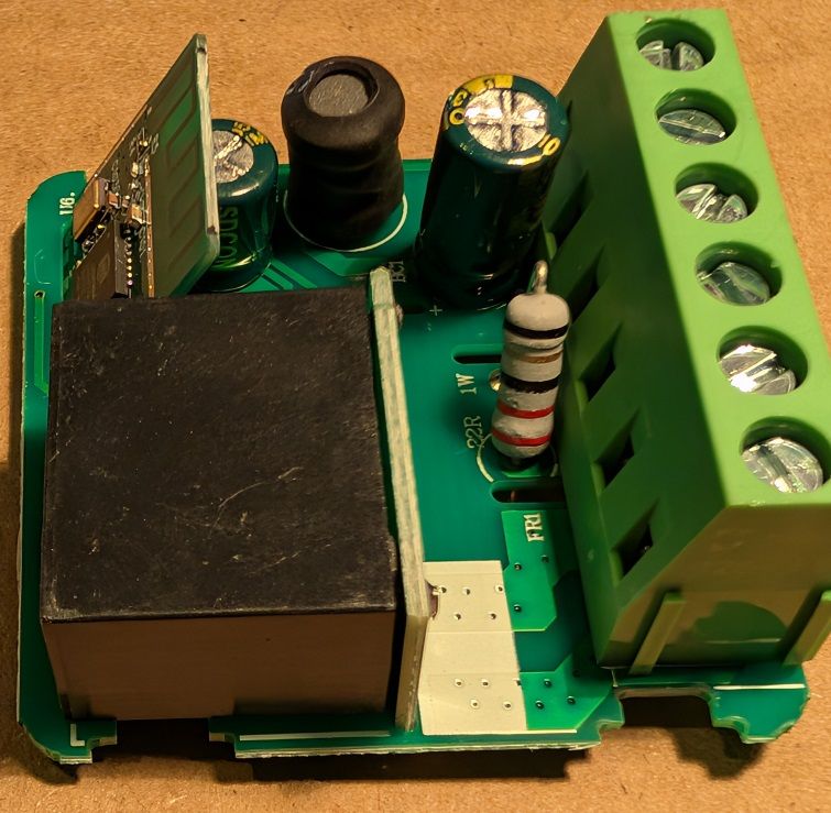

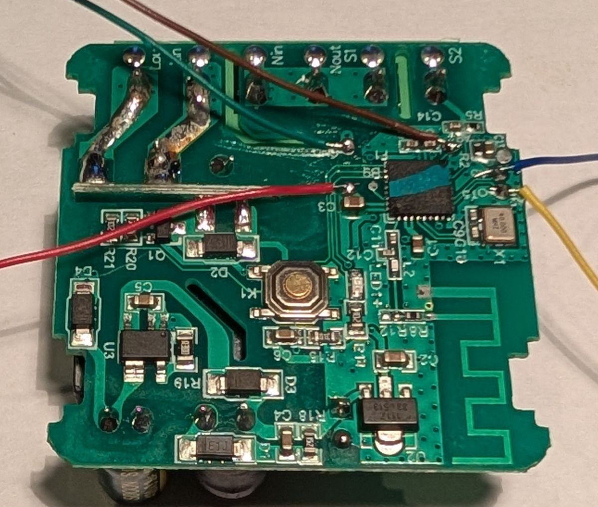

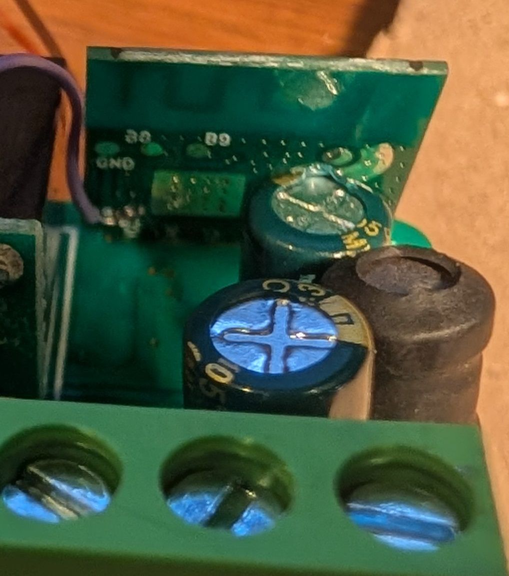

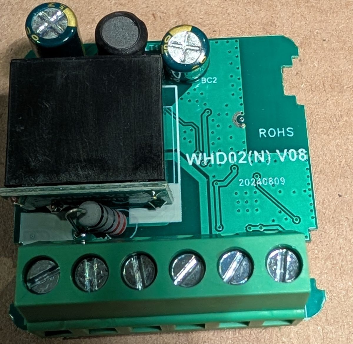

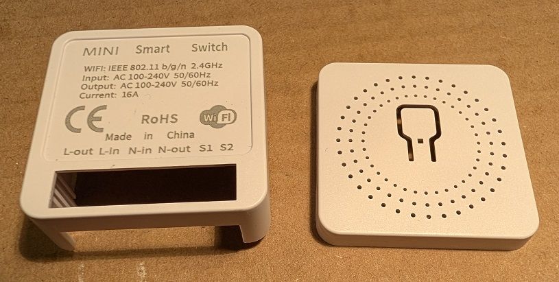

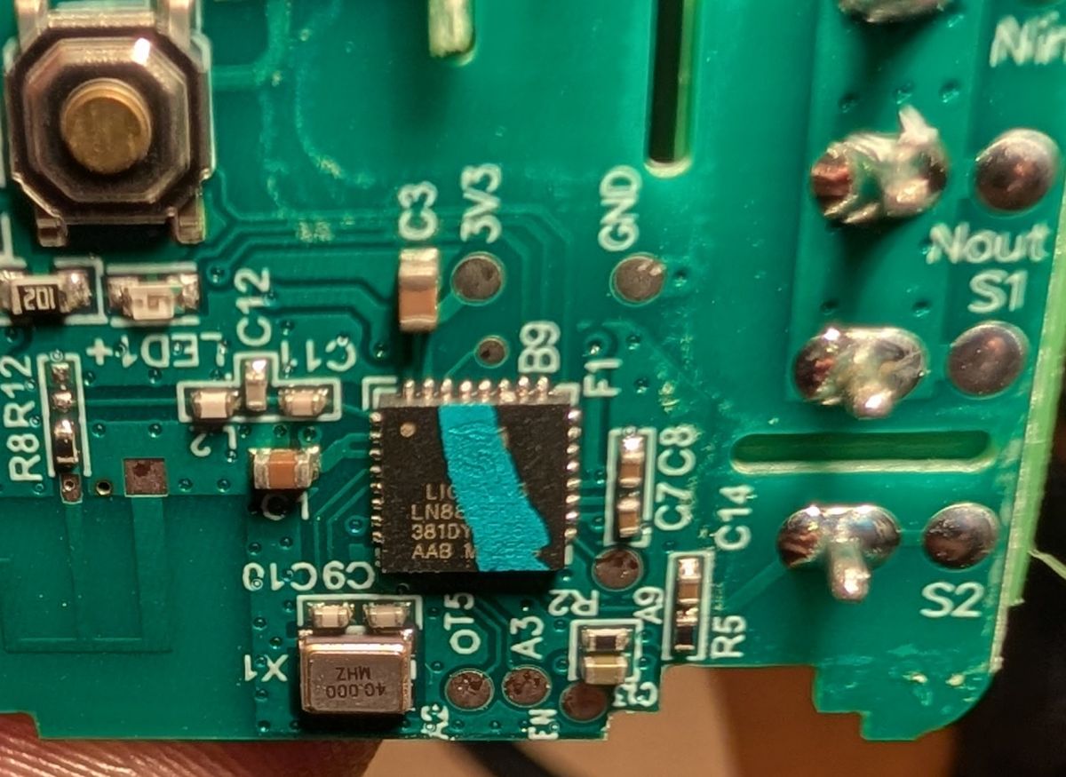

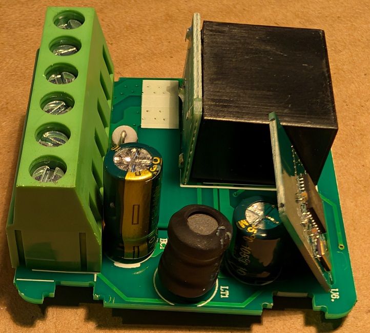

    Amazon "Haul" had these generic TUYA type switches for under $5 each so I bought six.

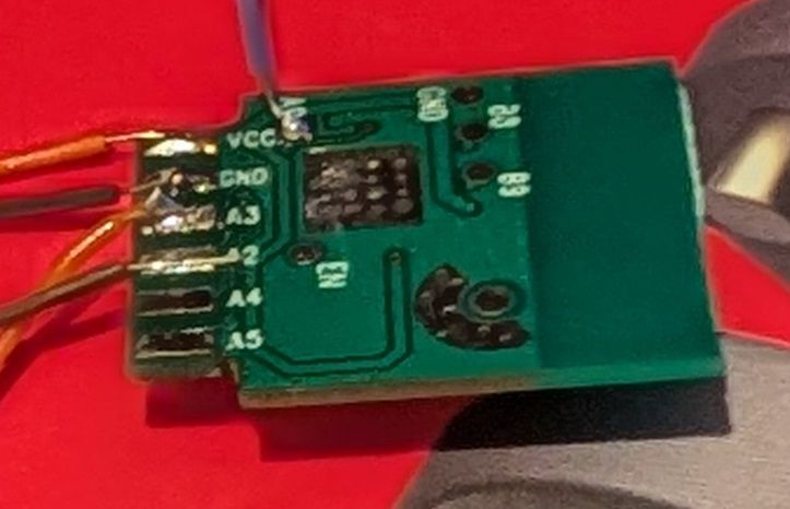

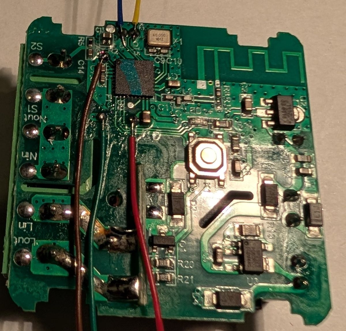

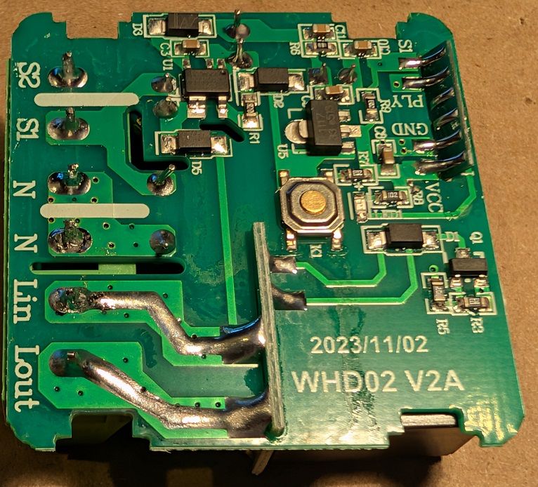

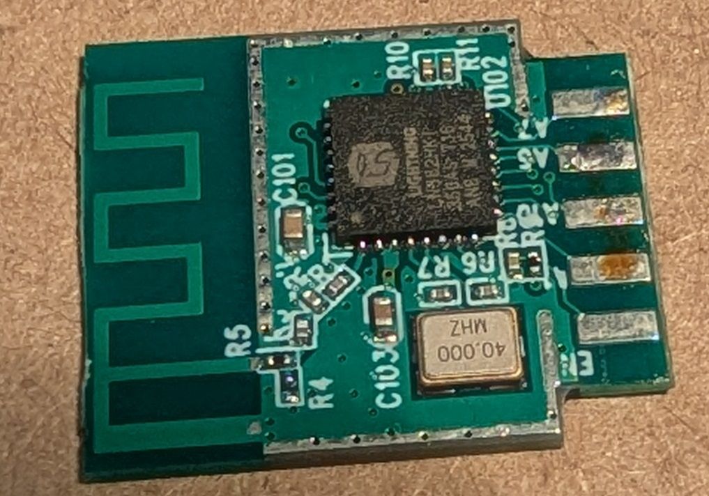

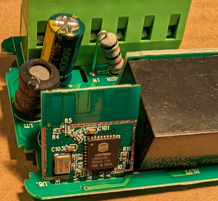

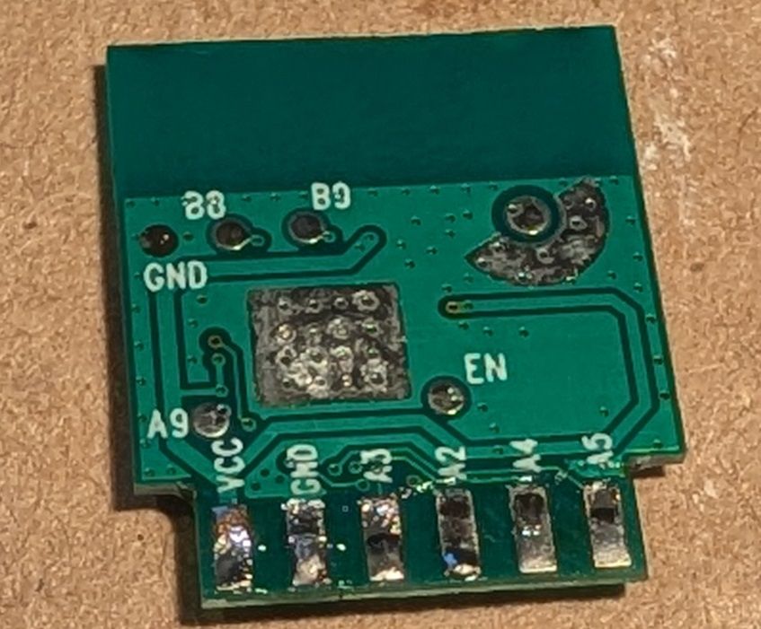

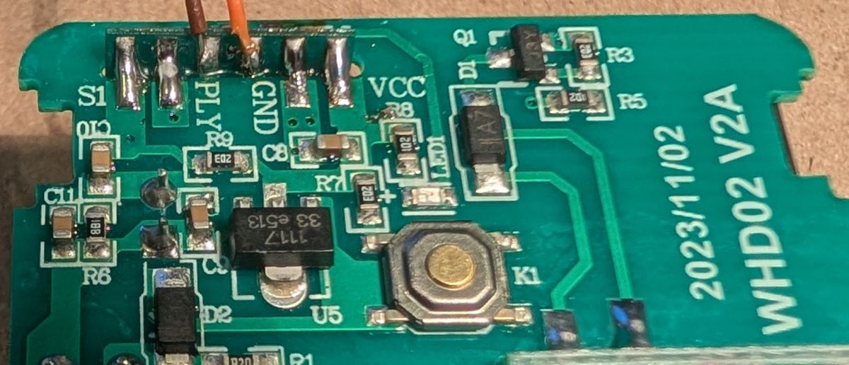

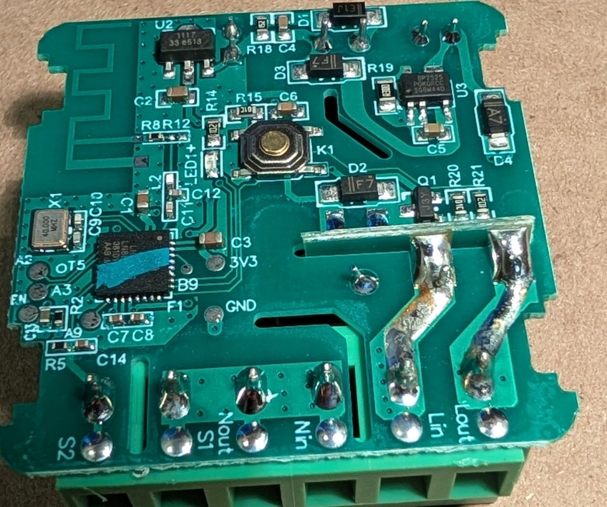

    All look identical from the outside but 4 had one circuit board inside, 2 had another. All were based on the LN882H chip. Two had a WHD02 V2A 2023-11-02 labeled circuit board with the LN882H on a daughterboard which must be unsoldered to get at the A9 pad to place it into flash mode. The four boards without the CPU daughterboard have all required pads exposed on the undersurface. That board is labeled WHD02(N) V08 20240809. The two older boards had GPIO pins 4,6,10 going to Relay, LED, Btn. The TglChanOnTgl is pin 5. The 4 newer boards had GPIO pins 19,21,20 going to Relay, Button, LED. The TglChanOnTgl is pin 7.

    OpenBekin succesfully flashed. The one with the daughter board it is easiest to desolder the daughterboard.

    Motherboard label: WHD02 V2A 2023/11/02
    Motherboard layout: two daughter boards: 1) relay, 2) LN882H daughterboard with the A9 pad (has to be shorted to ground to flash) on undersurface of daughterboard, requiring unsoldering daughterboard to access.
    "pins": {
    "4": "Rel;1",
    "5": "TglChanOnTgl;1",
    "6": "LED_n;1",
    "10": "Btn;1"
    "command": "PowerSave 1",
    Motherboard label: WHD02(N) V08 20240809
    Motherboard layout: one daughter board: 1) relay.
    Pads available on undersurface of motherboard for all flashing functions.
    "pins": {
    "7": "TglChanOnTgl;1",
    "19": "Rel;1",
    "20": "LED_n;1",
    "21": "Btn;1"
