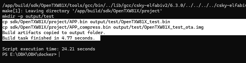

    BK7231N build time test....
    rm sdk/OpenBK7231N/platforms/bk7231n/toolchain/../bk7231n_os/tools/generate/OpenBK7231N_*.rbl || /bin/true
    rm sdk/OpenBK7231N/platforms/bk7231n/toolchain/../bk7231n_os/tools/generate/OpenBK7231N_*.bin || /bin/true
    make[1]: Leaving directory '/app/build'
    Build artifacts copied to output folder.
    Build task finished in 14.55 seconds.
    PS C:\Users\DeDaMrAz\Desktop\Docker tests>

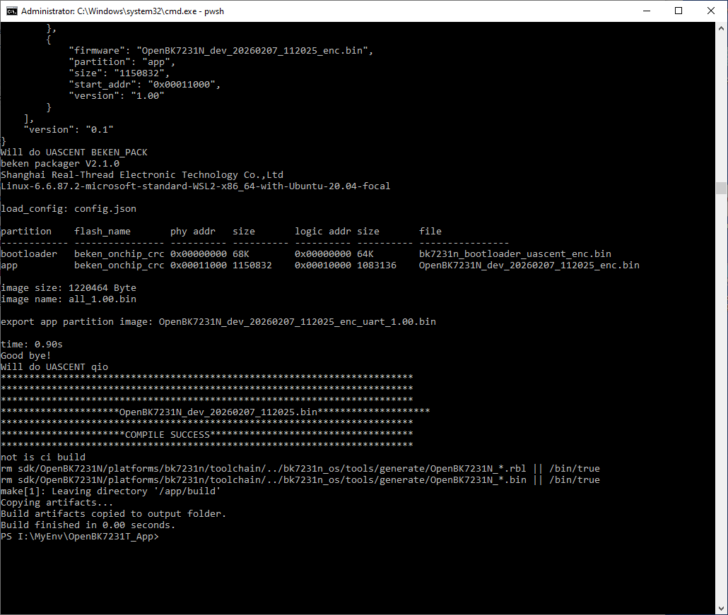

    #3 21831694
    Posts: 5220
    Help: 449
    Rate: 918

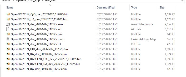

    Windows File Explorer list showing mostly OpenBK7231N .bin files plus .asm, .axf, .map, and .rbl
    Windows cmd/PowerShell window showing OpenBK7231N firmware build log with “COMPILE SUCCESS”.

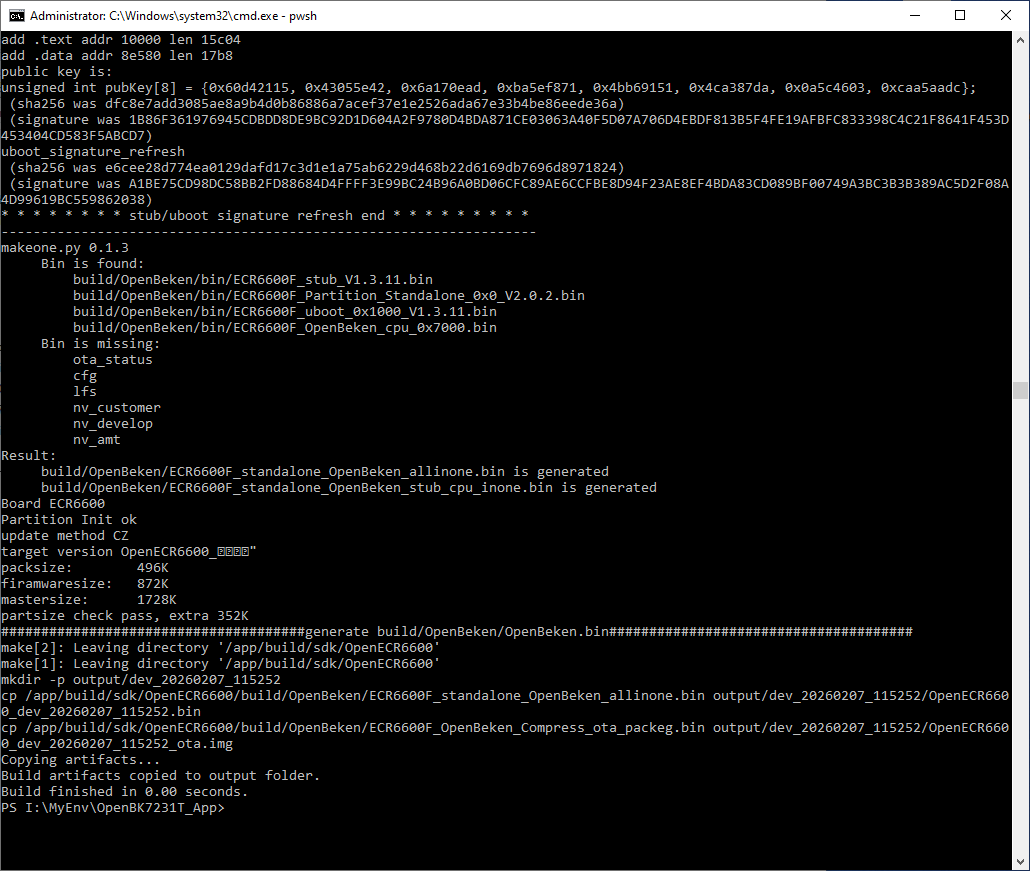

    I wasn't timing the initial build but subsequent ECR6600 with 1 random driver took less than a minute. Timer result is 0s though
    Windows console screenshot showing OpenBeken firmware build logs and generated binary files

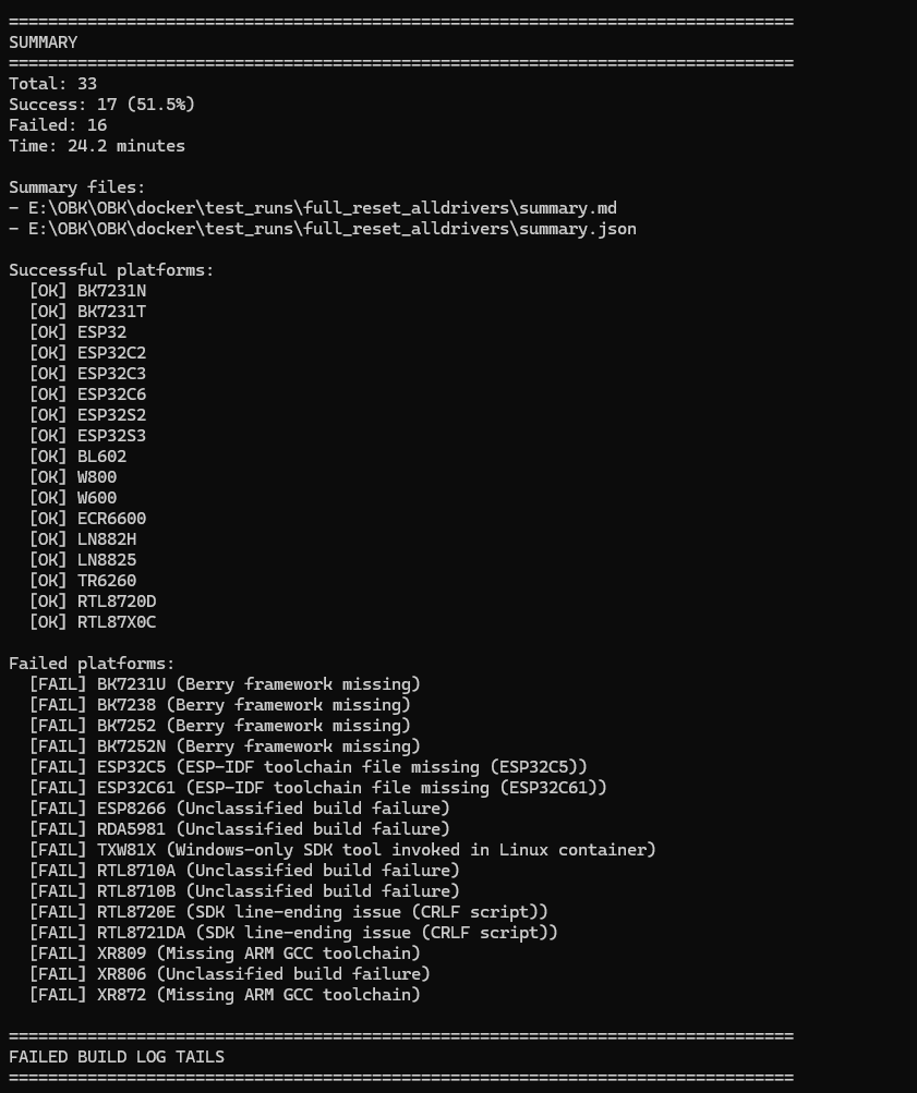

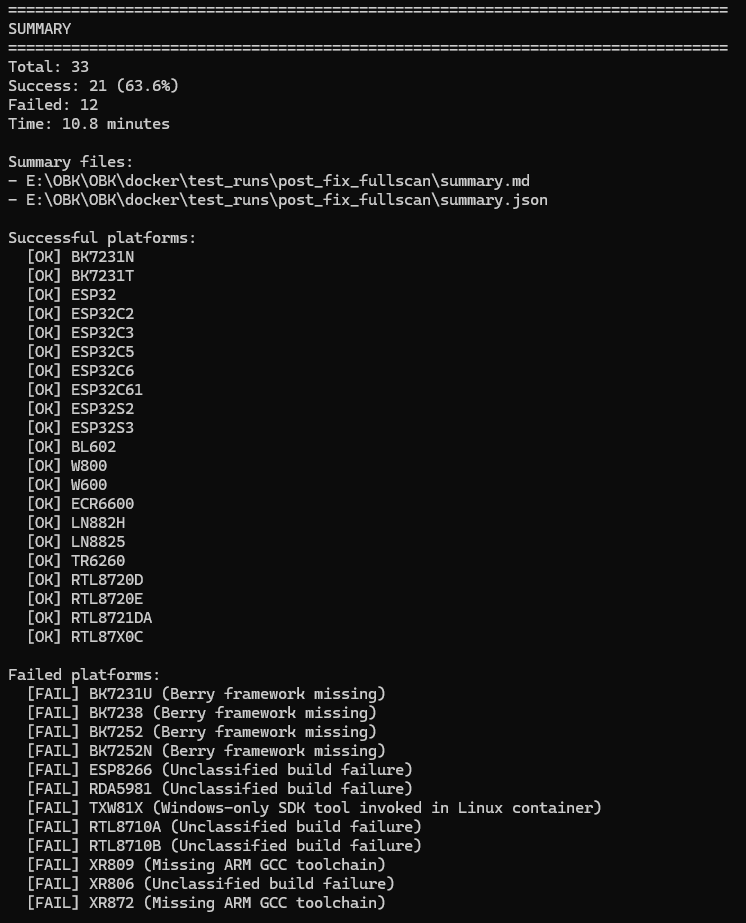

    Console screenshot with test summary: 33 total, 17 success, 16 failed, plus lists of successful and failed platforms.
    First run of the test all builds, not bad I would say, most of the failed ones are my mistake some of which I fixed already like RTL8720 and 8721, adding IDF v5.5.2 to the cached SDK's o fix ESP32C5 and ESP32C61 now and will tackle BK7231U, 38, 52 next and rerun all the tests again.
    Once I get all the platforms to build 100% with all available drivers I'll post a PR update and consider it ready to merge ( I would hope so )

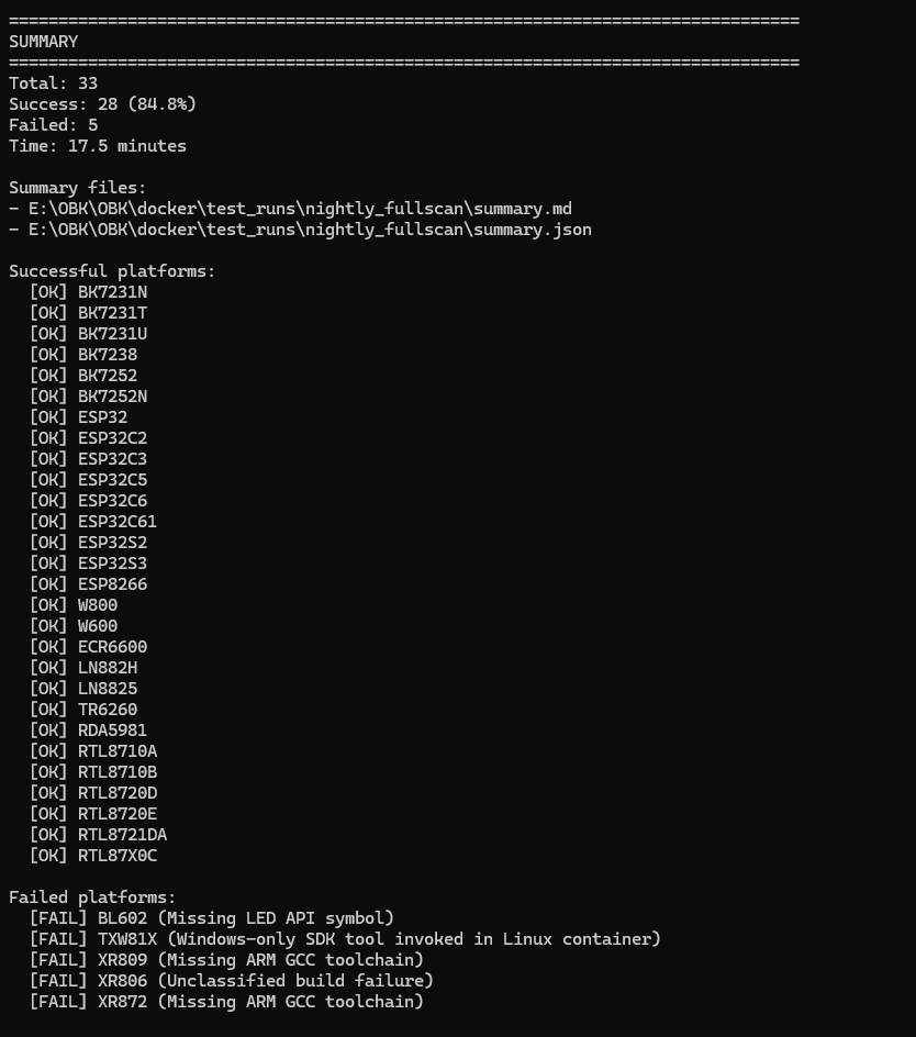

    Terminal screenshot with test summary: 33 total, 21 successes, 12 failures, plus lists of successful and failed platforms.
    Enough for tonight... success rate climbed to 84.8% + I'll fix the BL602 before I call it a night and continue tomorrow
    Terminal screenshot showing test summary: 33 total, 28 success (84.8%), 5 failed, 17.5 minutes

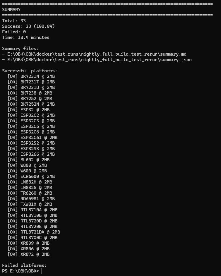

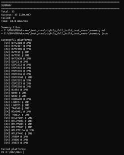

    No it is not enough, my brain would not let me sleep so I've wrestled with problematic builds and my own stupidity... came out clean on the other side (points for everyone who gets the reference)
    Full test --clean build with all drivers available on all 33 platforms is about 18 minutes (I can already see how I can speed it up even more - by not downloading certain thing for example but have them ready) each platform is building now with 2Mb default flash size ( yes I know and will do a full-nuclear test with everything form the start and flash sizes corrected at some point but I needed this win NOW!!!) After all the tests are done and completed I'll post a finished commit in the PR and I would call it done. When I find time I'll improve on the build speeds on certain platforms and maybe even create a ready made docker container from docker hub but it can wait... for now and our OBK community this is rather significant improvement (in my eyes at least), you can use python script as is or if you prefer GUI, that is available as well.
    MAJOR WARNING!!! I have tested builds on certain platforms only - not all of them!!! I tried to replicate the CI build as much as possible but be warned again - prepare for bricked modules!!!
    Console screenshot showing test summary: 33/33 success, platform list, and 18.4 minutes runtime

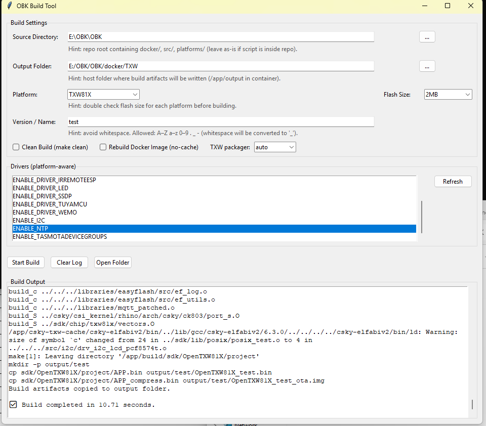

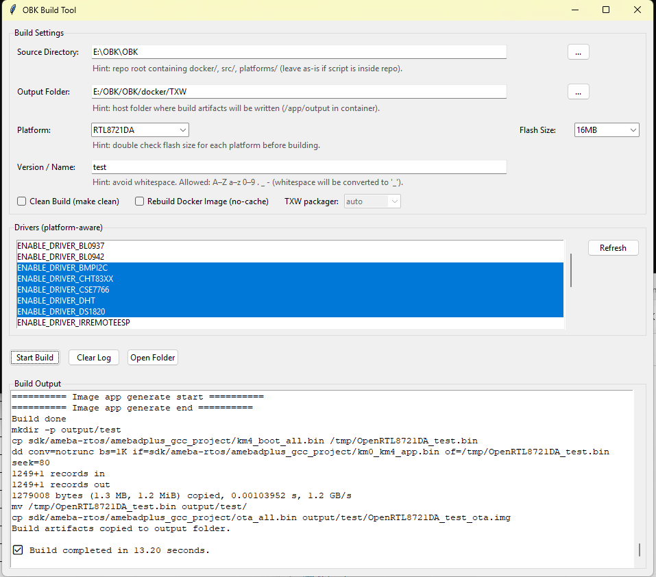

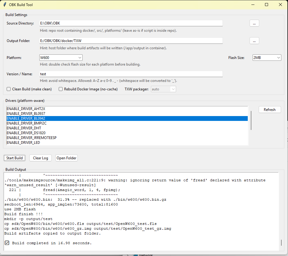

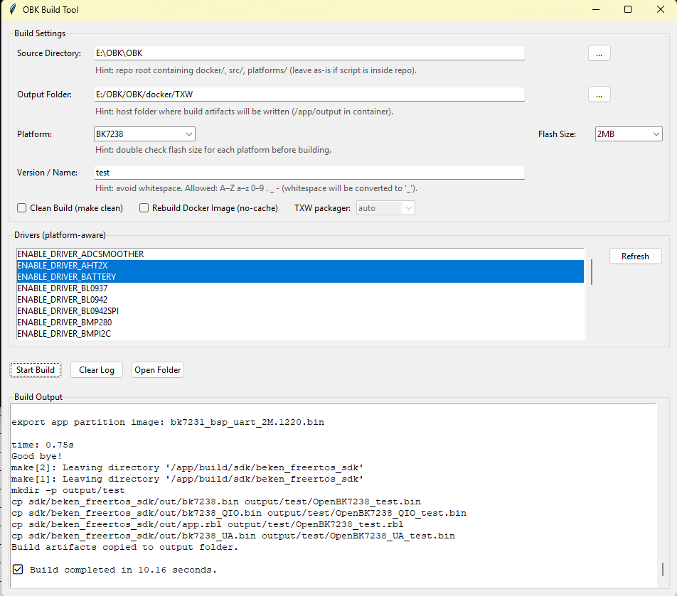

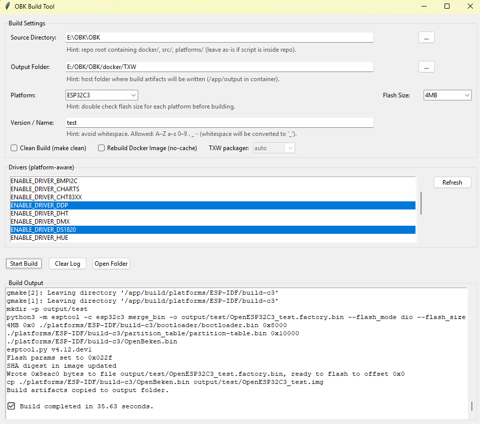

    Screenshot of OBK Build Tool with build settings and a log showing “Build completed”.
    “OBK Build Tool” window with build settings and output log showing “Build completed in 13.20 seconds.”
    Screenshot of OBK Build Tool showing build settings, driver list, and a completed build log
    Screenshot of OBK Build Tool showing build settings, driver list, and a completed build output log.
    Screenshot of OKB Build Tool with build settings and log showing “Build completed in 10.16 seconds”.
    Those are just some of the GUI tests and results, I'll prepare what is needed for the PR and commit soon.

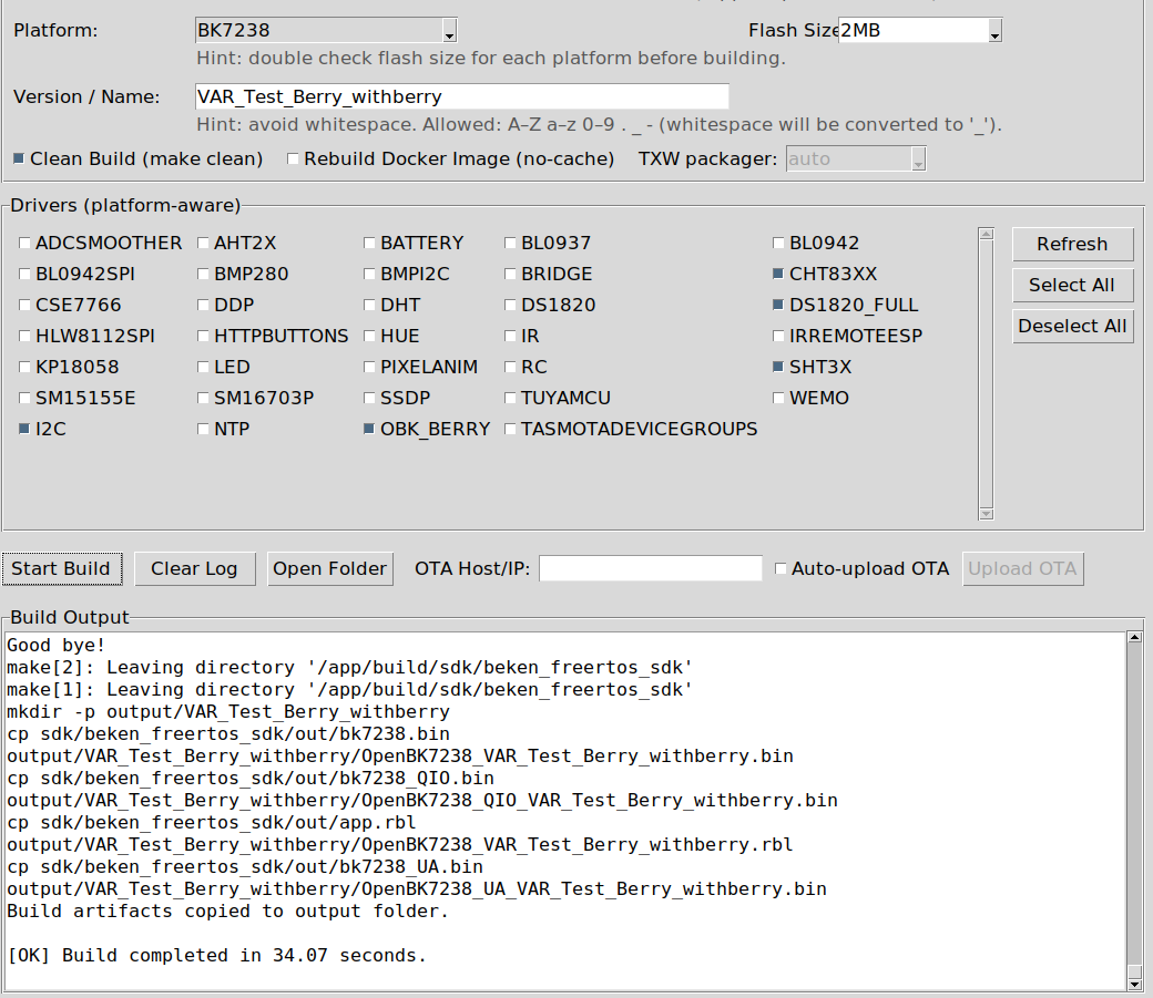

    #12 21838691
    max4elektroda
    Posts: 758
    Help: 49
    Rate: 189
    I'f I didn't do something wrong there's some todo for all platforms with "variants" @DeDaMrAz.
    Simple example: I build a BK7238 firmware with drivers
    DS1820_FULL
    I2C
    SHT3x
    Trying to start SHT3x results in:
    Info:MAIN:Driver sht3x is not known in this build.
    Info:MAIN:Available drivers:
    Info:MAIN:I2C
    Info:MAIN:, PWMToggler
    Info:MAIN:, DoorSensor

    #elif PLATFORM_LN882H
    Since we define our own config, the variants don't make sense in my eyes.
    Here's my idea to solve this:

    Remove all "OBK_VARIANT" lines and the matching "#endif" lines plus all "#undef" inside the block.
    Also added "berry" as an additional choice.
    Screenshot of firmware build tool: BK7238 platform, driver checklist, and log showing “Build completed”
    At least for BK7238 it works now ...
    Info:SENSOR:SHT : Status : FF FF
    Info:MAIN:Started sht3x.
    Info:CMD:[WebApp Cmd 'startdriver sht3x' Result] OK
