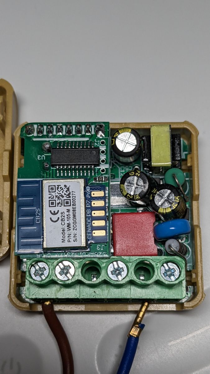

    Here's a photo with the cover removed as well:
    Close-up of a circuit board with CB2S module, capacitors, and a green screw terminal block inside a case
    You can see it's a "CB2S" chipset.

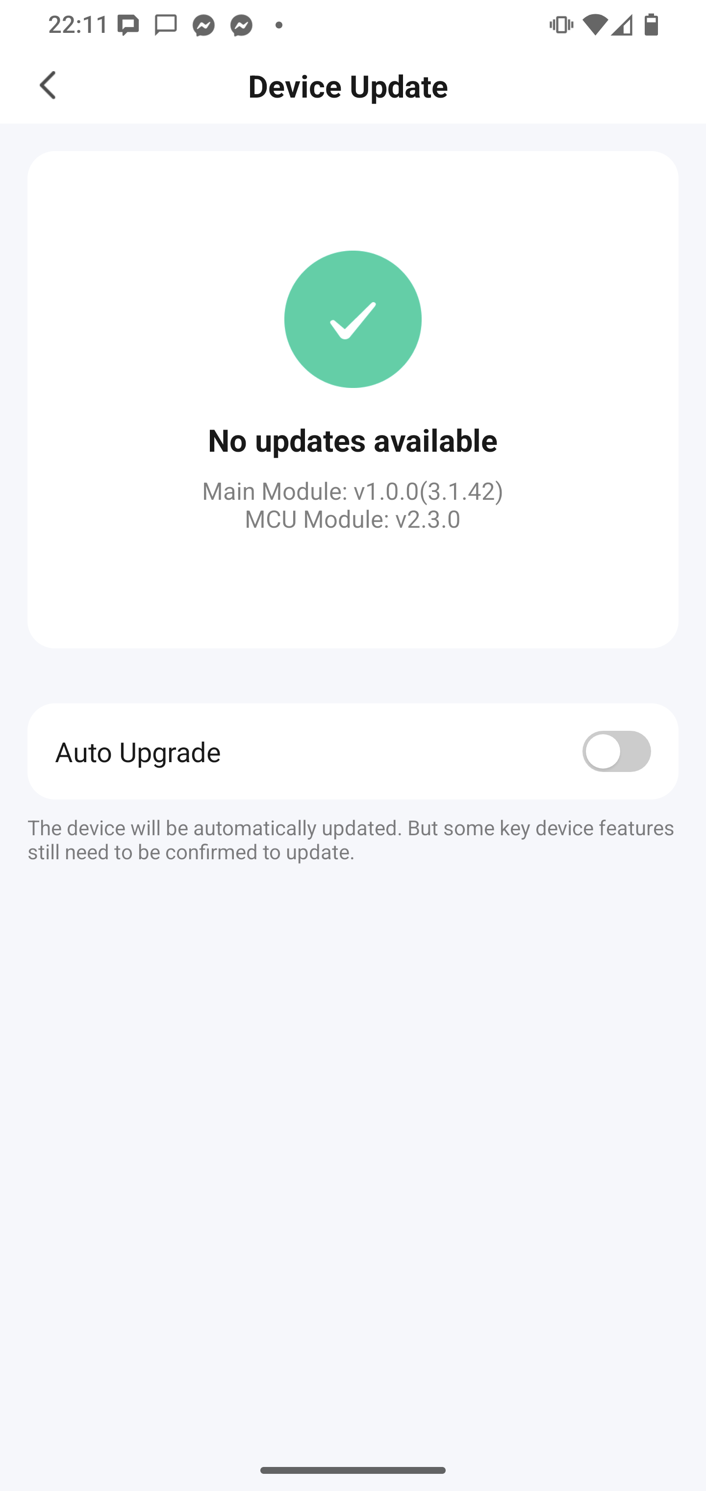

    I was planning to use tuya-cloudcutter to reflash them with ESPHome; however, I got a bit stuck as I wasn't sure if the version was supported or not.
    I did pair the dimmer module with the Tuya app, and it shows the Main Module version as "v1.0.0 (3.1.42)".
    “Device Update” screen showing “No updates available” and an “Auto Upgrade” toggle
    Do I simply ignore the "v1.0.0" and take "3.1.42" as the SDK version? Should I assume that version is unsupported?

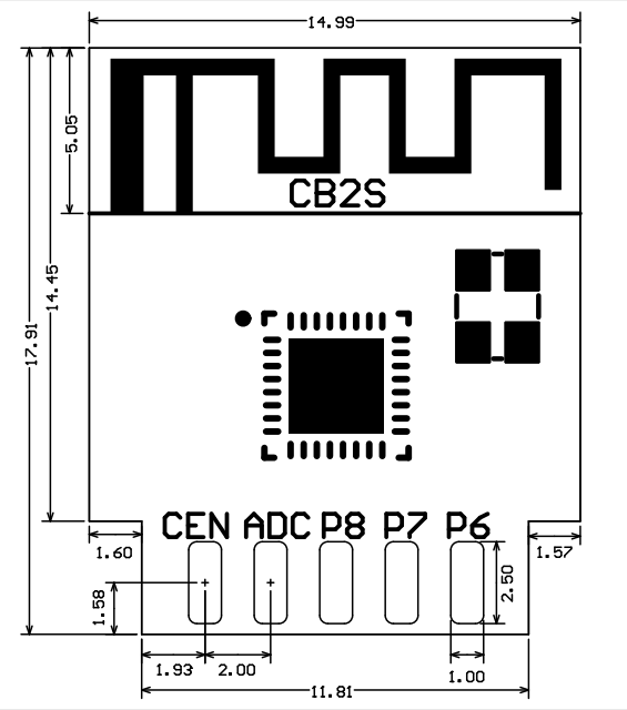

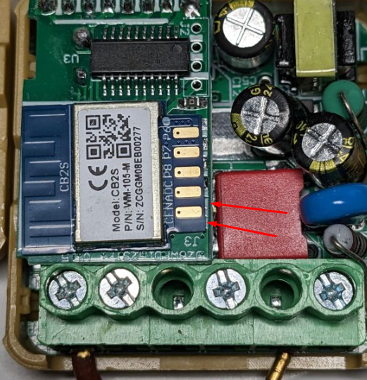

    I do see there are five gold pads on the top labelled "CEN", "ADC", "P8", "P7" and "P6".
    However, checking the CB2S Datasheet, it seems like the debug pads I actually want are on the underside?
    Technical drawing of a module with antenna pattern, “CB2S” label, and dimension markings.
    Does that mean I'd need to desolder the entire module off the daughterboard to try to reflash it?
    Or is there perhaps another simpler way?

  • Guessing UART pads on the top board
    #2 21834068
    Posts: 14771
    Rate: 12914
    This device may be using TuyaMCU, so it should have RX and TX routed to the IC on the top board. The only issue is that you don't actually know which pins are RX/TX... so you can only guess... maybe you could check with multimeter which pads are VDD and GND, and maybe two ones left will be UART? Still, it's just guessing, not reliable.
    Wait, isn't it a solder? Is there a contact?
    Close-up of a PCB with a CB2S module, capacitors, and a green screw terminal block
