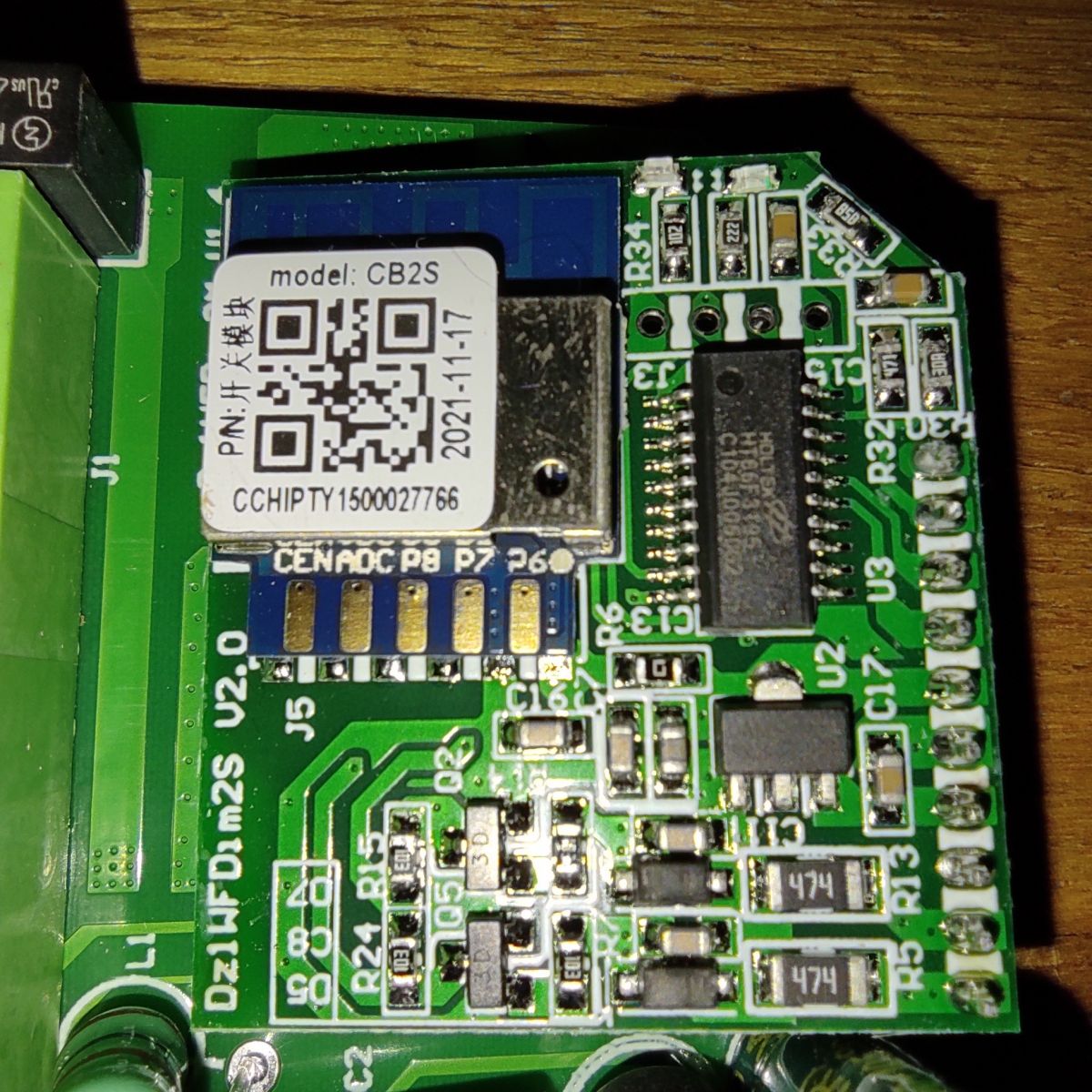

    What's inside?
    Image of an open MoesGo MS-105B dimmer module with visible internal electronics on a wooden surface.
    Close-up of the inside of the MoesGo MS-105B smart dimmer module showing electronic components.

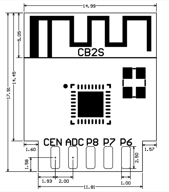

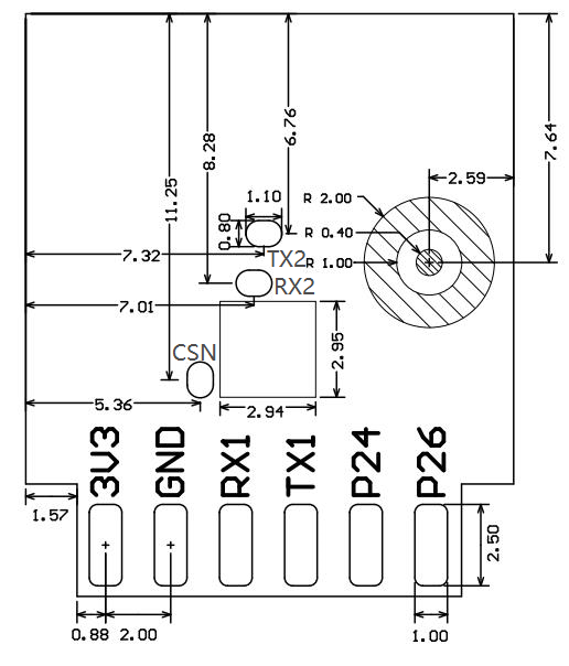

    As you can see, it uses CB2S Tuya Module (BK7231N)
    Diagram of CB2S module with pin labels.
    Diagram of an electronic module with pin labels and dimensions.
    and Holtek HT66F3195 microcontroller.

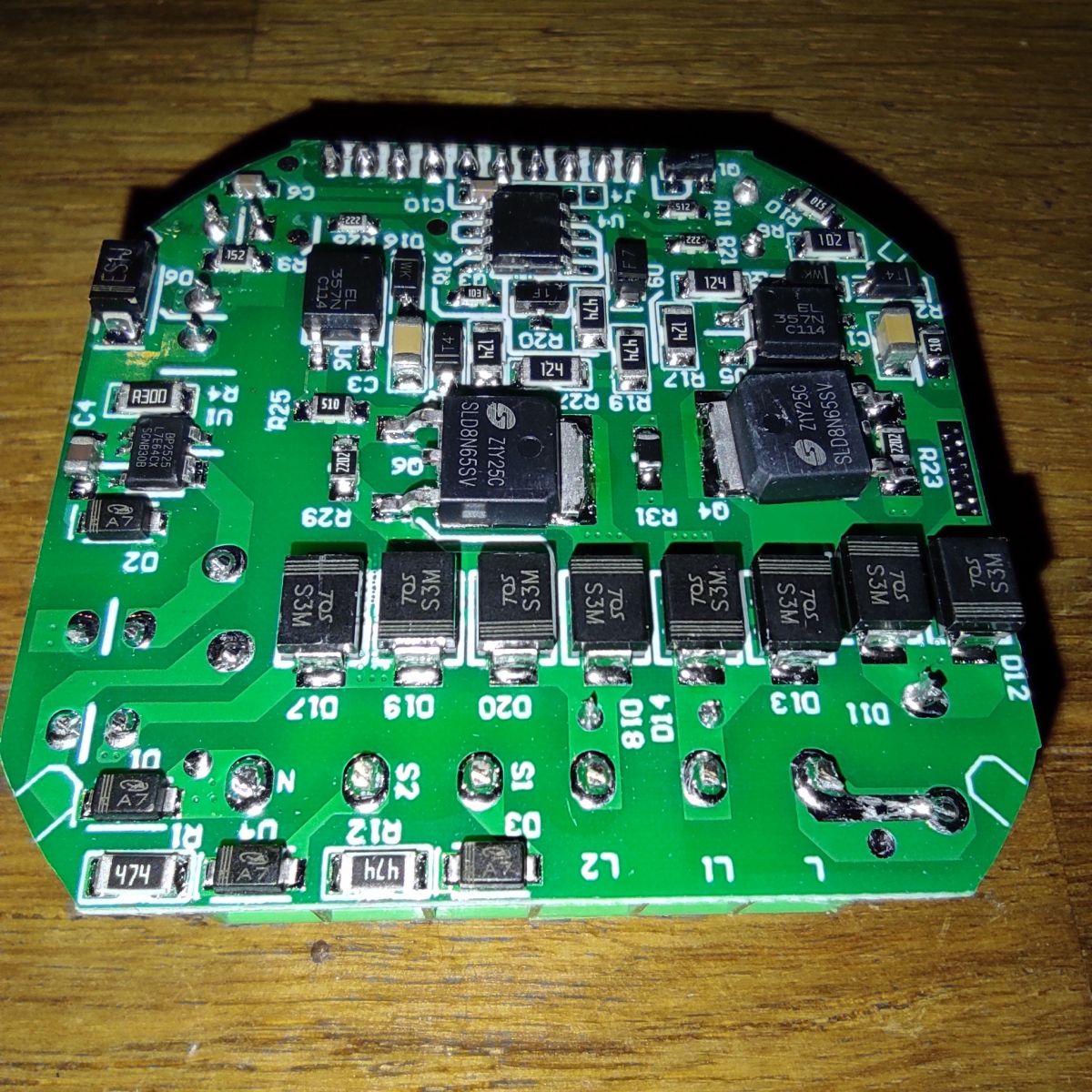

    The power section consists of two SLD8N65SV MOSFETs (650V, 7A@25°C, 1.1Ω) and two rectifying bridges built with S3M diodes (1000V, 3A).
    Printed circuit board of the MoesGo MS-105B dimmer module with components.

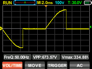

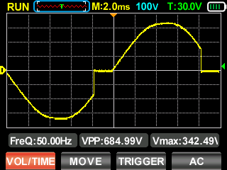

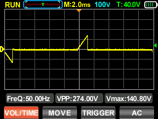

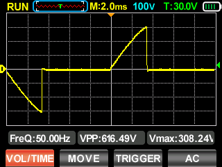

    MS-105B is a trailing edge dimmer. Below are the voltage waveforms for 1%, 30%, 50%, and 100% settings in the Tuya application (77W halogen light bulb used as the load):
    Oscilloscope screenshot showing voltage waveform for MoesGo MS-105B dimmer module.Oscilloscope graph of a voltage signal.
    Oscilloscope showing voltage waveform for MoesGo MS-105B dimmer.Oscilloscope screenshot showing a voltage waveform.

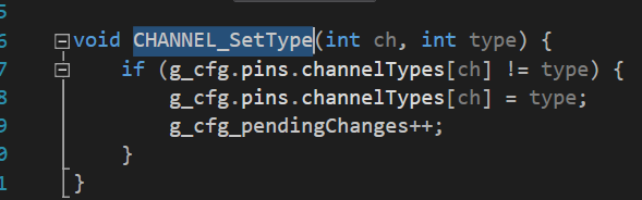

    leśny_ziutek wrote:
    Both are of value type so I don't think so.
    Info:TuyaMCU:TuyaMCU_ParseStateMessage: processing dpId 6, dataType 2-DP_TYPE_VALUE and 4 data bytes
    Info:TuyaMCU:TuyaMCU_ParseStateMessage: processing dpId 12, dataType 2-DP_TYPE_VALUE and 4 data bytes
    This may be the minimal brightness setting, maybe it's a separate value for each dimmer. You can try if you feel brave
    leśny_ziutek wrote:
    So leaving them in autoexec.bat isn't recommended because of increased Flash wearing.
    Flash writes are optimized, flash is written only if there is a change, and futhermore we try to save many changes with one write:
    Screenshot of a code snippet in C showing a function that sets the channel type.
    your script will not cause any flash wear

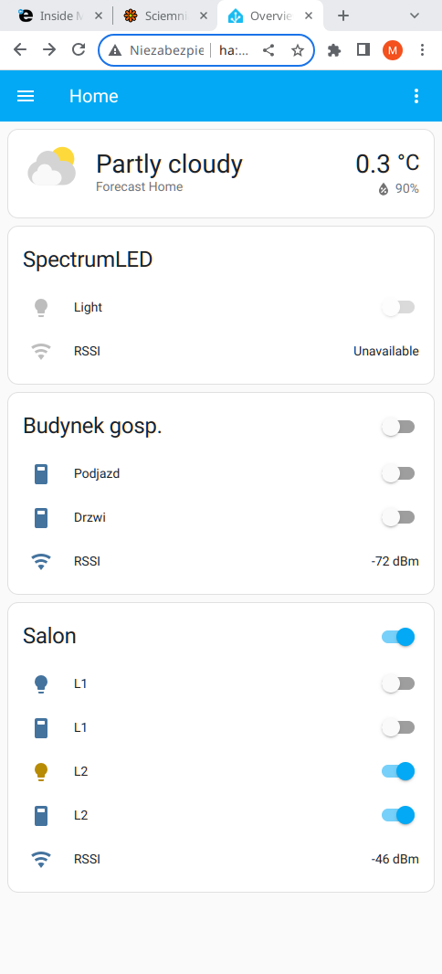

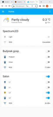

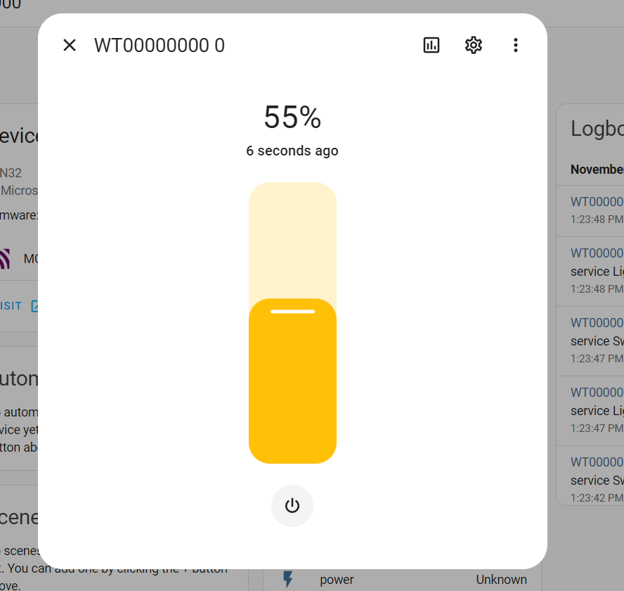

    I've tried to add this dimmer to HA.
    In the Home Assistant Configuration, the CMD window is empty. When I started the HA discovery, there were 4 switches detected (two switch icons and two light bulb icons) and an RSSI sensor. There isn't any dimming control, only on and off.
    There are 5 retained configuration messages in my MQTT broker:
    Home Assistant user interface with switches and sensors.
    Feature request
    Per channel tuyaMcu_setDimmerRange command would be useful.
    I have two different dimmable LED bulbs (Philips, Osram). With one global mapping command, there is no way to make them work similarly.
    #24 20838604
    Posts: 14612
    Help: 655
    Rate: 12629
    It seems that you've found a bug. It should be fixed now. The correct JSON to be published is:
    However, I think that dimmer control should work for you even if you click the light. Your code also indicates that:
    User interface showing dimmer control at 55%.
    Still, the two extra relays were published incorrectly.
    Can you check this build:
    https://github.com/openshwprojects/OpenBK7231T_App/releases/tag/1.17.326
  • #25 20838746
    leśny_ziutek
    Posts: 52
    Rate: 9
    Upgraded to the latest release.
    Now I've two light bulb controls and an RSSI sensor:
    As for dimming in HA, it could be due to my clumsiness in using it. I'm still learning...
    Now everything works like a charm. Thanks!
    There is also BK7231N/SM2185N topic that may be ready now to add the another supported device.

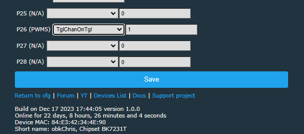

    This is TuyaMCU device, but you can make a work around. If you connect a wire to, for example, P26, which is not used yet, and add a rocker switch between P26 and GND, you can later set P26 pin role to TglChannelOnToggle (or to a Button, if you want to click) and us it to toggle, for example, channel 1:
    Screenshot of a device configuration interface with pin settings.
