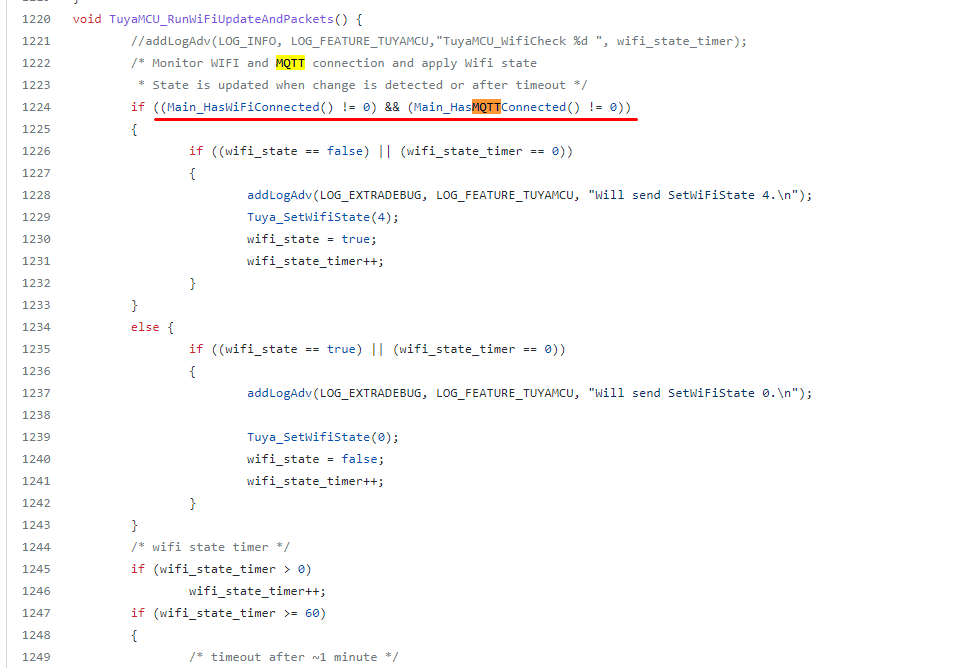

  • #8 20349869
    Posts: 14724
    Rate: 12807
    So you had no MQTT for whole time?
    Is it functional now?
    It might mean that... it beeps while WiFi state is 0, and stops when it's 4:
    Moes Wi-Fi 2 Gang Dimmer Module: OpenBK7231T WebGUI and CB2S Chip Configuration
    The only problem is I am not sure what to do with that. Maybe I should send something else than 0 in case that MQTT is off...
