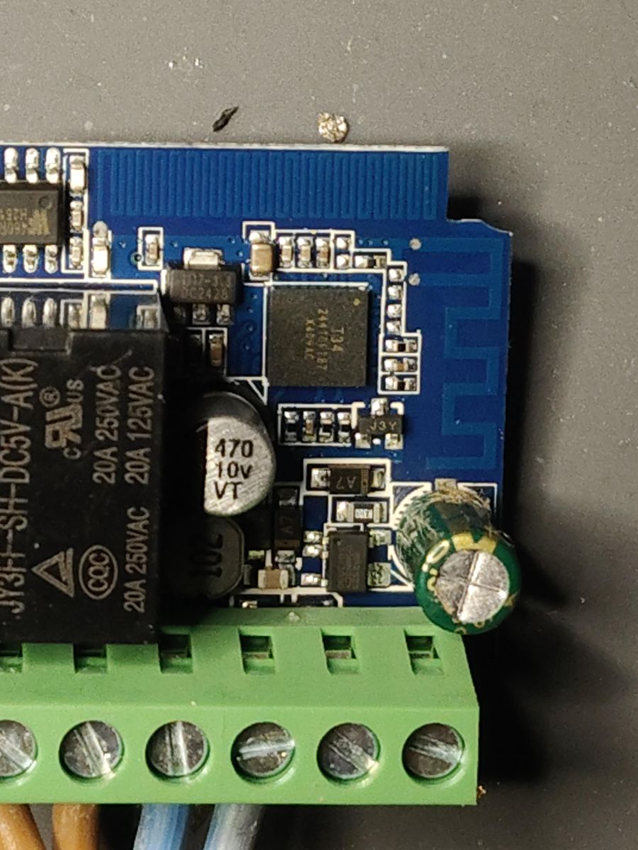

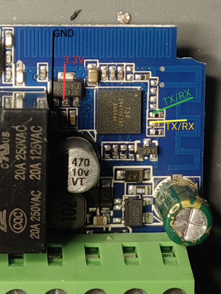

    A smart switch device with Wi-Fi and RF 433. It uses a T34, but the pins are not visible. I managed to figure out the 3.3 V, GND, TX, RX pins, but I still need to figure out where the CEN is connected to boot the flash chip. Has anyone managed to flash this device where the T34 pads are not visible? I've attached some images to help you understand better.

    I have already tried to use the multimeter and by using it I was able to find the 3.3 V, GND, TX and RX pins, but I can't find the CEN pin

    CEN is not essential. You can simply power-on (3.3v) or power-cycle the device while Easy Flasher is waiting for connection
  • Corrected RX/TX pin locations under the T34 chip

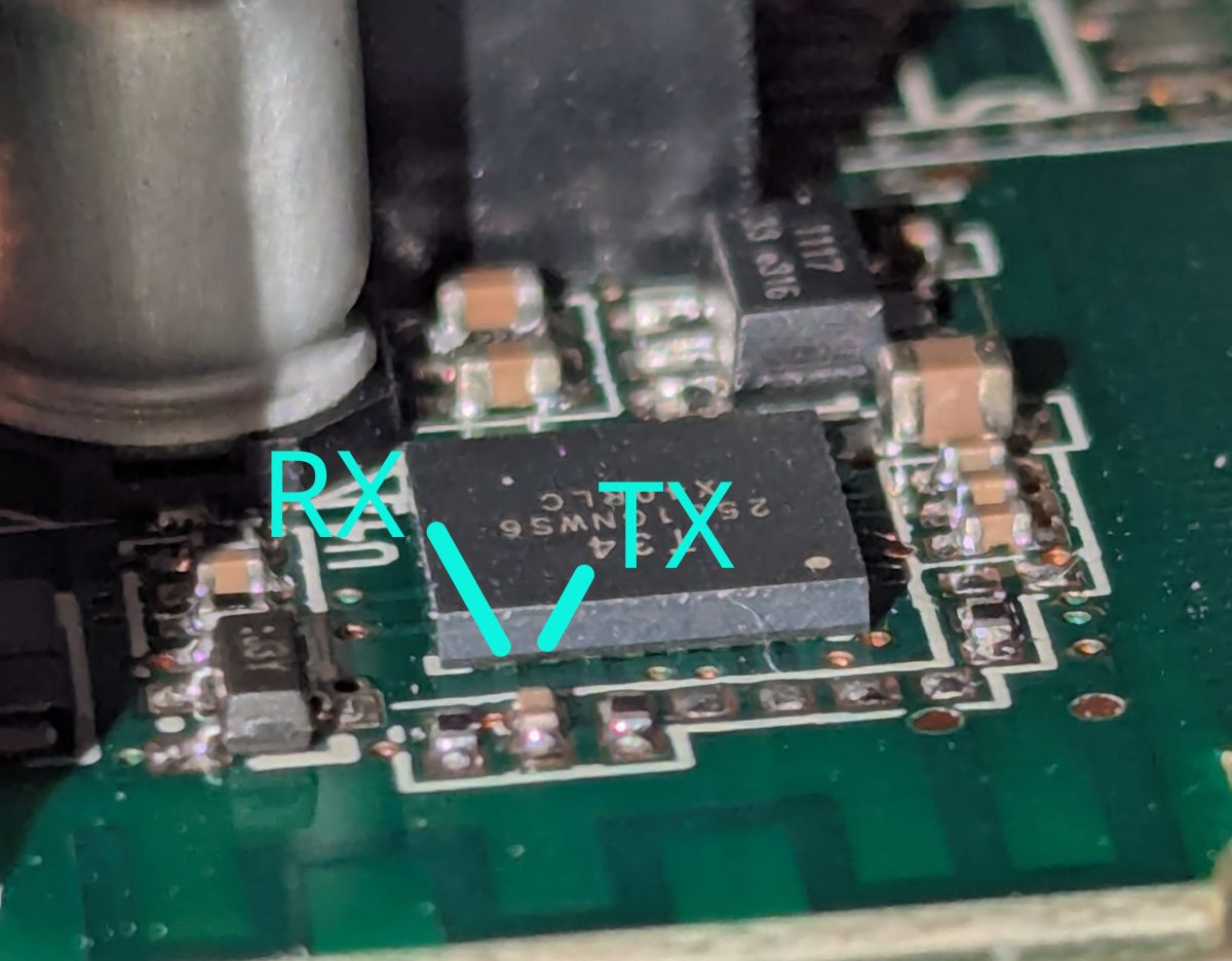

    I've recently ordered a bunch of the same switches in the hope of receiving a version where flashing would be relatively easy, but instead I got this version with the T34 too.
    There already is a forum post on flashing this exact type of Wi-Fi smart switch:
    https://www.elektroda.com/rtvforum/topic4079733.html#21705064
    There are blue and green PCBs with identical layouts.
    Sadly, you have misidentified one of the pins. The one you've marked in yellow is RX, while TX is the pin between the two you've marked. It is completely hidden under the chip, hence there is almost no option other than desoldering and resoldering it using hot air. Someone managed to flash it by sticking a very thin wire underneath, just enough to make contact with the TX pad. However, I myself did not have any success with this method.
    Below is the correct location of the RX/TX pins from one of the boards I got. The batch was mixed with green and blue boards.

    Desoldering and re-soldering the T34 chip correctly is too difficult and risky for me because I've never done it before, so I'll just use it as is. Thanks, everyone, for the replies.
