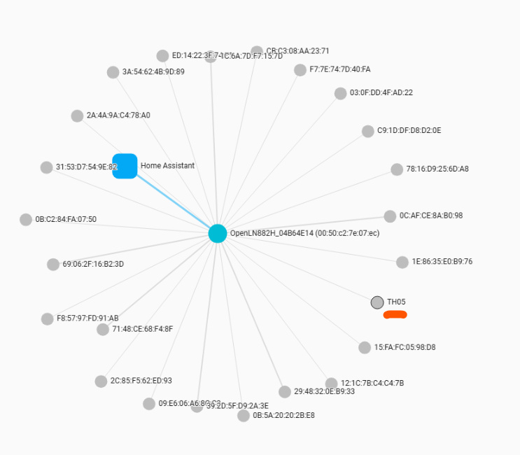

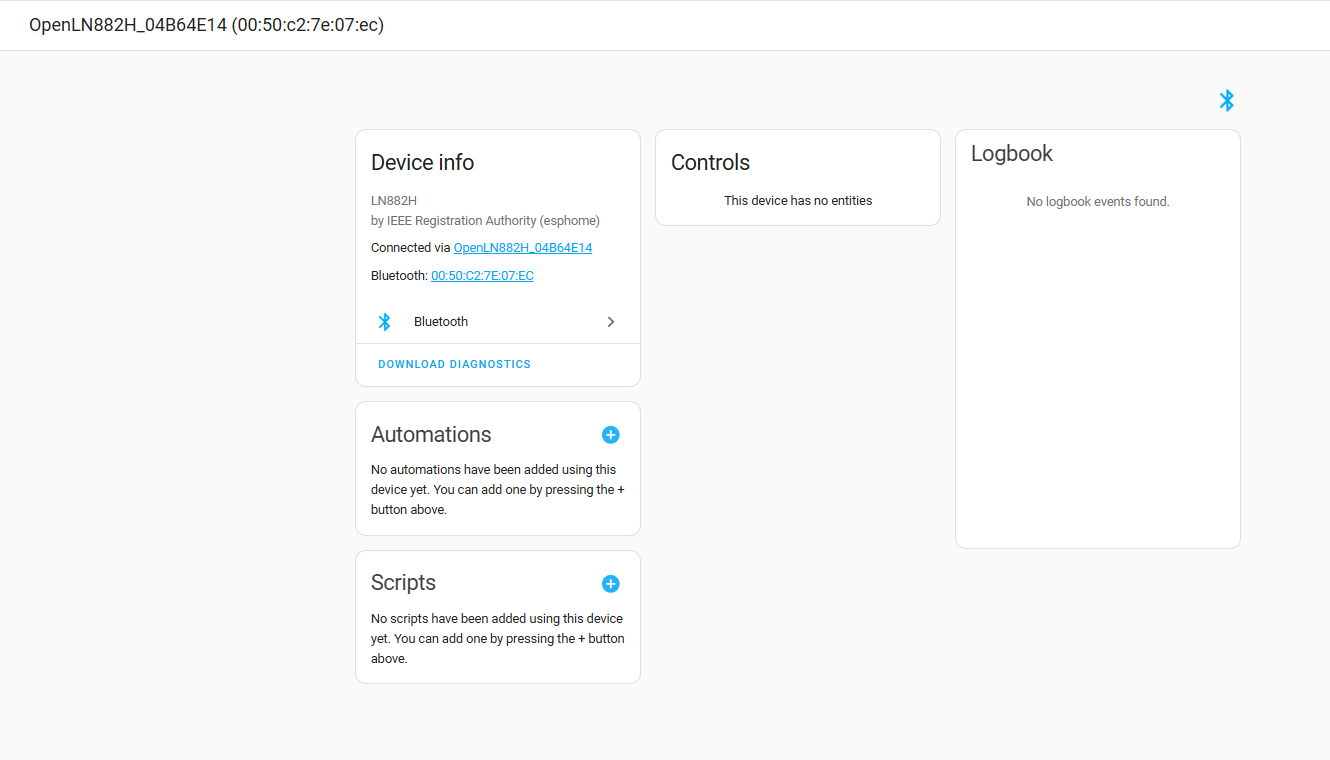

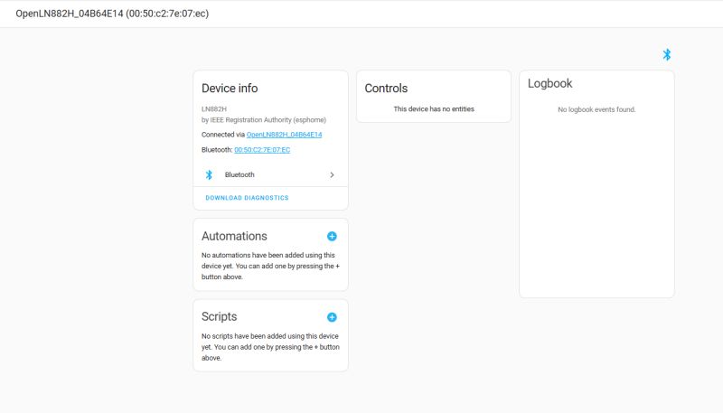

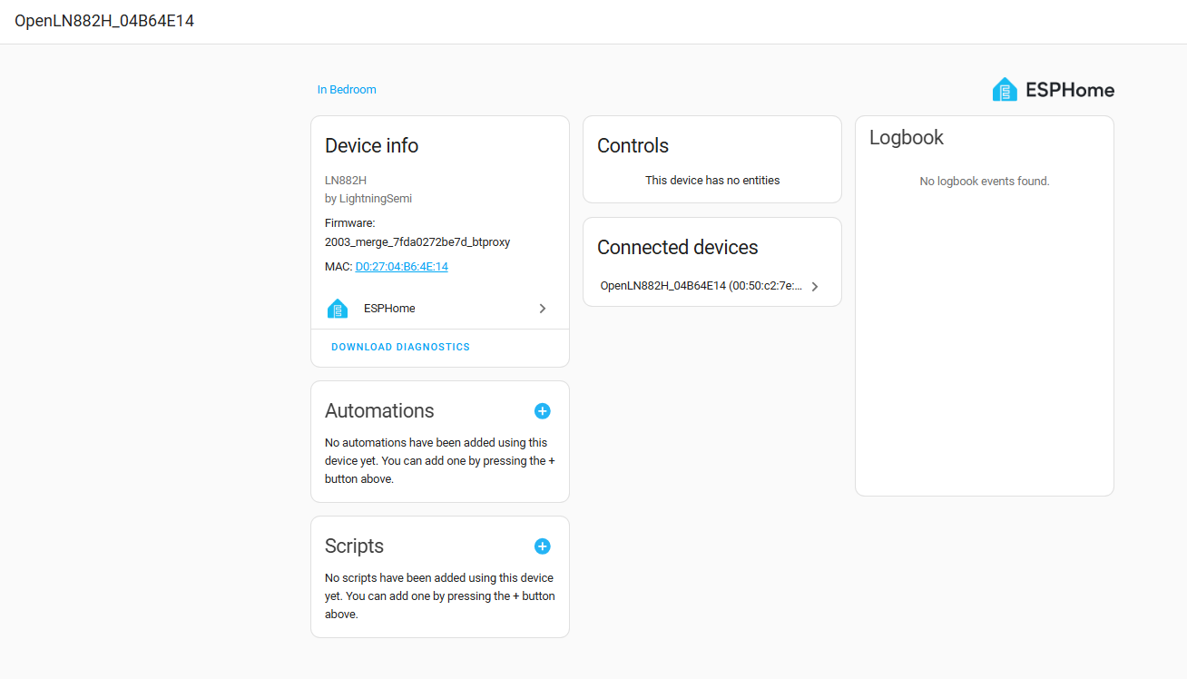

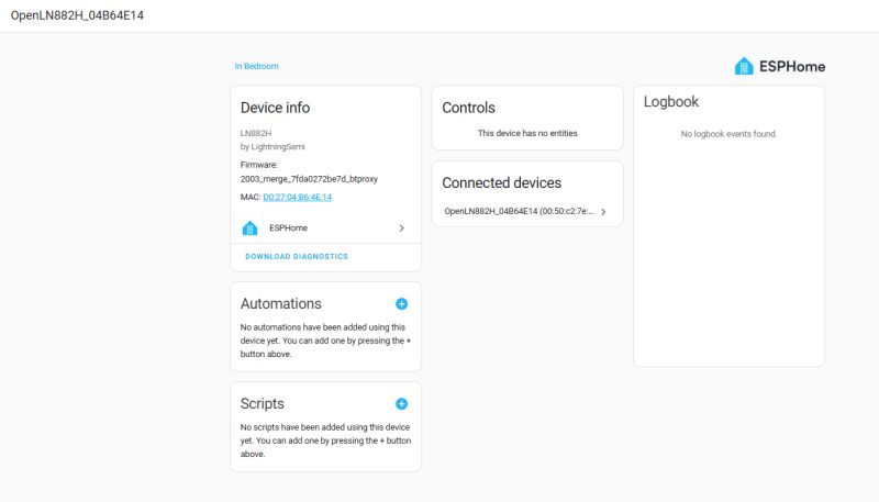

    #32 21852673
    Posts: 5068
    Help: 441
    Rate: 897
    something's happening. Tuya TH05 nearby
    Network graph with central node “OpenLN882H…” linked to “Home Assistant” and many MAC-address nodes
    Screenshot of OpenLN882H device page showing Bluetooth info and empty Controls and Logbook sections
    ESPHome dashboard screenshot showing LN882H device info with Controls, Connected devices, and Logbook panels
