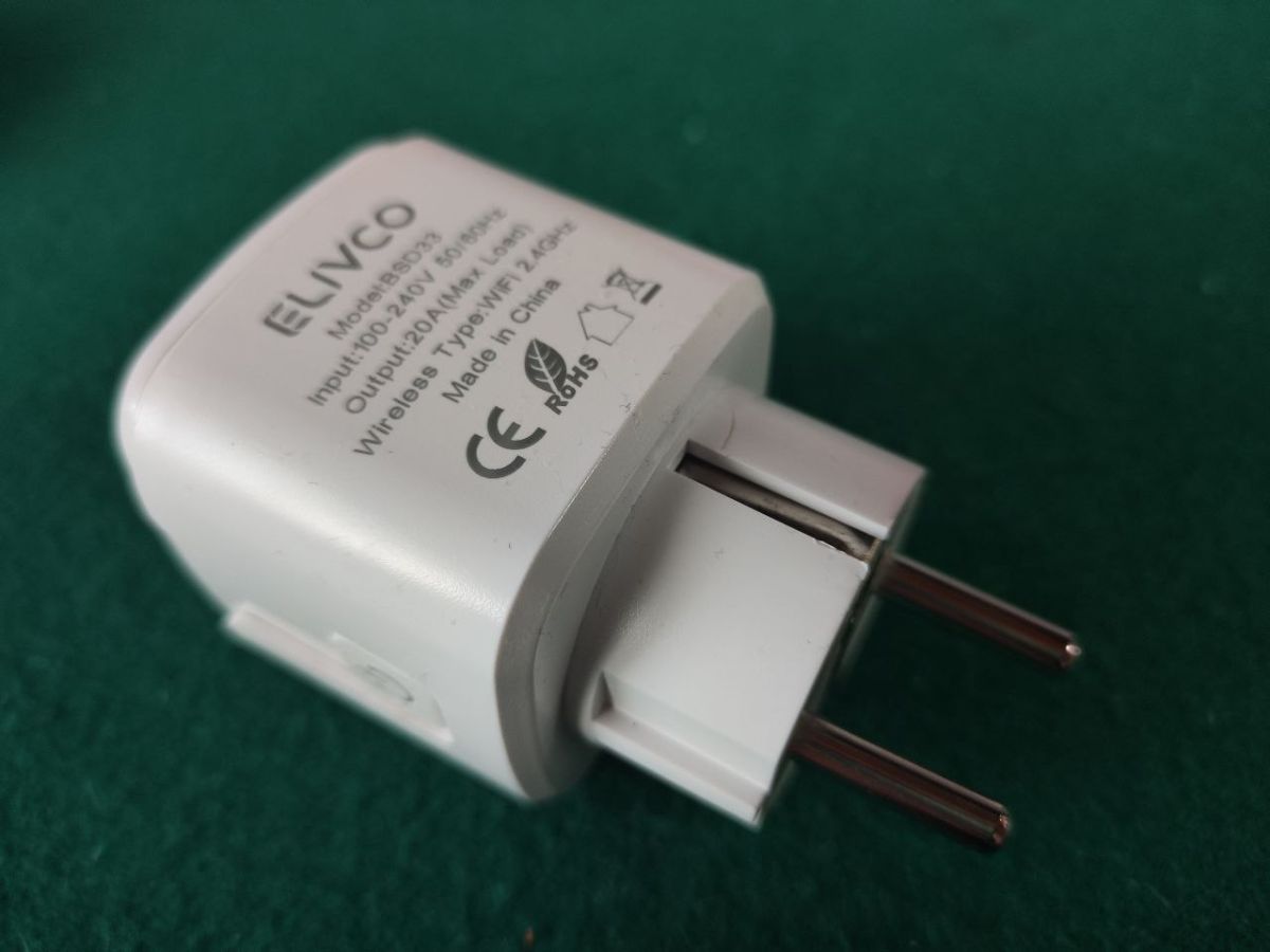

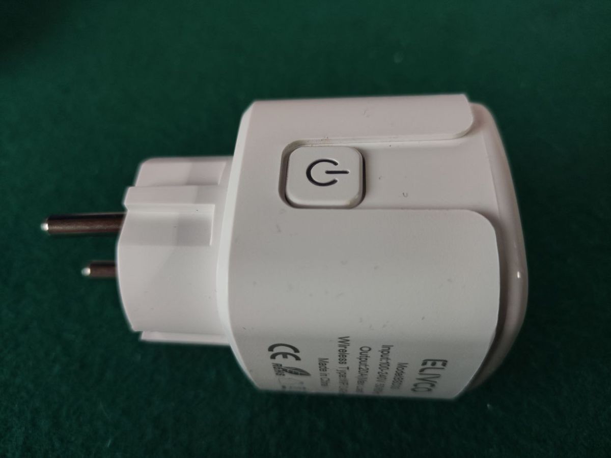

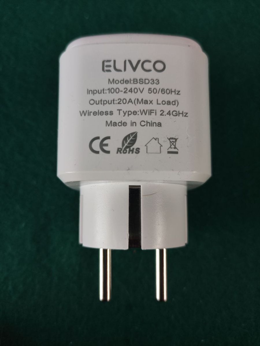

1. Device Description
This is a smart plug that I purchased on AliExpress. The hardware feels robust, and fortunately, it was easy to open without breaking any plastic tabs.
2. Hardware Identification

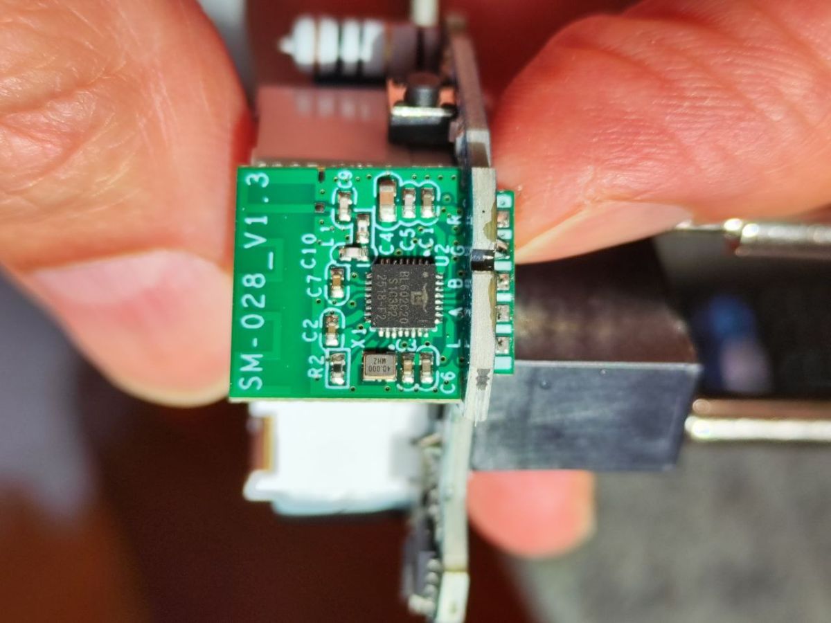

After opening the casing, this is what I found on the PCB:
Microcontroller (MCU): BL602
Module: SM-028_V1.3
Operating Voltage: 240 V AC
