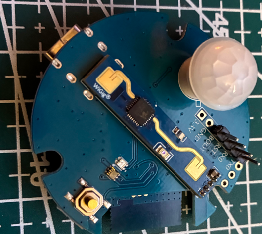

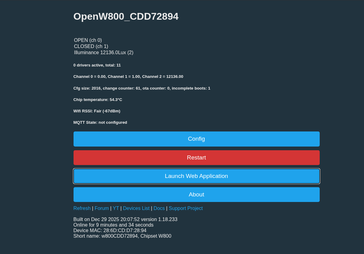

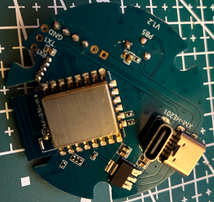

    XM-HE201 24 GHz Human Presence Sensor. I've managed to flash one of these to OpenBeken but I am struggling to get all the sensors working.
    To flash to OpenBeken you need to tie the boot pin to ground on startup, UART will output "C" continuously when it's ready to receive the firmware from wm_tool.exe. Use TX0/RX0 to flash the firmware; TX1/RX1 are connected to the mmWave sensor (LD2410B.)
    Pin 21 is connected to the PIR sensor and Pin 24 to the mmWave sensor's GPIO pin; setting them to DoorSnsrWSleep has them working. I believe the illuminance sensor is between the button and the LED and one of its pins did have continuity with pin 4 but I don't know how to identify it or configure it with OpenBeken. To fully support this device I believe a driver would have to be written to interface the LD2410B UART; way beyond my depth, barely got it flashed with LLM assistance.
    XM-HE201 PCB with USB-C port, RF module, and labeled TX/RX and GND pins.
    PCB with PIR and mmWave modules placed on a blue cutting mat with grid lines

    AI: When you try to configure or read from the illuminance sensor in OpenBeken, what exactly happens—do you get any readings, errors, or does it just not show up at all?
    I set the pin to ADC. The value stays between 10k and 12k whether the device is covered or a flashlight is shined directly on it. This is all on the advice of an LLM so it didn't really seem appropriate to even post as it's based on nothing tangible.

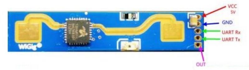

    I guess it would need some driver writing to parse the uart comms from the S3KM1110?
    I guess if you used wm_tool.exe you didn't come across Easy Flasher which can take a backup of W800 before flashing to OpenW800
  • LD2410 tool.exe connects over TX1/RX1

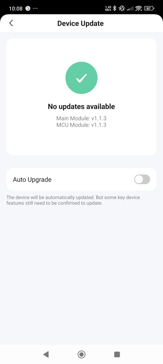

    boot log from your w800 dump, with some obvious differences because I don't have the real device with sensor

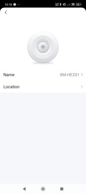

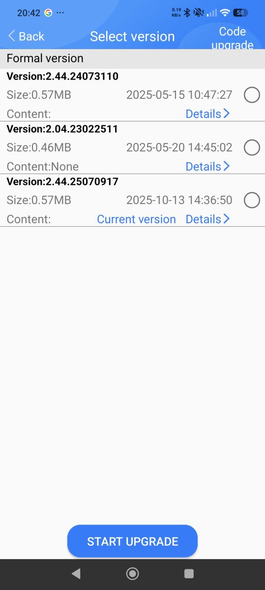

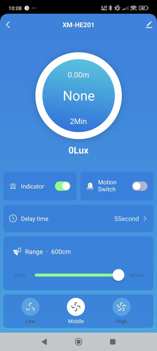

    appearance in Tuya app

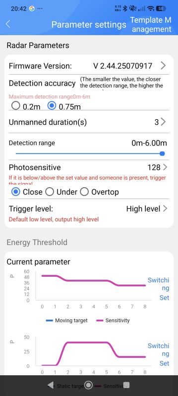

    [w800] XM-HE201 24G Sensor flashed to OpenBeken, sensors partially workingApp screen showing motion sensor settings for device XM-HE201Device update screen showing “No updates available” message

    So, is it I2C or UART? If that's UART, then I can add a driver maybe, i'm just not sure if we have generic UART driver on W800.
    Still, UART protocol in the documentation of HLK-LD2410B looks somewhat more advanced than I'd expect from such a simple sensor.
    Would you be able to provide a capture of packets from UART so I can work on parsing them on my side?

    It's a separate light sensor that is I2C as far as I can tell, while the mmWave LD2410B sensor is UART.

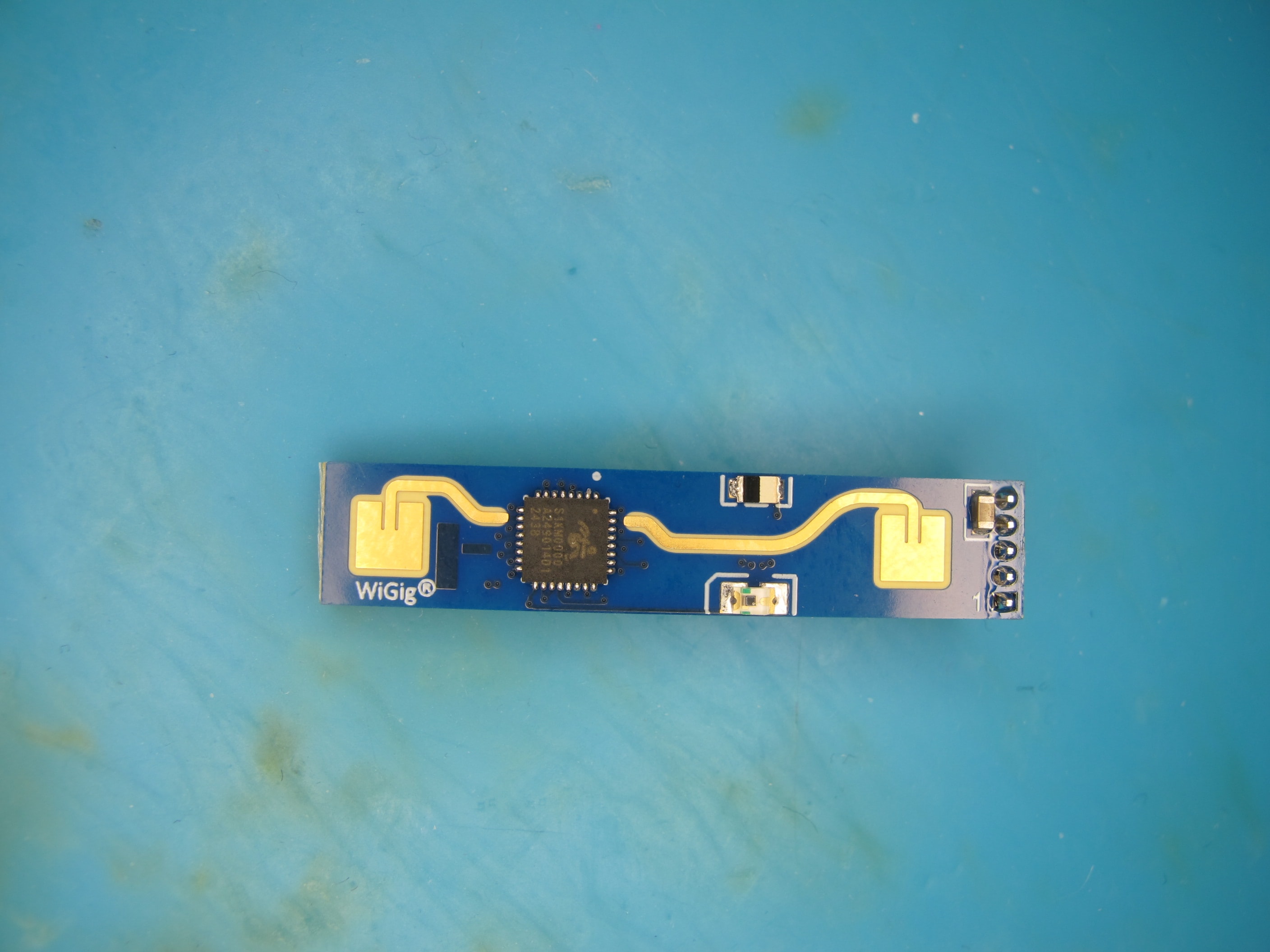

    LD2420 millimeter wave radar module with blue PCB and electronic components
  • #12 21806677
    Posts: 5220
    Help: 449
    Rate: 918

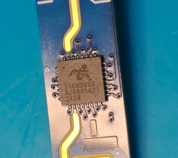

    mine's tiny!

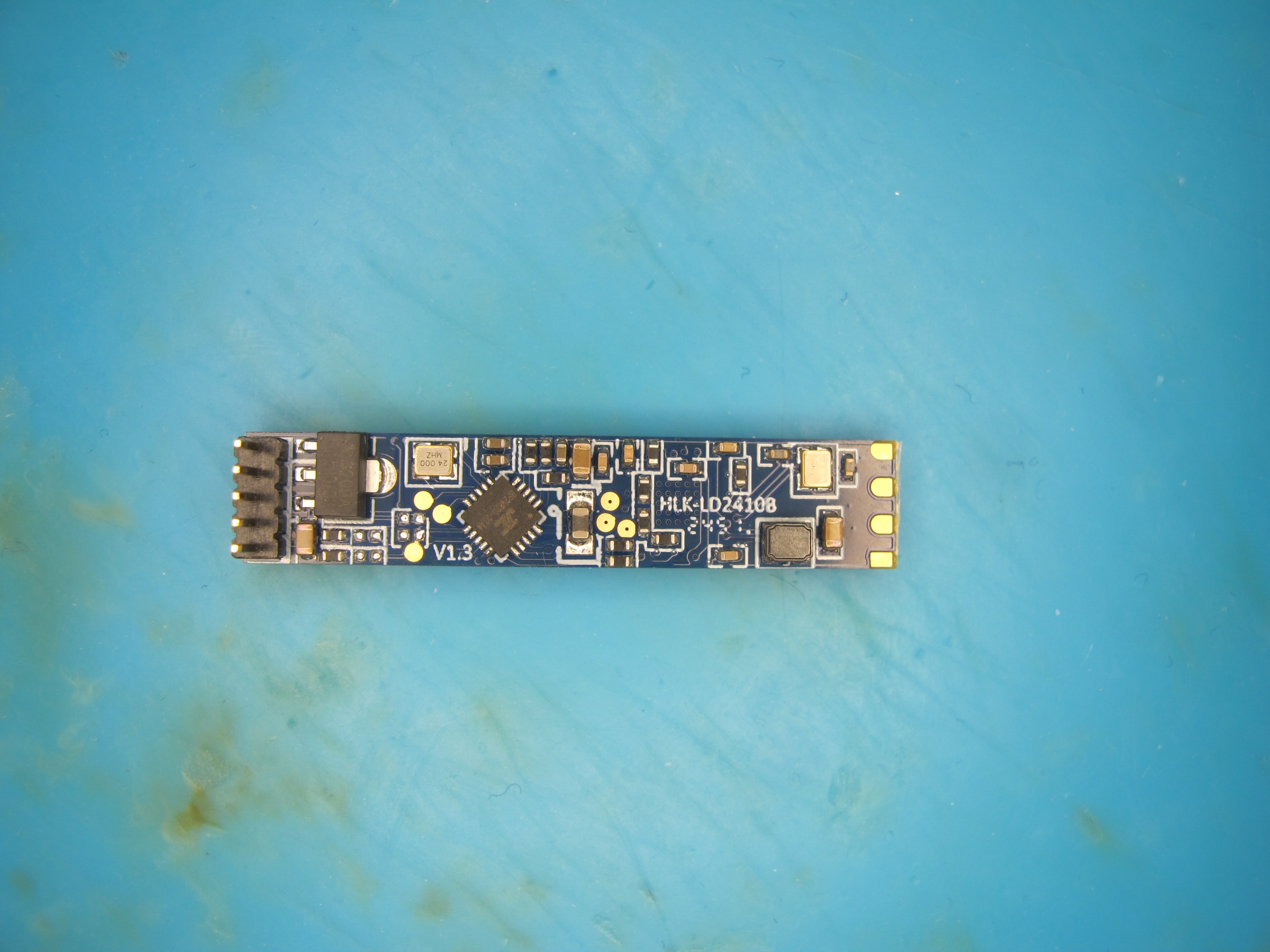

    hmm. also, S1KM0000
    S1KM0000 integrated circuit on blue PCB with gold traces and visible QFP pins

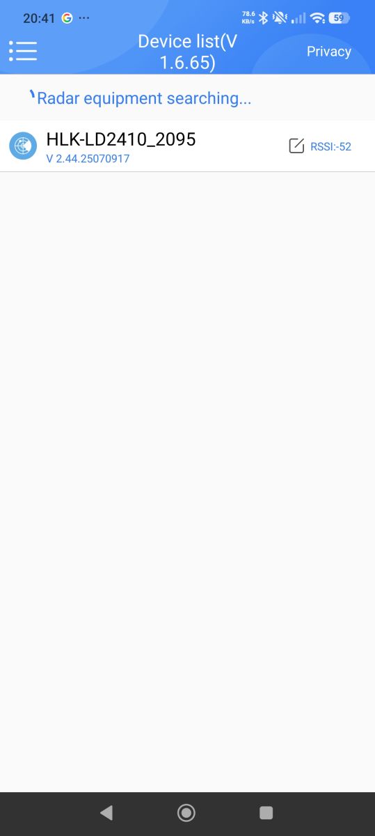

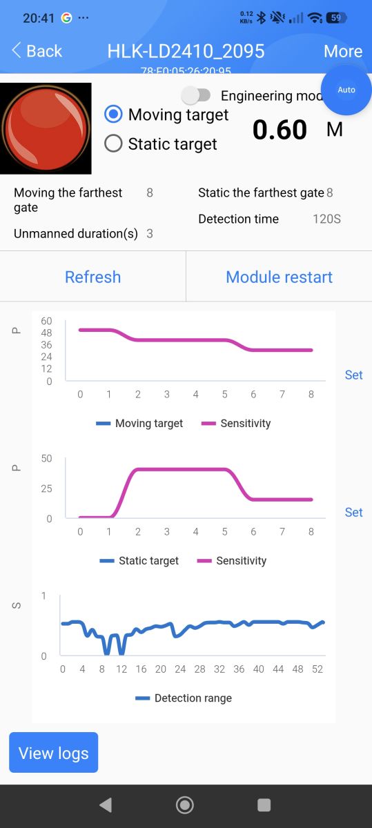

    HLK-LD2410 app screen displaying motion sensor data and detection graphs App screen showing detected sensor HLK-LD2410_2095 with RSSI signal -52 Radar parameter settings screen with sensitivity and motion graphs Software update screen showing three selectable firmware versions
    Blue WiGig sensor with chip and wires on a blue work mat

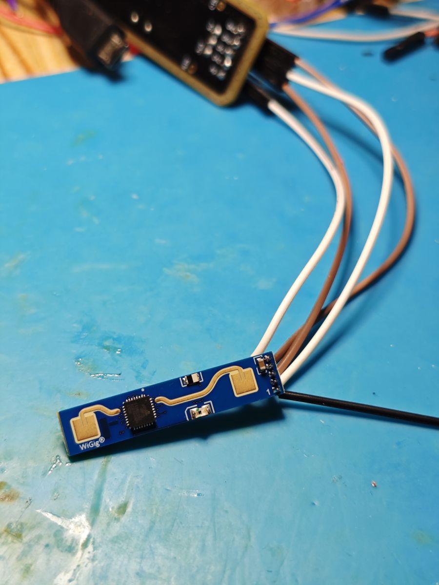

    uart sniff attached is what the W800 dump is sending from PB6
    Sensor module with labeled pins: VCC, GND, UART Rx, UART Tx, and OUT
    Tuya firmware doesn't seem to want to talk to I don't think. Connected to PB6/PB16 and OUT is to PB24
    Maybe I should just get the same device
    • ld2410b_uart_sniffer.py.zip (2.93 KB) You must be logged in to download this attachment.
    • uart_sniff_COM49_20260127_195952.log.txt (12.09 KB) You must be logged in to download this attachment.

Can I see how the device appears in the Tuya app before flashing?
Yes. A contributor posted screenshots of the OEM Tuya UI with motion and light elements. Reviewing them helps you map expected datapoints when recreating behavior on OpenBeken. Use these as a baseline for MQTT/topics later. [Elektroda, divadiow, post #21798204]
