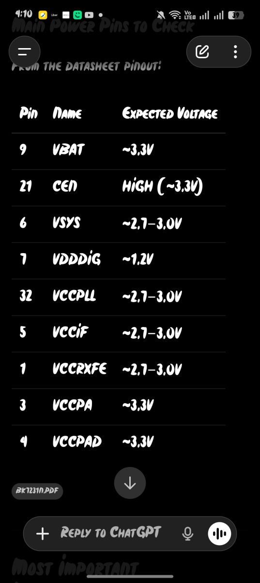

    The smart switch doesn't work now. The LED turns on when I apply 220 V, but there is no response from the switch. Pressing the button doesn't the state of the switch, and the device on Tuya app is offline. I measured voltage on the pins of the MCU in the picture
    Aubess 16A Tuya switch EZB-WBZS1H16N-A_V1.0 BK7231N UART flashing Phone screenshot of a table listing power pins and expected voltages (e.g., VBAT, VSYS, VCCPLL)

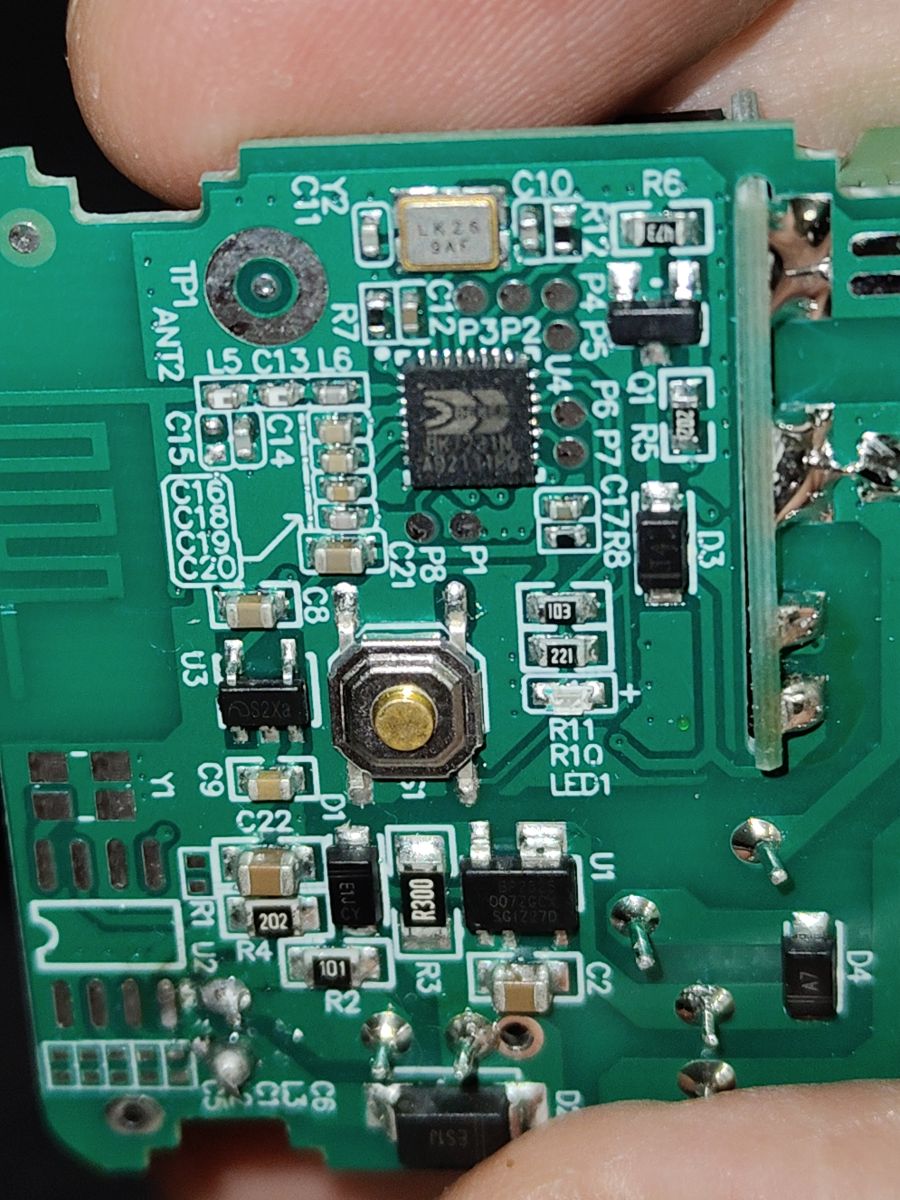

    And voltage was within range given by ChatGPT. I'm thinking either the MCU is dead or firmware crashed, so I want to reflash the MCU, but I don't know where I should connect USB-to-TTL UART uploader module pins on the PCB board. Also, do I need external 3.3 V, or can I use 3.3 V of UART module. This is a picture of PCB board
    Close-up of a green PCB with a push button, an IC, and multiple SMD components

    Can you post the exact model/PCB version and the markings written on the main MCU and the WiFi module (if there is one)?
    This PCB version EZB-WBZS1H16N-A_V1.0 and this MCU WiFi module marking BK7231N
    Can you upload clear front/back PCB pictures or list the labels near the pads/pins, and say if you already checked things like relay voltage, button continuity, or any UART serial output when powering it on?
    I checked button continuity, power on capacitors and on LDO, and on pins of MCU.

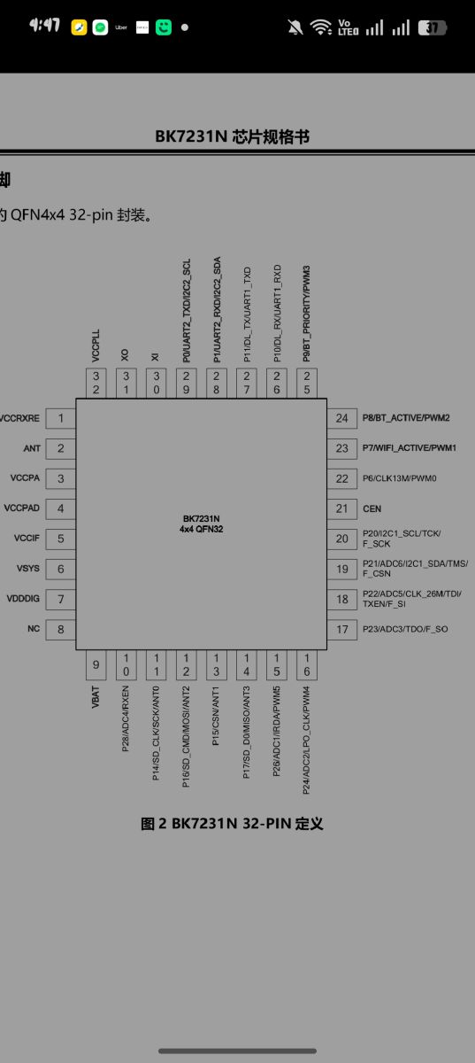

    To flash BK7231, you need to find RX and TX pins. UART1 is used for flashing. Good information about Beken can be found on our Elektroda BK7231 datasheet topic:
    https://www.elektroda.com/rtvforum/topic3951016.html
    Here is the pinout:
    So now, you can match pinout from the datasheet with your photo. You can use crystal position as reference:
    This indicates that UART pins are P4 and P5. That's kinda suprising, because shouldn't they be marked as P10/P11? Anyway, that's where you solder UART...
    Ok, apart from UART, you need power supply. Ground and VDD - either connect 5V to input of AMS, or 3.3V to output:

    3.3 V directly from USB to UART converter will most likely not work, not enough current.
    That's why I usually solder 5V to the input of AMS1117 on the board, to get good 3.3V on WiFi chip.
