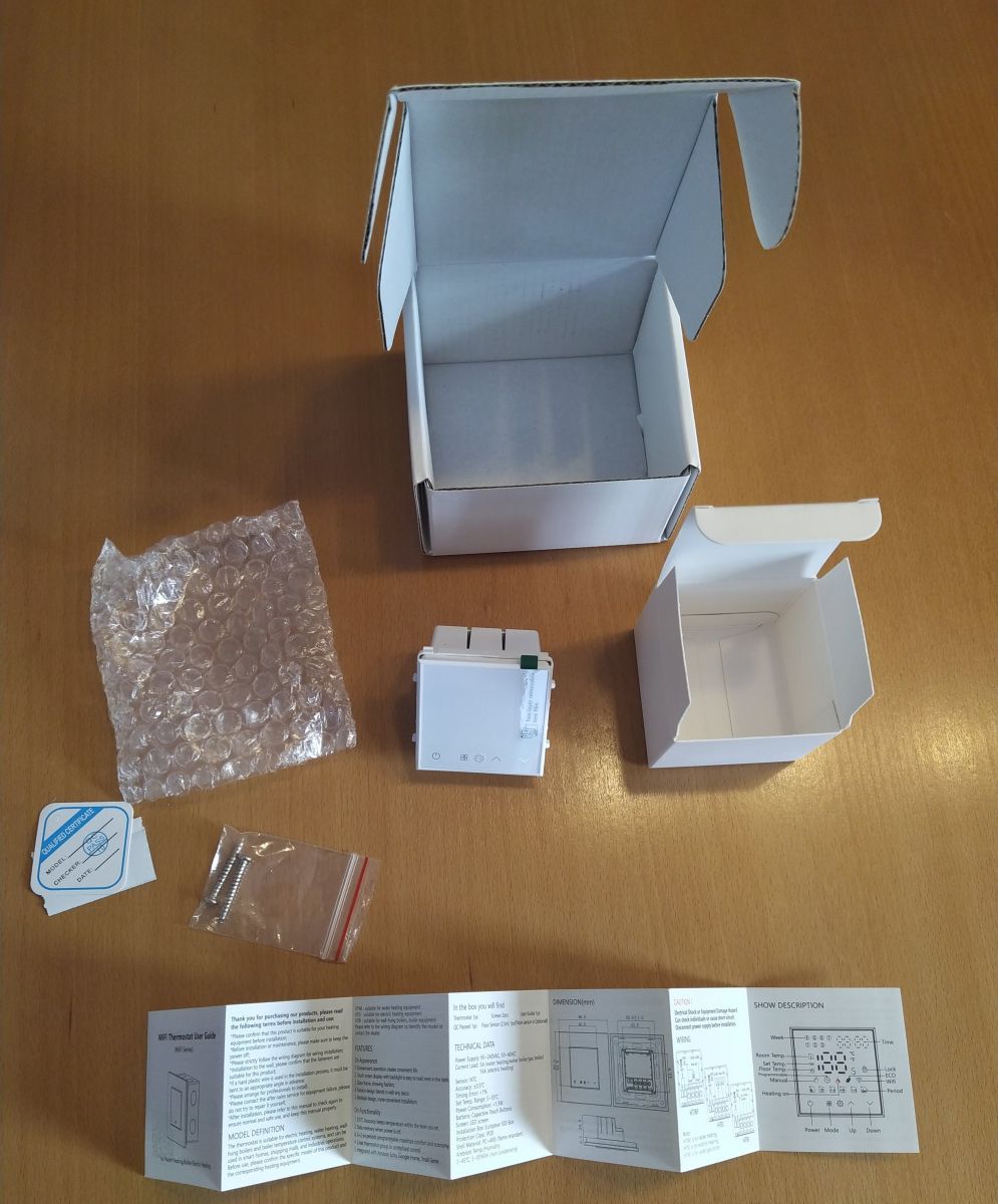

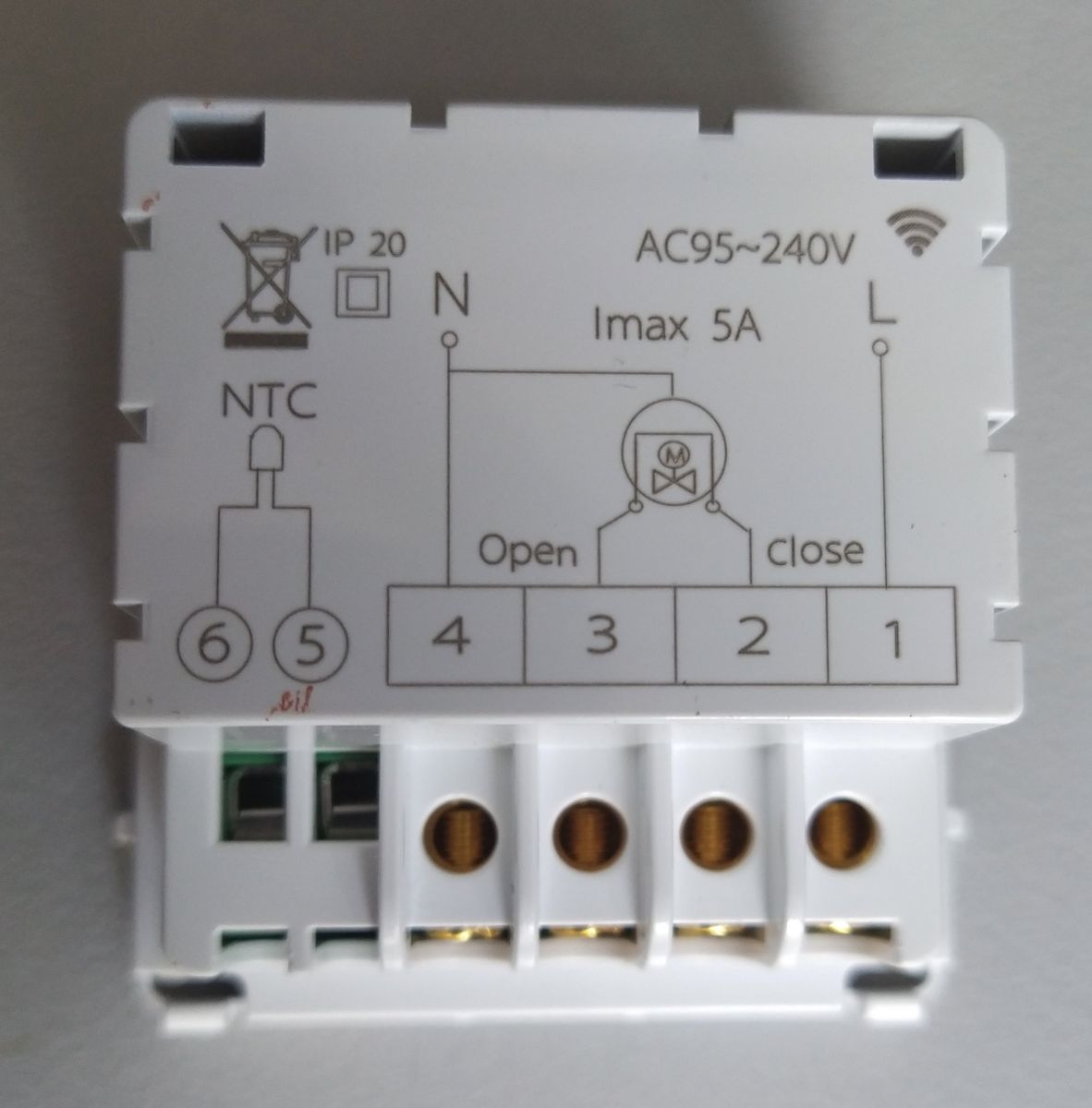

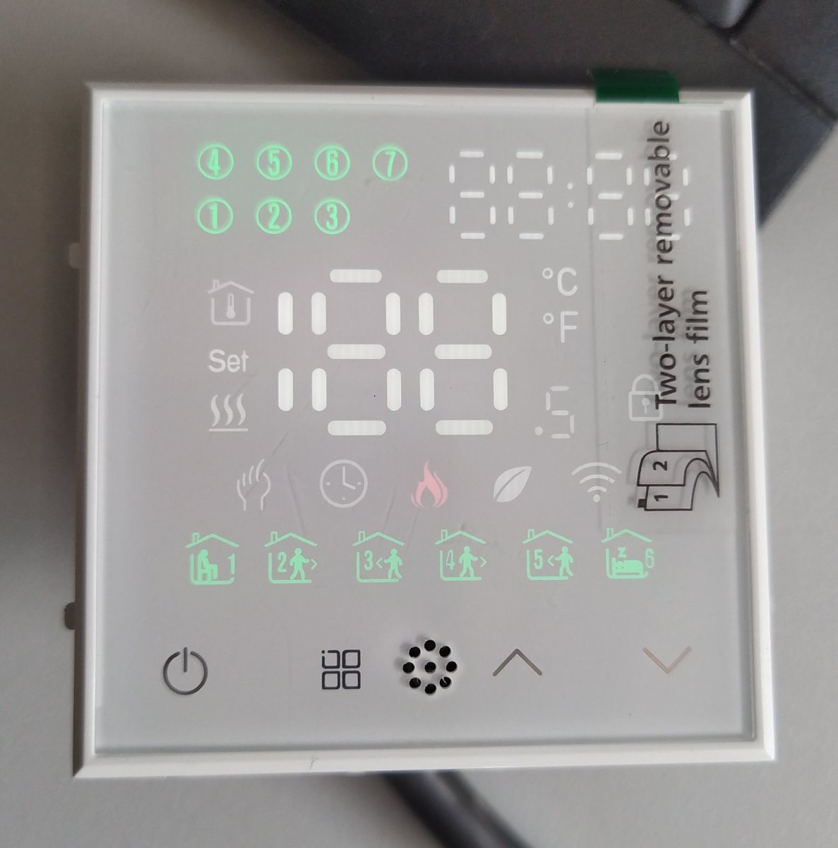

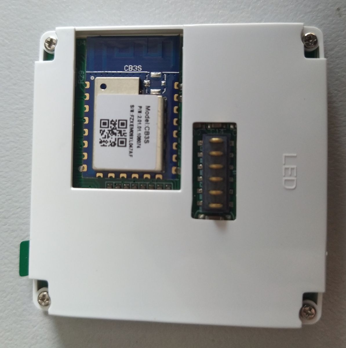

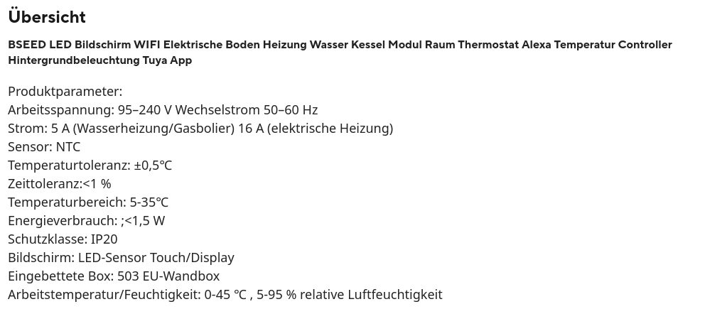

    CB3S / BK7231N - BSEED MELODY-M1-2411 (Wennzhou Mvava) - Floor heating thermostat
    Note the same but a very similar version is sold by Tawoia
    CAUTION: There is also a zigbee version sold!
    These units have a 46,8*46,8mm front so they might intergrade into european manufacturers designs (50*50mm) with an adapter plate (e.g. Gira 028227). i will test this.
    when ordered there is NO mounting plate. you will have to order the seperatly available design-frame. this one comes with the mounting frame thats is needed. :-(

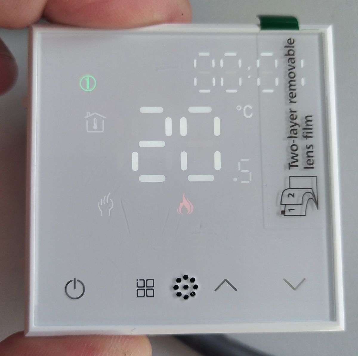

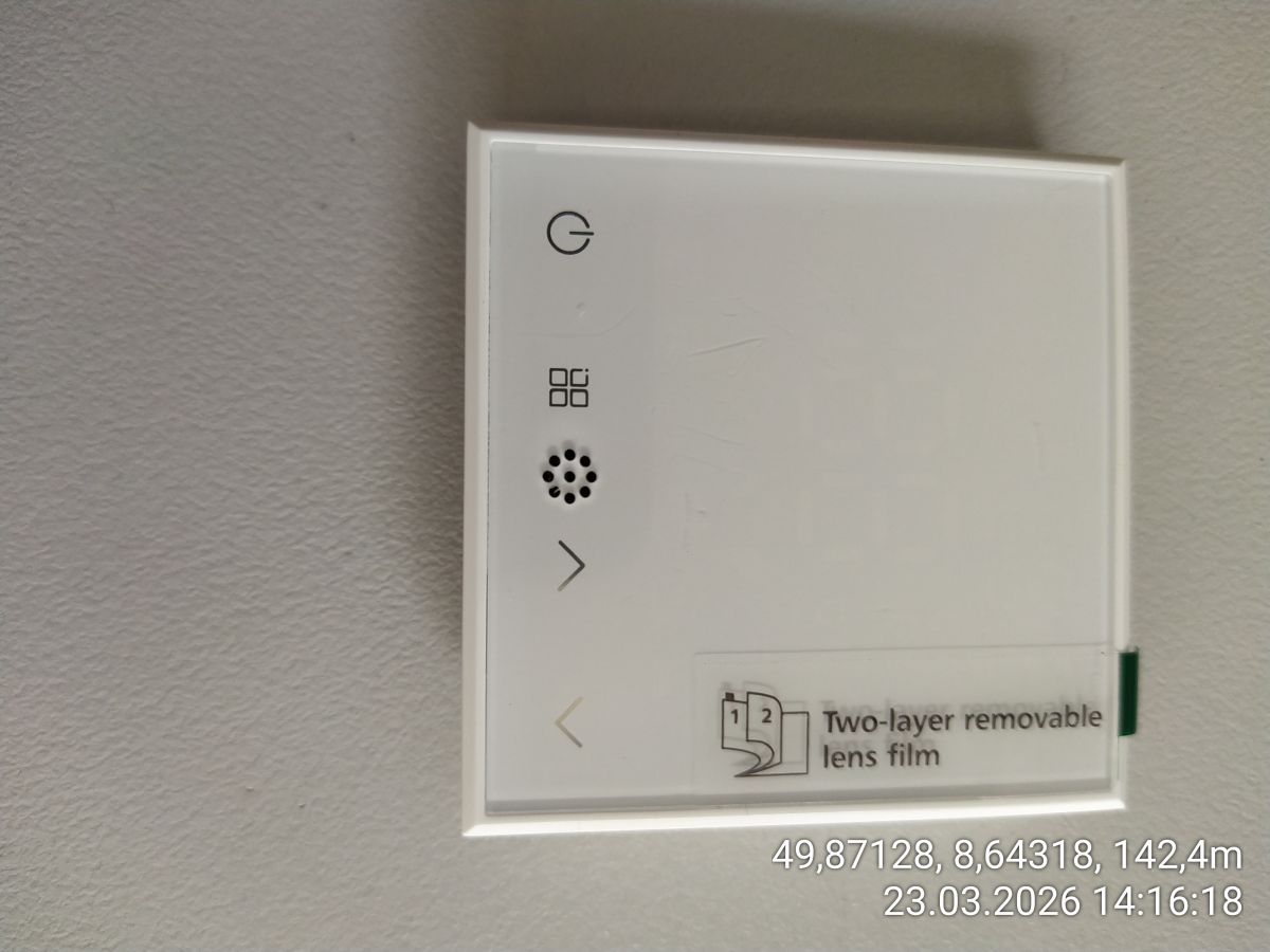

    Thermostat module and accessories on a table: open boxes, bubble wrap, screws, and a folded manualWhite glass wall control panel with touch icons and a “Two-layer removable lens film” sticker.
    Open device housing showing a CB3S module on a PCB and a connector area labeled “LED” Back of a thermostat with terminal block and printed wiring diagram, AC95–240V, Imax 5A
    Product label for “Socket & Switch” with manufacturer details, “Made in China,” and CE, RoHS, UKCA symbols. Glass thermostat control panel with backlit 28.2°C display and mode icons
    Thermostat control panel with lit temperature display showing 25°C and touch icons[CB3S/BK7231N] BSEED - MELODY-M1-2411 - Floor Heating Thermostat - Teardown

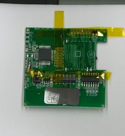

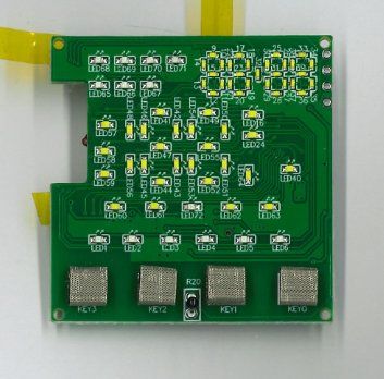

    Green PCB with many SMD parts and silkscreen labels LED and KEY Green PCB with integrated circuits and an FPC ribbon on a white background
    Screenshot with TuyaMCU logs and an “Übersicht” section listing BSEED thermostat product parameters BSEED WiFi Water thermostat diagram showing front touch icons and rear wiring terminals with labels
