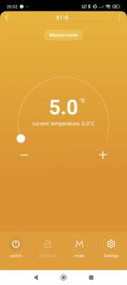

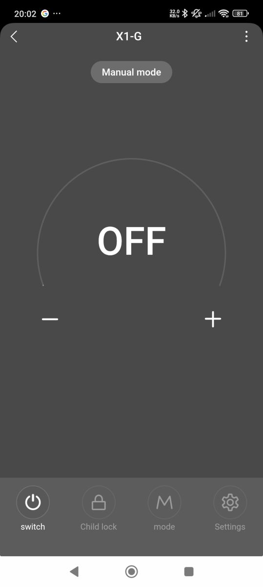

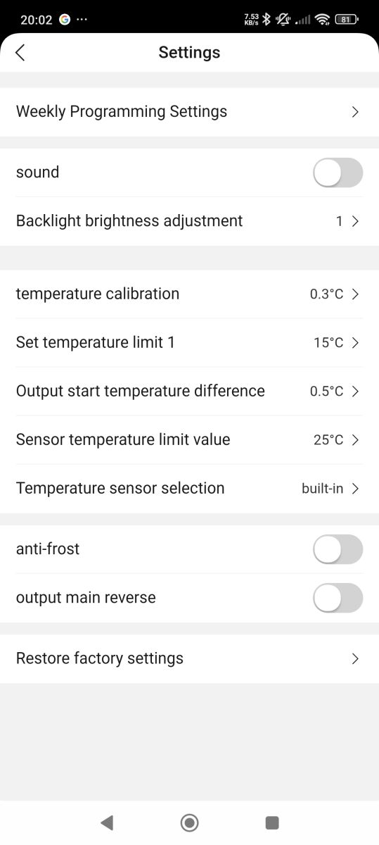

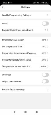

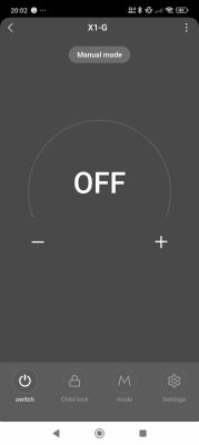

    boot log
    device details
    update info (MCU version 1.0.0 is set by me in TMDA):
    schema:
    nicer schema
    paired appearance in Tuya app
    Tuya app thermostat interface set to 5.0°C, current temperature 0.0°C Tuya app settings screen with thermostat configuration options Control app screen for X1-G device in manual mode with OFF status displayed
