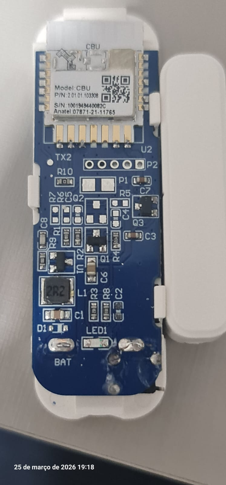

    carlosbill
    Close-up of a blue PCB with a CBU module, QR code, and SMD components inside a white plastic housing
    How can I use the BK7231N board and use a dry contact to trigger an open door alert?
    I am using board 19JWT-N.
    I couldn't locate the magnetic reed switch sensor among the board components. Does anyone have access to the electrical schematic of the board?
  • Hall sensor likely used instead of reed switch

    there are many similar contact sensors about.
    eg
    https://www.elektroda.com/rtvforum/topic4028193.html
    https://www.elektroda.com/rtvforum/topic4026894.html
    probably a hall sensor - Q3.
    eg:
    By the way, it seems the same PCB is used by the door sensors. U3 footprint looks like hall sensor.
    and https://www.elektroda.com/rtvforum/topic4028222.html#21331500
