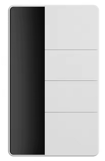

    Black-and-white wall panel: a vertical black strip on the left and three white segments on the right
    Hi everyone,
    I recently came across the Zemismart ZMS-206, a Zigbee wall switch with a small LCD display. Even though I would rather die than touch something Tuya, this one at least is Zigbee/local. Right now, it only shows a short label (max 10 characters) per gang, sent via Tuya's proprietary Zigbee datapoints.
    My goal is to display custom content on that screen: temperature readings, the currently playing song, icons, that kind of thing. Basically, turn it into a small smart home info panel embedded in the wall switch.

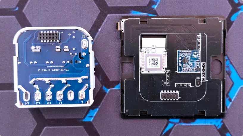

    Hardware overview (from this teardown):
    https://smarthomescene.com/reviews/zemismart-zigbee-screen-switch-zms-206-review/
    The ZT3L handles Zigbee communication and all switch logic. The display sits separately and is almost certainly driven by a dedicated MCU? Between the ZT3L and the LCD?
    1. What type of display is this physically? Is it a segmented LCD (like a calculator) or a pixel LCD?
    2. What is the display MCU?
    3. Even if the display has a pixel matrix, the MCU firmware might be hard-coded to only accept Tuya's proprietary text protocol?
    4. The ZT3L itself is not flashable, so going that route is not an option, but switching this to an ESP would also be a nightmare, right?
    Has anyone opened one of these and looked closely at the display assembly?
    Two circuit boards: a blue PCB with pins and a black board with modules and a QR code
    Thanks in advance!
  • #2 21872377
    Posts: 14770
    Rate: 12913
    It's probably TuyaMCU, but even if you plug your own WiFi module, then MCU won't allow you to display custom content on LCD.
    You probably need to disassemble it futher and determine what actually controls the display. Can you try this out and give us futher photos?
    Are there any futher chips on the board, how are they marked?
