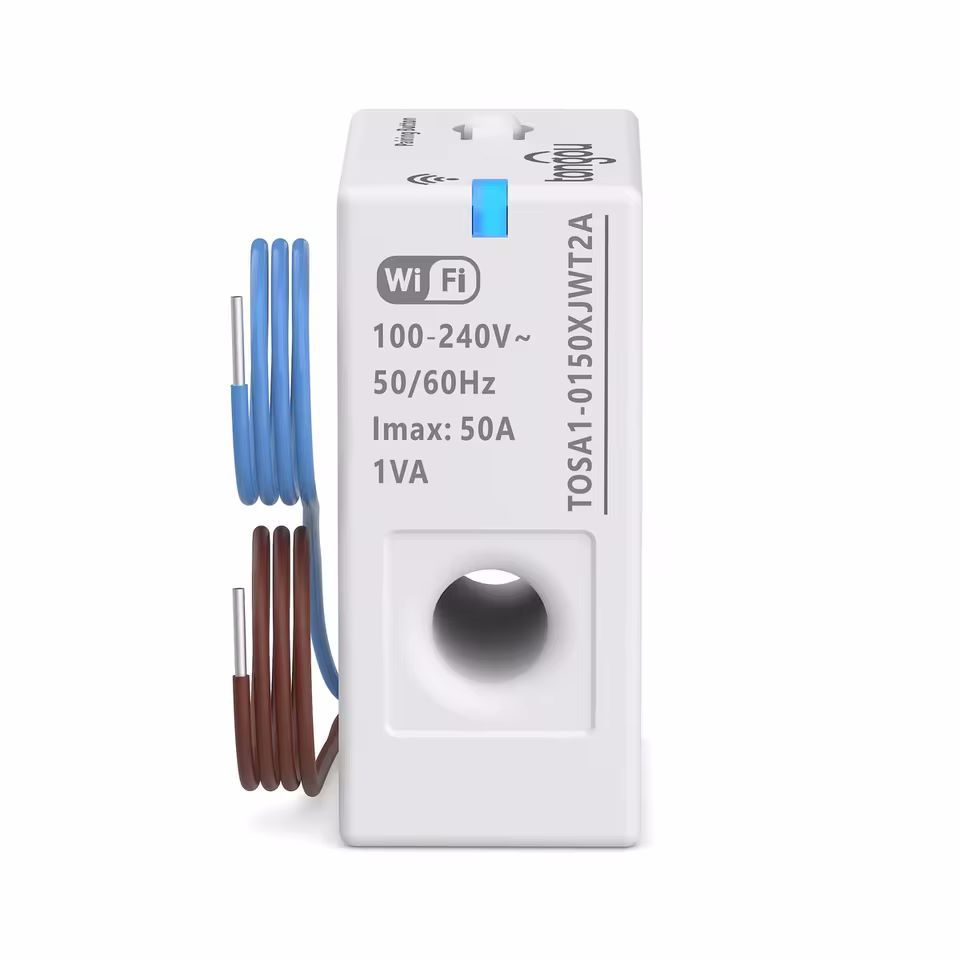

    TONGOU Tuya Smart WiFi Energy Meter - Teardown
    Promo graphic of TONGOU Tuya Smart WiFi Energy Meter with app screen and clip-on module on a cableAd for TONGOU WiFi smart energy meter with blue current coil and 99.5% accuracy claimsWhite WiFi energy meter 100–240V with pass-through hole and blue and brown wires with metal tips

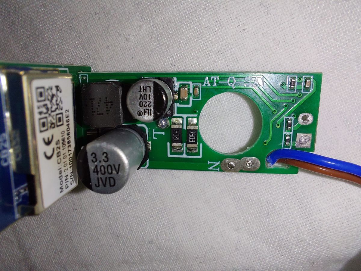

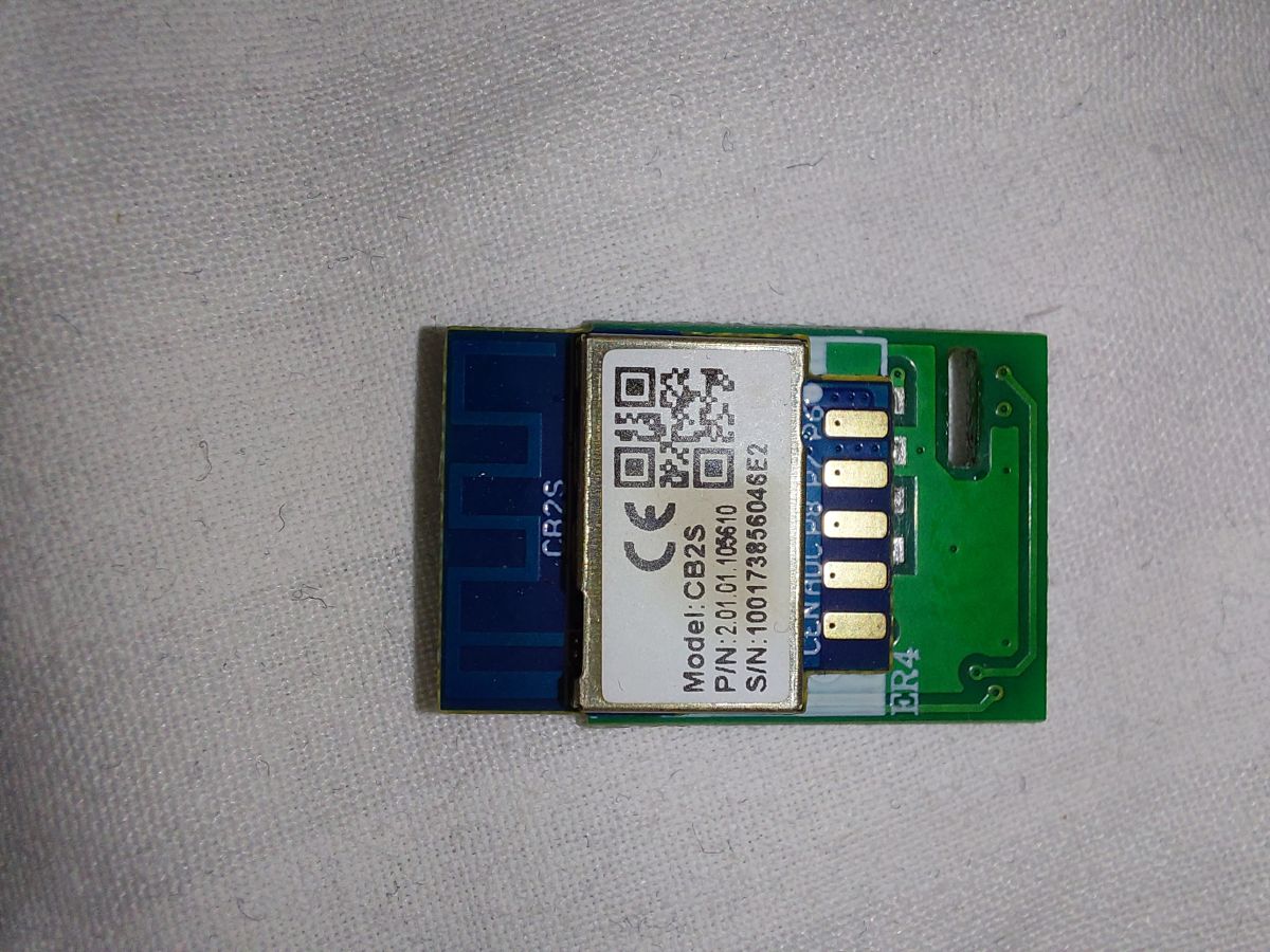

    Bought this tiny-shiny power metering module on Aliexpress. What we have inside:

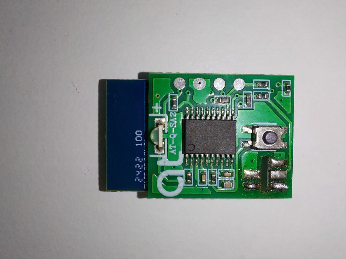

    Module: CB2S (BK7231N) - WiFi
    TuyaMCU: STC 8H3K64S2

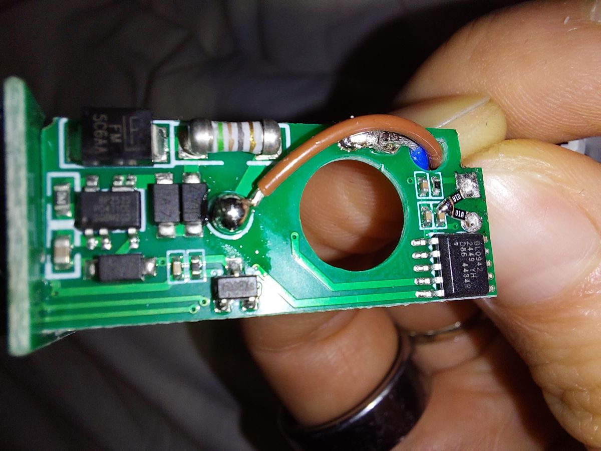

    Sensor: BL0942 - power metering
    Communication between all parts done using 2 UARTs.

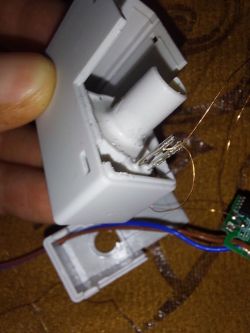

    Assembly contains 2 boards and current metering coil bulit into the plastic case. Smaller board is WiFi + TuyaMCU, bigger - power metering sensor with ac/dc converter:
    Close-up of a green PCB with a round CT hole, capacitors, and a brown and blue wire soldered to itClose-up of a green PCB with a circular hole and brown wire, showing a BL0942 chip, held between fingersGreen circuit board with a shielded module labeled “Model: CB2S” on a light fabric backgroundClose-up of a PCB with an STC chip and a push button, held between fingers.Small green PCB with an IC chip, a push button, and a blue module on the left on a white surfaceClose-up of an opened white plastic device casing with wires and a small circuit board

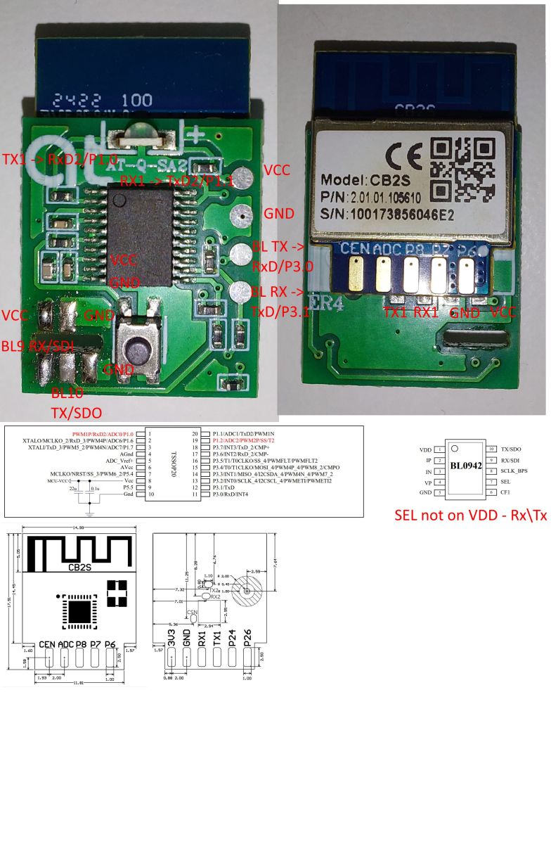

    Pinout is classic for "WiFi - TuyaMCU - Sensor" architecture:
    Front and back of a green PCB with a CB2S module, red pin labels, and pinout/diagram drawings below

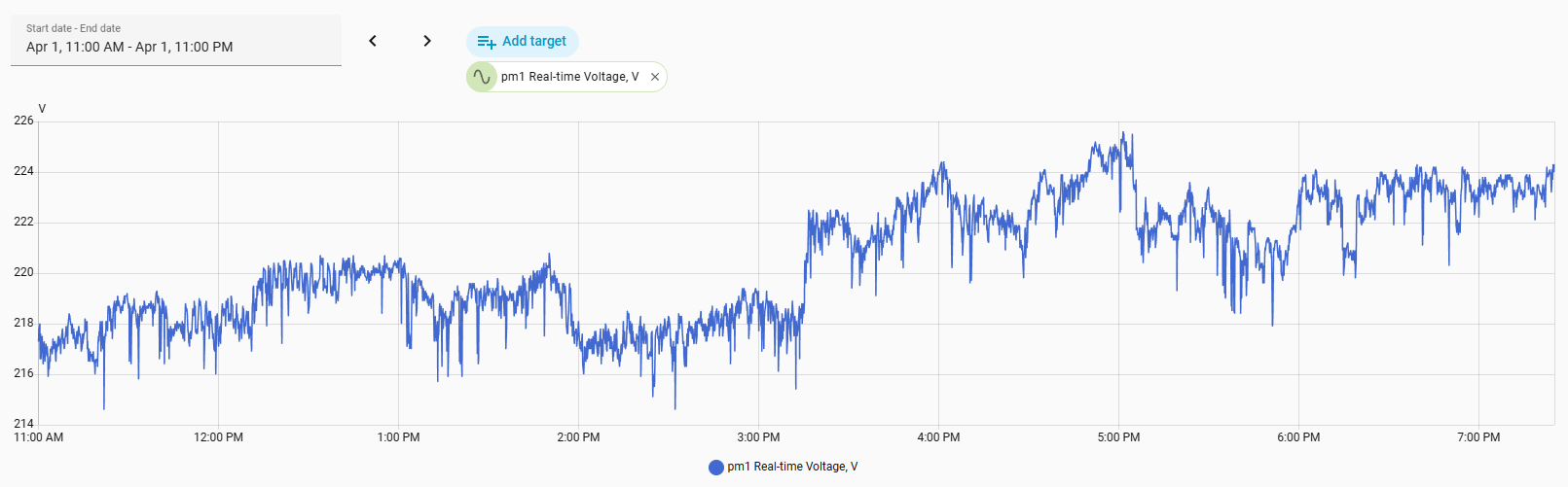

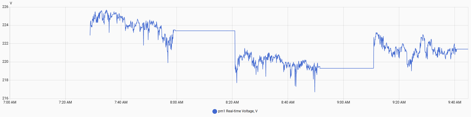

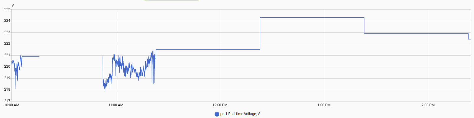

    # WATCHDOG
    # Watchdog channel
    setChannelLabel 200 "MCU Watchdog"
    setChannelType 200 ReadOnly
    setChannelPrivate 200 1
    setChannel 200 1
    # Reset watchdog on incoming measurements dpIds 6, 32, 50, 131 (channels 1, 2, 3, 9, 10, 5)
    addEventHandler OnChannelChange 1 if $CH200==0 then "setChannel 200 1"
    addEventHandler OnChannelChange 9 if $CH200==0 then "setChannel 200 1"
    addEventHandler OnChannelChange 10 if $CH200==0 then "setChannel 200 1"
    addEventHandler OnChannelChange 5 if $CH200==0 then "setChannel 200 1"
    # Toggle online_state if no measurements are received for more than X seconds, to restart MCU reporting
    addRepeatingEvent 7 -1 if $CH200==1 then "setChannel 200 0" else "backlog setChannel 0 1; delay_s 1; setChannel 0 0"
    tuyaMcu_sendQueryState
    I have only set one flag - Flag 29 - [NETIF] Use short device name as a hostname instead of a long name.
    Also, cleaned Device Group name, to make sure DGR driver not loading.
    That gave me pretty stable setup.
    Measurements sent every 5 second, same as in stock firmware - got an idea to connect CB2S directly to BL0942, may be it will be faster.
    All experiments were done using firmware version 1.18.280 for BK7231N.

    Seems like I still have stability issues:
    Line chart of voltage (V) over time, about 7:00–9:40, with fluctuations and step changes.
    Every 30 min it stops sending V/C/P readings from raw dpId 6 (Phase A - RAW_TAC2121C_VCP). What I see in logs... I spot 2 issues.
    1. Unsupported data point type 201-error. But it repeats every time when readings from dpId 6 are pushed by MCU, so it is probably not the stability issue:

    Added after 8 [hours] 38 [minutes]:
    It is MCU itself. And this behaviour also exists with stock firmware. And even reset with stock firmware via SmartLife app didn't help.
    After 30 mins sensor continue to send data to MCU via UART as it was before.
    Heartbeats between MCU and Module also work as usually. But MCU does not send any measurements to module.
    One observation - it sends last updated status info, then after 30 sec it sand another one, and then freezes.
    Not sure what to do next.. App says MCU version 1.0.0, and there are no updates.
    May be I will just connect sensor directly to CB2S UART, and desolder MCU completely.
    Added after 11 [hours] 35 [minutes]:
    Alerts\Thresholds also does not work when MCU stuck, so seems like measurements routine or whatever it uses really stopped.
    I checked reset PIN on MCU, and seems like it is pulled high, so reset occures only with 10 Ohm resistor (300 Ohms proposed by spec does not work, even 47 and 22 ohm does not) - but it is shortcircuit, not proper reset.
    Added after 2 [hours] 19 [minutes]:
    Once in every hour it allows 1 reading:
    Line chart of voltage (V) over time with abrupt jumps and stepped flat segments

    I noticed there that online_state is rw, not ro. After changing channel type to Toggle_inv and turning it online -> offline -> online, it started working. So I ended up with updated autoexec.bat with watchdog timer. Idea is to listen for changes on dpIds 131, 6, 32, 50 and if there are no changes for more than 7 seconds - toggle online_state.
    Original autoexec.bat was updated.
    Added after 11 [hours] 19 [minutes]:
    Works pretty stable:
    Line chart of voltage over time (pm1 Real-time Voltage) from 11:00 to 19:00, about 214–226 V.
