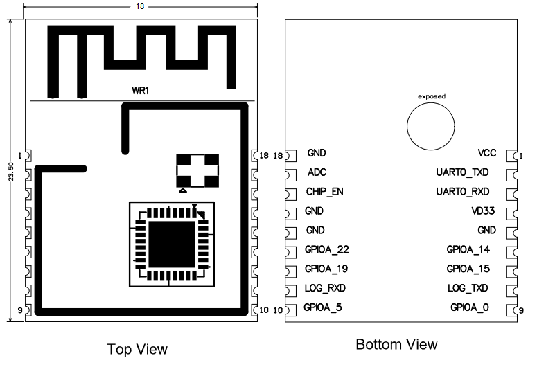

    Here are a few points of interesting regarding the Tuya WR1 module, two of which I hold in my possession after a seller on Taobao sent me these by 'mistake' instead of what I ordered, a WRG1 - RTL8711AM.
    The WR1 Tuya page is here https://developer.tuya.com/en/docs/iot/wifiwr1module?id=K9605tc0k90t3 but if it ever gets retired, I attach the PDF and here's some basic info:
    The WR1 is a low-power embedded Wi-Fi module developed by Hangzhou Tuya Information Technology Co., Ltd. The module consists of a highly integrated RTL8710BN chip and external flash memory. It comes with a built-in Wi-Fi network protocol and a large number of library functions.
    The WR1 also includes low power ARM CM4F, WLAN MAC, 1T1R WLAN, a maximum frequency of 125MHz, built-in 256K SRAM, 1Mbyte flash, and a wealth of peripheral resources.
    Technical diagram of an electronic module: top and bottom views with dimensions and pin labels.

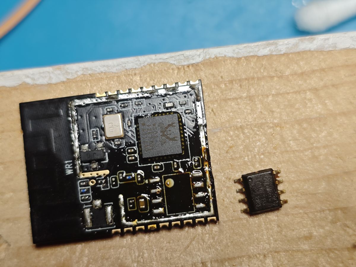

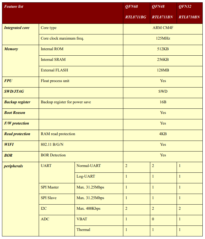

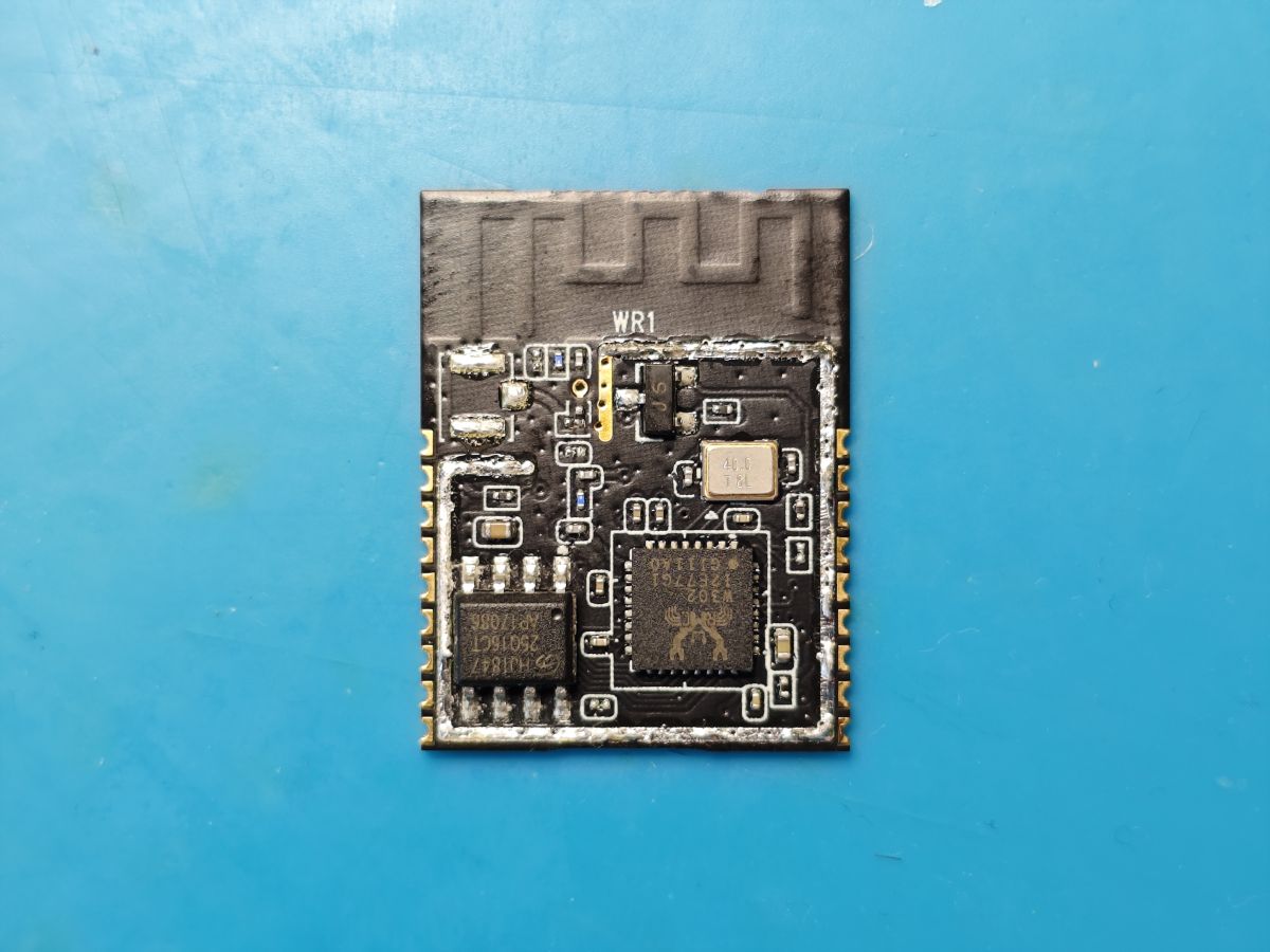

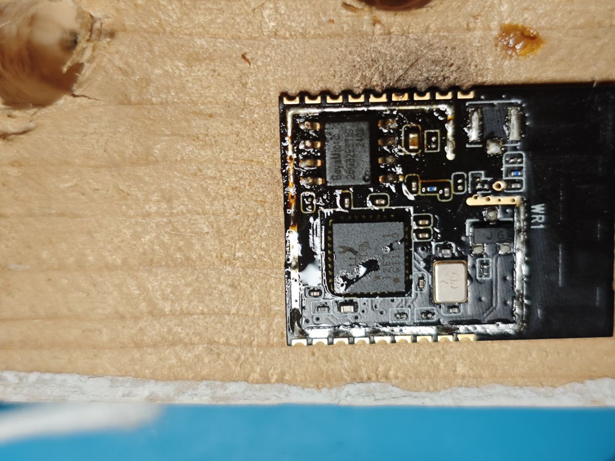

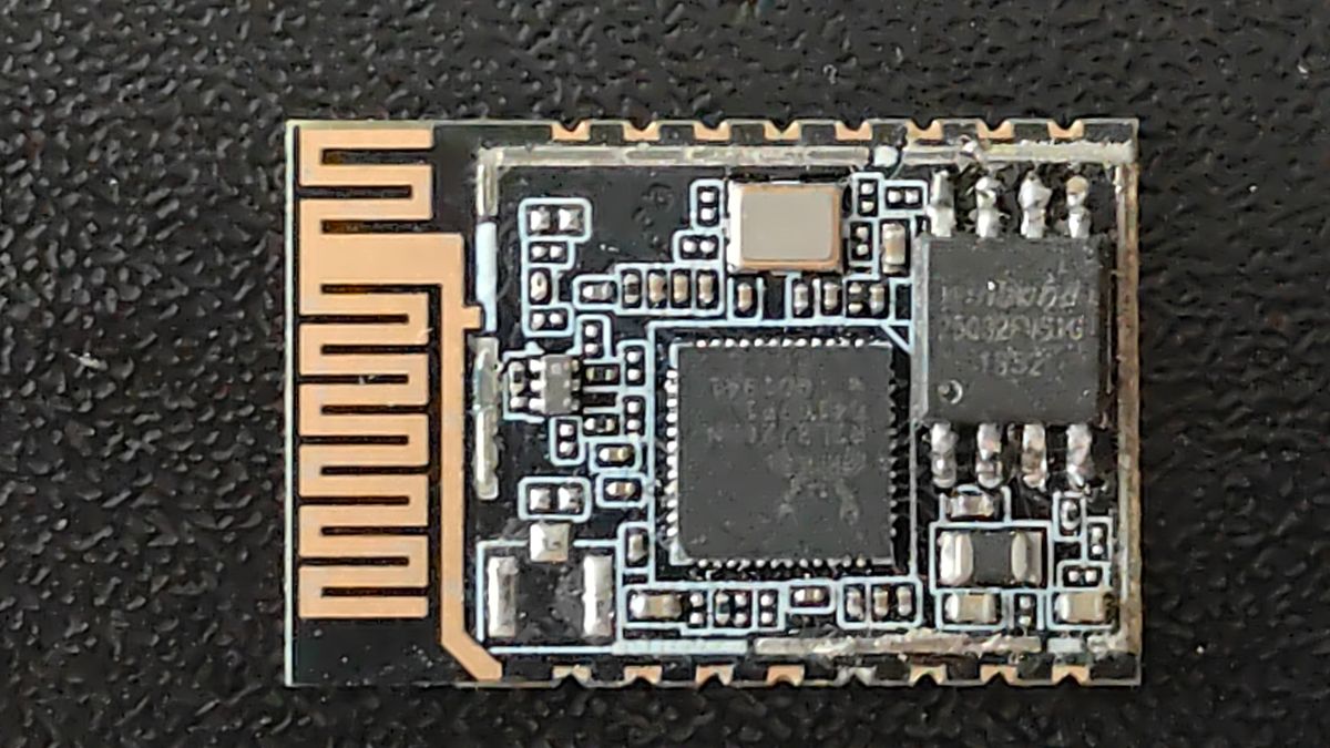

    I de-canned one to see the chip and confirm external flash size. I intend to replace the flash chip with something 4mb+ so I can burn flash dumps that are 4mb, eg: https://github.com/libretiny-eu/libretiny/issues/23#issuecomment-1255291754
    We see from an AmebaZ datasheet that 128MB is the maximum external flash supported.
    Comparison table of RTL8711BG/BN features with QFN68, QFN48, and QFN32 columns

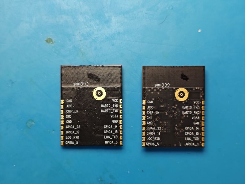

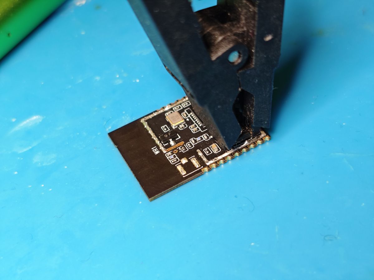

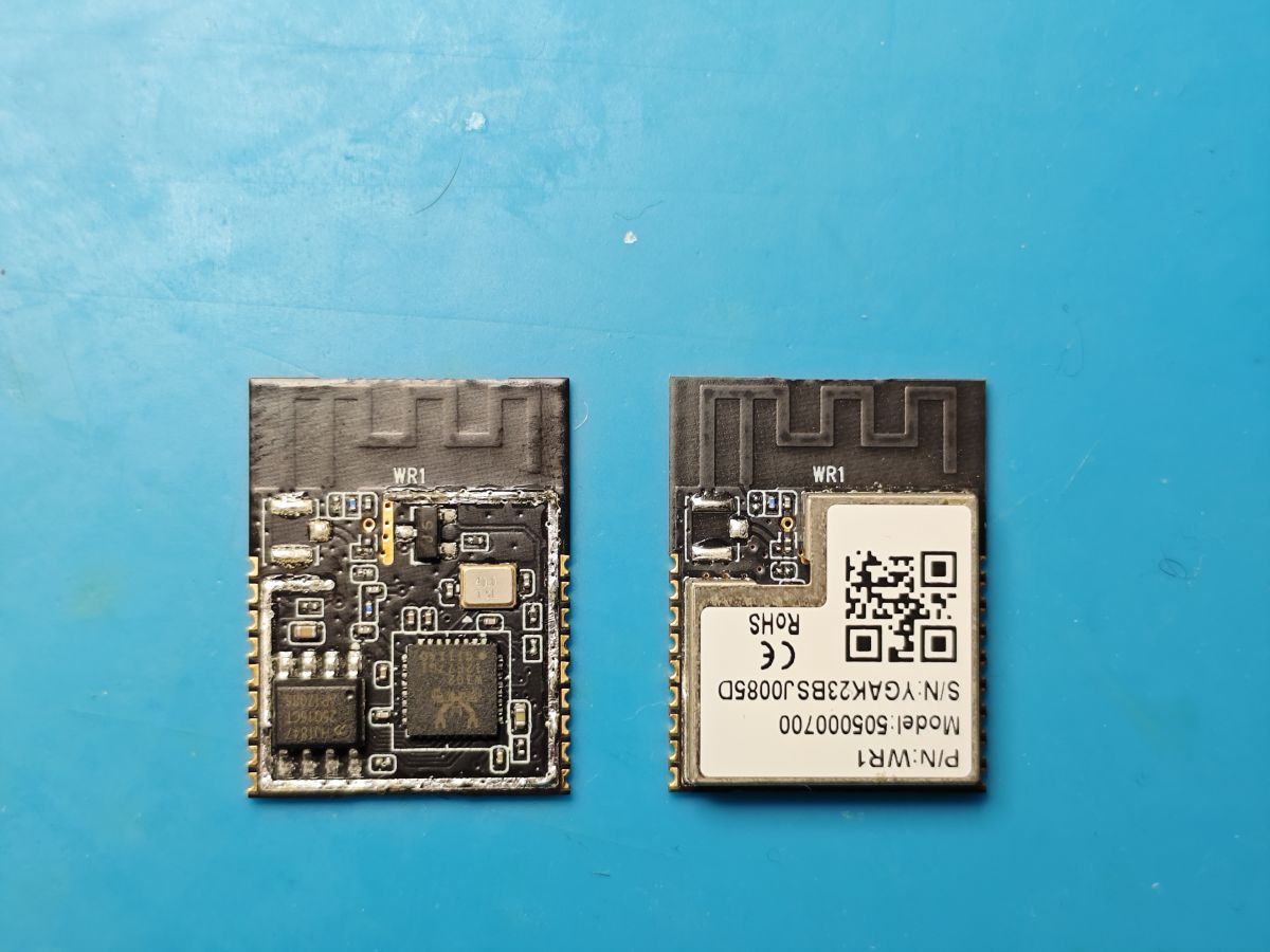

    First, some pics of my modules and a dump of the flash chip. This RTL8710BN is labelled as a W302. Flash chip HJ1847, 25Q16CT, AP17086.
    Two small PCB electronic modules with a trace antenna, on a blue background
    Two black PCB boards with pin labels lying on a blue work mat
    Close-up of an electronic module with a PCB antenna and IC on a blue background

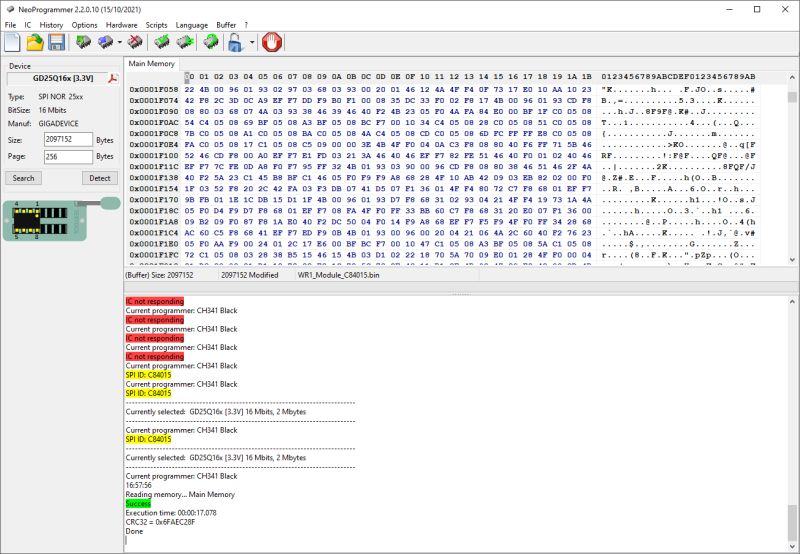

    2mb chip detection in NeoProgrammer with CH341A/clamp - C84015 / GigaDevice GD25Q16x, so not the 1mb expected.
    NeoProgrammer screenshot showing SPI memory hex dump and log with “IC not responding” and “Success”
    Small electronic module on a blue mat, held with tweezers; “WIFI” label visible.
    boot log from Log_TX pad
    Dump: https://github.com/openshwprojects/FlashDumps/commit/edf21874f3cf0201b3e963890143e755671e3052

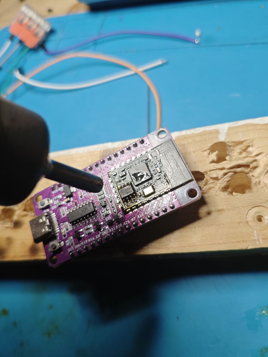

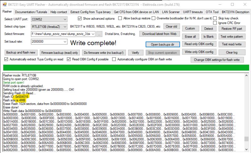

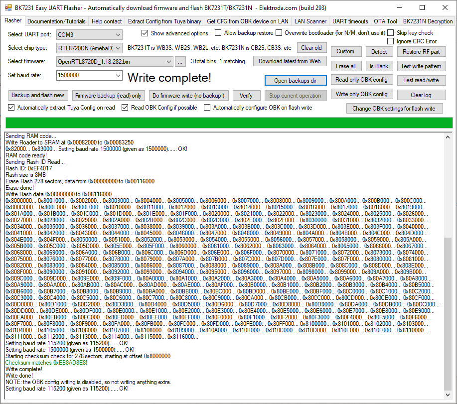

    transplant success. 4mb (32mbit) BoyaMicro chip donated from BW16
    PCB with micro‑USB port and shielded module, pointed at by a soldering iron tip
    Close-up of a PCB section with ICs and “WIFI” marking, partly covered with a white residue Close-up of a PCB with an antenna and a desoldered integrated circuit placed beside it
    Screenshot of BK7231 Easy UART Flasher showing “Write complete!” and a flashing log.

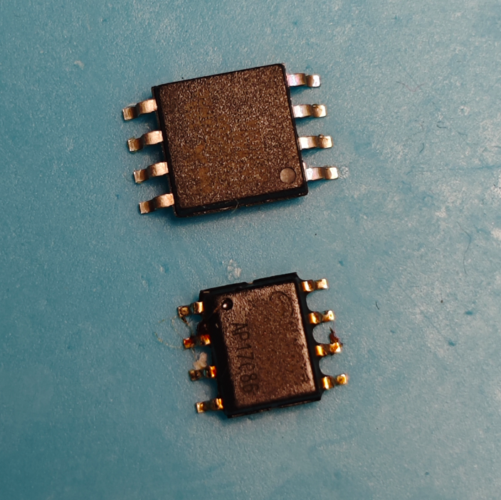

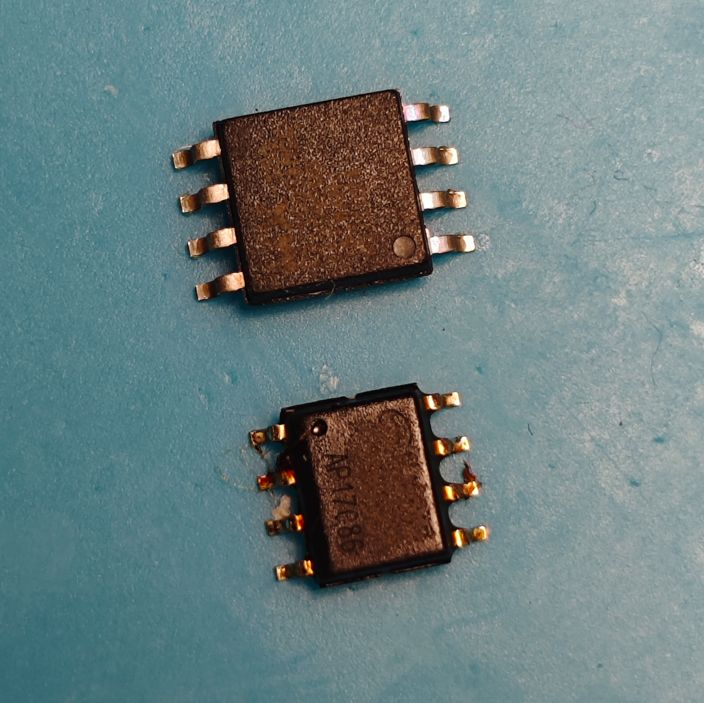

    You can also get larger flash sizes, for example from old laptop scrap boards. Or just order new chips...
    Yes, I have higher capacity chips, but I've found those pulled from old laptops or other device PCBs tend to be the wider SOIC-8 type whereas external flash beside RTL, XF16 etc MCUs tend to be the narrow type.
    Two black SOIC-8 IC chips on a blue surface, a larger one on top and a smaller one below.

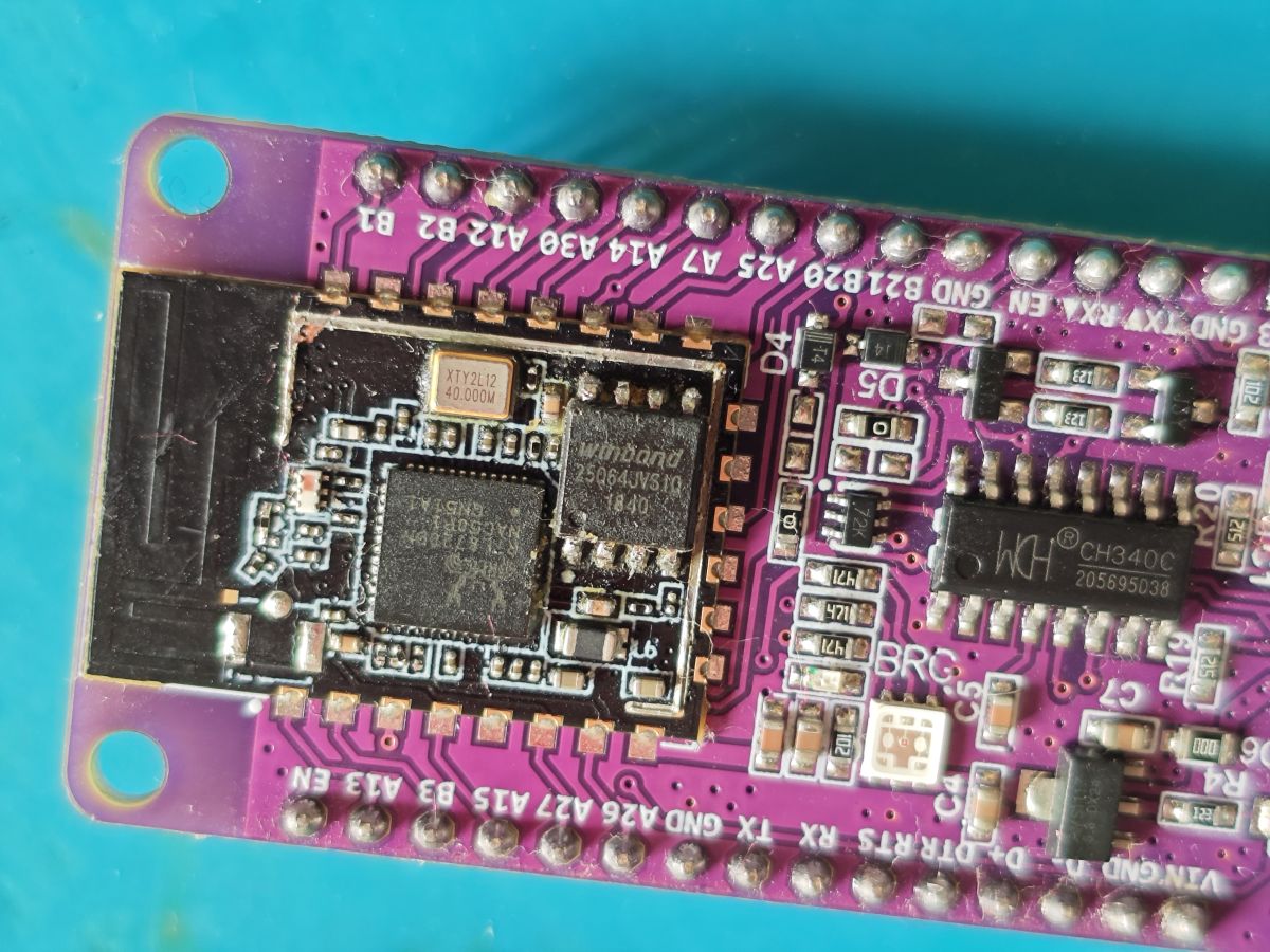

    managed to shoehorn a 64mbit wide SOIC8 Winbond onto the BW16. All tools fail CRC at write completion. I guess it doesn't like something about it

    #6 21877780
    insmod
    Posts: 1430
    Help: 168
    Rate: 455
    I've got 32mbit Winbond 25Q32 in one of my BW16 (not E), it works just fine, even if it's significantly slower.
  • #7 21877783
    Posts: 5195
    Help: 446
    Rate: 913
    hmm OK. that's good to know. im cleaning it up and will attempt to clamp onto it to see what protection bits are set if any. it's fresh off an Ali SPI module though, blank, so should be clear.

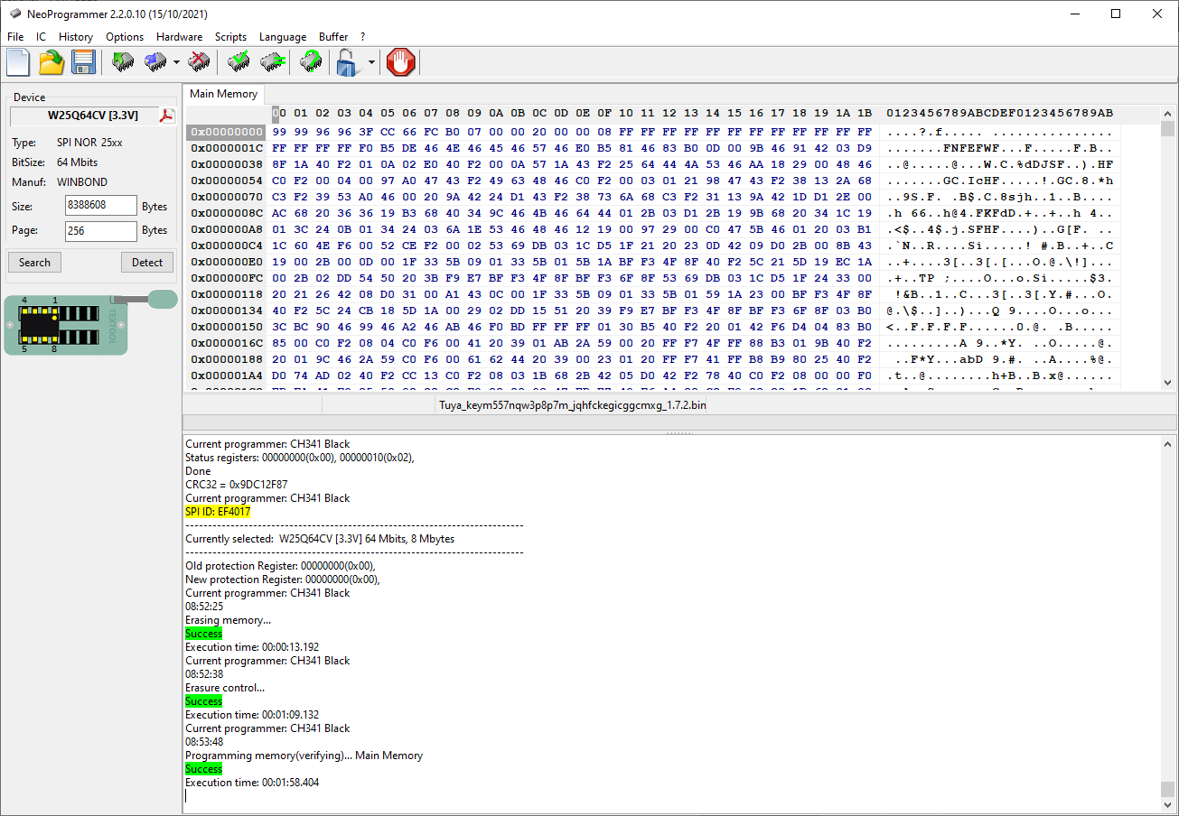

    nice. I fished a load of bits out of the recycling centre the other day, laptop, new router, HP dock - all 512k, 1mb, 2mb, 64k chips though :(
    Added after 30 [minutes]:
    checks out OK soldered back to CH341 breakout
    Screenshot of NeoProgrammer with hex view and log showing SPI flash W25Q64CV programming
    Added after 6 [minutes]:

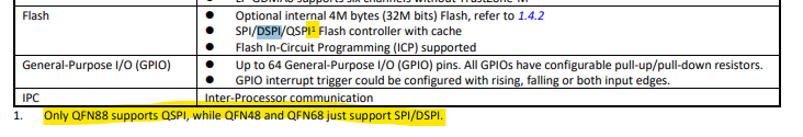

    @insmod do you recall noticing if your chip has quad mode enabled in SREG2? not found the answer yet if supported on RTLD. I assume yes.
    Screenshot of “SREG” window with SREG1–SREG3 checkboxes, “Winbond” dropdown, and Read/Write buttons
    Added after 5 [minutes]:

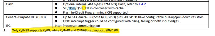

    oh. maybe it should be disabled
    Screenshot of a datasheet table for Flash, GPIO, and IPC, with a yellow-highlighted note about QSPI support.
    https://files.seeedstudio.com/products/102110.../UM0401_RTL872xD_Datasheet_v3.4_watermark.pdf

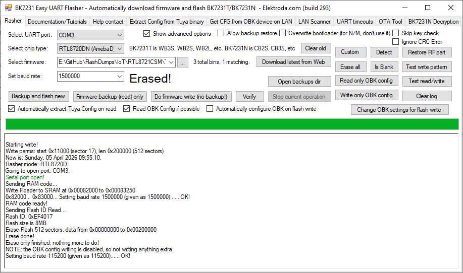

    I notice though that 'erase all' for RTL8720D erases only 2mb, whereas the erase before flash will erase the size of file being flashed, up to 8mb.
    Screenshot of BK7231 Easy UART Flasher showing “Erased!” and an operation log for COM3
    Erase-all only clears 2 MB on RTL8720D

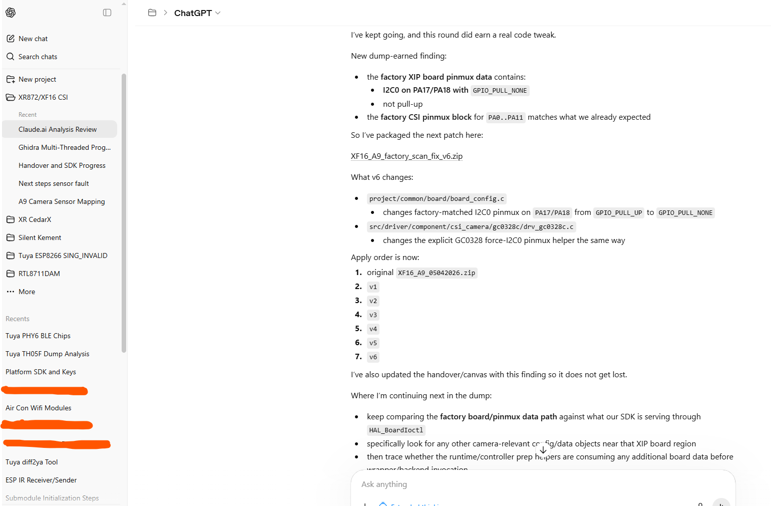

    You can also try LLM-assisted flash dump analysis, if you still have flash chips there. CPU architecture, string constants, etc.
    oh indeed. I do this a lot. feed GPT Ghidra too to run headless. it's VERY fun. I'm working on the XF16 jpeg demo at the moment like this

    Just double check to avoid giving false advice, I saw these kind of tools like to fake results sometimes, or at least describe the used methodology upfront.
    oh for sure. I take everything it comes out with with a pin of salt. Evidenced facts accepted only, repeat analysis etc etc
    It's just one of my ChatGPT 5.4 Thinking project folder trees. XF16 analysis was feeding it SDK, Ghidra and XF16 dump...
