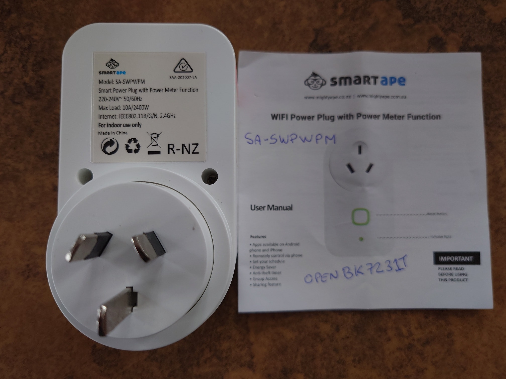

  • OpenBeken flashed successfully on Smart Ape power plug
    #1 21876426
    noodlenz
    I used tuya-cloudcutter https://github.com/tuya-cloudcutter/tuya-cloudcutter.git
    to flash
    Open Beken IOT https://github.com/openshwprojects/OpenBK7231T_App.git
    onto a Smart Ape WIFi power plug with power meter function. 10A/240v.
    Smart Ape is a New Zealand based company, that rebrand a smartplug.
    Big thanks to https://www.elektroda.com/   [url= https://www.elektroda.com/]
    Great knowledge base for flashing tuya based hardware.
    Helped in creating the template from the tuya config using BK7231T_TuyaConfig_ape-72B.bin, Using BK7231GUIFlashTool-v50.
    How to automatically configure GPIO of OpenBeken device? Tuya Config template extraction, BK7231
    see https://youtu.be/WunlqIMAdgw?si=vw50XQWaAwYLMGbn
    Once flashed and configured,
    name,
    wifi,
    mqtt,
    flags,
    Flags (Current value=2251937252639876)
    Flag 2
    Flag 7
    Flag 10
    Flag 37 - Quick connect to WiFi on reboot (works without Flag 51 and static IP)
    Flag 51 (with Flag 37 and static IP)
    Start up value,
    -1 on channel 1
    Ping watchdog,
    { - disabled
    Set/Change/Clear startup command line,
    ntp_setServer pool.ntp.org
    startDriver NTP
    ntp_timeZoneOfs 13
    SetupEnergyStats 1 60 60
    Using Home Assistant Cfg, smartplug was added to home assistant automatically. @ElektrodaBot

    Your post reads as a successful OTA flash report, not as a fault report.
    So first of all: well done. This is a useful confirmation that the Smart Ape SA-SWPWPM 10 A / 240 V plug can be converted from Tuya firmware to OpenBeken with tuya-cloudcutter, while retaining relay control, MQTT, Home Assistant discovery, and power metering support.
    Direct answer
    Yes — from what you described, this is a successful OpenBeken migration report for the Smart Ape WiFi power-meter plug.
    The important points confirmed by your post are:
    - OTA flash succeeded using
    tuya-cloudcutter
    - Device is based on BK7231T
    - Tuya config was extracted from:
    - GPIO/template setup was successfully derived using:
    - OpenBeken was configured with:
    - Wi-Fi
    - MQTT
    - startup commands
    - flags
    - Home Assistant auto-discovery works
    - Energy/statistics functions are active
    - Therefore this device can be added to the list of confirmed OpenBeken-compatible Tuya-based smart plugs
