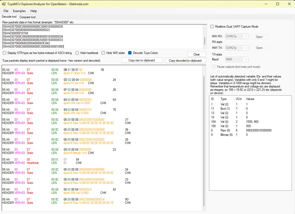

Decoding Tuya WiFi log 55AA0307 packets and repeating DP frames and make autoexec
ramielsaady 507 1
  • Repeated Tuya DP frames every 2 seconds
    #1 21877903
    ramielsaady
    Posts: 8
    /R 4/5/2026 3:50:38 PM WiFi received: 55AA03070008010200040000000119 //R 4/5/2026 3:50:38 PM WiFi received: 55AA030700050B010001001B //R 4/5/2026 3:50:38 PM WiFi received: 55AA030700080D0200040000000024 //R 4/5/2026 3:50:38 PM WiFi received: 55AA030700080F0200040000000026 //R 4/5/2026 3:50:38 PM WiFi received: 55AA0307000868020004000003E86A //R 4/5/2026 3:50:38 PM WiFi received: 55AA0307000869020004000001F475 //R 4/5/2026 3:50:38 PM WiFi received: 55AA0307000C0600000808EE00001E00000037 //R 4/5/2026 3:50:40 PM WiFi received: 55AA03070008010200040000000119 //R 4/5/2026 3:50:40 PM WiFi received: 55AA030700050B010001001B //R 4/5/2026 3:50:40 PM WiFi received: 55AA030700080D0200040000000024 //R 4/5/2026 3:50:40 PM WiFi received: 55AA030700080F0200040000000026 //R 4/5/2026 3:50:40 PM WiFi received: 55AA0307000868020004000003E86A //R 4/5/2026 3:50:40 PM WiFi received: 55AA0307000869020004000001F475 //R 4/5/2026 3:50:41 PM WiFi received: 55AA0307000C0600000808ED00001E00000036 //R 4/5/2026 3:50:42 PM WiFi received: 55AA03070008010200040000000119 //R 4/5/2026 3:50:42 PM WiFi received: 55AA030700050B010001001B //R 4/5/2026 3:50:42 PM WiFi received: 55AA030700080D0200040000000024 //R 4/5/2026 3:50:42 PM WiFi received: 55AA030700080F0200040000000026 //R 4/5/2026 3:50:43 PM WiFi received: 55AA0307000868020004000003E86A //R 4/5/2026 3:50:43 PM WiFi received: 55AA0307000869020004000001F475 //R 4/5/2026 3:50:43 PM WiFi received: 55AA0307000C0600000808ED00001E00000036 //R 4/5/2026 3:50:44 PM WiFi received: 55AA03070008010200040000000119 //R 4/5/2026 3:50:44 PM WiFi received: 55AA030700050B010001001B //R 4/5/2026 3:50:44 PM WiFi received: 55AA030700080D0200040000000024 //R 4/5/2026 3:50:45 PM WiFi received: 55AA030700080F0200040000000026 //R 4/5/2026 3:50:45 PM WiFi received: 55AA0307000868020004000003E86A //R 4/5/2026 3:50:45 PM WiFi received: 55AA0307000869020004000001F475 //R 4/5/2026 3:50:45 PM WiFi received: 55AA0307000C0600000808ED00001E00000036 //R 4/5/2026 3:50:45 PM WiFi received: 55AA030000010104 //R 4/5/2026 3:50:46 PM WiFi received: 55AA03070008010200040000000119 //R 4/5/2026 3:50:46 PM WiFi received: 55AA030700050B010001001B //R 4/5/2026 3:50:46 PM WiFi received: 55AA030700080D0200040000000024 //R 4/5/2026 3:50:47 PM WiFi received: 55AA030700080F0200040000000026 //R 4/5/2026 3:50:47 PM WiFi received: 55AA0307000868020004000003E86A //R 4/5/2026 3:50:47 PM WiFi received: 55AA0307000869020004000001F475 //R 4/5/2026 3:50:47 PM WiFi received: 55AA0307000C0600000808ED00001E00000036 //R 4/5/2026 3:50:47 PM WiFi received: 55AA03070008090500040000000023 //R 4/5/2026 3:50:48 PM WiFi received: 55AA03070008010200040000000119 //R 4/5/2026 3:50:48 PM WiFi received: 55AA030700050B010001001B //R 4/5/2026 3:50:49 PM WiFi received: 55AA030700080D0200040000000024 //R 4/5/2026 3:50:49 PM WiFi received: 55AA030700080F0200040000000026 //R 4/5/2026 3:50:49 PM WiFi received: 55AA0307000868020004000003E86A //R 4/5/2026 3:50:49 PM WiFi received: 55AA0307000869020004000001F475 //R 4/5/2026 3:50:49 PM WiFi received: 55AA0307000C0600000808ED00001E00000036 //R 4/5/2026 3:50:50 PM WiFi received: 55AA03070008010200040000000119 //R 4/5/2026 3:50:50 PM WiFi received: 55AA030700050B010001001B //R 4/5/2026 3:50:51 PM WiFi received: 55AA030700080D0200040000000024 //R 4/5/2026 3:50:51 PM WiFi received: 55AA030700080F0200040000000026 //R 4/5/2026 3:50:51 PM WiFi received: 55AA0307000868020004000003E86A //R 4/5/2026 3:50:51 PM WiFi received: 55AA0307000869020004000001F475 //R 4/5/2026 3:50:51 PM WiFi received: 55AA0307000C0600000808ED00001E00000036 //R 4/5/2026 3:50:52 PM WiFi received: 55AA03070008090500040000000023 //R 4/5/2026 3:50:52 PM WiFi received: 55AA03070008010200040000000119 //R 4/5/2026 3:50:52 PM WiFi received: 55AA030700050B010001001B //R 4/5/2026 3:50:53 PM WiFi received: 55AA030700080D0200040000000024 //R 4/5/2026 3:50:53 PM WiFi received: 55AA030700080F0200040000000026 //R 4/5/2026 3:50:53 PM WiFi received: 55AA0307000868020004000003E86A //R 4/5/2026 3:50:53 PM WiFi received: 55AA0307000869020004000001F475 //R 4/5/2026 3:50:53 PM WiFi received: 55AA0307000C0600000808EE00001E00000037 //R 4/5/2026 3:50:54 PM WiFi received: 55AA03070008010200040000000119 //R 4/5/2026 3:50:54 PM WiFi received: 55AA030700050B010001001B //R 4/5/2026 3:50:55 PM WiFi received: 55AA030700080D0200040000000024 //R 4/5/2026 3:50:55 PM WiFi received: 55AA030700080F0200040000000026 //R 4/5/2026 3:50:55 PM WiFi received: 55AA0307000868020004000003E86A //R 4/5/2026 3:50:55 PM WiFi received: 55AA0307000869020004000001F475 //R 4/5/2026 3:50:55 PM WiFi received: 55AA0307000C0600000808ED00001E00000036 //R 4/5/2026 3:50:56 PM WiFi received: 55AA03070008010200040000000119 //R 4/5/2026 3:50:56 PM WiFi received: 55AA030700050B010001001B //R 4/5/2026 3:50:57 PM WiFi received: 55AA030700080D0200040000000024 //R 4/5/2026 3:50:57 PM WiFi received: 55AA030700080F0200040000000026 //R 4/5/2026 3:50:57 PM WiFi received: 55AA0307000868020004000003E86A //R 4/5/2026 3:50:57 PM WiFi received: 55AA0307000869020004000001F475 //R 4/5/2026 3:50:58 PM WiFi received: 55AA0307000C0600000808EC00001E00000035 //R 4/5/2026 3:50:58 PM WiFi received: 55AA03070008010200040000000119 //R 4/5/2026 3:50:59 PM WiFi received: 55AA030700050B010001001B //R 4/5/2026 3:50:59 PM WiFi received: 55AA030700080D0200040000000024 //R 4/5/2026 3:50:59 PM WiFi received: 55AA030700080F0200040000000026 //R 4/5/2026 3:50:59 PM WiFi received: 55AA0307000868020004000003E86A //R 4/5/2026 3:51:00 PM WiFi received: 55AA0307000869020004000001F475 //R 4/5/2026 3:51:00 PM WiFi received: 55AA0307000C0600000808ED00001E00000036 //R 4/5/2026 3:51:00 PM WiFi received: 55AA03070008010200040000000119 //R 4/5/2026 3:51:01 PM WiFi received: 55AA030700050B010001001B //R 4/5/2026 3:51:01 PM WiFi received: 55AA030700080D0200040000000024 //R 4/5/2026 3:51:01 PM WiFi received: 55AA030700080F0200040000000026 //R 4/5/2026 3:51:01 PM WiFi received: 55AA0307000868020004000003E86A //R 4/5/2026 3:51:02 PM WiFi received: 55AA0307000869020004000001F475 //R 4/5/2026 3:51:02 PM WiFi received: 55AA0307000C0600000808EC00001E00000035 //R 4/5/2026 3:51:02 PM WiFi received: 55AA030000010104 //R 4/5/2026 3:51:02 PM WiFi received: 55AA03070008010200040000000119 //R 4/5/2026 3:51:03 PM WiFi received: 55AA030700050B010001001B //R 4/5/2026 3:51:03 PM WiFi received: 55AA030700080D0200040000000024 //R 4/5/2026 3:51:03 PM WiFi received: 55AA030700080F0200040000000026 //R 4/5/2026 3:51:04 PM WiFi received: 55AA0307000868020004000003E86A //R 4/5/2026 3:51:04 PM WiFi received: 55AA0307000869020004000001F475 //R 4/5/2026 3:51:04 PM WiFi received: 55AA0307000C0600000808EC00001E00000035 //R 4/5/2026 3:51:05 PM WiFi received: 55AA03070008010200040000000119 //R 4/5/2026 3:51:05 PM WiFi received: 55AA030700050B010001001B //R 4/5/2026 3:51:05 PM WiFi received: 55AA030700080D0200040000000024 //R 4/5/2026 3:51:05 PM WiFi received: 55AA030700080F0200040000000026 //R 4/5/2026 3:51:06 PM WiFi received: 55AA0307000868020004000003E86A //R 4/5/2026 3:51:06 PM WiFi received: 55AA0307000869020004000001F475 //R 4/5/2026 3:51:06 PM WiFi received: 55AA0307000C0600000808EC00001E00000035 //R 4/5/2026 3:51:07 PM WiFi received: 55AA03070008010200040000000119 //R 4/5/2026 3:51:07 PM WiFi received: 55AA030700050B010001001B //R 4/5/2026 3:51:07 PM WiFi received: 55AA030700080D0200040000000024 //R 4/5/2026 3:51:08 PM WiFi received: 55AA030700080F0200040000000026 //R 4/5/2026 3:51:08 PM WiFi received: 55AA0307000868020004000003E86A //R 4/5/2026 3:51:08 PM WiFi received: 55AA0307000869020004000001F475 //R 4/5/2026 3:51:09 PM WiFi received: 55AA0307000C0600000808EC00001E00000035 //R 4/5/2026 3:51:09 PM WiFi received: 55AA03070008010200040000000119 //R 4/5/2026 3:51:09 PM WiFi received: 55AA030700050B010001001B //R 4/5/2026 3:51:10 PM WiFi received: 55AA030700080D0200040000000024 //R 4/5/2026 3:51:10 PM WiFi received: 55AA030700080F0200040000000026 //R 4/5/2026 3:51:11 PM WiFi received: 55AA0307000868020004000003E86A //R 4/5/2026 3:51:11 PM WiFi received: 55AA0307000869020004000001F475 //R 4/5/2026 3:51:11 PM WiFi received: 55AA0307000C0600000808EC00001E00000035 //R 4/5/2026 3:51:12 PM WiFi received: 55AA03070008090500040000000023 //R 4/5/2026 3:51:12 PM WiFi received: 55AA03070008010200040000000119 //R 4/5/2026 3:51:12 PM WiFi received: 55AA030700050B010001001B //R 4/5/2026 3:51:13 PM WiFi received: 55AA030700080D0200040000000024 //R 4/5/2026 3:51:13 PM WiFi received: 55AA030700080F0200040000000026 //R 4/5/2026 3:51:14 PM WiFi received: 55AA0307000868020004000003E86A //R 4/5/2026 3:51:14 PM WiFi received: 55AA0307000869020004000001F475 //R 4/5/2026 3:51:14 PM WiFi received: 55AA0307000C0600000808EC00001E00000035 //R 4/5/2026 3:51:15 PM WiFi received: 55AA03070008010200040000000119 //R 4/5/2026 3:51:15 PM WiFi received: 55AA030700050B010001001B //R 4/5/2026 3:51:16 PM WiFi received: 55AA030700080D0200040000000024 //R 4/5/2026 3:51:16 PM WiFi received: 55AA030700080F0200040000000026 //R 4/5/2026 3:51:16 PM WiFi received: 55AA0307000868020004000003E86A //R 4/5/2026 3:51:17 PM WiFi received: 55AA0307000869020004000001F475 //R 4/5/2026 3:51:17 PM WiFi received: 55AA0307000C0600000808EC00001E00000035 //R 4/5/2026 3:51:18 PM WiFi received: 55AA03070008010200040000000119 //R 4/5/2026 3:51:18 PM WiFi received: 55AA030700050B010001001B //R 4/5/2026 3:51:19 PM WiFi received: 55AA030700080D0200040000000024 //R 4/5/2026 3:51:19 PM WiFi received: 55AA030700080F0200040000000026 //R 4/5/2026 3:51:20 PM WiFi received: 55AA0307000868020004000003E86A //R 4/5/2026 3:51:20 PM WiFi received: 55AA0307000869020004000001F475 //R 4/5/2026 3:51:21 PM WiFi received: 55AA0307000C0600000808EC00001E00000035 //R 4/5/2026 3:51:21 PM WiFi received: 55AA030000010104 //R 4/5/2026 3:51:22 PM WiFi received: 55AA03070008010200040000000119 //R 4/5/2026 3:51:22 PM WiFi received: 55AA030700050B010001001B //R 4/5/2026 3:51:23 PM WiFi received: 55AA030700080D0200040000000024 //R 4/5/2026 3:51:23 PM WiFi received: 55AA030700080F0200040000000026 //R 4/5/2026 3:51:24 PM WiFi received: 55AA0307000868020004000003E86A //R 4/5/2026 3:51:24 PM WiFi received: 55AA0307000869020004000001F475 //R 4/5/2026 3:51:25 PM WiFi received: 55AA0307000C0600000808EC00001E00000035 //R 4/5/2026 3:51:25 PM WiFi received: 55AA03070008010200040000000119 //R 4/5/2026 3:51:26 PM WiFi received: 55AA030700050B010001001B //R 4/5/2026 3:51:26 PM WiFi received: 55AA030700080D0200040000000024 //R 4/5/2026 3:51:27 PM WiFi received: 55AA030700080F0200040000000026 //R 4/5/2026 3:51:27 PM WiFi received: 55AA0307000868020004000003E86A //R 4/5/2026 3:51:28 PM WiFi received: 55AA0307000869020004000001F475 //R 4/5/2026 3:51:28 PM WiFi received: 55AA0307000C0600000808EC00001E00000035 //R 4/5/2026 3:51:29 PM WiFi received: 55AA03070008010200040000000119 //R 4/5/2026 3:51:29 PM WiFi received: 55AA030700050B010001001B //R 4/5/2026 3:51:30 PM WiFi received: 55AA030700080D0200040000000024 //R 4/5/2026 3:51:31 PM WiFi received: 55AA030700080F0200040000000026 //R 4/5/2026 3:51:31 PM WiFi received: 55AA0307000868020004000003E86A //R 4/5/2026 3:51:32 PM WiFi received: 55AA0307000869020004000001F475 //R 4/5/2026 3:51:32 PM WiFi received: 55AA0307000C0600000808EB00001E00000034 //R 4/5/2026 3:51:33 PM WiFi received: 55AA03070008010200040000000119 //R 4/5/2026 3:51:33 PM WiFi received: 55AA030700050B010001001B //R 4/5/2026 3:51:34 PM WiFi received: 55AA030700080D0200040000000024 //R 4/5/2026 3:51:34 PM WiFi received: 55AA030700080F0200040000000026 //R 4/5/2026 3:51:35 PM WiFi received: 55AA0307000868020004000003E86A //R 4/5/2026 3:51:35 PM WiFi received: 55AA0307000869020004000001F475 //R 4/5/2026 3:51:36 PM WiFi received: 55AA0307000C0600000808ED00001E00000036 //R 4/5/2026 3:51:36 PM WiFi received: 55AA03070008010200040000000119 //R 4/5/2026 3:51:37 PM WiFi received: 55AA030700050B010001001B //R 4/5/2026 3:51:38 PM WiFi received: 55AA030700080D0200040000000024 //R 4/5/2026 3:51:38 PM WiFi received: 55AA030700080F0200040000000026 //R 4/5/2026 3:51:39 PM WiFi received: 55AA0307000868020004000003E86A //R 4/5/2026 3:51:39 PM WiFi received: 55AA0307000869020004000001F475 //R 4/5/2026 3:51:40 PM WiFi received: 55AA0307000C0600000808EC00001E00000035 //R 4/5/2026 3:51:41 PM WiFi received: 55AA03070008010200040000000119 //R 4/5/2026 3:51:41 PM WiFi received: 55AA030700050B010001001B //R 4/5/2026 3:51:42 PM WiFi received: 55AA030700080D0200040000000024 //R 4/5/2026 3:51:42 PM WiFi received: 55AA030700080F0200040000000026 //R 4/5/2026 3:51:43 PM WiFi received: 55AA0307000868020004000003E86A //R 4/5/2026 3:51:44 PM WiFi received: 55AA0307000869020004000001F475 //R 4/5/2026 3:51:44 PM WiFi received: 55AA0307000C0600000808ED00001E00000036 //R 4/5/2026 3:51:54 PM WiFi received: 55AA03070008010200040000000119 //R 4/5/2026 3:51:55 PM WiFi received: 55AA030700050B010001001B //R 4/5/2026 3:51:56 PM WiFi received: 55AA030700080D0200040000000024 //R 4/5/2026 3:51:56 PM WiFi received: 55AA030700080F0200040000000026 //R 4/5/2026 3:51:57 PM WiFi received: 55AA0307000868020004000003E86A //R 4/5/2026 3:51:57 PM WiFi received: 55AA0307000869020004000001F475 //R 4/5/2026 3:51:58 PM WiFi received: 55AA0307000C0600000808ED00001E00000036 //R 4/5/2026 3:51:59 PM WiFi received: 55AA03070008010200040000000119 //R 4/5/2026 3:51:59 PM WiFi received: 55AA030700050B010001001B //R 4/5/2026 3:52:00 PM WiFi received: 55AA030700080D0200040000000024 //R 4/5/2026 3:52:01 PM WiFi received: 55AA030700080F0200040000000026 //R 4/5/2026 3:52:01 PM WiFi received: 55AA0307000868020004000003E86A //R 4/5/2026 3:52:02 PM WiFi received: 55AA0307000869020004000001F475 //R 4/5/2026 3:52:03 PM WiFi received: 55AA0307000C0600000808EC00001E00000035 //R 4/5/2026 3:52:03 PM WiFi received: 55AA03070008010200040000000119 //R 4/5/2026 3:52:04 PM WiFi received: 55AA030700050B010001001B //R 4/5/2026 3:52:04 PM WiFi received: 55AA030700080D0200040000000024 //R 4/5/2026 3:52:05 PM WiFi received: 55AA030700080F0200040000000026 //R 4/5/2026 3:52:06 PM WiFi received: 55AA0307000868020004000003E86A //R 4/5/2026 3:52:06 PM WiFi received: 55AA0307000869020004000001F475 //R 4/5/2026 3:52:07 PM WiFi received: 55AA0307000C0600000808EC00001E00000035 //R 4/5/2026 3:52:08 PM WiFi received: 55AA03070008010200040000000119 //R 4/5/2026 3:52:09 PM WiFi received: 55AA030700050B010001001B //R 4/5/2026 3:52:09 PM WiFi received: 55AA030700080D0200040000000024 //R 4/5/2026 3:52:10 PM WiFi received: 55AA030700080F0200040000000026 //R 4/5/2026 3:52:11 PM WiFi received: 55AA0307000868020004000003E86A //R 4/5/2026 3:52:11 PM WiFi received: 55AA0307000869020004000001F475 //R 4/5/2026 3:52:12 PM WiFi received: 55AA0307000C0600000808EA00001E00000033 //R 4/5/2026 3:52:13 PM WiFi received: 55AA030000010104 //R 4/5/2026 3:52:13 PM WiFi received: 55AA03070008010200040000000119 //R 4/5/2026 3:52:14 PM WiFi received: 55AA030700050B010001001B //R 4/5/2026 3:52:15 PM WiFi received: 55AA030700080D0200040000000024 //R 4/5/2026 3:52:16 PM WiFi received: 55AA030700080F0200040000000026 //R 4/5/2026 3:52:16 PM WiFi received: 55AA0307000868020004000003E86A //R 4/5/2026 3:52:17 PM WiFi received: 55AA0307000869020004000001F475 //R 4/5/2026 3:52:18 PM WiFi received: 55AA0307000C0600000808EC00001E00000035 //R 4/5/2026 3:52:18 PM WiFi received: 55AA03070008090500040000000023 //R 4/5/2026 3:52:19 PM WiFi received: 55AA03070008010200040000000119 //R 4/5/2026 3:52:20 PM WiFi received: 55AA030700050B010001001B //R 4/5/2026 3:52:21 PM WiFi received: 55AA030700080D0200040000000024 //R 4/5/2026 3:52:21 PM WiFi received: 55AA030700080F0200040000000026 //R 4/5/2026 3:52:22 PM WiFi received: 55AA0307000868020004000003E86A //R 4/5/2026 3:52:24 PM WiFi received: 55AA03070008010200040000000119 //R 4/5/2026 3:52:25 PM WiFi received: 55AA030700050B010001001B //R 4/5/2026 3:52:26 PM WiFi received: 55AA030700080D0200040000000024 //R 4/5/2026 3:52:27 PM WiFi received: 55AA030700080F0200040000000026 //R 4/5/2026 3:52:28 PM WiFi received: 55AA0307000868020004000003C042 //R 4/5/2026 3:52:28 PM WiFi received: 55AA0307000869020004000001F475 //R 4/5/2026 3:52:29 PM WiFi received: 55AA0307000C0600000808EC00006E0000189D //R 4/5/2026 3:52:30 PM WiFi received: 55AA03070008010200040000000119 //R 4/5/2026 3:52:31 PM WiFi received: 55AA030700050B010001001B
    this uart capture for this device

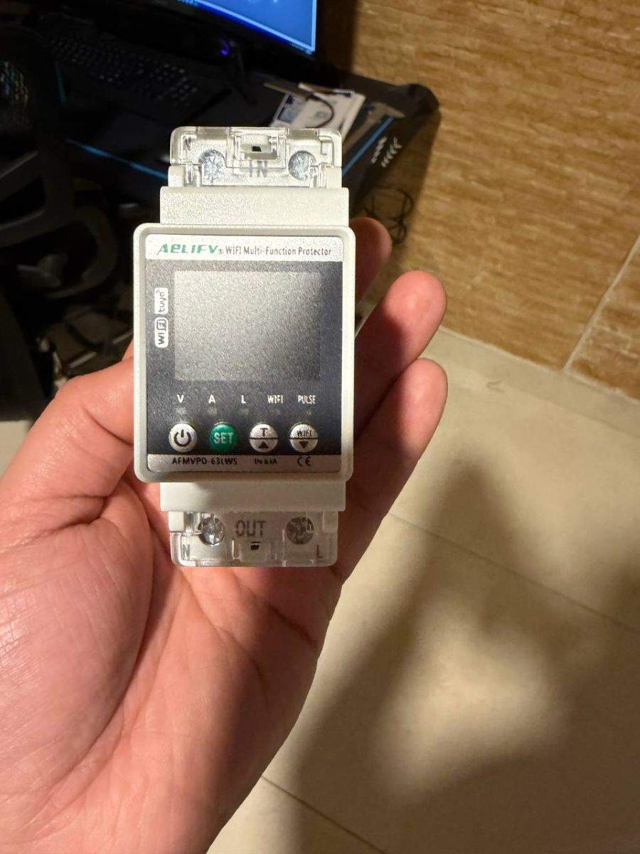

    A person holds a modular power meter with display and buttons; label reads “WiFi Multi-Function Protector”.
    AI: What is the exact device brand/model (or at least what type of Tuya device is it), and what functions are you trying to map from these DPs?
    Aelifv
    AI: What firmware/tool are you using for this capture and autoexec (OpenBeken/BKWriter/Tasmota/custom), and what exactly do you want autoexec to do: replay these UART frames at boot, send a DP command once, or keep syncing state?
    i use tuya original frimware to get dpid and make dp for openbeken frimware
