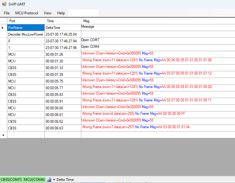

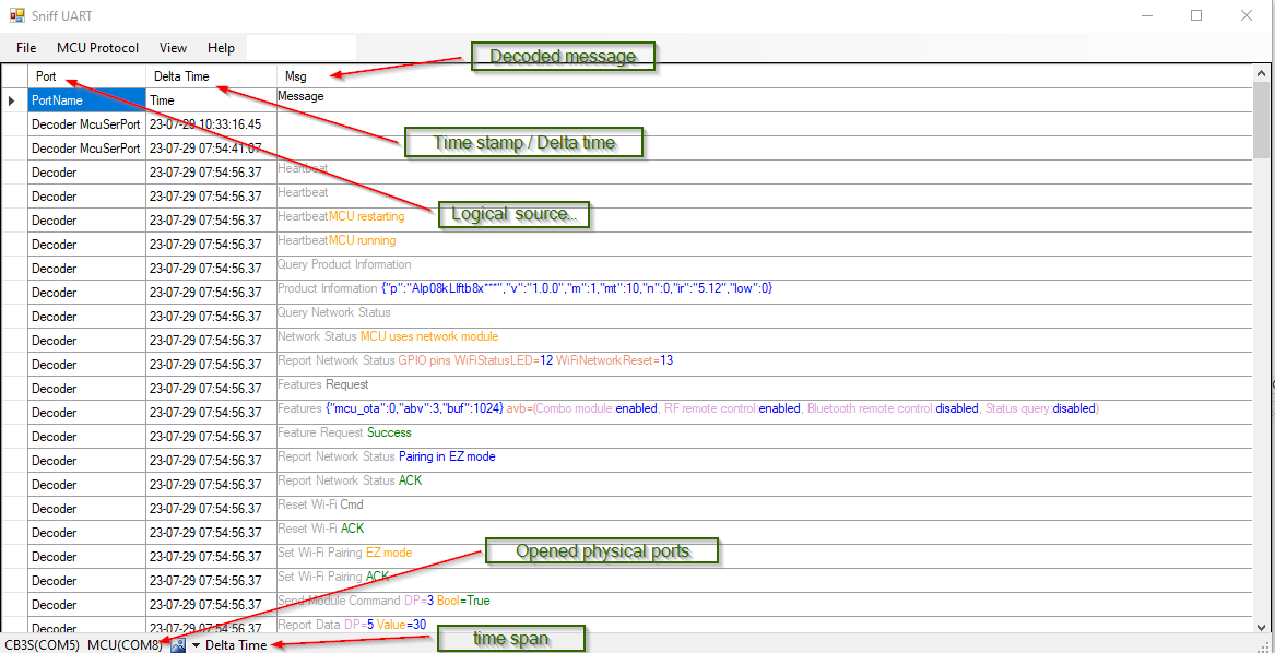

    There is a further Windows program available on GitHub named "SniffUART".
    Screenshot of the Sniff UART program showing a table of decoded messages from serial ports, annotated with arrows and labels.
    What is the difference to TuyaMcu Analyzer?
    - improve communication to serial USB adapters.
    - all Tuya messages specified by Tuya are decoded.
    - maintainable, means errors can easily be fixed & further decoding can be added.
    A lot of work - hopefully worth it to you.
    Please have a look at the Readme.md on GitHub.

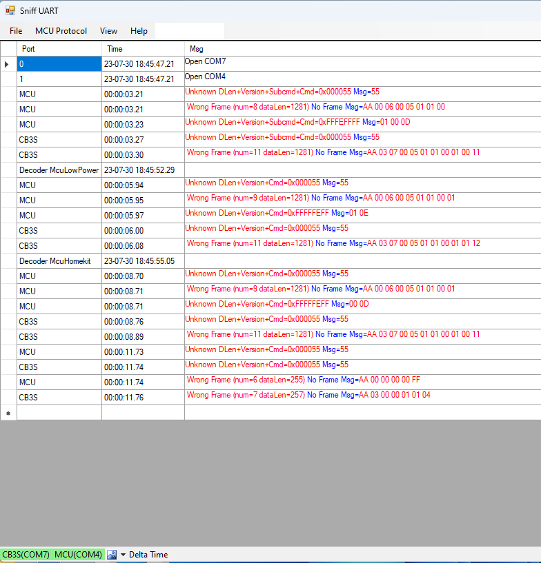

    Decided to give this a test as me and @p.kaczmarek2 are working on something TuyaMCU related but I am not having luck decoding the messages so far. Any idea?
    Sniff UART software window displaying error messages about frames and message decoding on COM4 and COM7 ports.
    Screenshot of the Sniff UART program showing serial communication analysis with multiple decoding errors for TuyaMCU frames.
  • #7 20674055
    Posts: 14825
    Rate: 13000
    You have set decoder MCU Low Power?

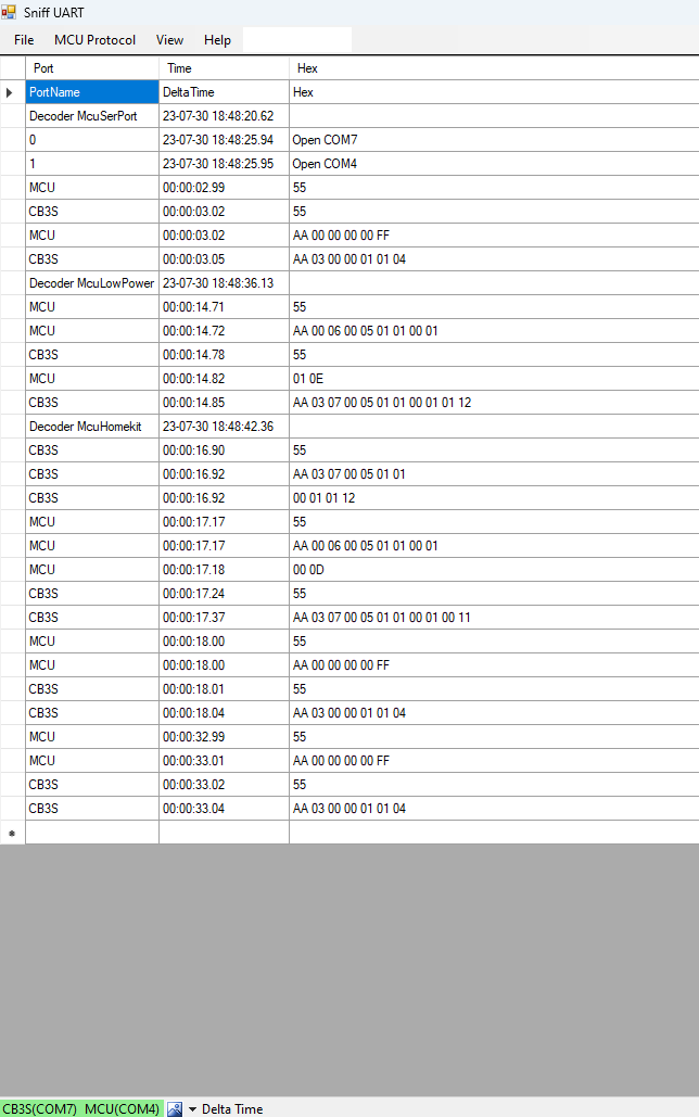

    DeDaMrAz
    Posts: 623
    Help: 34
    Rate: 130
    Capture in HEX looks to be alright and we can decode them using TuyaMCU Analyzer from @p.kaczmarek2
    Sniff UART program window displaying serial communication logs between MCU and CB3S module with decoded HEX data.

    #9 20675424
    mkmunichmk
    Posts: 32
    It looks like SniffUART has a problem finding the end of a message. You'll need to play around with the parameter "Read Timeout" in the port settings. This time in ms defines the gap time between messages. Normally, a serial port will send all bytes at once (using an internal 16-byte buffer if the chip). Of course, the Windows driver could 'divide' the byte stream, so the first byte could come immediately and the 'rest' with a second call to ReadBytes. For this, I'd configured a minimal message length of 2 bytes. Maybe I should increase this fixed value in the code.
    But first, you should try to increase the Read Timeout to e.g. 100 ms.
    One last-minute change has been to increase the thread priority. If you can compile the source code, you could comment this out
    in PortHandler.cs at line ~33
    _readThread.Priority = ThreadPriority.Highest;
    Maybe "AboveNormal" would help? Please let me know.
