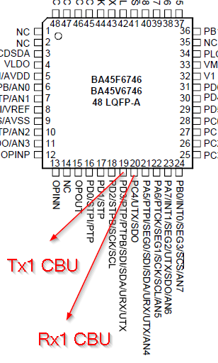

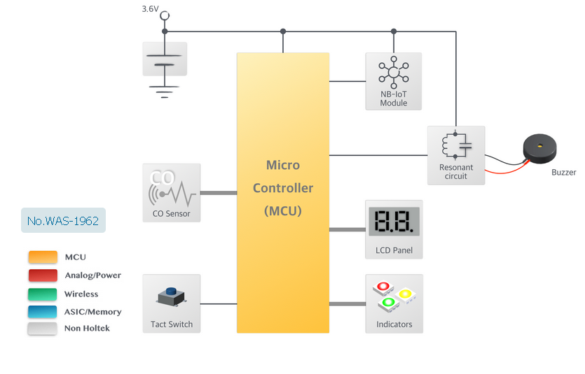

    I am sitting on a new device: Carbon Monoxide (CO) detector. Details once there's something to present, for now I'm stuck on the communication between the MCU and the TuyaMCU.
    A dedicated BA45F6746 from Holtek is used as the MCU for detection, with display support. A CBU is being used as the TuyaMCU. Datasheet attached.
    Block diagram of carbon monoxide detector with components. .
    MCU handles display, sensor, status and failure LEDs, test button, alarm buzzer.
    The TuyaMCU handles the battery status, WiFi LED, reset button + one more, as yet unidentified signal (I'm betting on a CO detection alarm).
    The rest of the communication is over the UART:
    The illustration shows the pin diagram of the Holtek BA45F6746 microcontroller in a 48 LQFP-A package with connections for Tx1 and Rx1 to the CBU module highlighted. .
    The problem is that between the circuits, the communication goes through messages that are unknown to me.
    Below are examples of these. After switching on the device, 3 packets each go on Rx and Tx and silence. I am very much asking for help in possibly understanding them:

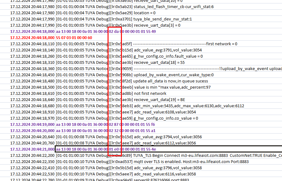

    I've been away for a while, I've taken some timestamp logs and linked them so you can see the correlation between TuyaMCU and MCU, maybe this will get someone closer to a solution.
    By the way, do you know how to strigger the carbon monoxide sensor without the monoxide itself? I'd like to trigger an alarm and see how the TuyaMCU is informed of the alarm.

    Only two bytes and the checksum at the end change, have you tried checking what is in those bytes? What do they look like as a 16 bit integer for example?
    Tuya debug log with highlighted byte values. .
