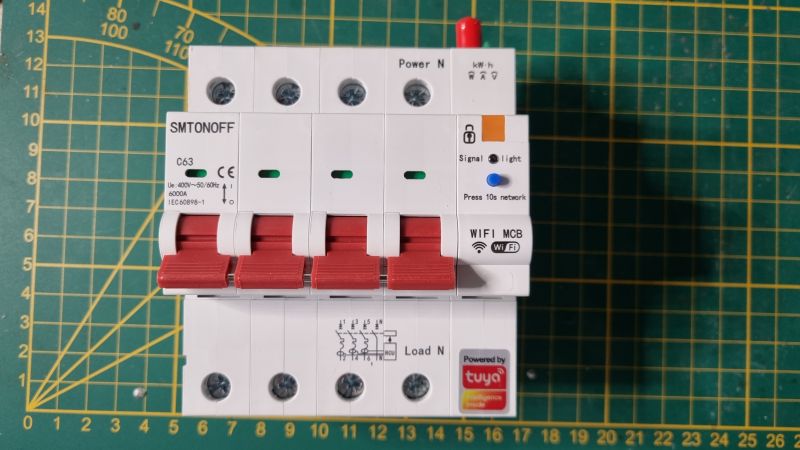

    Device used for demonstration
    The following demonstration is based on Tuya DIN 4P 1-63A which was donated to me by a reader. However, here I will just focus on Raw format from TuyaMCU packets, the full teardown will be posted separately.
    Tuya DIN 4P 1-63A device with WiFi features on a green measurement mat.

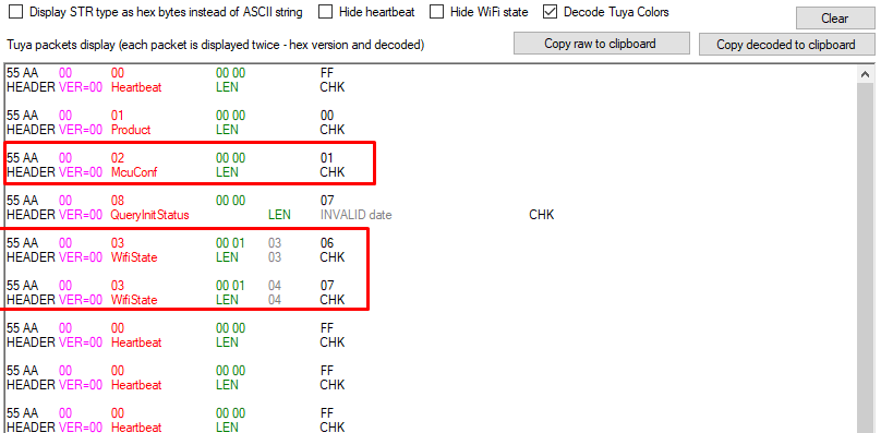

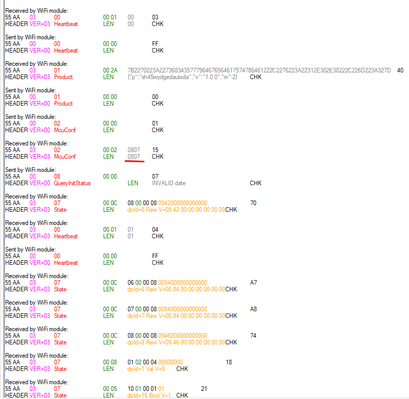

    Initial communication capture
    At first I've decided to use my TuyaMCU analyzer to take a basic communication capture between MCU and the WiFi module:
    Screenshot of communication analysis between WiFi module and MCU.
    The first interesting thing here is that the WiFi state packet is not sent at all! This is because this device is using something called Processing by the Wi-Fi module, as indicated by the presence of payload of 0x02 packet (MCUConf).

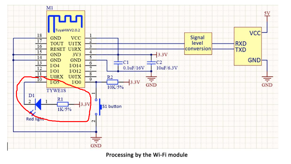

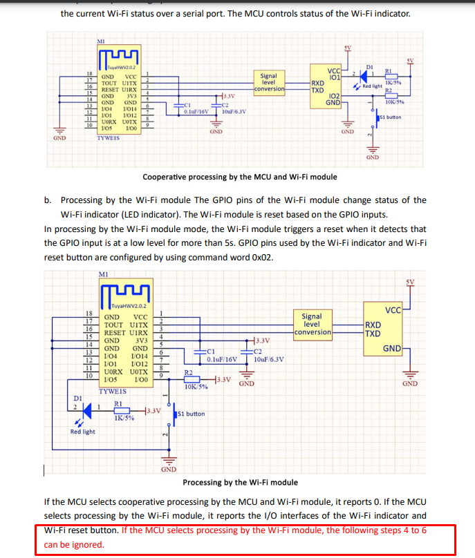

    Processing by the Wi-Fi module - the GPIO pins of the Wi-Fi module change status of the Wi-Fi indicator (LED indicator). The Wi-Fi module is reset based on the GPIO inputs.
    In processing by the Wi-Fi module mode, the Wi-Fi module triggers a reset when it detects that the GPIO input is at a low level for more than 5s. GPIO pins used by the Wi-Fi indicator and Wi-Fi reset button are configured by using command word 0x02.
    The command payload is 0807, which means that P08 is a WiFi LED and also WiFi state output for the MCU, and 07 is the pairing button...
    Note: if the 0x02 packet (MCUConf) has no payload, then processing is done by the MCU, and everything works out of the box, no extra pins are required.

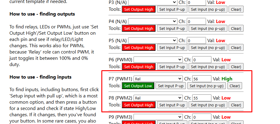

    Everything was failing so far, until I decided to try setting the WiFi LED pin...

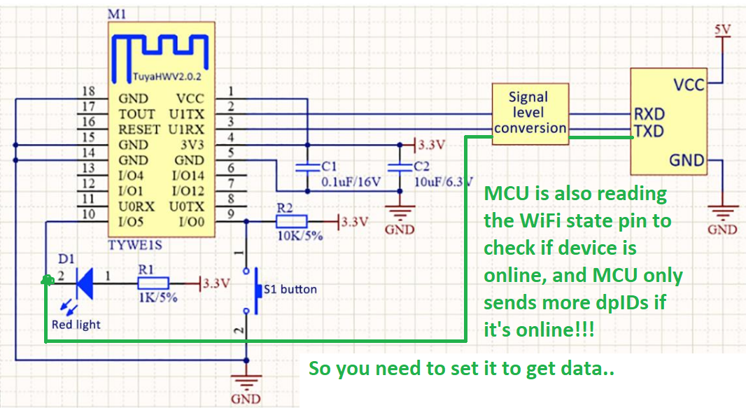

    Simple solution to the problem
    It turned out that the already mentioned P08 is not just used for WiFi LED - it has a LED connected, but it also enables sending of more dpIDs. I've tested it with GPIODoctor:
    Screenshot of a settings interface for outputs P7 and P8 on a TuyaMCU device.
    This means that MCU is physically to connected to this pin as well and it's reading this pin state...
    So once I've set it's state to AlwaysHigh (or AlwaysLow, depending on the device):
    Now, it looks like we have a full set of data! That's what we needed for the futher processing.

    If your TuyaMCU device is reporting MCUConf packet with non-zero length, the reported byte values are WiFi state and reset button pins. The WiFi state pin is not only just used for LED - it's also used to enable sending futher dpIDs from the MCU. So, in order to get all the values from it, you need to set it to either AlwaysLow or AlwaysHigh in OBK setting. Only that way will work for devices in WiFi processing mode, no "WiFistate 0x04", neither "querying the state" will work here.
    I've attached related TuyaMCU doc in PDF format, you can check it out for more details. Interestingly enough, it DOES NOT show that the MCU is also reading the LED state...
    Diagram of a device with a Tuya Wi-Fi module and connected red LED.
    So I guess they didn't bother to document well the case I described here.

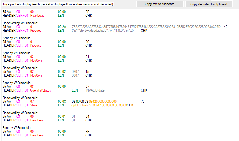

    Very good question! As you can see on the mentioned capture, there is no WiFi state packet at all in WiFi-processing exchange:
    Please compare it with other communication dump (WiFi to MCU only):
    Screenshot of a tool displaying Tuya communication packets in hexadecimal format.
    As you can see, there are two cases:
    - if MCUConf (0x02) has no payload, then WiFi state is reported by 0x03 packet
    - if MCUConf (0x02) has payload, then payload of MCUConf specified the pins used for WiFi state and reset, and no 0x03 packet is sent
    You can find out the same if you check out Tuya docs:
    Diagram of Wi-Fi module connection to MCU and information on cooperative processing.

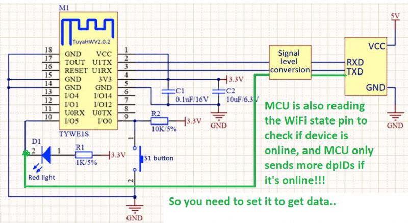

    My only problem was that Tuya documentation does not show that MCU is also reading the WiFi state (LED) pin to check if it can send more dpIDs!.
    The correct schematic should be:

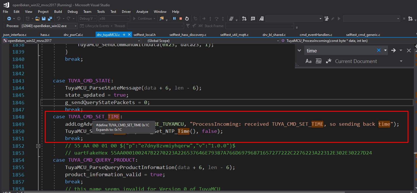

    I am uploading information from this thread .
    Problem: the device is not sending data to MQTT, despite being set up:
    tuyaMcu_defWiFiState 4
    The WiFi connection marker would appear and disappear, the device would establish a WiFi connection from the beginning every 1 minute or so.
    The solution was to set the driver to support NTP and the correct time on the device previously added:
    startDriver NTP
    //ntp_timeZoneOfs 1 //optional
    tuyaMcu_sendCurTime //wysyła czas z TuyaMCU do MCU, bez tego jak zgubił czas to nie uaktualniał
    This automatically set the time and stabilised the WiFi connection. A side effect was that the transmission of CB3S-defined channels from TuyaMCU appeared.
  • #5 21324964
    Posts: 14770
    Rate: 12913
    So it seems that there are at least 3 methods used by TuyaMCU (non-battery powered version) to check for correct connectivity:
    - WiFi state packet (0x04 means connected to cloud and paired)
    - GPIO output (if MCUConf length is 2?)
    - NTP data (I guess it checks for correct, non 1970? time sent there):
    Screenshot of source code in Microsoft Visual Studio related to setting time in TuyaMCU.
