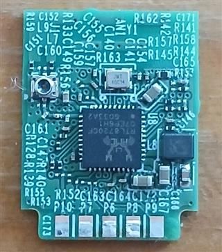

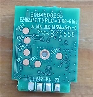

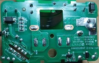

    Anyone has info on this RTL board? It's from a Tapo P105 plug. Any info much appreciated.
    Unfortunately, the pinout doesn't seem to match ESP-02S :(.
    Green printed circuit board with electronic components and a central cutout revealing a black ribbon Close-up of a small PCB with an integrated circuit and surface-mount components Small green PCB with printed numbers, circuit traces, and four silver contacts along the bottom edge

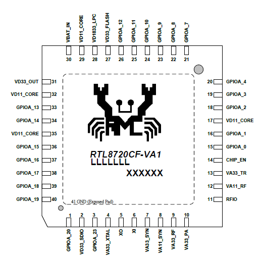

    not seen that one around I don't think. Do you have a multimeter? could do with tracing to which pins each of the TP pads go to on the RTL8720CF
    Pinout diagram of RTL8720CF-VA1 IC with a crab-like logo and labeled pins around the package

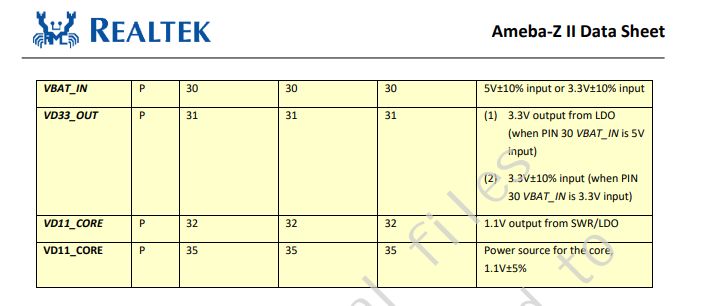

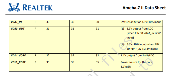

    It seems it's being fed with 5 V.

    5v - seems that is acceptable for RTL8720CF
    Excerpt of a Realtek Ameba‑Z II datasheet table showing power pins and voltage notes

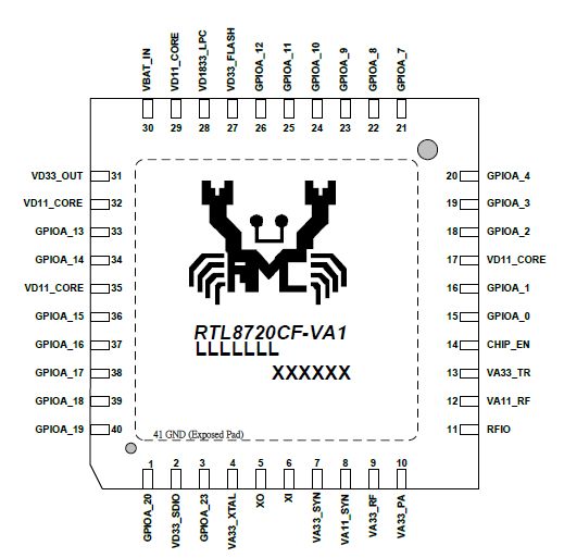

    It was easier than expected. Should be enough to flash it, thx for the idea. I'll update when I know, unless I release the smoke reserves from the chip LOL.
    TP1 - Vcc, TP8 - Gnd
    TP6 - GPIOA_0, TP9 - 36 (GPIOA_15 UART_Log_RXD), TP7 - 37 (GPIOA_16 UART_Log_TXD)
    TP10 - possibly GPIOA_13 RX
    If I read it correctly, TP6 and 10 go to VCC for flashing.
    Added after 4 [hours] 35 [minutes]:
    >>21878639
    Successfully flashed OpenBeken! Used ltchiptool-v4.14.0 and ltchiptool_ambz2_2026-04-06_14-42-02
    TP1, TP6, TP10 - Vcc , TP8 - Gnd , TP9 - RXD , TP7 - TXD
