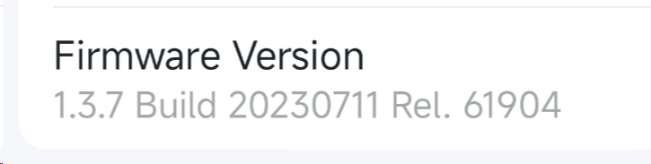

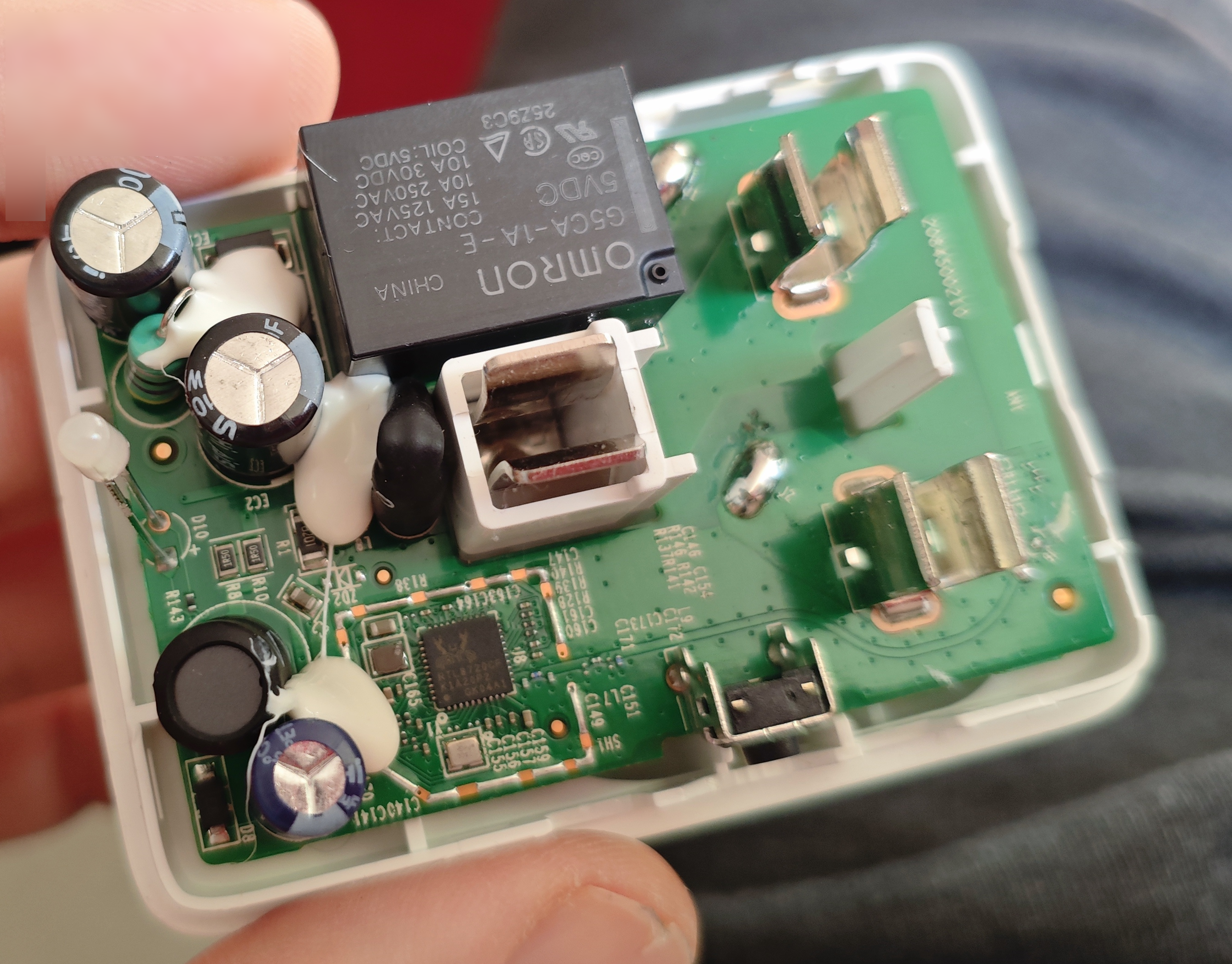

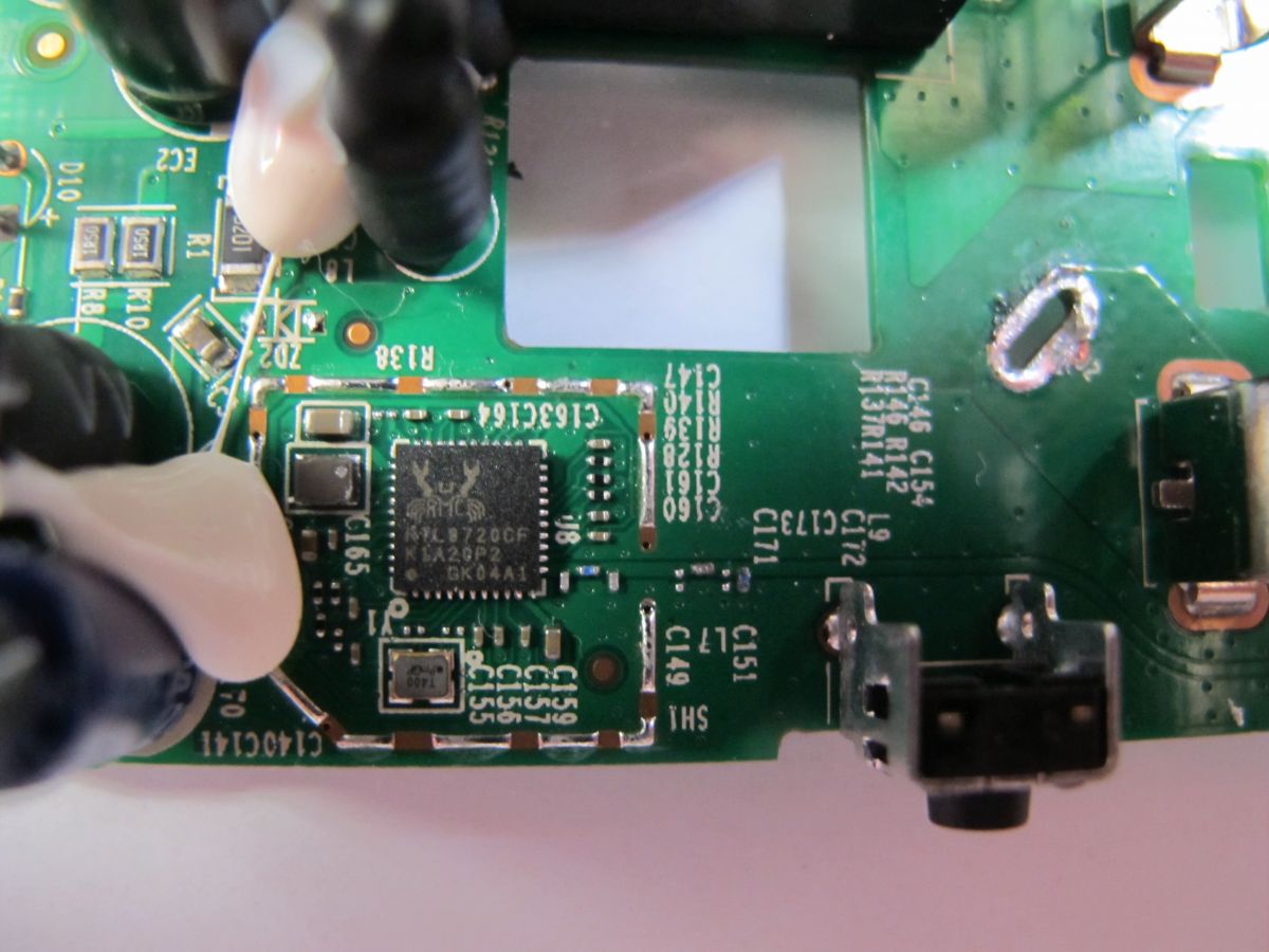

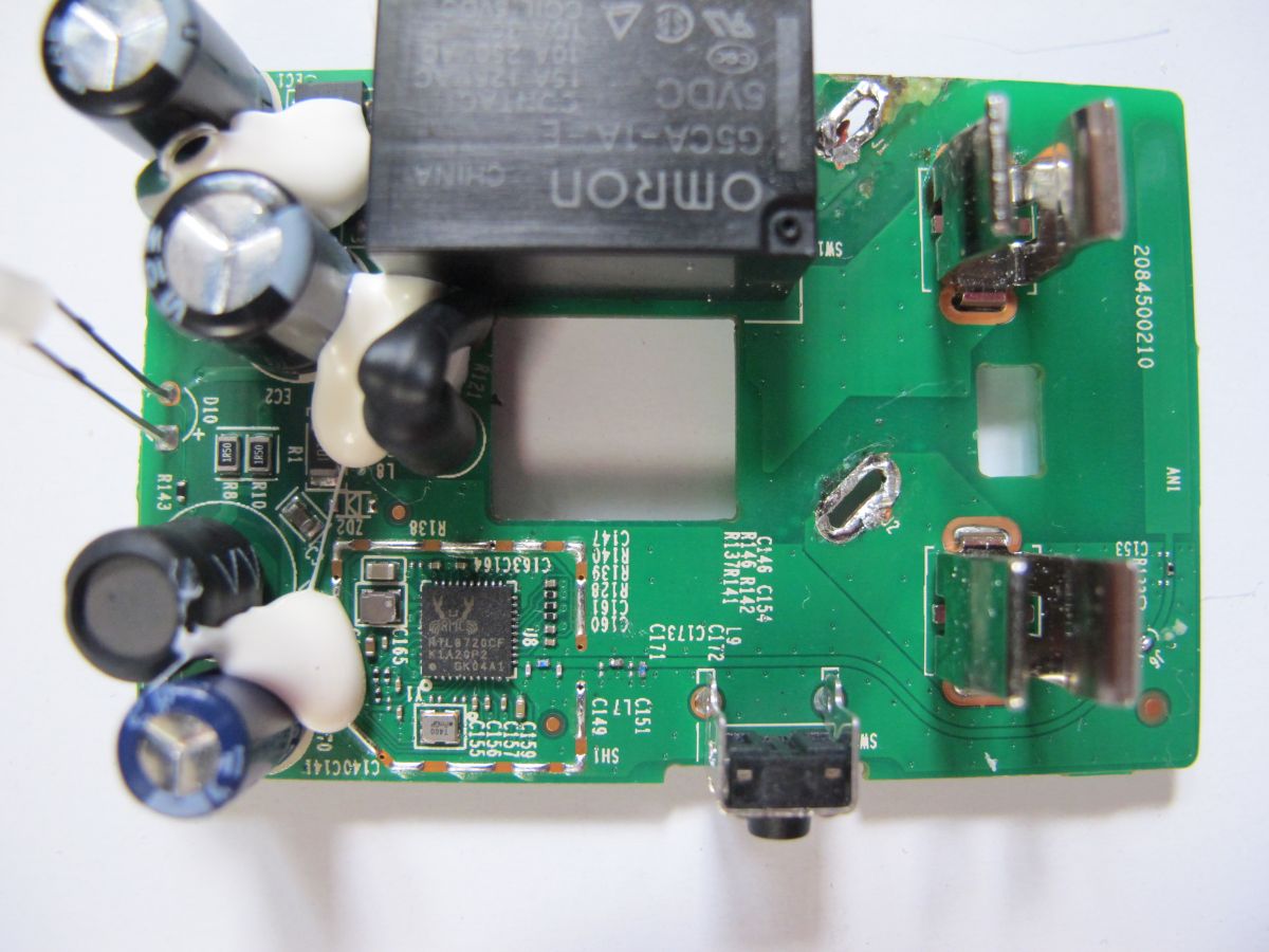

    I had given someone a Tapo P100 which is RTL8720CF, so nabbed that back (swapped with Beken device). Here's some resources relating to the P100. New post rather than make a distraction in the development thread.
    Tapo P100 smart plug with tapo logo and LED indicator.

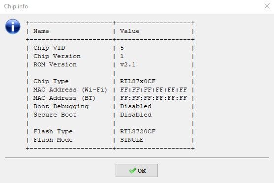

    Boot
    Chip information displayed in a table on a computer screen.
    Circuit board of Tapo P100 with RTL8720CF chip and capacitors. PCB with markings and electronic components. Close-up of an electronic circuit with a visible RTL8720CF chip.
    Close-up of the internal electronics of a Tapo P100 device.
    Tapo P100 PCB with connector and pin labels.
    Screenshot of firmware version 1.3.7 Build 20230711 Rel. 61904.
    • Tapo_P100_RTL8720CF_AmebaZ2_1.3.7.bin (2 MB) You must be logged in to download this attachment.

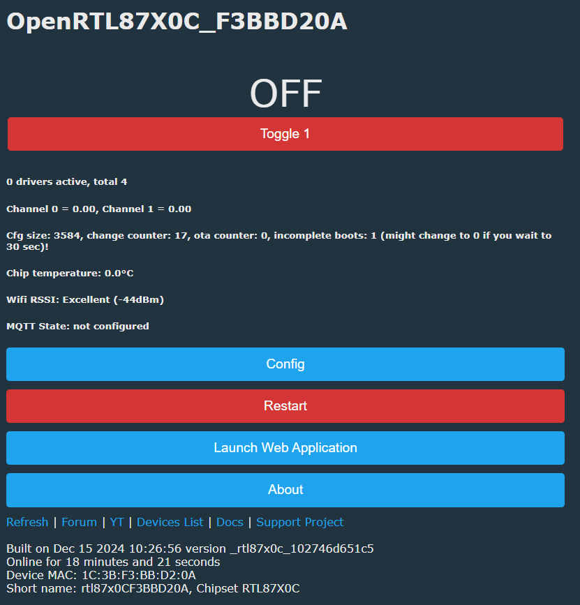

    RELAY - PA8
    BTN - PA17
    LED_N - PA10
    Screenshot of the OpenRTL87X0C software interface with the toggle switch turned off.

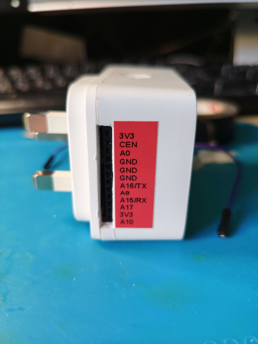

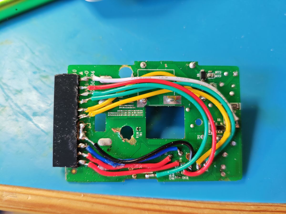

    I also have Tapo P100 but EU version, and the board is a bit different. But I have a few questions regarding the flashing connection scheme.
    Would you mind sharing your connection setup for flashing the chip?
    I'm assuming that PA15 and PA16 go to TX and RX.
    What about PA0? I've read somewhere it should go to 3v3.
    And should I put C_EN to GND while booting to put it in download mode?
  • #4 21369606
    Posts: 5213
    Help: 446
    Rate: 914
    yes to PA15/16 and I pulled PA00 high with direct connection to 3.3V. I did not need to use CEN - just powered on with PA00 connected.

    This is more useful. Some GPIOs not seen on RTL8720CF modules I have. Not for use with the mains of course.
    An electronic adapter with a plug and a pin header labeled on a red sticker White electrical plug with a red label RTL8720CF. Printed circuit board with soldered colorful wires on a blue surface.
