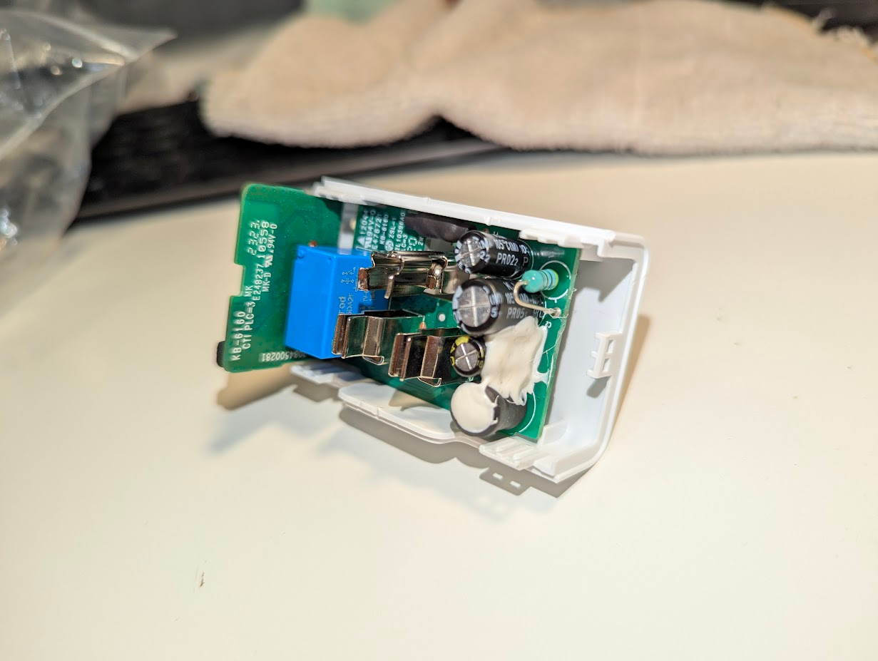

    This is for a HS103V5 (Version 5)
    TP-Link smart plug connected to an American electrical outlet.

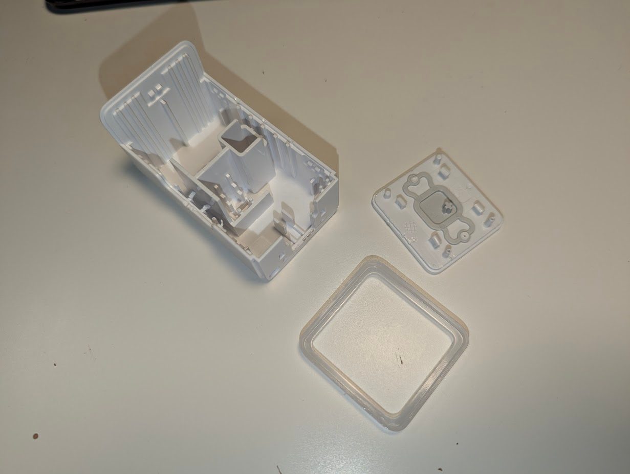

    The case is pretty difficult to open. First, you have to remove the cap with the clear plastic ring. Then the rest of the case can be pried open:
    A printed circuit board with electronic components in a white case on a table.
    Three plastic casing parts for an electrical device on a white table.

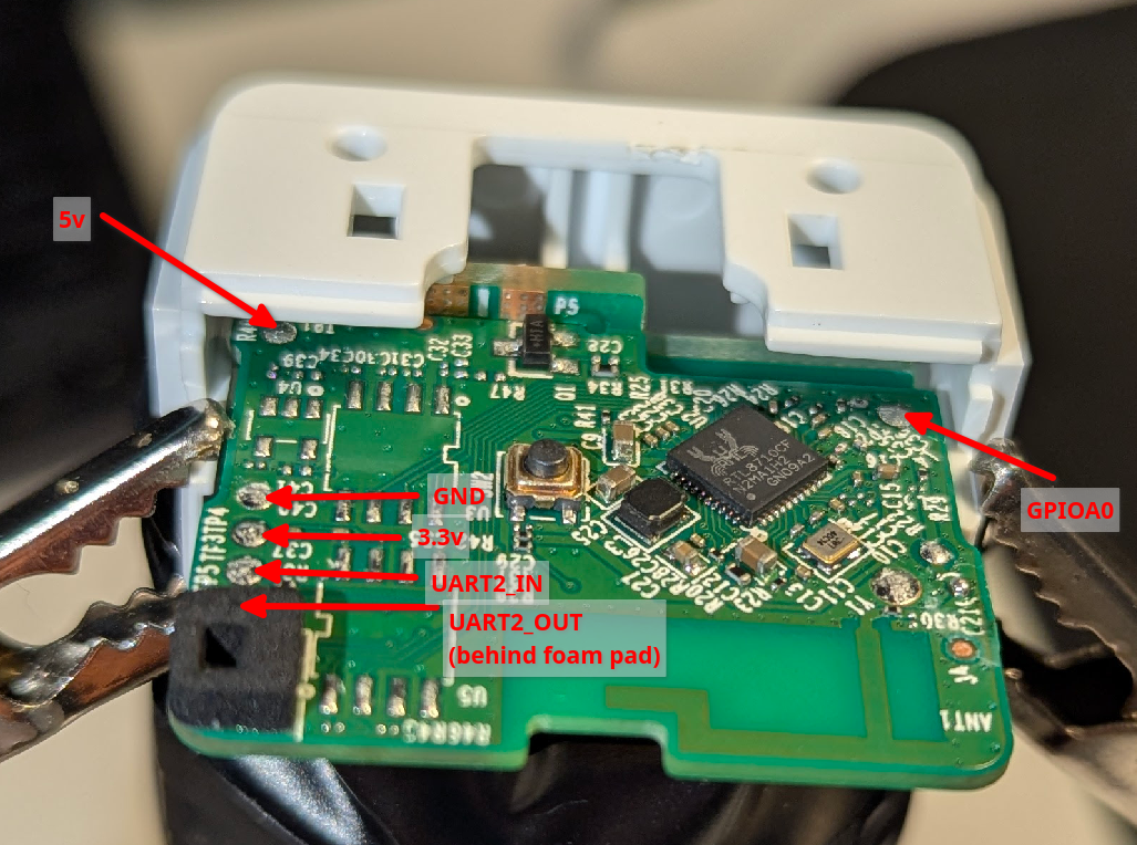

    Then use these test points to flash OpenRTL:
    TP1 Vcc 5 V
    TP3 3.3 V
    TP4 GND
    TP6 UART2_OUT
    TP5 UART2_IN
    TP2 GPIOA0
    Don't forget to short GPIOA0 to 3.3 V to enable bootloader mode.
    Close-up of an electronic device's PCB with labeled connection pins: 5V, GND, 3.3V, UART2_IN, UART2_OUT, and GPIOA0.
    I recommend removing the black foam pad to make things easier.

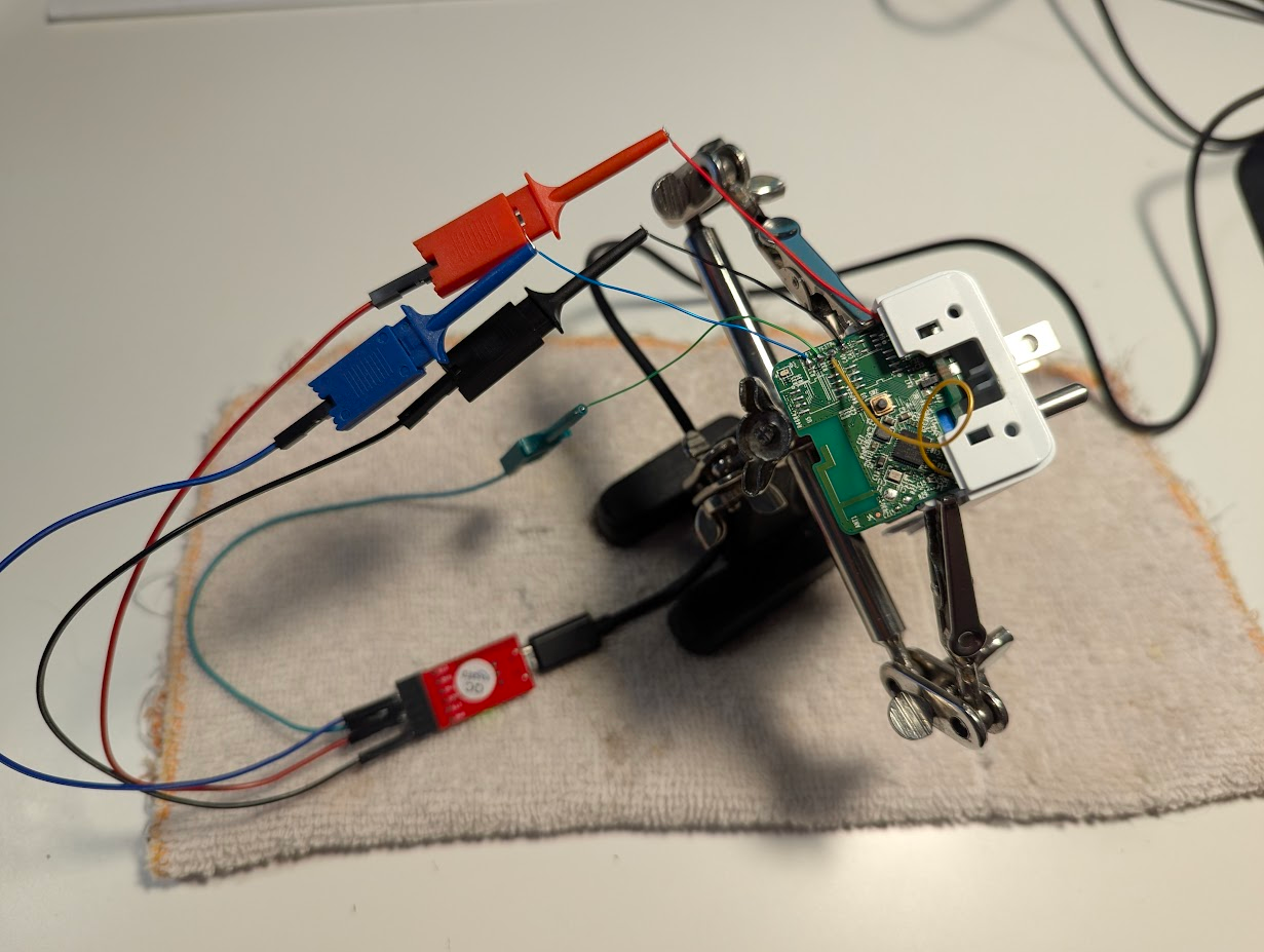

    Here's my setup:
    A PCB of an electrical socket with test wires connected, held in a helping hand tool.
    FLash using RTL87X0C UART Flash
    https://github.com/openshwprojects/OpenBK7231T_App/releases

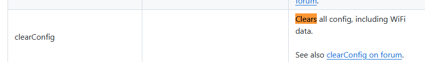

    Hmmm, I just found this:
    https://github.com/openshwprojects/OpenBK7231T_App/blob/main/docs/safeMode.md
    And I think it means the configuration is not erased, but ignored, which would be enough because that's what the original firmware did for a 5s long press of the button.

    addEventHandler OnHold 17 SafeMode 5
    addEventHandler OnHold 17 clearConfig 20
    Will try this. We should also add this to https://www.elektroda.com/rtvforum/topic4098414.html. I'll have to double-check but I think the template does not handle the dedicated reset button...

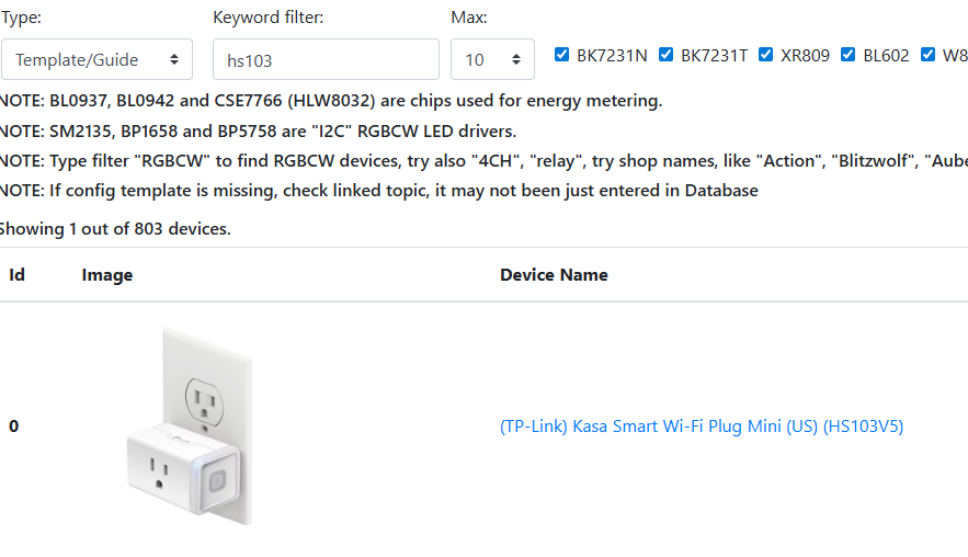

  • #9 21769686
    Jerther
    Posts: 30
    Rate: 9
    @divadiow I see the template hasn't been pushed to the main repository... Anyway to make it happen?

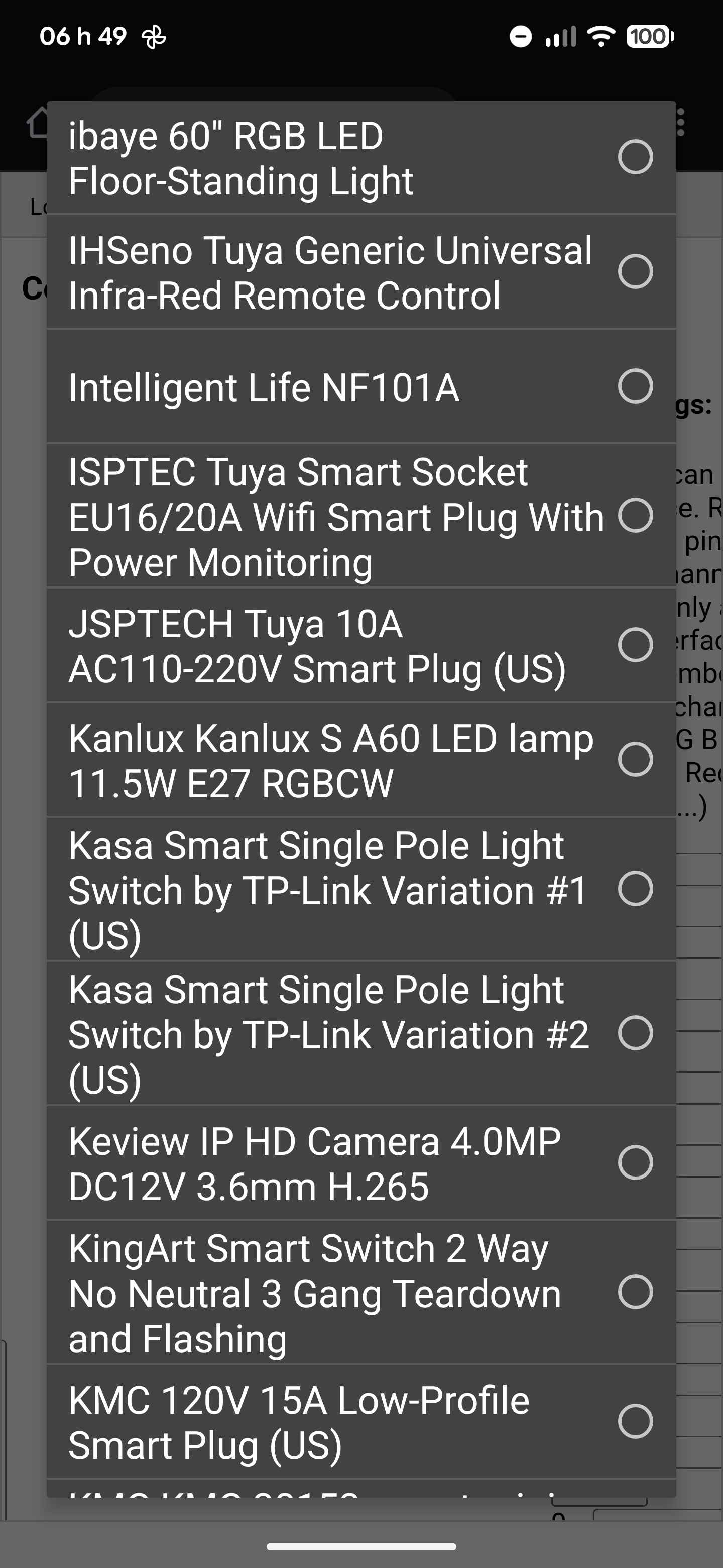

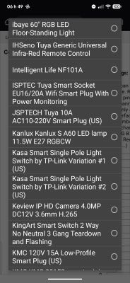

  • #11 21769980
    Jerther
    Posts: 30
    Rate: 9
    Oh, I get it now. The name is wrong. Same for the dual exterior plug. I think Kasa devices should be grouped together, like the HS200 variants:
    Smart home device list in a mobile app interface
