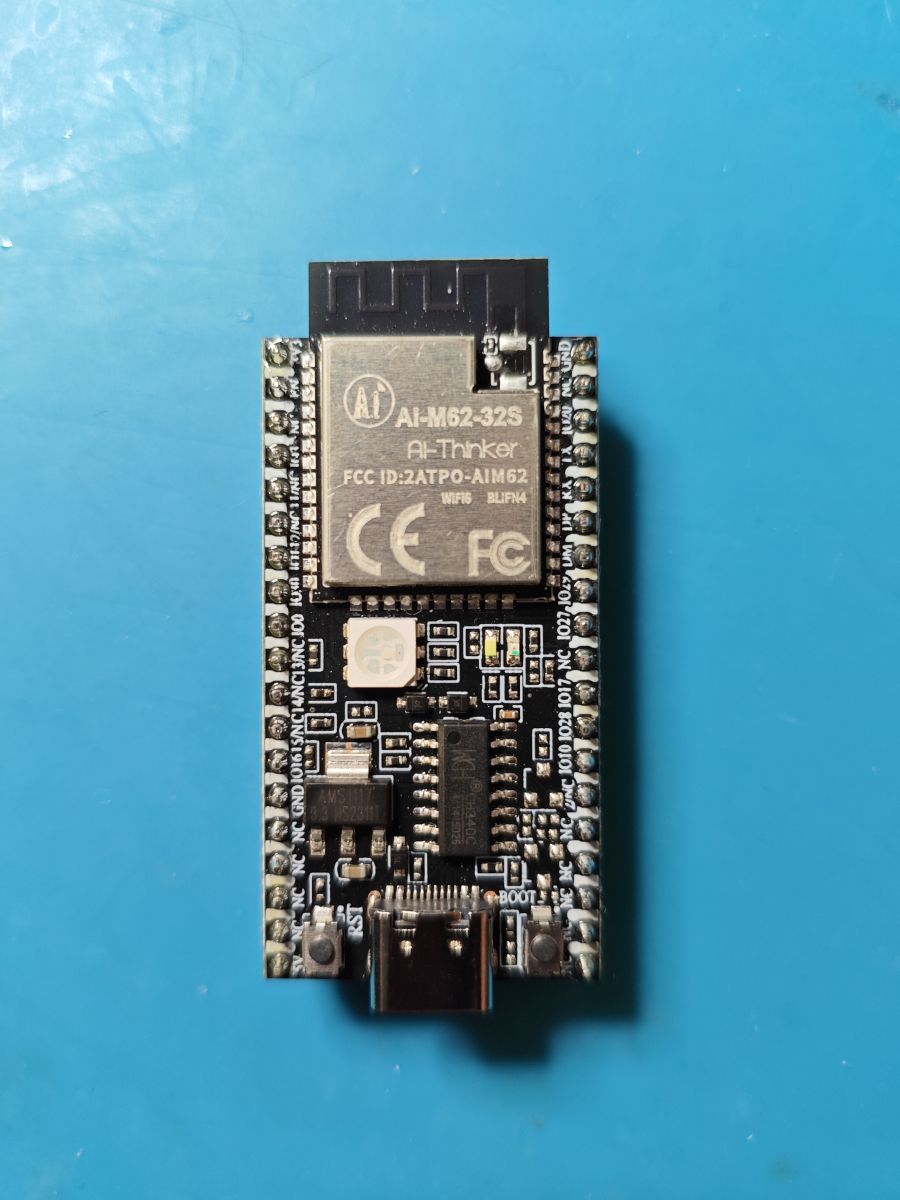

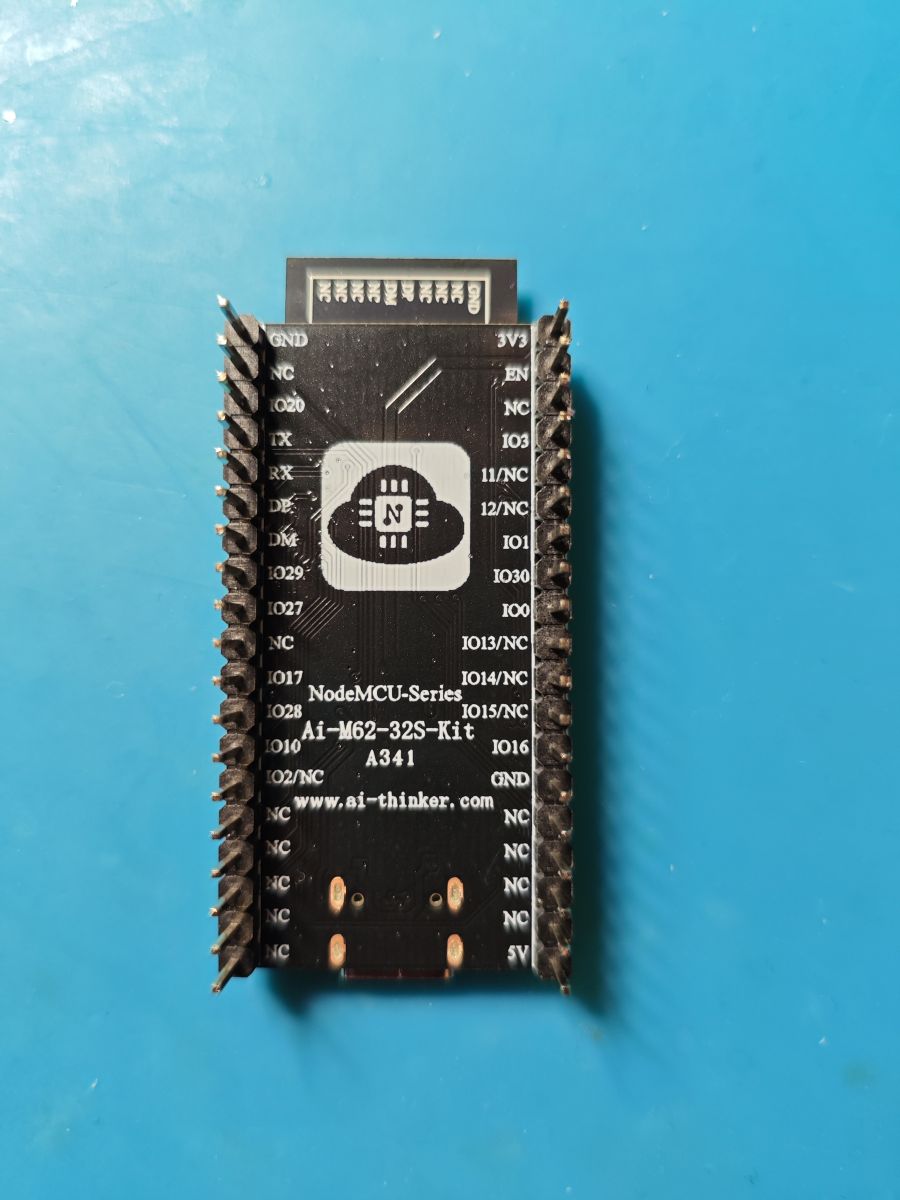

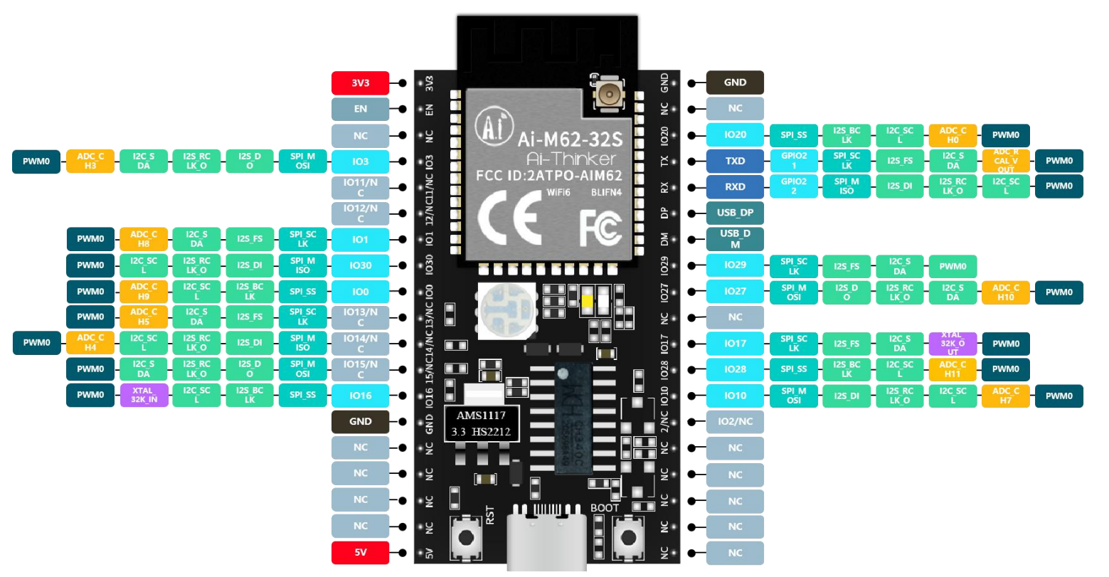

    A little topic on my BL616 experiences and some pics of OpenBL616 (in development, general release disabled) and maybe as a place for any future BL616-specific points.
    BL616/BL618 is Wi-Fi 6 + Bluetooth 5.3 + 802.15.4(Zigbee/Thread) combo chipset for ultra-low-power applications
    Ai-Thinker Ai-M62-32S-Kit from Ali Express
    Bouffalo Lab BL616/Ai-Thinker Ai-M62-32S-Kit: OpenBL616Bouffalo Lab BL616/Ai-Thinker Ai-M62-32S-Kit: OpenBL616
    https://en.ai-thinker.com/pro_view-128.html

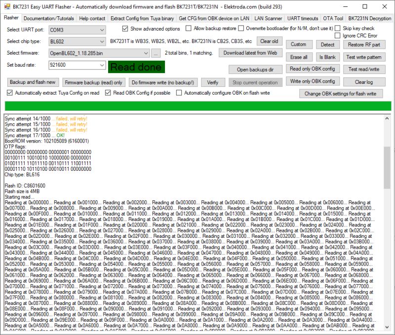

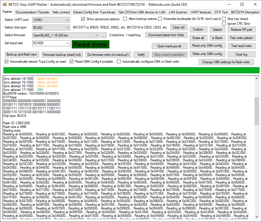

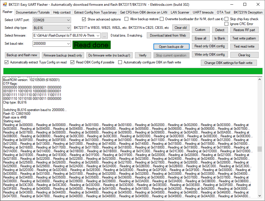

    Easy Flasher dump 4mb
    boot log 115200
    dump + efuse: https://github.com/divadiow/FlashDumps/tree/main/IoT/BL616

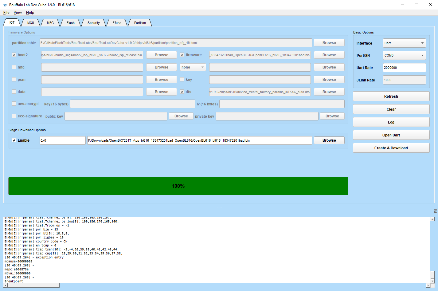

    @insmod how are you getting your OpenBL616 to boot? I don't seem to be able to nail the combinations as if AIO or multi-part

    insmod wrote:
    4M partition table, boot2, firmware and dts.
    Not single download.
    yeh, image was last-ditch try single download anyway check.
    boot log currently:
    insmod wrote:
    and there's one bugged commit with trailing whitespace in file name).
    where's this? this can be fixed in Windows though surely?

    cheers. breakpoint still though.

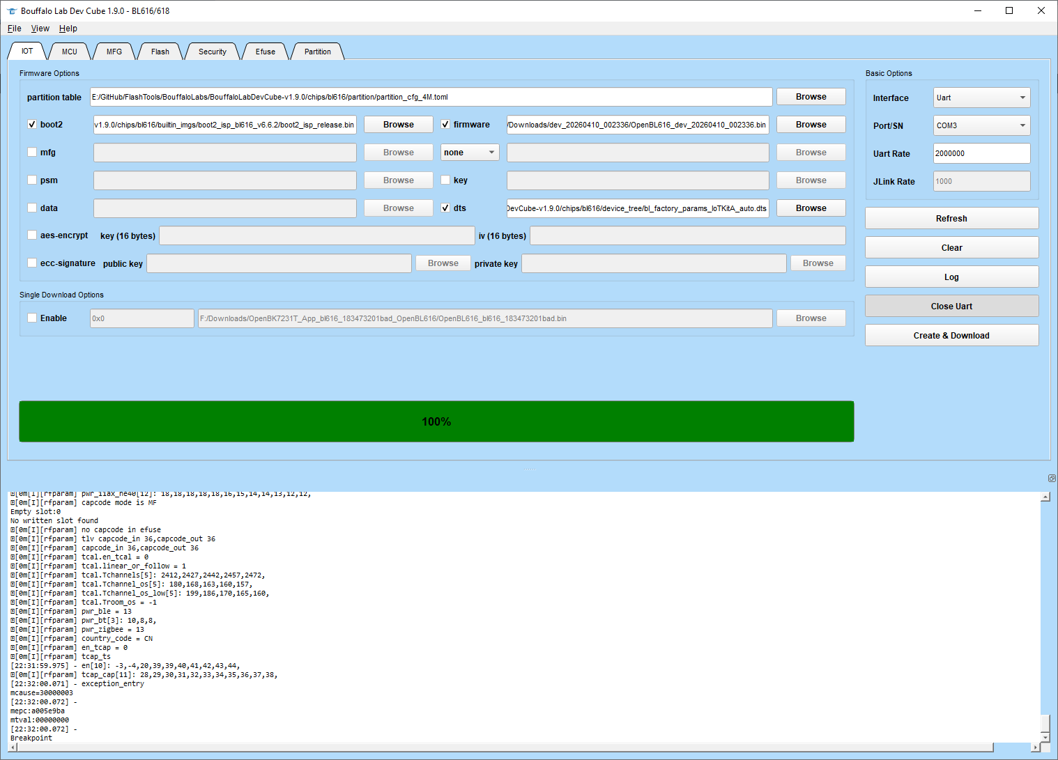

    Screenshot of Buffalo Lab Dev Cube 1.9.0 showing flashing settings and a 100% progress bar
    Added after 8 [minutes]:
    I see our hardware differs
    QFN56 / 8 MB flash / 4 MB PSRAM vs QFN40 / 4 MB / no PSRAM

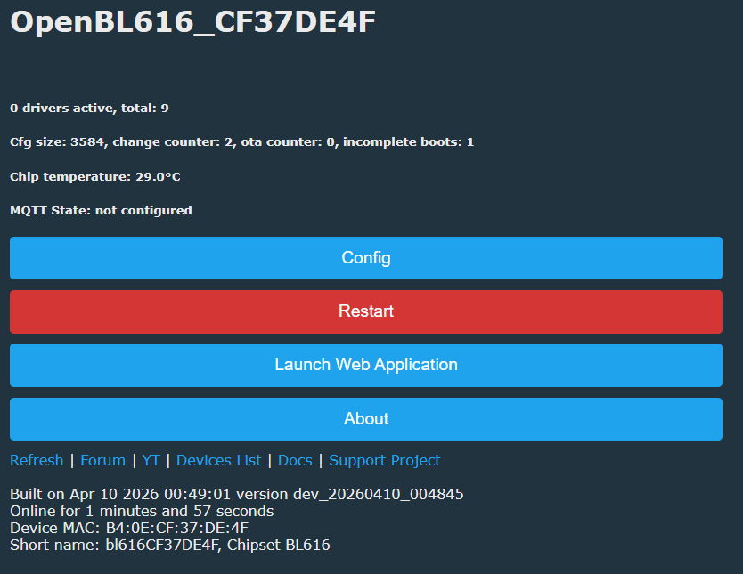

    It triggers in bflb_gpio_pad_check. Considering that OBK is not yet initialized, SDK side bug?
    Here's a build without it
    I'm using BL618, not 616
    • dev_20260410_004845.zip (1.33 MB) You must be logged in to download this attachment.

    Screenshot of the OpenBL616 panel with Config, Restart, and Launch Web Application buttons

  • #17 21910474
    insmod
    Posts: 1367
    Help: 163
    Rate: 429
    Doesn't work on 618
    BootROM version: 102105089 (6160001)
    OTP flags:
    00000000 00000000 00000001 00000000
    00100111 00010010 10001001 00000001
    10000001 00101000 00111001 11001111
    00001110 10110100 10011011 00000000
    Chip type: BL616
    Switching BL616 operation baud to 2000000...
    Flash ID read failed, retrying BL616 flash parameter setup once...
    Failed to get BL616 flash ID.
    There was no result to save.
    Must it be in a separate file? The only real change that it requires is flash_set_para.
    As it is, BL616_FLASH_SET_PARA is hardcoded. It should be getting it from efuse (i think?)
    Also, this block can be removed
    OBK config read is not supported on BL616 yet.
    OpenBL616 is good enough, but i haven't included it because there are no real devices using it yet
