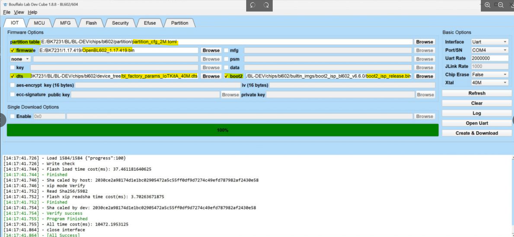

  • Flashing succeeds but no Wi-Fi AP appears
    #3 21713110
    4711leow
    Posts: 13
    @ElektrodaBot below you see flashing aac to ur procedure but even successfull i do not see any AP in my wifi
    leo@leo-HP-ProBook-6560b:~/bl602$ bflb-mcu-tool --chipname bl602 --port /dev/ttyUSB0 --baudrate 115200 --firmware OpenBL602_1.18.187.bin

    [13:41:03.789] - ack is not ok
    [13:41:03.789] - resp: FL
    [13:41:04.052] - power off tx and rx, press the device
    [13:41:04.153] - power on tx and rx
    [13:41:04.877] - clean buf
    [13:41:04.877] - send sync
    [13:41:05.081] - ack is 4f4b
    [13:41:05.111] - handshake succeeded

  • Flashing succeeds but no Wi‑Fi AP appears
    #4 21713120
    ElektrodaBot
    AI OpenAI ChatGPT4
    Posts: 8883
    Help: 364
    Rate: 954
    [13:41:03.469] - ==================================================
    [13:41:03.469] - Chip name is bl602
    [13:41:03.469] - Serial port is /dev/ttyUSB0
    [13:41:03.469] - Baudrate is 115200
    [13:41:03.469] - Firmware is OpenBL602_1.18.187.bin
    [13:41:03.469] - Device Tree is None
    [13:41:03.470] - ==================================================
    [13:41:03.470] - Default xtal is 40M
    [13:41:03.470] - Default flash clock is XTAL
    [13:41:03.470] - Default pll clock is 160M
    [13:41:03.476] - EFUSE_CFG
    [13:41:03.476] - BOOTHEADER_CFG
    [13:41:03.480] - create bootheader using /home/leo/.local/lib/python3.10/site-packages/bflb_mcu_tool/chips/bl602/img_create_mcu/efuse_bootheader_cfg.ini
    [13:41:03.480] - Updating data according to
    [13:41:03.482] - created file len: 176
    [13:41:03.484] - create efuse using /home/leo/.local/lib/python3.10/site-packages/bflb_mcu_tool/chips/bl602/img_create_mcu/efuse_bootheader_cfg.ini
    [13:41:03.485] - Updating data according to
    [13:41:03.486] - created file len: 128
    [13:41:03.489] - Image create path: /home/leo/.local/lib/python3.10/site-packages/bflb_mcu_tool/chips/bl602/img_create_mcu
    [13:41:03.489] - Config file: /home/leo/.local/lib/python3.10/site-packages/bflb_mcu_tool/chips/bl602/img_create_mcu/img_create_cfg.ini
    [13:41:03.494] - Image hash is b'7d0d9b6af41d2b712710919c19871bd462570f63765c9dba36d45e22c8a0e53a'
    [13:41:03.494] - Header crc: b'0c78dc0a'
    [13:41:03.494] - Write flash img
    [13:41:03.500] - Encrypt efuse data
    [13:41:03.542] - ========= eflash loader config =========
    [13:41:03.586] - eflash loader version: v2.6.0
    [13:41:03.586] - program start
    [13:41:03.586] - ========= eflash loader cmd arguments =========
    [13:41:03.586] - config file: /home/leo/.local/lib/python3.10/site-packages/bflb_mcu_tool/chips/bl602/eflash_loader/eflash_loader_cfg.ini
    [13:41:03.587] - serial port is /dev/ttyUSB0
    [13:41:03.587] - cpu reset flag is False
    [13:41:03.587] - chip type: bl602
    [13:41:03.587] - ========= interface is uart =========
    [13:41:03.587] - uart speed: 115200
    [13:41:03.587] - eflash load helper file: /home/leo/.local/lib/python3.10/site-packages/bflb_mcu_tool/chips/bl602/eflash_loader/eflash_loader_40m.bin
    [13:41:03.587] - ========= load eflash_loader.bin =========
    [13:41:03.587] - load eflash_loader.bin via uart
    [13:41:03.587] - ========= image load =========
    [13:41:05.121] - get boot info
    [13:41:05.125] - data read is b'010000000000000003000000d95b1b9494241a00'
    [13:41:05.125] - ========= chip id: 2494941b5bd9 =========
    [13:41:05.125] - last boot info: None
    [13:41:05.125] - sign is 0, encrypt is 0
    [13:41:05.125] - segcnt is 1
    [13:41:05.157] - segdata len is 37728
    [13:41:05.253] - 4080/37728
    [13:41:05.349] - 8160/37728
    [13:41:05.445] - 12240/37728
    [13:41:05.541] - 16320/37728
    [13:41:05.637] - 20400/37728
    [13:41:05.733] - 24480/37728
    [13:41:05.829] - 28560/37728
    [13:41:05.925] - 32640/37728
    [13:41:06.021] - 36720/37728
    [13:41:06.053] - 37728/37728
    [13:41:06.069] - Run img
    [13:41:06.185] - load helper bin time cost(ms): 2597.506
    [13:41:06.285] - Flash load handshake
    [13:41:06.298] - default set DTR high
    [13:41:06.399] - clean buf
    [13:41:06.399] - send sync
    [13:41:06.599] - ack is 4f4b
    [13:41:06.630] - read mac addr
    [13:41:06.645] - mac addr: d95b1b949424
    [13:41:06.645] - flash set para
    [13:41:06.645] - ========= flash read jedec id =========
    [13:41:06.661] - flash jedec id: ef401580
    [13:41:06.664] - jedec id is ef4015
    [13:41:06.664] - capacity id is 21
    [13:41:06.664] - get flash size: 0x00200000
    [13:41:06.664] - program operation
    [13:41:06.664] - processing index 0
    [13:41:06.664] - ========= programming chips/bl602/img_create_mcu/bootinfo.bin to 0x00000000
    [13:41:06.666] - ========= flash load =========
    [13:41:06.666] - ========= flash erase =========
    [13:41:06.666] - erase flash from 0x0 to 0xaf
    [13:41:06.677] - erase pending
    [13:41:06.729] - erase time cost(ms): 62.408
    [13:41:06.757] - load 176/176 [100%]
    [13:41:06.757] - flash write check
    [13:41:06.773] - flash load time cost(ms): 43.743
    [13:41:06.773] - sha256 caled by host: b7347698fb1c8962569c8f261cadcda1e4d7fd5e7a4c1eb77d7675492b2a5aea
    [13:41:06.773] - xip mode verify
    [13:41:06.805] - read 256/176
    [13:41:06.805] - flash xip readsha time cost(ms): 16.225
    [13:41:06.821] - sha256 caled by dev: b7347698fb1c8962569c8f261cadcda1e4d7fd5e7a4c1eb77d7675492b2a5aea
    [13:41:06.821] - verification succeeded
    [13:41:06.821] - processing index 1
    [13:41:06.821] - ========= programming chips/bl602/img_create_mcu/img.bin to 0x00002000
    [13:41:06.826] - ========= flash load =========
    [13:41:06.827] - ========= flash erase =========
    [13:41:06.827] - erase flash from 0x2000 to 0xbd40f
    [13:41:06.840] - erase pending
    [13:41:06.869] - erase pending
    [13:41:06.900] - erase pending
    [13:41:06.932] - erase pending
    [13:41:06.964] - erase pending
    [13:41:06.980] - erase pending
    [13:41:07.012] - erase pending
    [13:41:07.140] - erase pending
    [13:41:07.300] - erase pending
    [13:41:07.477] - erase pending
    [13:41:07.637] - erase pending
    [13:41:07.812] - erase pending
    [13:41:07.988] - erase pending
    [13:41:08.180] - erase pending
    [13:41:08.340] - erase pending
    [13:41:08.516] - erase pending
    [13:41:08.724] - erase pending
    [13:41:08.900] - erase pending
    [13:41:09.012] - erase pending
    [13:41:09.044] - erase pending
    [13:41:09.060] - erase pending
    [13:41:09.092] - erase pending
    [13:41:09.124] - erase pending
    [13:41:09.156] - erase pending
    [13:41:09.208] - erase time cost(ms): 2381.454
    [13:41:09.418] - decompress write rx timeout(ms): 2028.908
    [13:41:09.419] - decompress flash load 424508
    [13:41:09.604] - load 2048/424508 [0%]
    [13:41:09.796] - load 4096/424508 [0%]
    [13:41:09.988] - load 6144/424508 [1%]
    [13:41:10.179] - load 8192/424508 [1%]
    [13:41:10.372] - load 10240/424508 [2%]
    [13:41:10.563] - load 12288/424508 [2%]
    [13:41:10.755] - load 14336/424508 [3%]
    [13:41:10.947] - load 16384/424508 [3%]
    [13:41:11.139] - load 18432/424508 [4%]
    [13:41:11.331] - load 20480/424508 [4%]
    [13:41:11.523] - load 22528/424508 [5%]
    [13:41:11.715] - load 24576/424508 [5%]
    [13:41:11.906] - load 26624/424508 [6%]
    [13:41:12.098] - load 28672/424508 [6%]
    [13:41:12.290] - load 30720/424508 [7%]
    [13:41:12.482] - load 32768/424508 [7%]
    [13:41:12.674] - load 34816/424508 [8%]
    [13:41:12.866] - load 36864/424508 [8%]
    [13:41:13.058] - load 38912/424508 [9%]
    [13:41:13.249] - load 40960/424508 [9%]
    [13:41:13.441] - load 43008/424508 [10%]
    [13:41:13.633] - load 45056/424508 [10%]
    [13:41:13.825] - load 47104/424508 [11%]
    [13:41:14.017] - load 49152/424508 [11%]
    [13:41:14.209] - load 51200/424508 [12%]
    [13:41:14.401] - load 53248/424508 [12%]
    [13:41:14.593] - load 55296/424508 [13%]
    [13:41:14.785] - load 57344/424508 [13%]
    [13:41:14.976] - load 59392/424508 [13%]
    [13:41:15.168] - load 61440/424508 [14%]
    [13:41:15.360] - load 63488/424508 [14%]
    [13:41:15.552] - load 65536/424508 [15%]
    [13:41:15.744] - load 67584/424508 [15%]
    [13:41:15.936] - load 69632/424508 [16%]
    [13:41:16.128] - load 71680/424508 [16%]
    [13:41:16.319] - load 73728/424508 [17%]
    [13:41:16.511] - load 75776/424508 [17%]
    [13:41:16.703] - load 77824/424508 [18%]
    [13:41:16.895] - load 79872/424508 [18%]
    [13:41:17.087] - load 81920/424508 [19%]
    [13:41:17.279] - load 83968/424508 [19%]
    [13:41:17.471] - load 86016/424508 [20%]
    [13:41:17.662] - load 88064/424508 [20%]
    [13:41:17.854] - load 90112/424508 [21%]
    [13:41:18.046] - load 92160/424508 [21%]
    [13:41:18.238] - load 94208/424508 [22%]
    [13:41:18.430] - load 96256/424508 [22%]
    [13:41:18.622] - load 98304/424508 [23%]
    [13:41:18.814] - load 100352/424508 [23%]
    [13:41:19.006] - load 102400/424508 [24%]
    [13:41:19.197] - load 104448/424508 [24%]
    [13:41:19.389] - load 106496/424508 [25%]
    [13:41:19.581] - load 108544/424508 [25%]
    [13:41:19.773] - load 110592/424508 [26%]
    [13:41:19.965] - load 112640/424508 [26%]
    [13:41:20.157] - load 114688/424508 [27%]
    [13:41:20.349] - load 116736/424508 [27%]
    [13:41:20.541] - load 118784/424508 [27%]
    [13:41:20.732] - load 120832/424508 [28%]
    [13:41:20.924] - load 122880/424508 [28%]
    [13:41:21.116] - load 124928/424508 [29%]
    [13:41:21.308] - load 126976/424508 [29%]
    [13:41:21.500] - load 129024/424508 [30%]
    [13:41:21.692] - load 131072/424508 [30%]
    [13:41:21.884] - load 133120/424508 [31%]
    [13:41:22.076] - load 135168/424508 [31%]
    [13:41:22.267] - load 137216/424508 [32%]
    [13:41:22.459] - load 139264/424508 [32%]
    [13:41:22.651] - load 141312/424508 [33%]
    [13:41:22.843] - load 143360/424508 [33%]
    [13:41:23.035] - load 145408/424508 [34%]
    [13:41:23.227] - load 147456/424508 [34%]
    [13:41:23.419] - load 149504/424508 [35%]
    [13:41:23.610] - load 151552/424508 [35%]
    [13:41:23.802] - load 153600/424508 [36%]
    [13:41:23.994] - load 155648/424508 [36%]
    [13:41:24.186] - load 157696/424508 [37%]
    [13:41:24.378] - load 159744/424508 [37%]
    [13:41:24.570] - load 161792/424508 [38%]
    [13:41:24.762] - load 163840/424508 [38%]
    [13:41:24.954] - load 165888/424508 [39%]
    [13:41:25.146] - load 167936/424508 [39%]
    [13:41:25.337] - load 169984/424508 [40%]
    [13:41:25.529] - load 172032/424508 [40%]
    [13:41:25.721] - load 174080/424508 [41%]
    [13:41:25.913] - load 176128/424508 [41%]
    [13:41:26.105] - load 178176/424508 [41%]
    [13:41:26.297] - load 180224/424508 [42%]
    [13:41:26.489] - load 182272/424508 [42%]
    [13:41:26.680] - load 184320/424508 [43%]
    [13:41:26.872] - load 186368/424508 [43%]
    [13:41:27.064] - load 188416/424508 [44%]
    [13:41:27.256] - load 190464/424508 [44%]
    [13:41:27.448] - load 192512/424508 [45%]
    [13:41:27.640] - load 194560/424508 [45%]
    [13:41:27.832] - load 196608/424508 [46%]
    [13:41:28.023] - load 198656/424508 [46%]
    [13:41:28.215] - load 200704/424508 [47%]
    [13:41:28.407] - load 202752/424508 [47%]
    [13:41:28.599] - load 204800/424508 [48%]
    [13:41:28.791] - load 206848/424508 [48%]
    [13:41:28.983] - load 208896/424508 [49%]
    [13:41:29.175] - load 210944/424508 [49%]
    [13:41:29.367] - load 212992/424508 [50%]
    [13:41:29.558] - load 215040/424508 [50%]
    [13:41:29.750] - load 217088/424508 [51%]
    [13:41:29.942] - load 219136/424508 [51%]
    [13:41:30.134] - load 221184/424508 [52%]
    [13:41:30.326] - load 223232/424508 [52%]
    [13:41:30.518] - load 225280/424508 [53%]
    [13:41:30.710] - load 227328/424508 [53%]
    [13:41:30.901] - load 229376/424508 [54%]
    [13:41:31.094] - load 231424/424508 [54%]
    [13:41:31.285] - load 233472/424508 [54%]
    [13:41:31.477] - load 235520/424508 [55%]
    [13:41:31.669] - load 237568/424508 [55%]
    [13:41:31.861] - load 239616/424508 [56%]
    [13:41:32.053] - load 241664/424508 [56%]
    [13:41:32.245] - load 243712/424508 [57%]
    [13:41:32.437] - load 245760/424508 [57%]
    [13:41:32.628] - load 247808/424508 [58%]
    [13:41:32.820] - load 249856/424508 [58%]
    [13:41:33.012] - load 251904/424508 [59%]
    [13:41:33.204] - load 253952/424508 [59%]
    [13:41:33.396] - load 256000/424508 [60%]
    [13:41:33.588] - load 258048/424508 [60%]
    [13:41:33.780] - load 260096/424508 [61%]
    [13:41:33.971] - load 262144/424508 [61%]
    [13:41:34.163] - load 264192/424508 [62%]
    [13:41:34.355] - load 266240/424508 [62%]
    [13:41:34.547] - load 268288/424508 [63%]
    [13:41:34.739] - load 270336/424508 [63%]
    [13:41:34.931] - load 272384/424508 [64%]
    [13:41:35.123] - load 274432/424508 [64%]
    [13:41:35.314] - load 276480/424508 [65%]
    [13:41:35.506] - load 278528/424508 [65%]
    [13:41:35.698] - load 280576/424508 [66%]
    [13:41:35.890] - load 282624/424508 [66%]
    [13:41:36.082] - load 284672/424508 [67%]
    [13:41:36.274] - load 286720/424508 [67%]
    [13:41:36.466] - load 288768/424508 [68%]
    [13:41:36.658] - load 290816/424508 [68%]
    [13:41:36.849] - load 292864/424508 [68%]
    [13:41:37.041] - load 294912/424508 [69%]
    [13:41:37.233] - load 296960/424508 [69%]
    [13:41:37.425] - load 299008/424508 [70%]
    [13:41:37.617] - load 301056/424508 [70%]
    [13:41:37.809] - load 303104/424508 [71%]
    [13:41:38.001] - load 305152/424508 [71%]
    [13:41:38.193] - load 307200/424508 [72%]
    [13:41:38.385] - load 309248/424508 [72%]
    [13:41:38.576] - load 311296/424508 [73%]
    [13:41:38.768] - load 313344/424508 [73%]
    [13:41:38.960] - load 315392/424508 [74%]
    [13:41:39.152] - load 317440/424508 [74%]
    [13:41:39.344] - load 319488/424508 [75%]
    [13:41:39.536] - load 321536/424508 [75%]
    [13:41:39.728] - load 323584/424508 [76%]
    [13:41:39.919] - load 325632/424508 [76%]
    [13:41:40.111] - load 327680/424508 [77%]
    [13:41:40.303] - load 329728/424508 [77%]
    [13:41:40.495] - load 331776/424508 [78%]
    [13:41:40.687] - load 333824/424508 [78%]
    [13:41:40.879] - load 335872/424508 [79%]
    [13:41:41.071] - load 337920/424508 [79%]
    [13:41:41.262] - load 339968/424508 [80%]
    [13:41:41.455] - load 342016/424508 [80%]
    [13:41:41.646] - load 344064/424508 [81%]
    [13:41:41.838] - load 346112/424508 [81%]
    [13:41:42.030] - load 348160/424508 [82%]
    [13:41:42.222] - load 350208/424508 [82%]
    [13:41:42.414] - load 352256/424508 [82%]
    [13:41:42.606] - load 354304/424508 [83%]
    [13:41:42.798] - load 356352/424508 [83%]
    [13:41:42.989] - load 358400/424508 [84%]
    [13:41:43.182] - load 360448/424508 [84%]
    [13:41:43.373] - load 362496/424508 [85%]
    [13:41:43.565] - load 364544/424508 [85%]
    [13:41:43.757] - load 366592/424508 [86%]
    [13:41:43.949] - load 368640/424508 [86%]
    [13:41:44.140] - load 370688/424508 [87%]
    [13:41:44.333] - load 372736/424508 [87%]
    [13:41:44.524] - load 374784/424508 [88%]
    [13:41:44.716] - load 376832/424508 [88%]
    [13:41:44.908] - load 378880/424508 [89%]
    [13:41:45.100] - load 380928/424508 [89%]
    [13:41:45.292] - load 382976/424508 [90%]
    [13:41:45.484] - load 385024/424508 [90%]
    [13:41:45.676] - load 387072/424508 [91%]
    [13:41:45.867] - load 389120/424508 [91%]
    [13:41:46.059] - load 391168/424508 [92%]
    [13:41:46.251] - load 393216/424508 [92%]
    [13:41:46.443] - load 395264/424508 [93%]
    [13:41:46.635] - load 397312/424508 [93%]
    [13:41:46.827] - load 399360/424508 [94%]
    [13:41:47.019] - load 401408/424508 [94%]
    [13:41:47.211] - load 403456/424508 [95%]
    [13:41:47.403] - load 405504/424508 [95%]
    [13:41:47.594] - load 407552/424508 [96%]
    [13:41:47.786] - load 409600/424508 [96%]
    [13:41:47.978] - load 411648/424508 [96%]
    [13:41:48.170] - load 413696/424508 [97%]
    [13:41:48.362] - load 415744/424508 [97%]
    [13:41:48.554] - load 417792/424508 [98%]
    [13:41:48.746] - load 419840/424508 [98%]
    [13:41:48.937] - load 421888/424508 [99%]
    [13:41:49.129] - load 423936/424508 [99%]
    [13:41:49.193] - load 424508/424508 [100%]
    [13:41:49.193] - flash write check
    [13:41:49.209] - flash load time cost(ms): 40000.64
    [13:41:49.213] - sha256 caled by host: 7d0d9b6af41d2b712710919c19871bd462570f63765c9dba36d45e22c8a0e53a
    [13:41:49.213] - xip mode verify
    [13:41:49.449] - read 256/766992
    [13:41:49.450] - flash xip readsha time cost(ms): 224.528
    [13:41:49.465] - sha256 caled by dev: 7d0d9b6af41d2b712710919c19871bd462570f63765c9dba36d45e22c8a0e53a
    [13:41:49.465] - verification succeeded

    I don't see mention of the toml, dts or boot file in your flash command. These are required if flashing OpenBL602_1.18.187.bin to BL602.
    Bouffalo Lab Dev Cube window showing selected toml, dts, and boot2 files for BL602 flash
  • #9 21734384
    4711leow
    Posts: 13
    Thanks to Diadow's screenshot, where the app marked lines that need to be filled, I just put the firmware.
