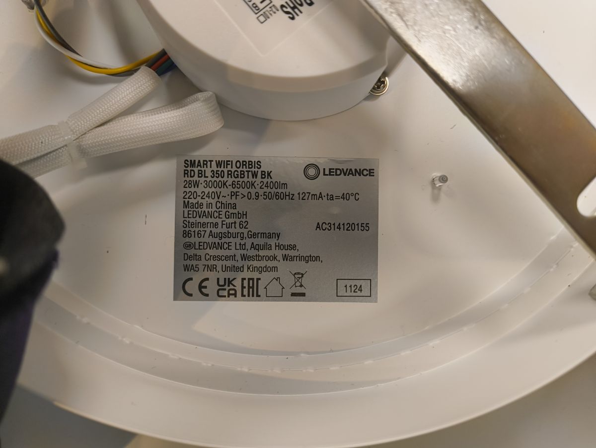

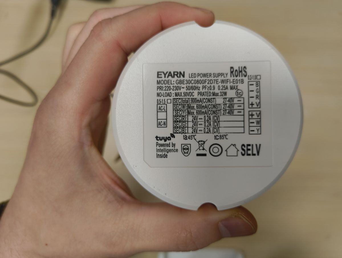

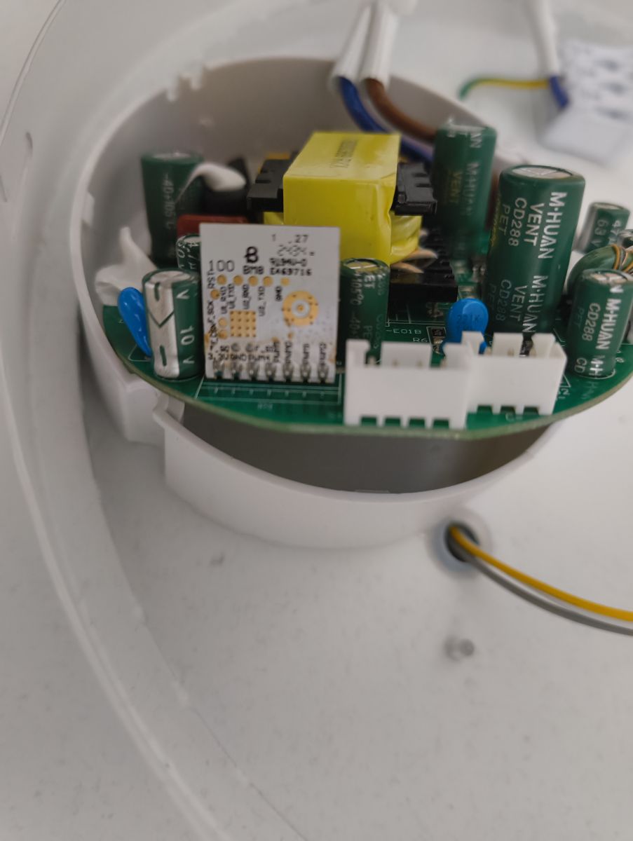

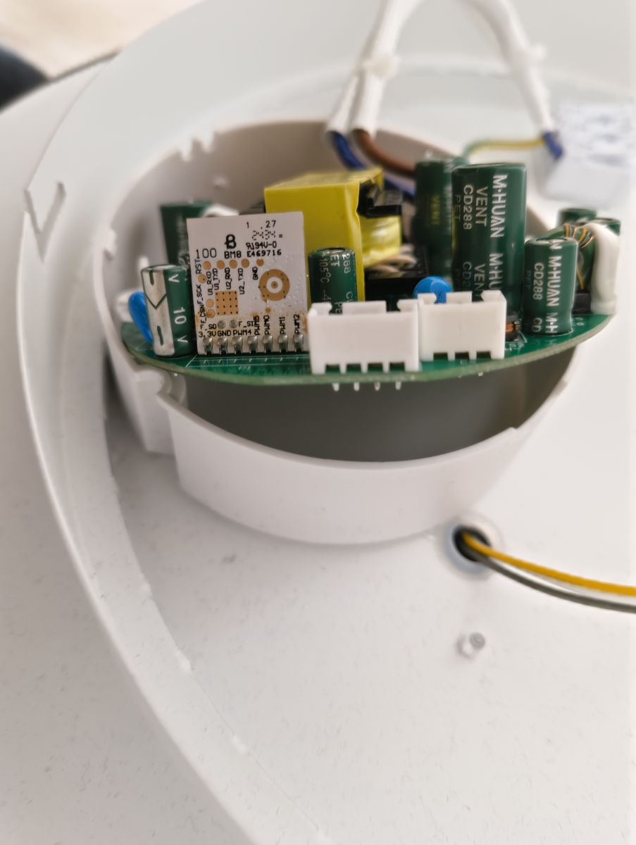

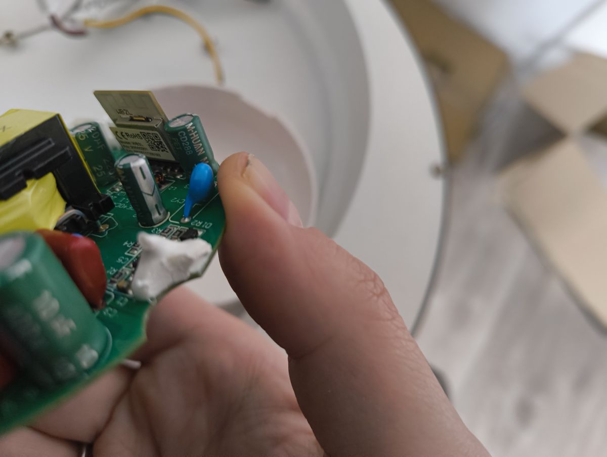

    Hello together,
    after I found OpenBeken I was totally happy that there is an alternative to Tasmota, that works on the Beken chips.
    I have a couple of Ledvance SMART Orbis Backlights here at home and like to integrate it into my home automation platform via MQTT. Sadly Ledvance don't provide any possibilities to do so without their app and/or offline.
    Because of this, I took the chance to test OpenBeken and it worked pretty well. I created a video how to do this.
    English: https://www.youtube.com/watch?v=KLGQgxonuIw
    German: https://www.youtube.com/watch?v=Mmw2ukTRFl4
    Here additionally some photos, the config and the backuped firmware
    How to flash Ledvance SMART+ Orbis Backlight RGBCW with OpenBeken? How to flash Ledvance SMART+ Orbis Backlight RGBCW with OpenBeken? How to flash Ledvance SMART+ Orbis Backlight RGBCW with OpenBeken? How to flash Ledvance SMART+ Orbis Backlight RGBCW with OpenBeken?
