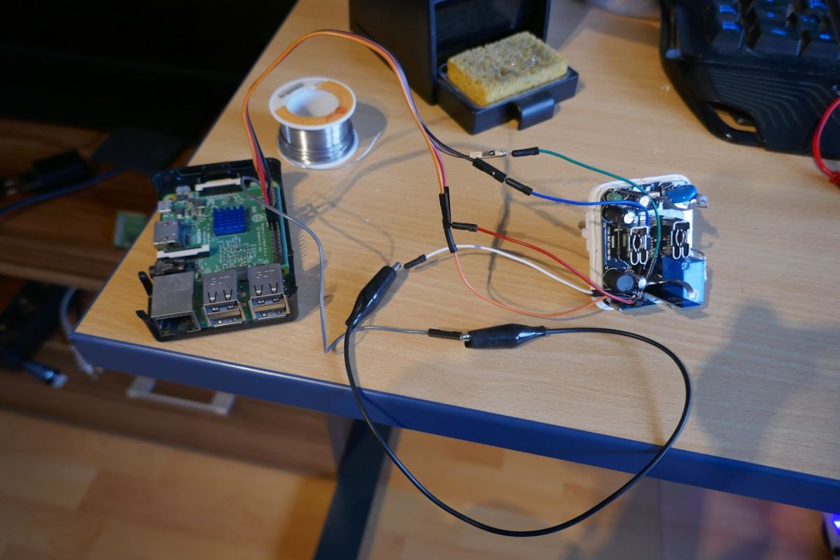

    Step 2 - Prepare for Flashing
    Once the device has been opened, you should easily find the blue board labeled "WB2S" - this is the one you need to flash. Regretfully the pins required to do an UART flash are not accessible at all. Neither is it possible to desolder the board, unless you desolder the main PCB first. I opted against that option, because I did not want to mess with the 220V main electricity circuitry - anything going wrong here and your device might catch fire or you might catch an electric shock, once you plug it back in. Compared to that, messing with the 3.3V BK7231T IC is relatively safe (or so do I hope).
    Luckily, there is another, less used but still viable option to flash your device: SPI. And just a lucky, the pins for that are quite accessible. At least most of them. Once I had everything soldered together according to that diagram, I figured that the 3.3V power supply had been omitted. Therefore I give you the complete wiring instructions here:
    CEN -> GPIO22
    SCK -> SPI0 SCLK
    CSN -> SPI0 CE0
    SI -> SPI0 MOSI
    (ADC_)SO -> SPI0 MISO
    VBAT -> 3v3
    GND -> Ground
    For you reference:
    WB2S Datasheet
    Raspberry Pi Pinout

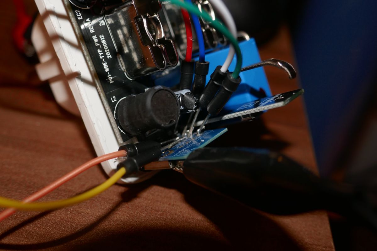

    You will notice that especially the VBAT and GND pads are really difficult to solder to, because the main PCB is in the way. Consequently (after I barely managed to solder the VBAT pad) I cheated a little and connected the Ground via other means: It turns out that the metal case, protecting the actual IC, is grounded as well :)
    I wish you the best of luck with soldering!
    Raspberry Pi connected with cables to a disassembled smart plug.
    My initial attempt with only four wires. VBAT and GND are still missing.
    Circuit board with soldered wires connected to various points.
    And the final version with all six wires connected. If you can't see yourself soldering in the tiny gap here, this instruction is probably not for you.

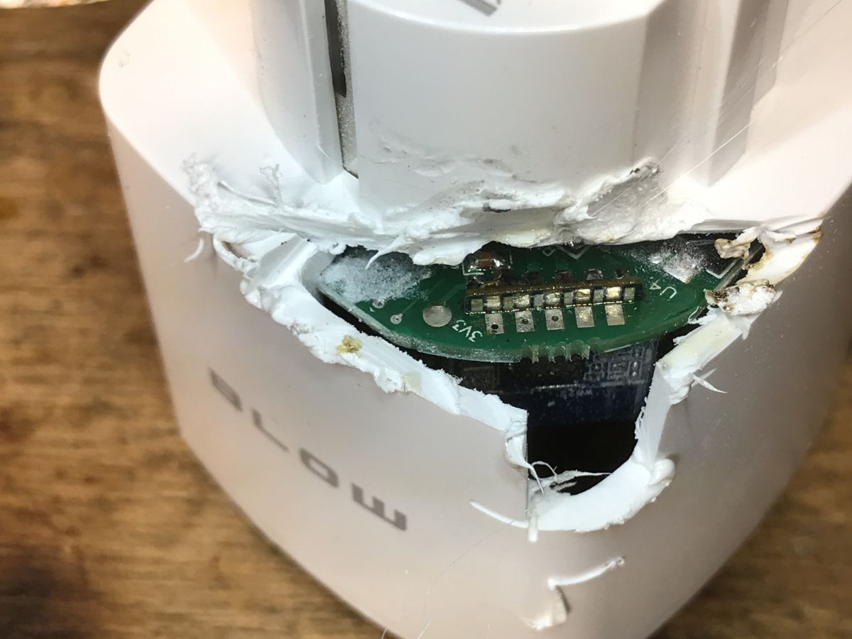

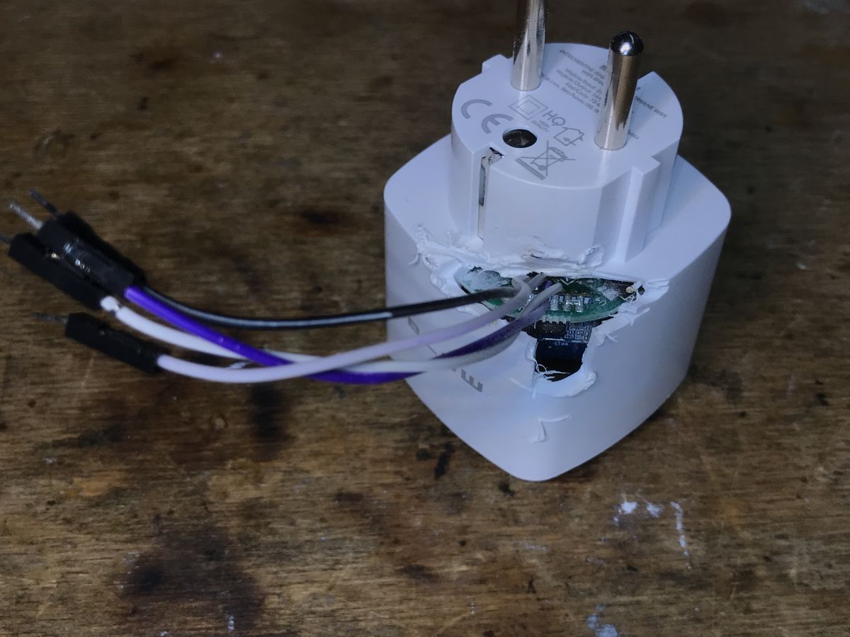

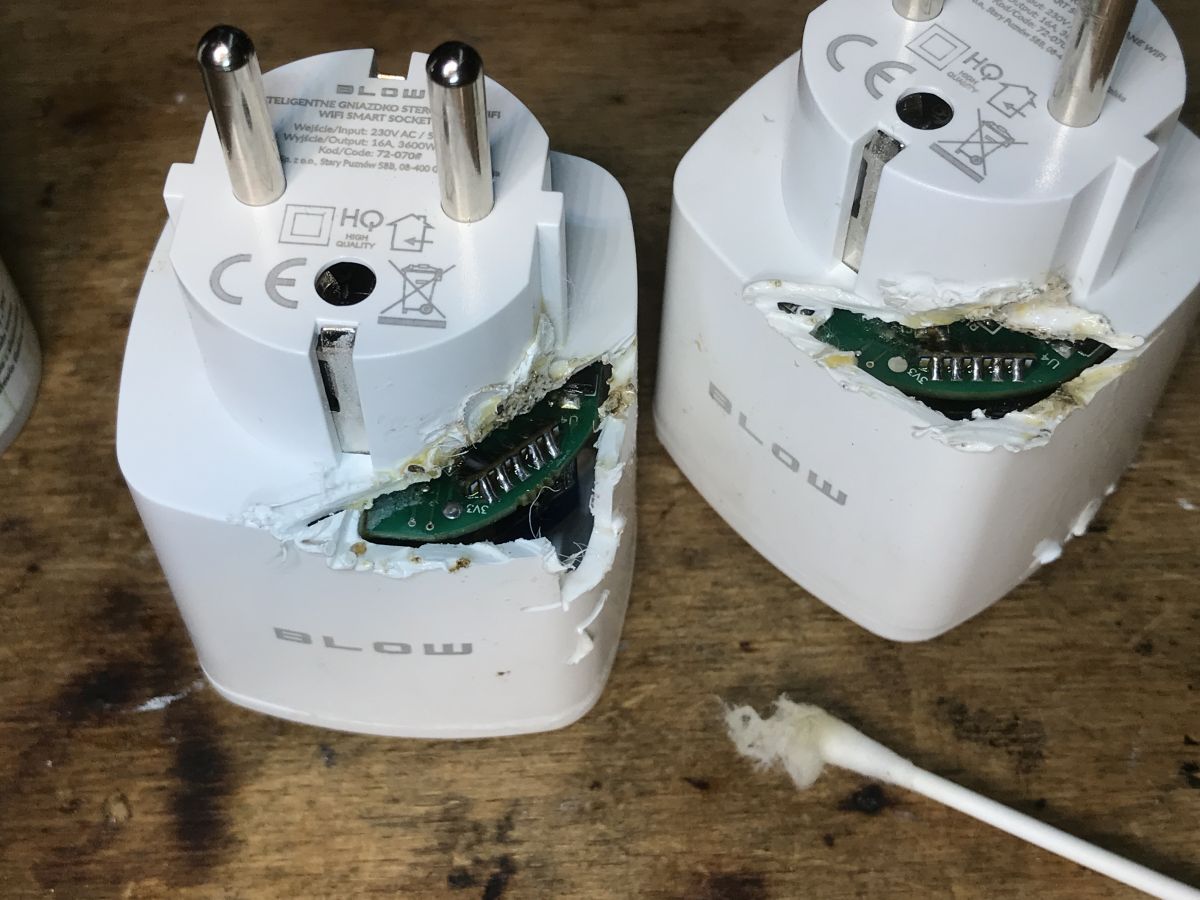

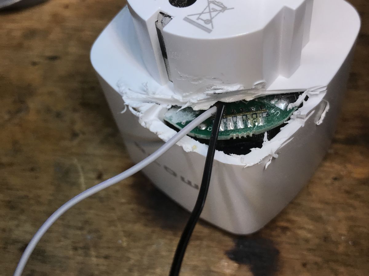

    Very nice guide, I see what you did there. That's a clever approach to the badly accessible pins problems.
    Since your topic is SPI related, you might also want to look here:
    https://www.elektroda.com/rtvforum/topic3931424.html
    I also had a similiar issue last week, but I've chosen a totally different approach:
    Two white, damaged smart plugs by BLOW with exposed internal electronics. Close-up of a damaged electrical device with a visible opening through which wires and a PCB are protruding. View of a modified electrical plug with exposed wires and PCB. Damaged plastic device casing with visible interior and PCB.
    My device had a different case and it was harder to even solder to WB2S pads on the pads so I decided to just make a hole and access the pads from the bottom.
